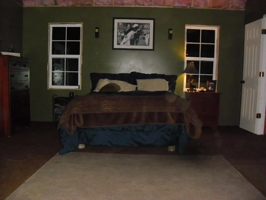

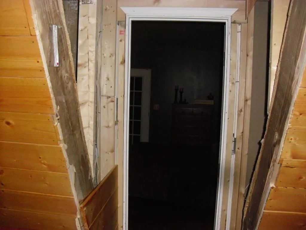

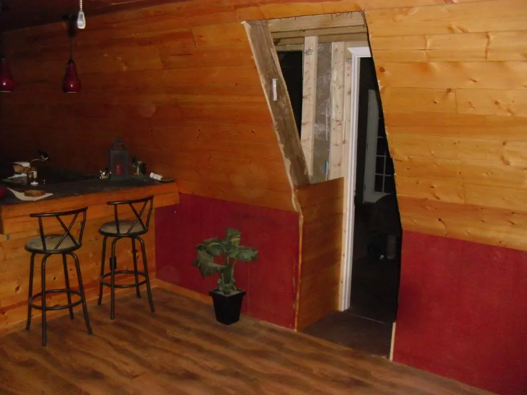

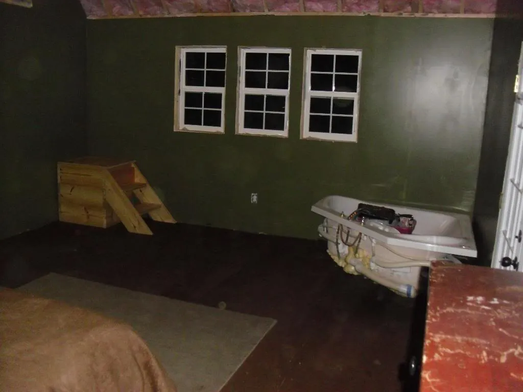

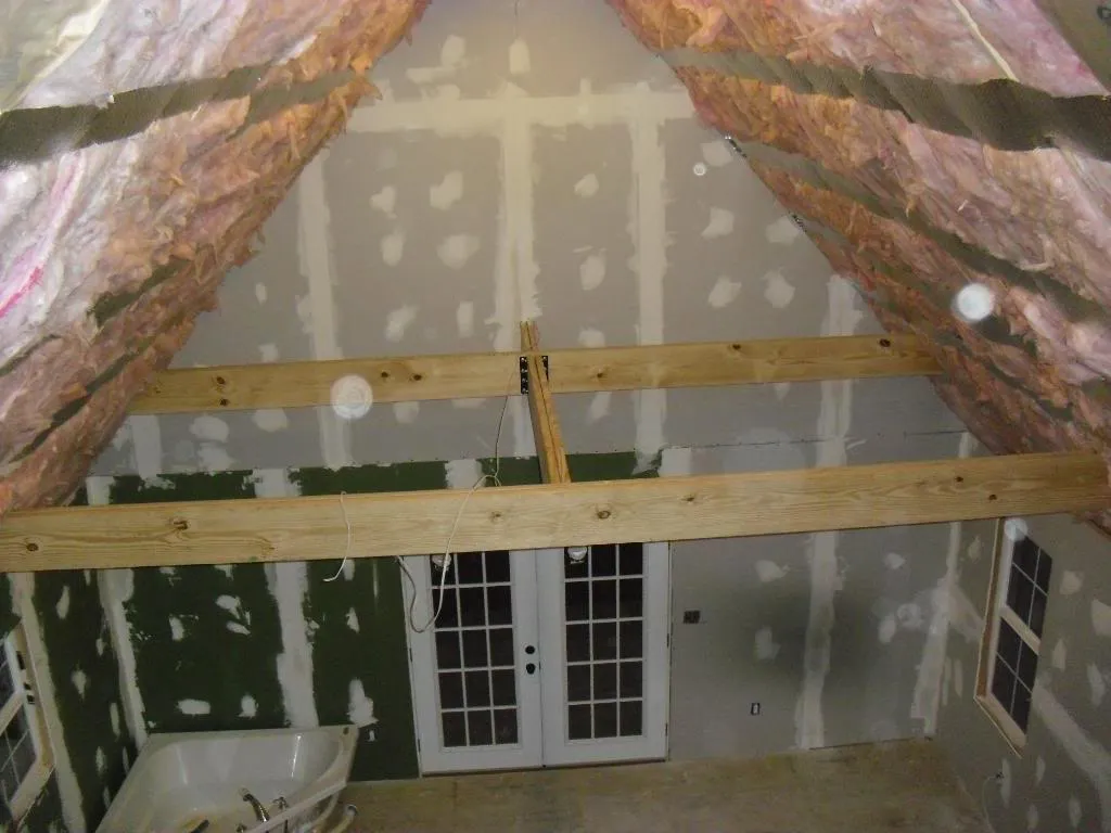

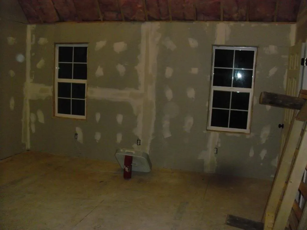

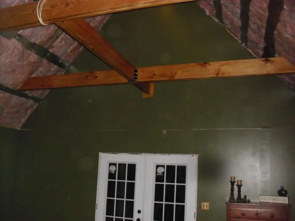

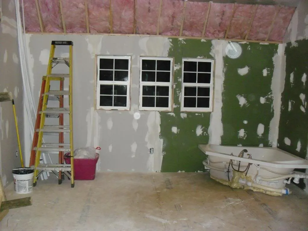

Here are pics of the past week or so. Progress has been very slow as I had a couple guys I was in the military with visiting the past couple weeks, and didnt want to work the whole time they were here. Need to sand and then paint. The green colored drywall in the corner is mildew resistant since thats where the jacuzzi will be.
I will have pine trim going up all corners and around all windows and doors as well as all the way across where the upper and lower wall meets above the french doors. The loft area and ceiling will be covered with pine. Not sure if I want to build a bookshelf or a small closet in the area I have cut out in the drywall yet. If I do a shelf I will have to build some type of closet upstairs in the loft. Any ideas will be much appreciated.
The area cut out above the doors looks like a good place to build out into a sleeping loft.
EaglesSJ
Its only 4 ft deep. not really enough for a sleeping loft. I have thought about building it out into the room further though. But Im not sure if we want another bed in our bedroom or not. I was thinking more of a lounge area.
My thought was to cantilever the build out off of the rafters of the main house roof.The floor joist would have to be through bolted I think.Just a thought.I kind got that "Little House On the Prairie" thought in my head when I saw that space.Did you ever watch that show and see how the sleeping loft was laid out?I thought it was kinda neat.Should have been warm that high and close to the chimney.

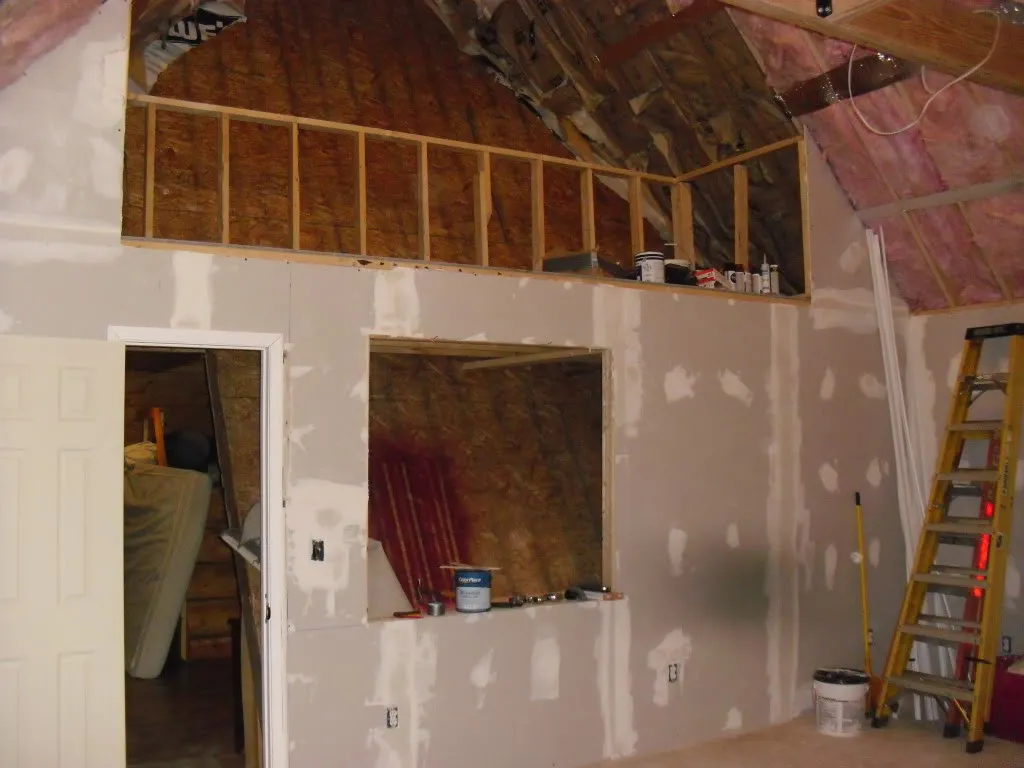

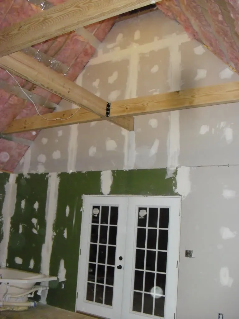

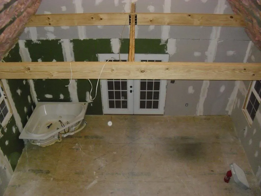

Here are the past couple days progress pics. We havent done alot because we are out of funds. I was laid off right before Christmas and I am still looking for work. We did manage to sand the drywall, paint, stain the beams, trim where they join the drywall, and build the lower half of the loft stairs out of reclaimed lumber from the stairs that were in our living room previously. I also reused the boards cut from the wall where the entry to the addition now is. We had over half of a 5 gallon bucket left of brown paint from the underpinning and decided to paint the OSB flooring to make it a little easier to sweep and for looks since it will be another month or so until we can do anything else with it. Please keep in mind that the loft area and the area where the upper and lower wall meets above the french doors will all have wood trim and this is the reason for not having finished drywall seams in those areas. I will probably be trimming around the windows and doors and such in a week or so. But it is livable at this point and that is the key. My next priority is fireproofing the wall behind and beside the woodstove as I can tell the wood is starting to really dry out. I will more than likely do something with copper sheeting. Not sure yet though as we really need to put the money to use elsewhere so drywall maybe what happens.
We are about $3000 from completing the addition both inside and out. $1000 inside for TG ceiling and loft area, $500 for flooring, $200 for tub plumbing and surrounds, and then about $1300 for log siding and exterior finishing. Anyways without further ado, here are the pics. Probably the last for a week or so at least.
