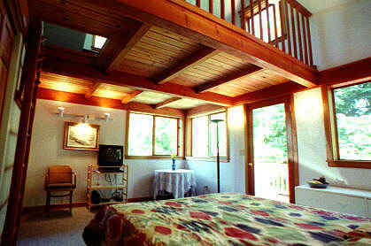

devildog
Thanks for the pic john.
All good points. I did mention to my wife that we could extend the wall to the ceiling later if she needed more privacy when she's older.

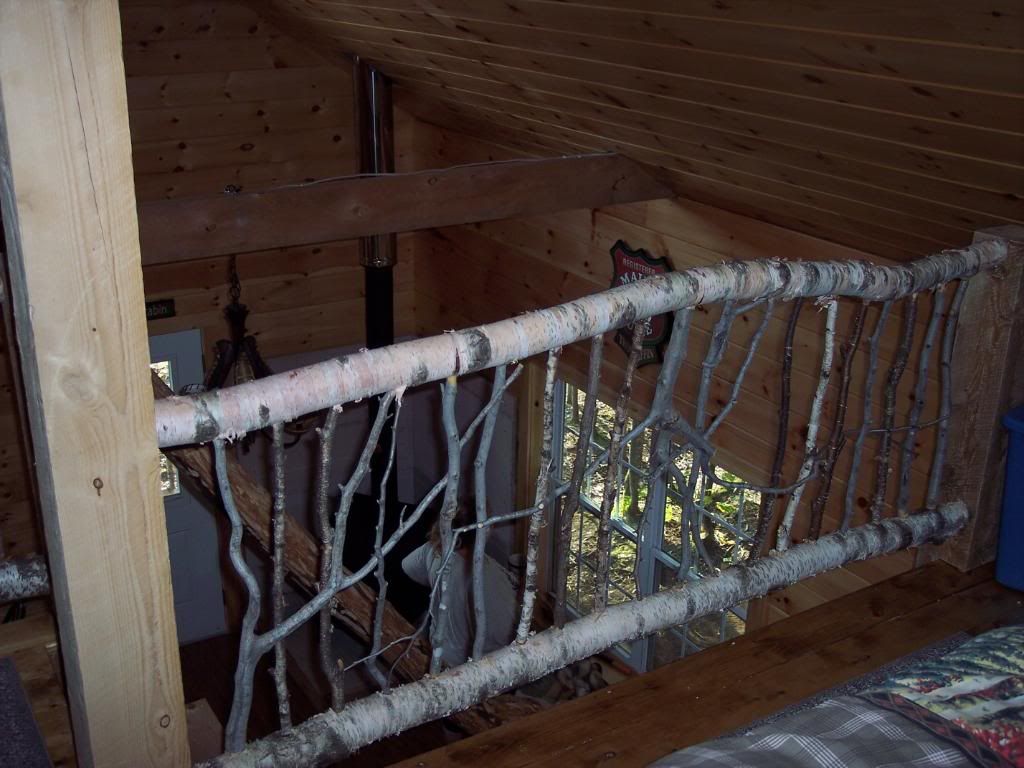

MaineRhino
This may be a little more rustic than what you want, but it gives a feel of what the view would be.
I think a short wall may give the child more privacy, but the real issue would be the sound, such as from a radio, ipod, or even speaking (or playing).
Ours is 20x26, and the loft is 20x10.
Quote from: devildog on March 25, 2010, 02:15:25 PM
As far as guest go,I think they should deal with what they get.
Right. As far as we are concerned we build/buy what we want/need for our normal day to day lives. Over the years we have packed a good number of people into the house on a temporary basis. There were one or two who perceived their needs to be above what we have to offer. The nearby hotels take care of that. Ditto when we visit a couple different relatives. We know will will be better served by the local Day's Inn. No hard feelings are held by anyone as far as I know.
devildog
MaineRhino, That does prove what Im talking about. While standing below, if that wall was solid and about 42" you couldnt see anything going on in the room.

rocking23nf
I dont think that railing made out of branchs would pass code in many areas, there are too large of gaps in some of the spindles.
I believe 3 inchs is the max you can have.
