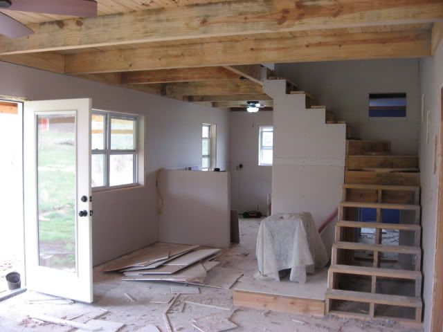

We were suppose to start drywall on Monday but I arrived to 6-8 inches of snow on the ground so the crew didn't show.
They started in on tuesday and finished hanging today.  Taping and floating on Friday.

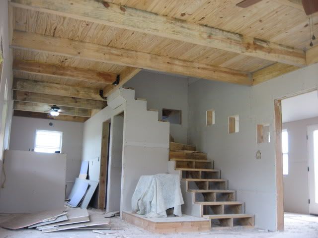

Across from the stove I plan a L-shaped built-in dining booth.

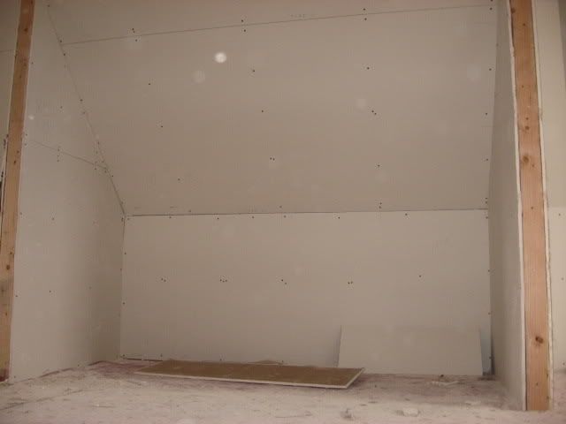

I didn't have them rock the interior of the closet because I want to put some shelves between the studs for additional storage.  The closet will serve as a pantry of sorts for the kitchen.

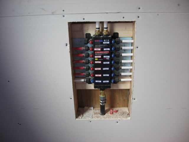

Cubby for the manifold.

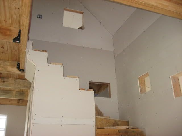

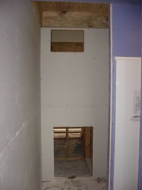

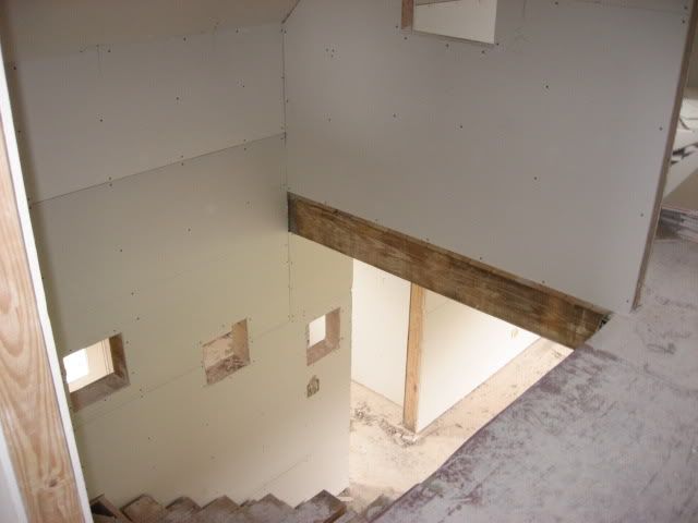

Closet at the top of the stairs.
Looking back down.

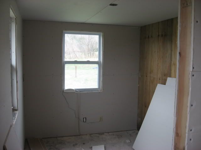

Office/ guest room

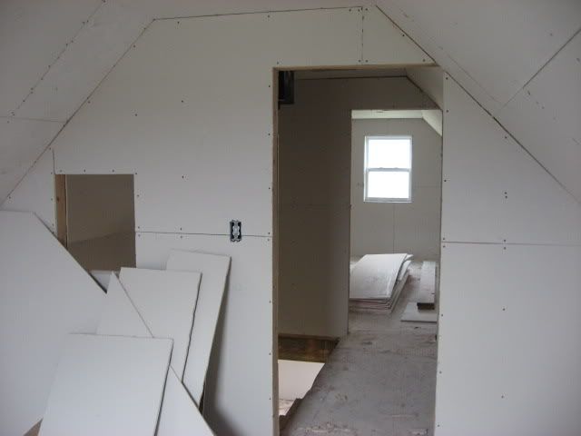

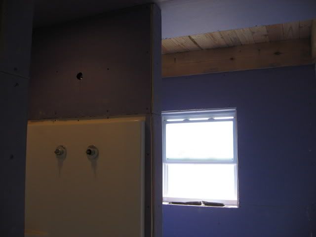

Both of the upstairs bedrooms have interior windows that will look down into the stairwell.  We also put one looking into the bathroom but that will have an opaque or stained glass insert- only to keep the light moving.
Bathroom- as best I could photograph such a small space!

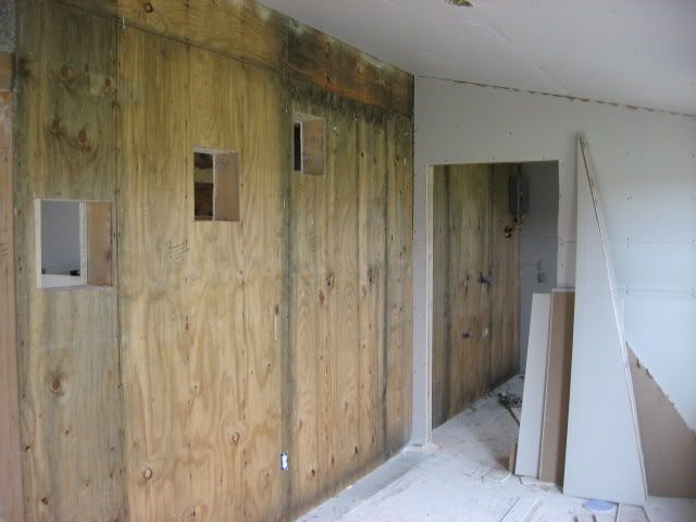

The "dog room"
Looking into the laundry room. Future home of the washer/dryer, freezer, sink, dog food preparation area(don't ask)
Upstairs looking from one bedroom to another.

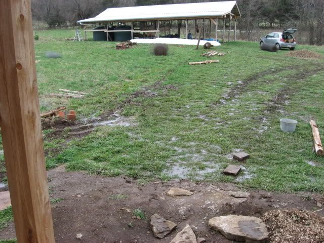

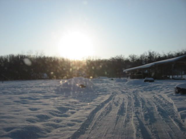

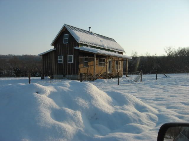

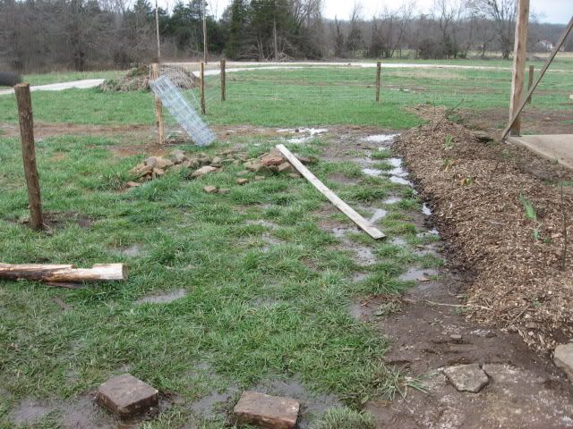

Of course the snow melted fast with temps in the 60's so now it's a muddy, soggy mess.  And more rain in the forecast  :(  Luckily the berm is working well to keep the water away from the house.  We'll add another french drain close to the fence.
And this is dry compared to yesterday!

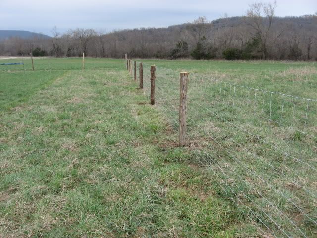

We've started the fencing to keep our dogs in check.

To answer your question, it is a vented cap in that it is an A- shaped piece of metal that is fastened to the tops of the standing seams.  They bent the ends of the panels up under the ridge cap so you don't get a full 1-3/8 space...maybe something more like 3/8ths.  But it will make a nice space for air to escape the small attic space.  Also when I add that to the triangle vents at each gable end I should have enough free space for the house fan to exhaust the hot air in the summer.
Now, even with that steep pitch I had to have them come back and attach that brillo pad like mesh under the cap because one time with snow on the roof and a strong northwest wind, snow actually was blown back up under the cap and fell down into the attic space (well, actually it made it into the bedroom- this was before insulation and drywall).  If you go with vented, I'd make sure to use it on your house because it's an even less steep pitch (is it like a 4/12?) and I would think that snow would more easily make its way in.  I had them completely close off the shed roof's on both sides because they are less than 3/12 and snow very easily came in the house when it slid off the 12/12.  Not a lot, but enough to make me nervous about eventual water damage marks on the drywall ceiling.
They did use rake trim and eave trim as well.  In fact, both trims were integral to the panels as they helped to fasten them in place.  I've never been big on rake trim for metal roofs but I'm very happy with the way that it looks.  It's not as bulky looking as some rake trims I've seen.  Plus both the rake and the eave have a slight turn-out at the ends to help water to drip away from the facia board.

OlJarhead
I noticed that Don put in something similar.  Is this for your water lines or some kind of heating system?
I've never seen these 'pex manifolds' before and am wondering why I keep seeing them ???
http://www.pexsupply.com/Viega-MXBD14-2-3-8-14-Port-Compression-MANABLOC-6-hot-8-cold-5380000-p
I found that -- interesting.  So it's a plumbing distro for multiple locations?
For my little cabin I can't imagine using one but perhaps if they made something with 3 colds and 2 hots I'd be interested.
jdhen
It's for the water lines.  The main supply line comes in at the bottom.  The top 2 lines go to and from the water heater.  The white lines supply the cold water and the red to the hot.  It basically allows you to run a dedicated line to each faucet.
This is the smallest manifold I could find.  They make some small copper manifolds that have from 2 or more outlets with shut-off valves so you might make something like that work in your situation.
Jesse
This is a nice neat system that is so much more doable for an owner than cutting and sweating copper pipe (like we did!)
OlJarhead
Quote from: jdhen on March 30, 2010, 07:34:46 AM
Thanks for the reply.
Interesting really.  I can see doing this in my case too becuase I have a main pipe that would come to the manifold from the cistern and then the hot going to the instant on LP heater and running the home runs to where they are needed.
I wonder if it wouldn't work to use this to run to a water spicket on the side of the house too?  Also to have reserve for an extra room if one should be added with a bathroom in it also.
In my case I need cold to go to the kitchen sink, bathroom sink, tub and composting toilet and then hot to the tub/shower, kitchen and bathroom sinks.  So have 7 or 8 leads is pretty excessive but for $90 if they can be plugged off it might be worth it.  I could run one of the colds to the back and front walls of the cabin allowing me to hook up watering/sprinkling hoses to them then.

Scott, you really are too kind.  While I am proud of the way the pex turned out you notice I haven't been posting lots of pics of the DWV  ::)  Not real clean with the primer or the glue.
Jarhead- I have 2 cold lines running to hose bibs under the house and that will run through the foundation wall.  It will be useful for small amounts of watering but they recommend that if you're planning to use it for heavy irrigation to run it separately off the main and not through the manifold.
It's easy to plug off unused ports.  I have one and the plugs cost $.60 or so.

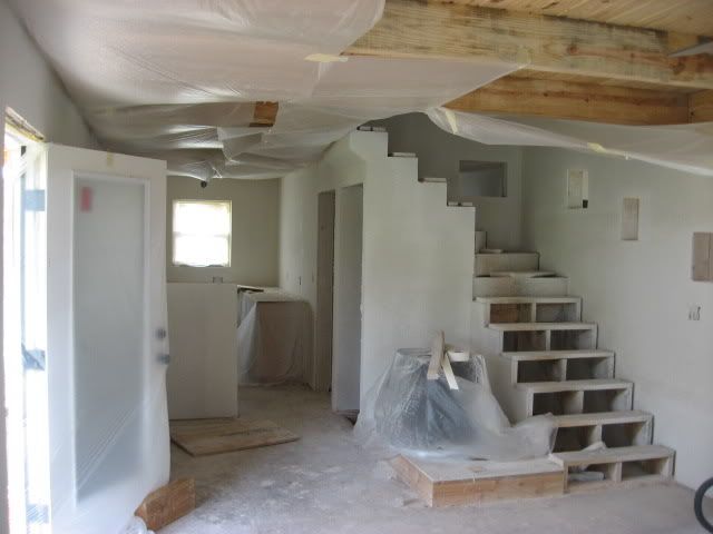

Everything is now draped in plastic as the texture crew finished up the drywall today.  I had them leave it up because it will make the painting much easier.  That starts tomorrow  :P
