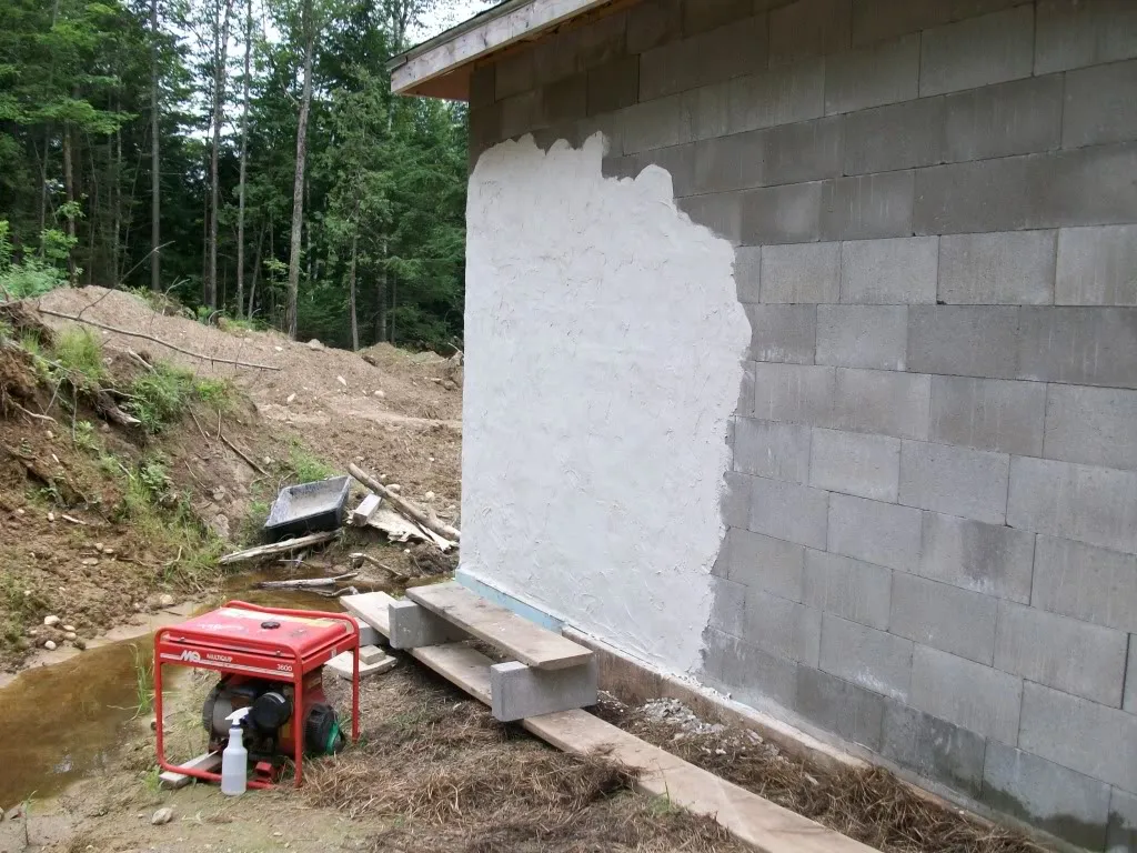

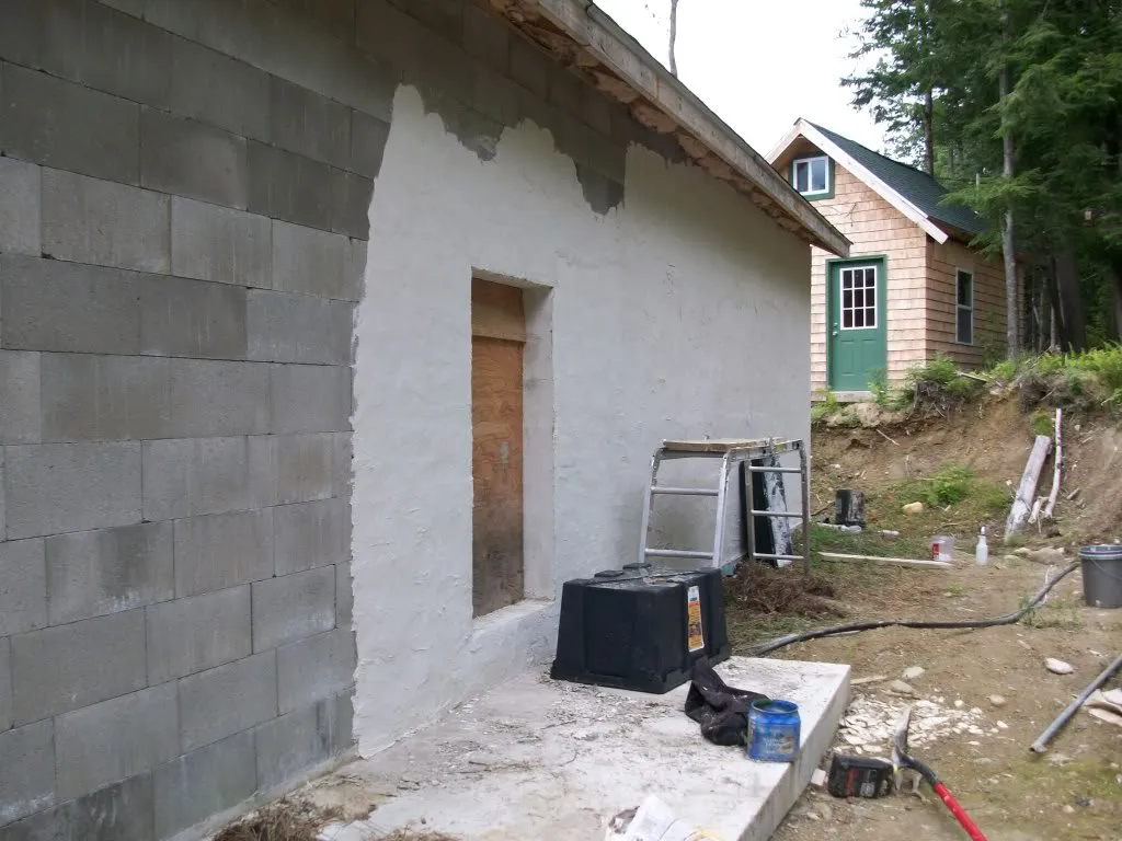

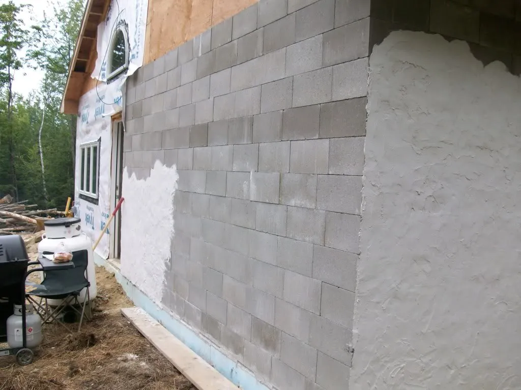

Anyways, on to pics! I parged this weekend. This is one bag
and heres the other one. Each bag takes about 2 hrs to mix and apply.

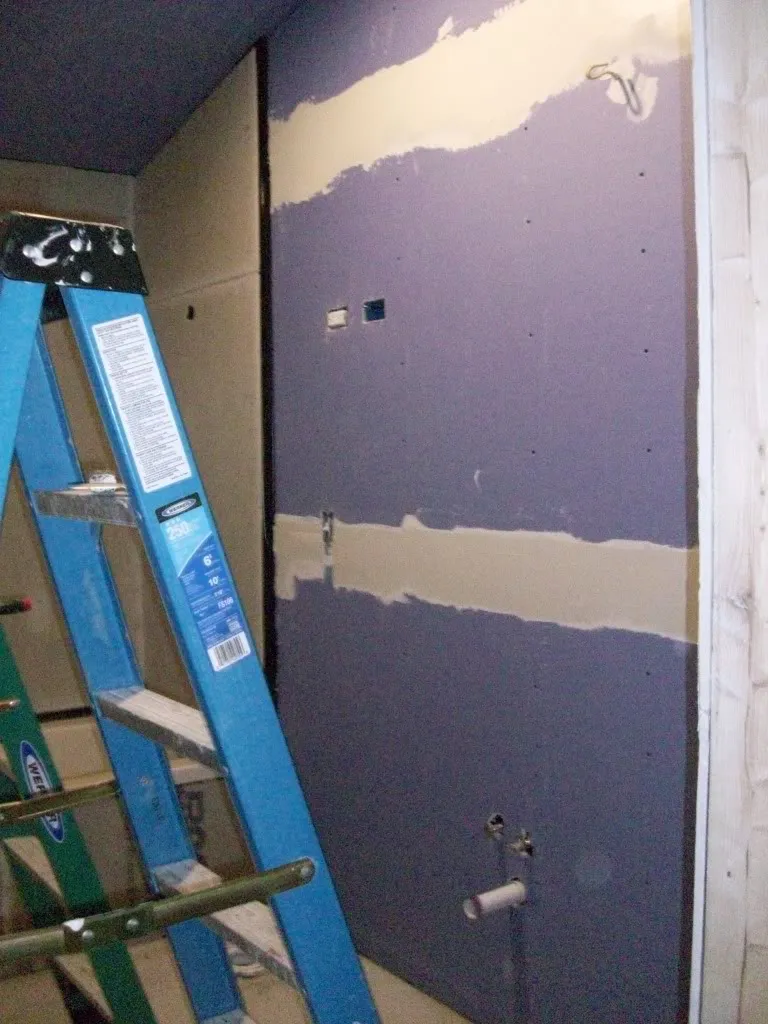

Anyways, after the system was done, I put up the 6 mil plastic and then drywalled the rest of the bathroom, then started the tapered joints.
I also cleared some brush and wired more outlets and switches to round out the weekend.

congrats on plumbing!  BTW are you mixing by hand or machine?

I'm mixing by hand. We'll me and my 2 buddies we all mix by hand. We use a hoe primarily.

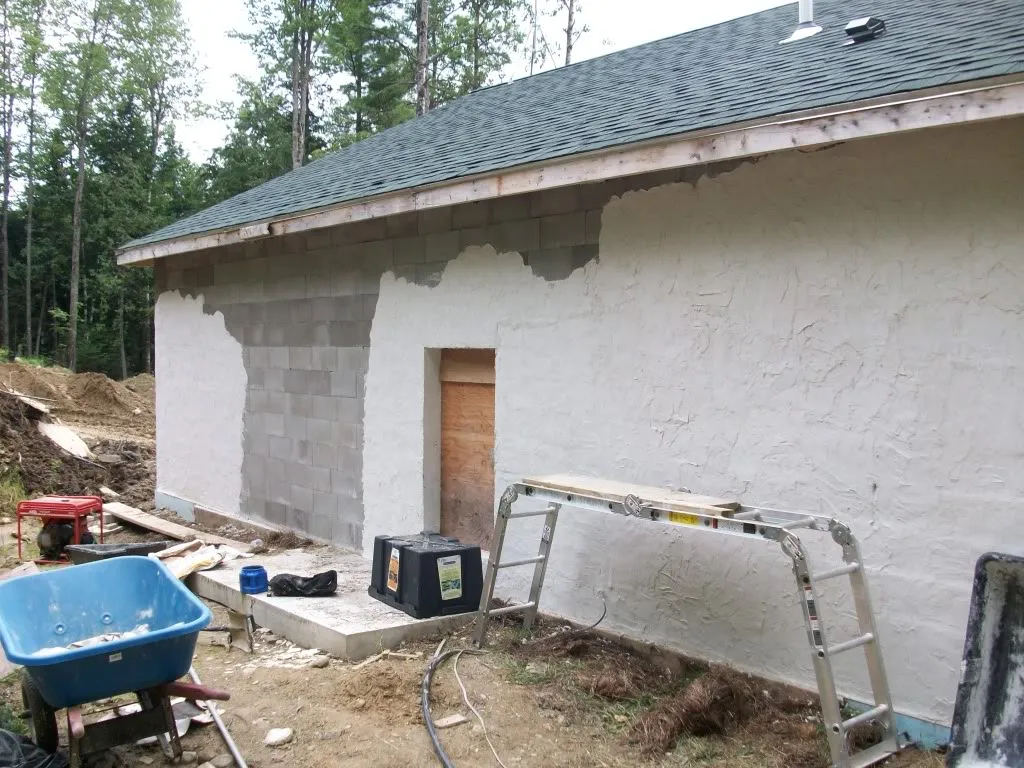

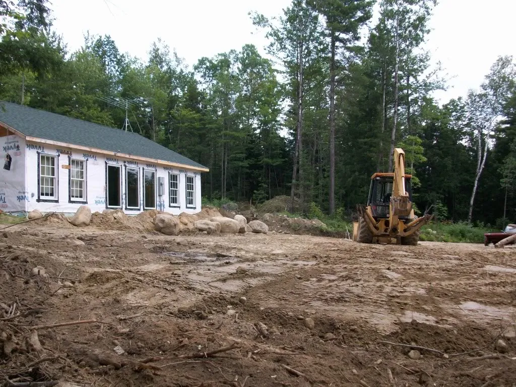

Anyways, here are some pics from the weekend. I'm posting these blind so if they don't come up. Let me know. We went through 6 bags of SBC and have 5 more to go, then were finished before I build the cold cellar. We're aiming for this coming weekend to wrap it up. It took 3 able bodied guys 6 hrs to do 6 bags and everyones hands were beat afterwards!

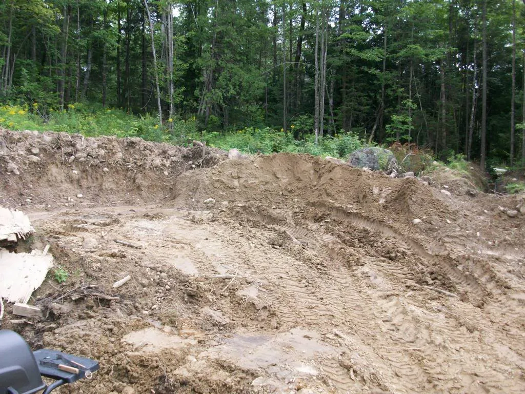

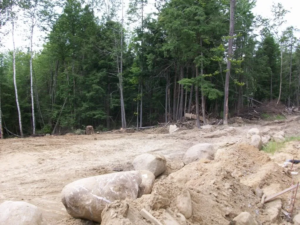

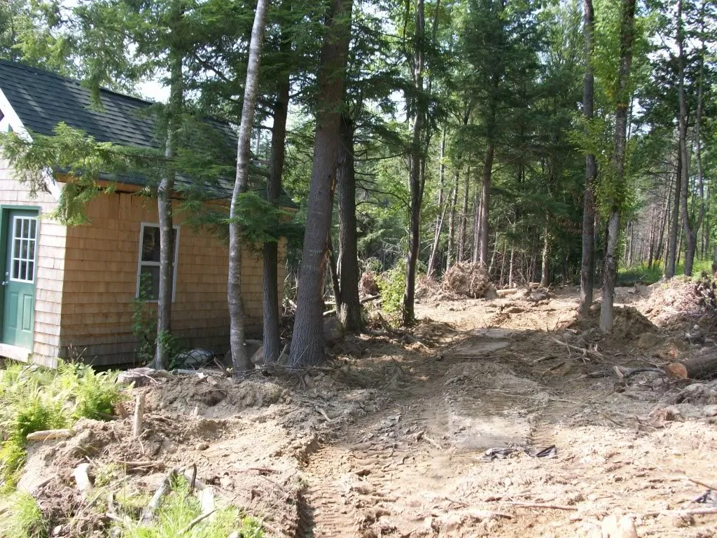

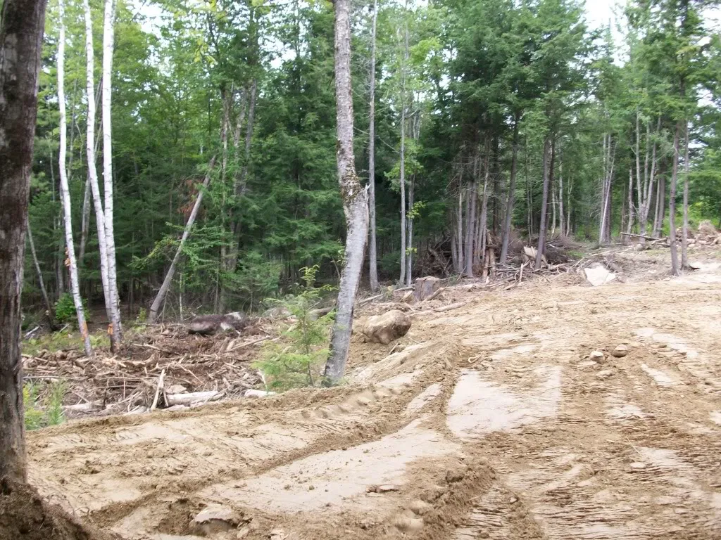

I also spent a great deal of time on my backhoe clearing more land and terracing out my sloping lot. I'm collecting boulders for either a wall in front of my house or behind it.
Dog
Looking really good!
"Collecting" boulders huh?  :) I sense some interesting landscaping...

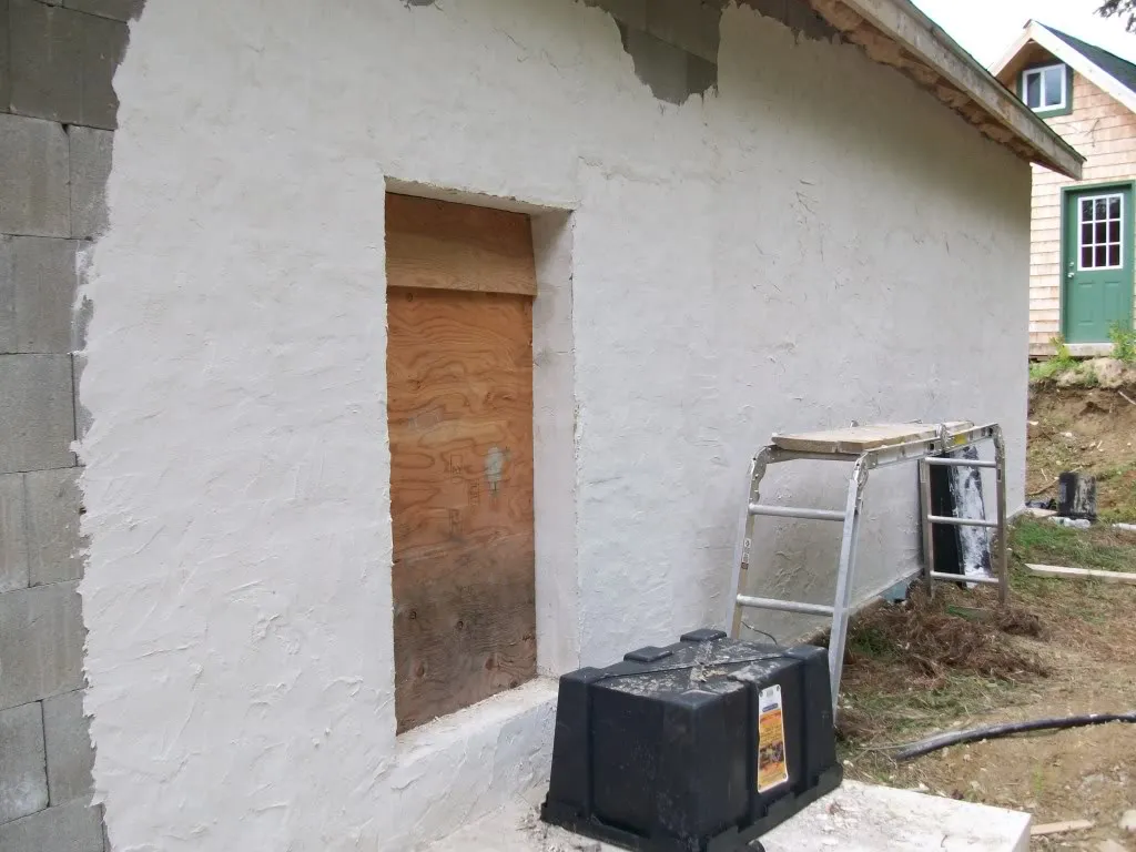

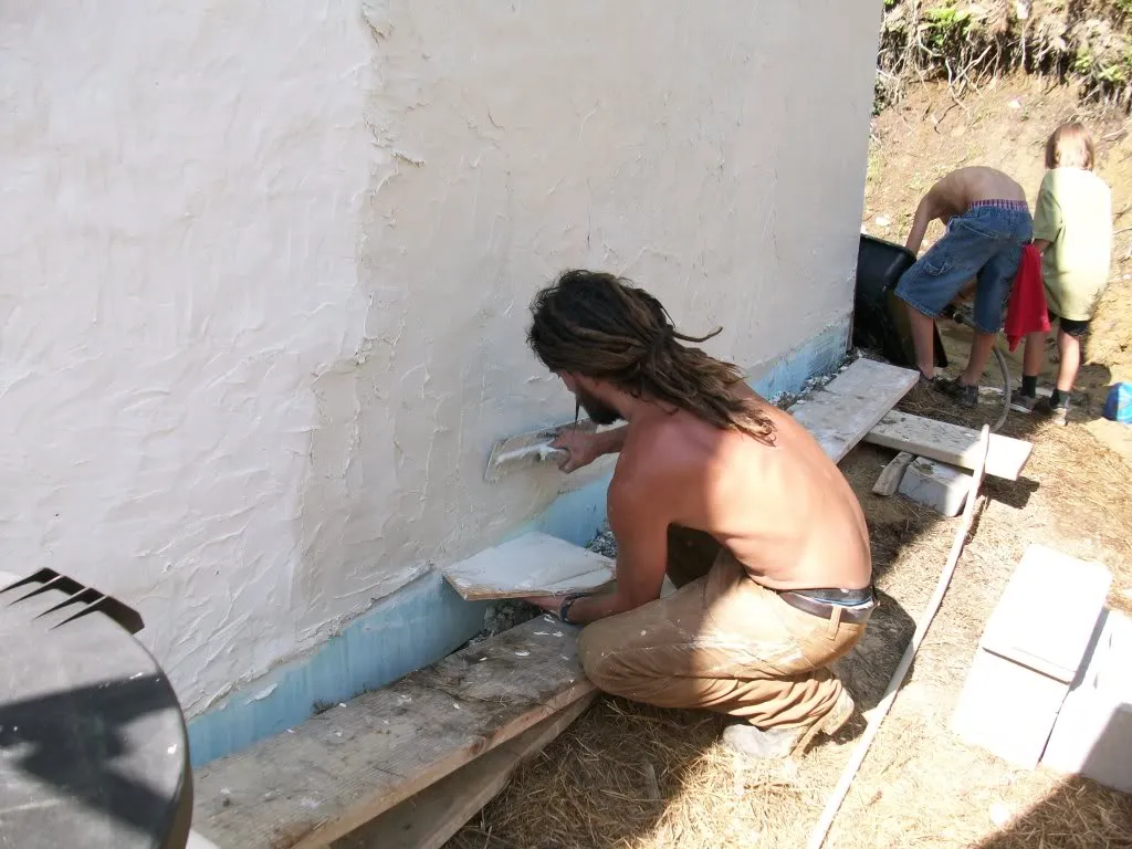

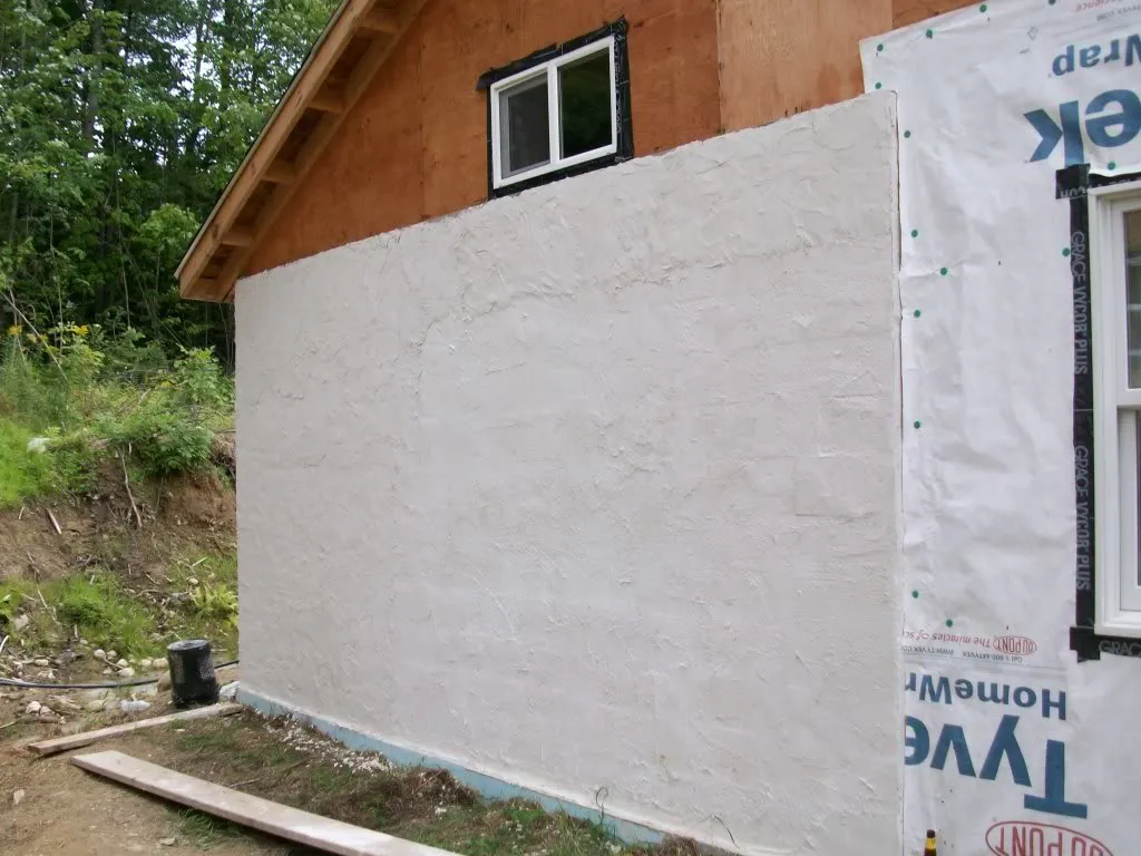

I've been doing a lot of thinking on the subject, especially regarding the root cellar I have. Thats what definitely makes things different for me. I also have some bad news. My job is laying me off in 3 weeks. Ok so here are pics from this past weekend. I had my friends ( who coincidentally built their own strawbale house ) come and help me parge the remaining part of the back walls.
And heres how it looks now.

Sorry to hear about the job BK. At least you are building a homestead that you can heat with wood, get free water from your spring, and grow a good deal of your food.  The progress looks good, I'm looking forward to the backfilling etc.

Nice job on the parging!  Woot , I'm sure you will party when the final SBC is applied in the root cellar.  I'm sure those blocks are on the root cellar slab are temp, but just in case , make sure to put some 2" foam in between the wall of house and the walls of the root cellar.   Nice progress!!!

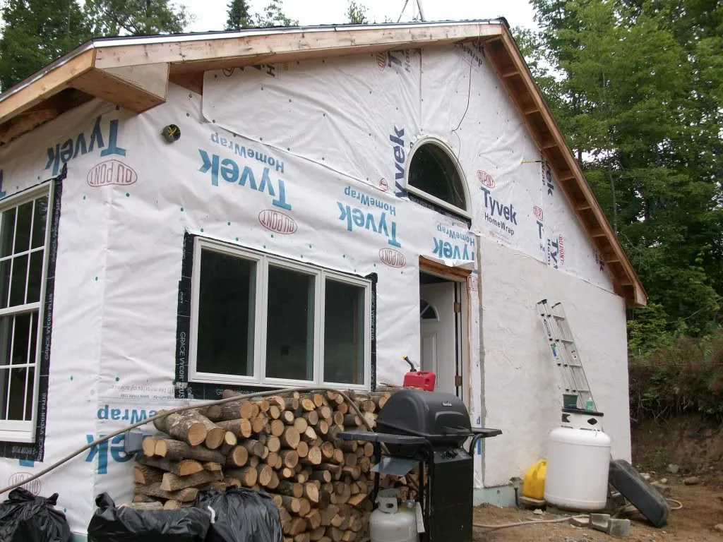

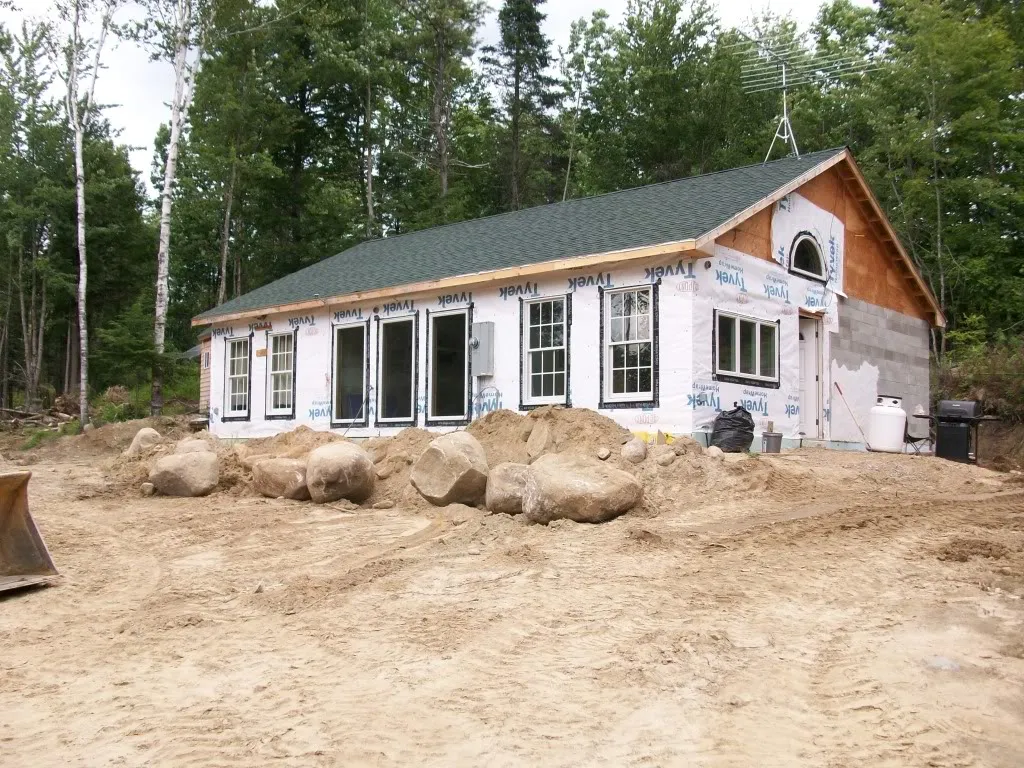

Finished the east side Tyvek

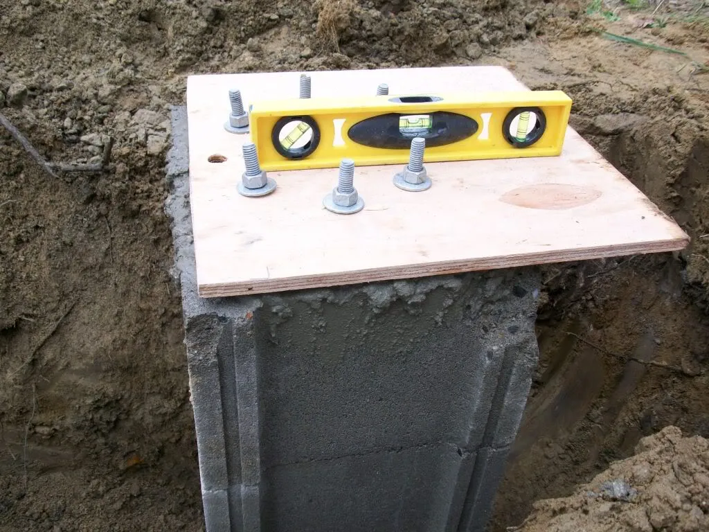

Built a cement foundation pillar for my solar panel mount
Sanded and spray painted black the solar panel mount. It was originally a gas station sign post.

I noticed you took down that one pic.  It might just be me but it looks like you forgot the 2 inches of insulation between the root cellar wall and the house.  I think what you see happening is that the root cellar will maintain a temp closer to your house temp.
To fix that wall if you want shim the 2nd course of drystack , or re-morter, or if it doesn't bother you I'm sure it will be strong and it adds character  8)
