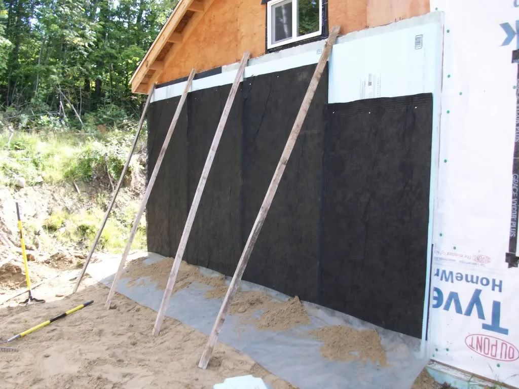

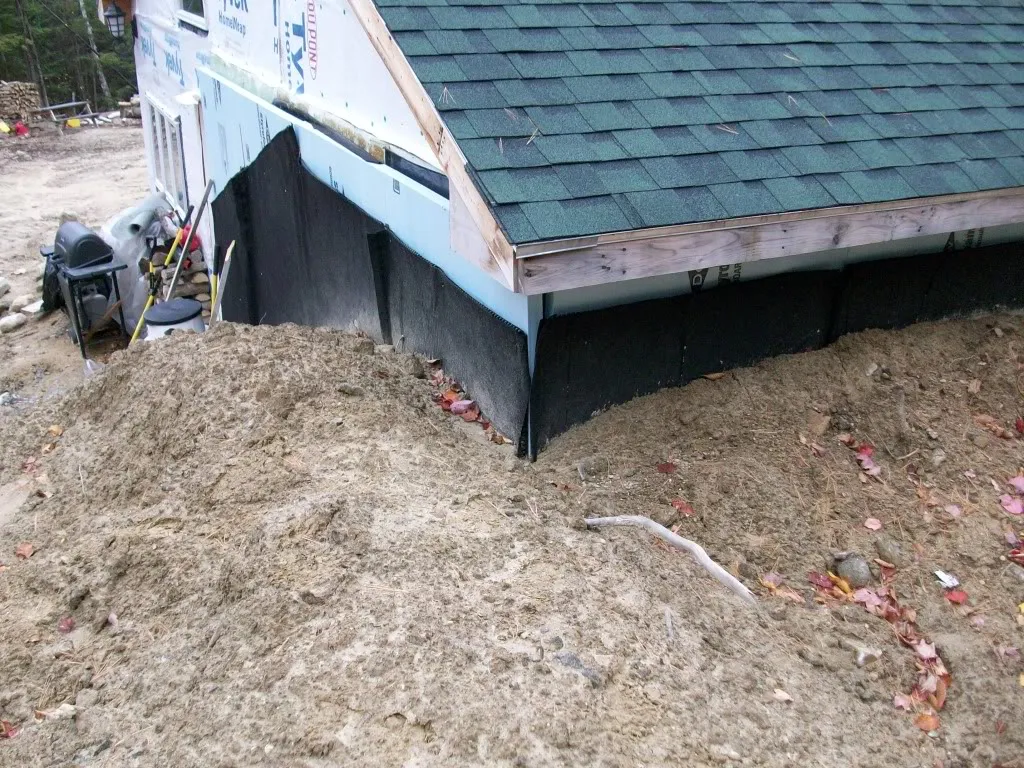

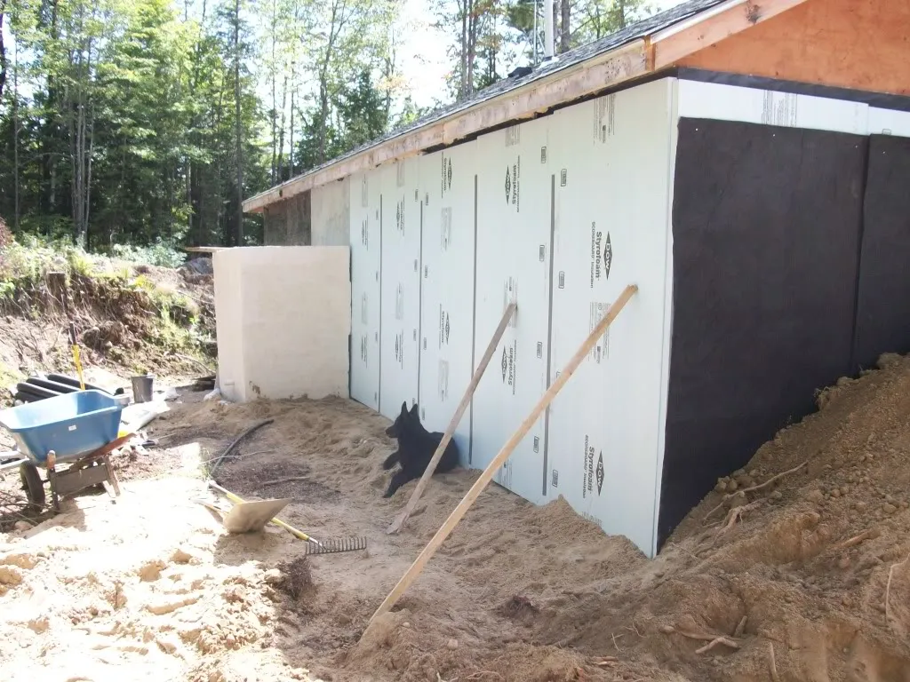

I primed the walls with CCW 702 Primer. I used about 4 out of the 5 gallons to coat my entire back wall. The primer is basically model airplane glue. If you've ever used that stuff, you know it is horrible stuff to smell and breath in and everything it gets on it including hands is hard to get off. After it was allowed to dry 1 hr, the CCW MiraDRI 860 binded to the wall beautifully, almost too well. My friend helped me attach the first sheet at the top of the wall and then he pulled off the wax paper as I stuck it to the wall, but after 2 sheets, it was easy enough to do myself and it was more productive with him measuring and cutting the sheets while I hung them. Laying and cutting it with a T-square is my recommendation for that crucial 90 degree cut which determines that the 2" overlap will not stray.
I also want to note that saturday night, it got down to 45 degrees outside, but stayed 65 degrees inside....very comfortable. And once the back wall is bermed, it should be even better.
Jeff: I fixed the block on the root cellar so a 2" piece will fit between it.  ;D
Working until when we got up until 3pm, we got almost the whole back wrapped except for the root cellar and one sliver on the west side.

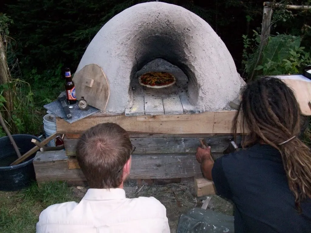

My friend Joe had a party to test out his new cob firebrick oven. We made some delicious pizzas and enjoyed a few coronas. Almost all the ingredients were handmade and came from gardens or scratch ( including the mozzerella ). I will probably have to make one of these as well. The pizzas cooked incredibly fast in there.

Just wondering If you only went with the block wall on the east and west sides half way, do to cost or some other reason? I have my block walls along the full west and east sides in my plans, and wanted to make sure I'm not missing anything?
Bishop I have never used CCW MiraDRI 860 is it something similar to ice guard ( Self adhesive rubber based waterproofing).  I was just wondering when I saw the installation procedures that you are using it in verticle strips rather than horizontal lap over style.  I have used a good bit of Ice & storn guard on roofs and it was always recommended to start at the bottom and climb to the top to guarantee it did not leak.  Don't mind me I just get this way sometimes. [waiting]

That sounds cool man. Cant wait to see you and lister get started on your projects. Yes, I went only half way to bring in more light around the house. I didn't want a tunnel feeling. Many of my early pics in pages 3-8 show the block wall going up in great detail. You'll see I used tapcon screws with PT lumber to connect to the block wall on the east and west sides.

Yes, its exactly like Grace I&W shield. This was the recommended install procedure by Rob Roy in his book "Earth Sheltered Homes", he still stands by this install method and actually so does CCW as their white sheets back this method as well. The seam is very tight. The bitumene material is VERY sticky and bonds well to itself. I also have MiraDRAIN being installed over the insulation in the next phase. The MiraDRI is the last line of defense.

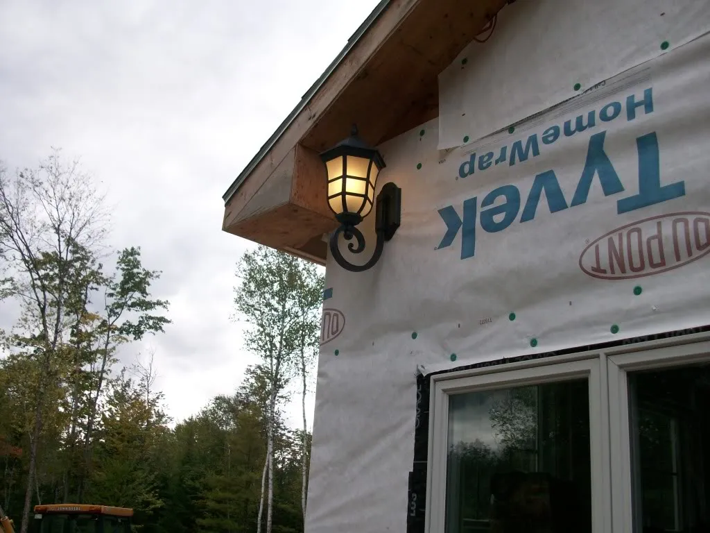

this light is run off my solar array at 120v, i want to convert it to 12v, its on the todo

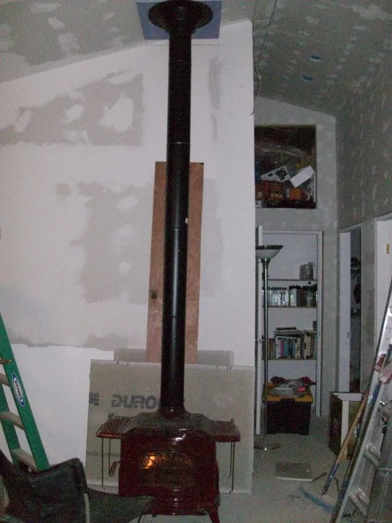

my stove pipe after being installed, I still need to do the back wall plate but i have some stuff protecting the wall for now. the whole install came out pro, i did it myself.

Looking good.  I really love that red wood stove.

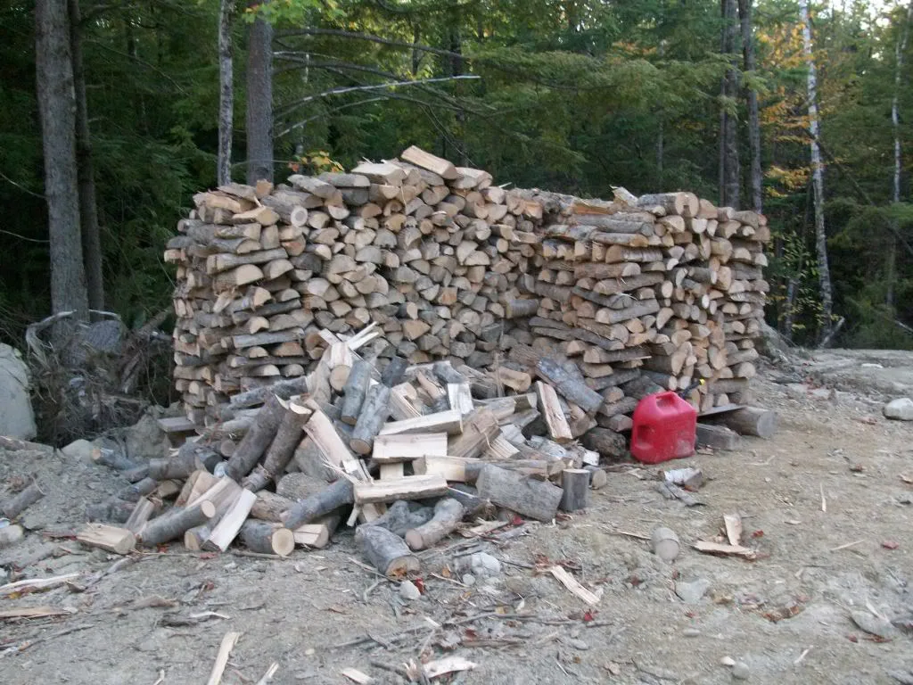

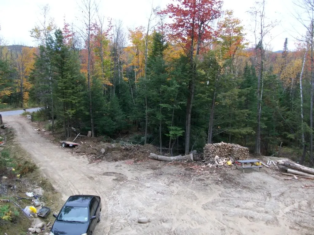

Last week I cut & split about 4-6 cord of hardwood ( ash, birch & maple ). It had been cut last spring. I'm glad this task is over!

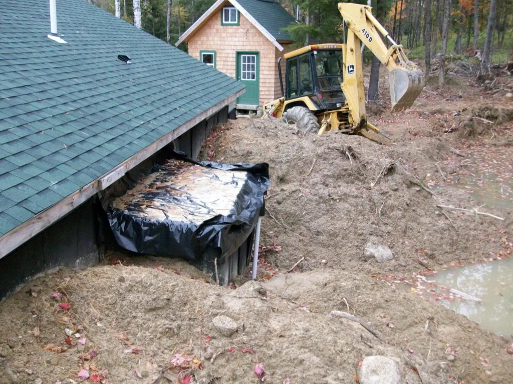

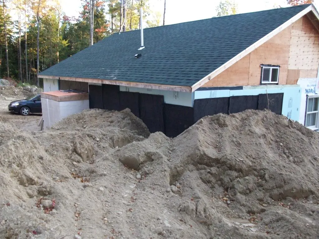

Got behind the house and started berming the west side

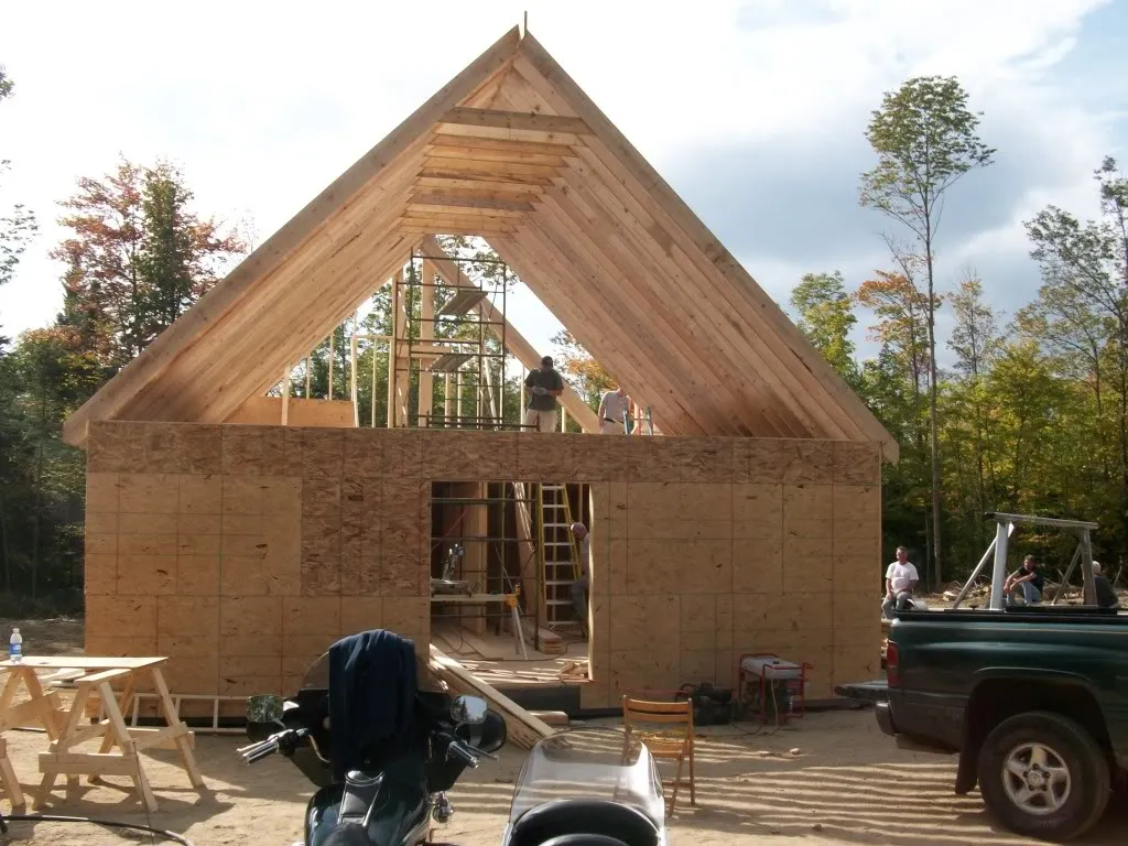

My new next door neighbor is building a house. 32x28, hes going to do all pine boards inside

It is so exciting to see the berm hitting the house! :)

Progress of the berm.
