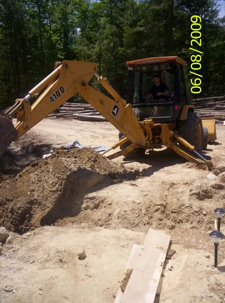

I also fixed my backhoe last weekend. One pic is of diagnosing the leak and other is me feeling proud of fixing this myself, lol. My first semi-major repair. It only cost $75 to replace the hose

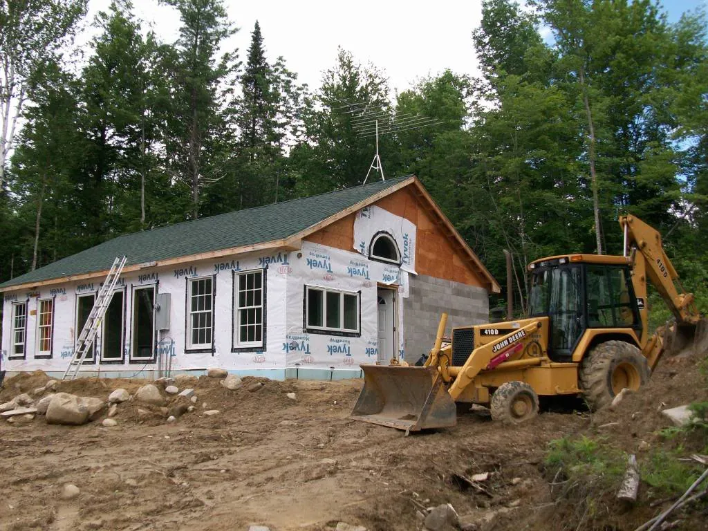

Here's my new ginormous UHF 60 mile range antenna mounted to the roof with a tripod mount. I ordered it from www.solidsignal.com because they had the cheapest prices I could find. The antenna is a Winegard and is VHF only. I chose VHF and not a UHF/VHF combo because the channels I wanted were in the lower frequencies and it was more expensive for the combo units. For the mount, mast and antenna, it was around $100.

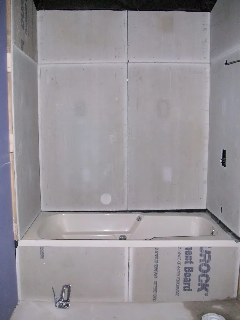

Here's the tub surround done in Durock. I'm going to tile it, but I'm not sure with what yet.

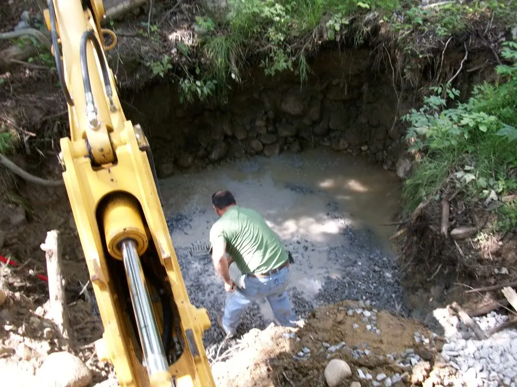

Pics!

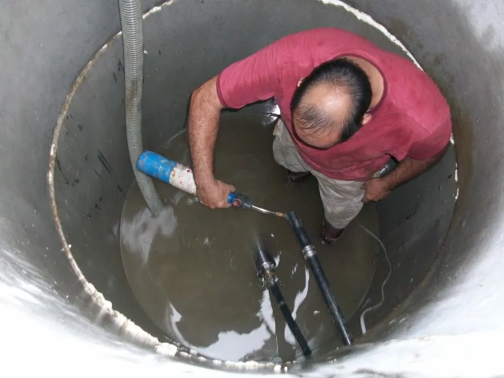

installing the water line and power into the well tile. I need to backfill around it more to raise the water line inside.

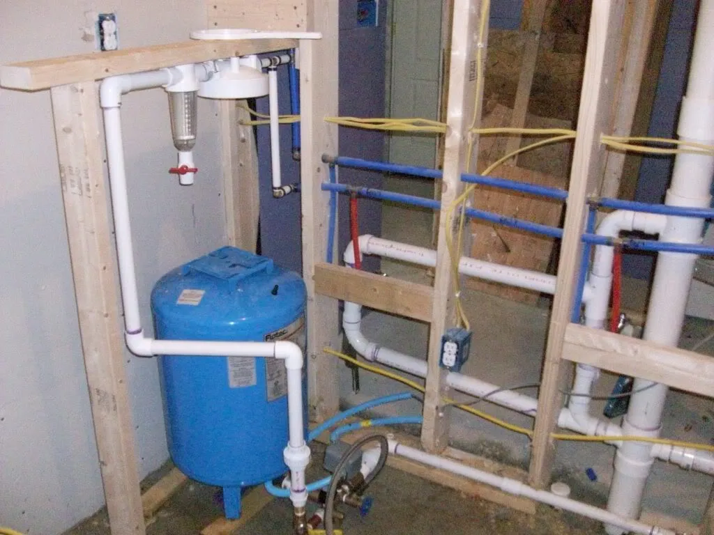

Rock installed up to the brass shutoff and I installed the 1" PVC, filters and white pex connections in 3/4". Unfortunately I could not pressure test because I lost the O-ring for the whirlpool house filter. When I get my water heater setup, I'll re-route the line that points down after the filter to it.

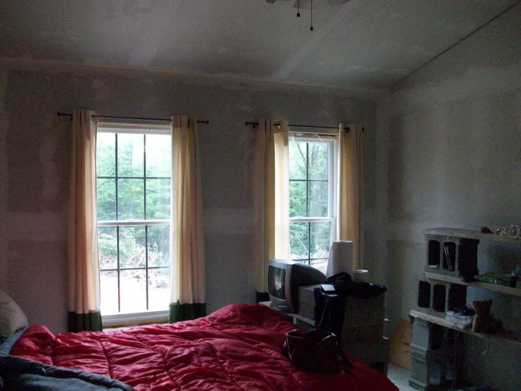

I put up some drapes to make the bedroom look nicer

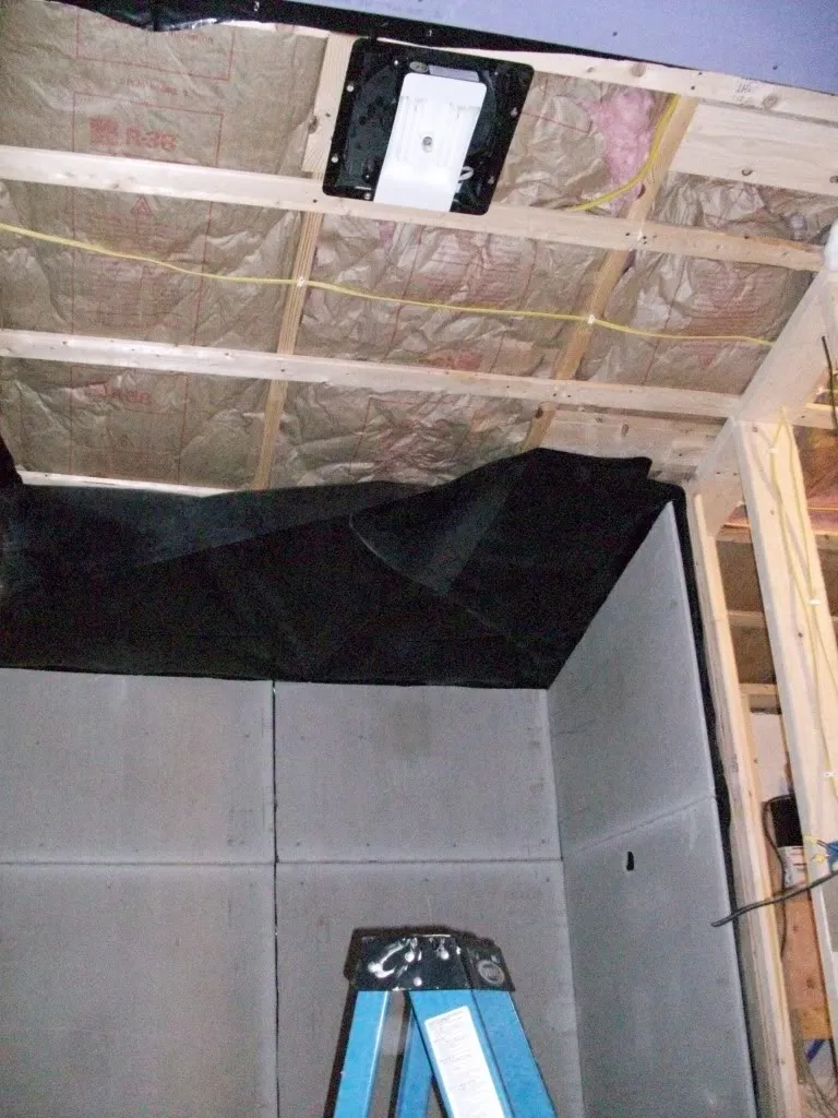

I installed the bathroom roof vent and tubing, then covered the inside back up with insulation.

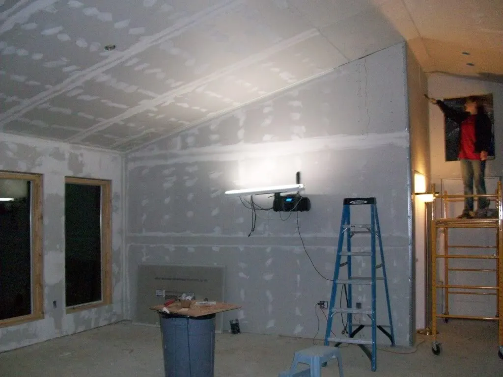

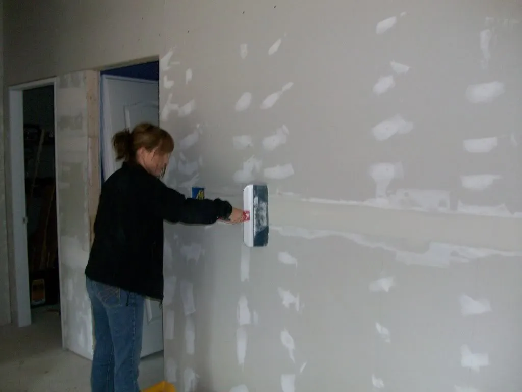

The living room drywall is progressing. We're doing it ourselves to save money. Its the fallback project.

I have a sediment spin down pre-filter and then a whole house 25 micron filter by Whirlpool. Both sold at Lowes. Word is, you never have to replace the sediment filters, just clean and rinse them. The whole house filter only lasts 6 months.
Special notes: I used a 1"Male to 3/4" pex zurn brass connector on the house filter outlet, then branched to a 3/4" T for hot and cold. I'm no plumber but I recommend 1" unions on both sides of the pressure tank inlet and outlets incase you have a bladder failure in the future. Lastly, don't be shy with the teflon tape, I usually make about 6 revolutions around a thread.
