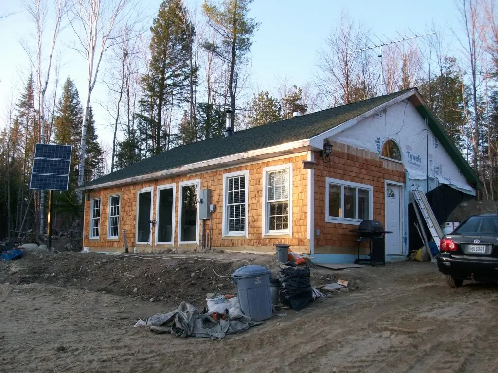

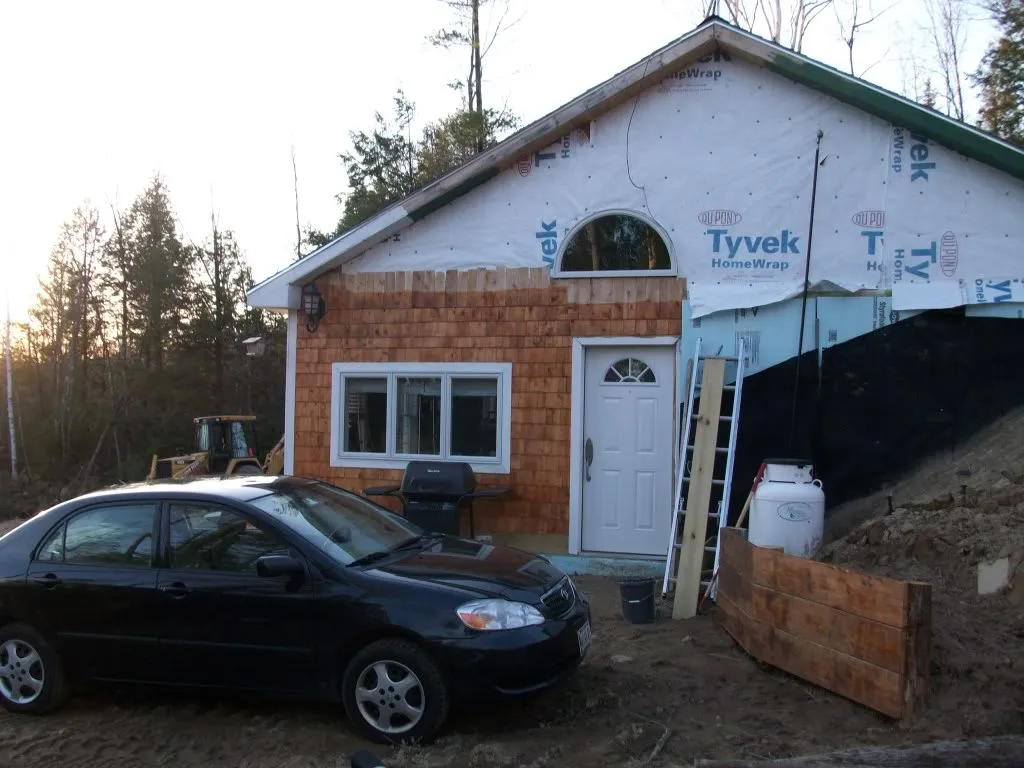

I worked on shingling the house this past weekend.
If anyone knows where I can find cheap stick on window panes. I'd like to get some for the middle 3 windows so they also have a colonial look like the outer 4 in the front.

white plastic and silicone.

That looks freakin' sweet.  I love the cedar shakes, Deb and I were wondering how you were going to finish it ..... a bit of work to install but worth it.  Nice pics :)
Glad to see your making some real good progress.

Are those undercourse shingles BK?  Make sure to get a finish on them soon, because they curl and split pretty quickly if you don't.
Nice work!
For the windows you might start with just adding the middle horizontal bars. That would tie the front together without getting too fussy.

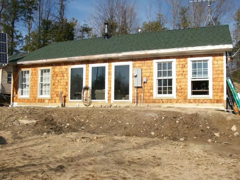

Some progress on the cedar shake shingling. I'm applying Cabot Cedar Naturaltone stain/protectant.

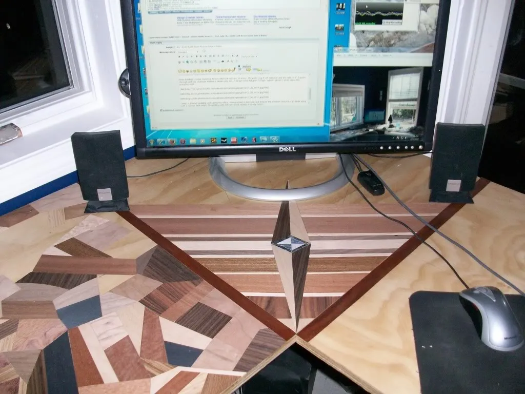

Lastly, I finished mudding and taping the office. Then painted it dark blue and finished the windows and put in 2" blinds along with a custom desk which I'm finishing with leftover wood vaneers from my fathers business.
 [cool].  But I get dizzy enough looking at the screen and that countertop would really mess me up.

Nice desk work

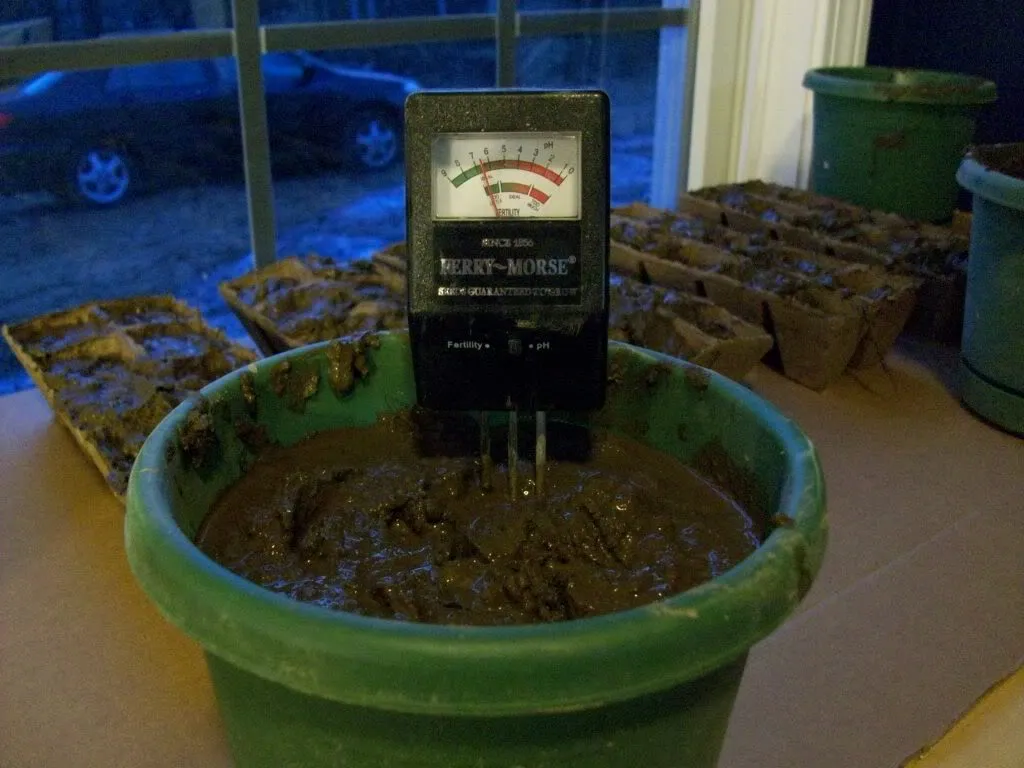

Having picked up a PH soil tester, some composted manure and limestone earlier, we put it to use this afternoon. We fixed the soil PH so it was about 6.5 with decent fertility.We have this book, Gardening in hard times http://www.amazon.com/Gardening-When-Counts-Growing-Mother/dp/086571553X and have been trying to follow it. This being our first year of serious gardening, we're going to try growing the hardier crops first like peas, radish, onion, spinach, cabbage and swiss chard and lettuce romaine first.
We're starting them inside for now, our soil meets the PH for all of them.

Nice job on the desk too.. It looks awesome.  We have a similar idea using shale pieces to make designs.  We have some with a rose color, some blue, some grey.  they will look really cool in a mosiaic like you did .

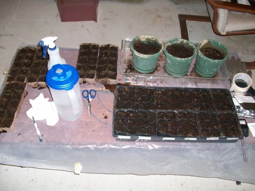

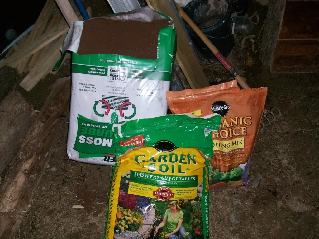

I'm checking out those videos. About the prior photos, actually, I tossed out that first iteration of soil and seed. It hardened up WAY too fast without soil aeration. I bought and mixed equal parts miracle grow garden soil and peat moss for the 2nd initial seedling starting, lol.
This one should go perfect because I felt around the soil consistency of all the pre-started vegetable plants at Lowes.

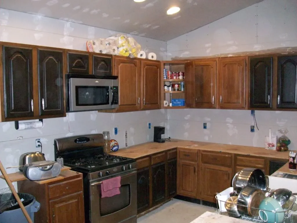

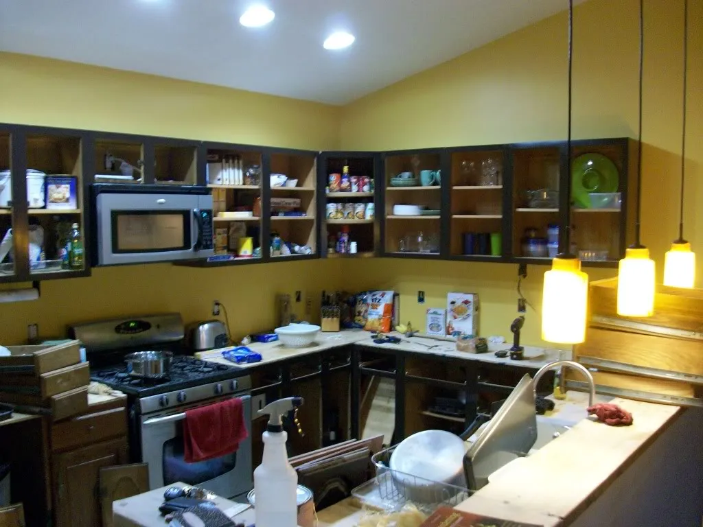

Last 2 days I've been working on the kitchen, and while this is just an 'in-progress' pic, it will give an idea of how painting the mismatching cabinets one color really brings them alive. Also, the 3 pendant lights are new as well. I have some crown molding I'm going to install also. Hopefully it looks good when I'm done.
This is how the cabinets looked before just a few months ago.

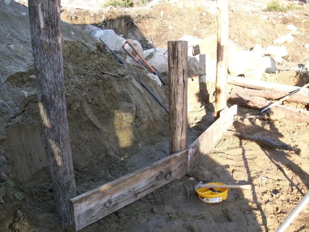

Way back on page two, you show a form box for your showers P-trap. I am wondering why/how is it ok to leave bare ground exposed like that. ??? ???

I later filled the box with some concrete I mixed up just as a precaution but in Rob Roys book, Earth Sheltered Homes, I don't recall him mentioning it has to be a sealed box as long as you are building on a well drained, frost proof foundation or pad.

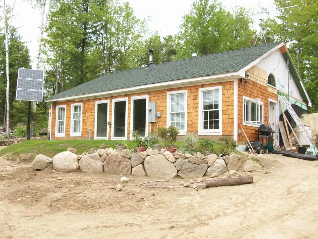

Been working on landscaping the front yard. Lots of blood, sweat and tears. Rocks tossed, top soil raked, roots pulled and cut, brush hauled, logs sorted and stumps removed. Only 1/2 way there. You can also see my all-cedar 2-rail fence near the street. I'm half way done with that also.

Very nice BK!  We drove by your place on Sunday on our return from camp, my wife likes the rails you made. We have been looking at land in that area.
Keep it up!   [cool]

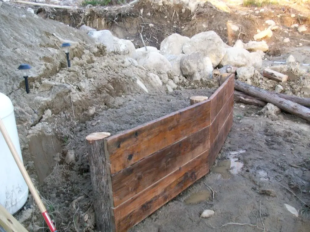

Raised bed is going well. Broccoli, Cabbage, Cauliflower from store. Beans, Spring Mix, Spinach and Sunflowers from seed.
