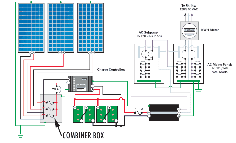

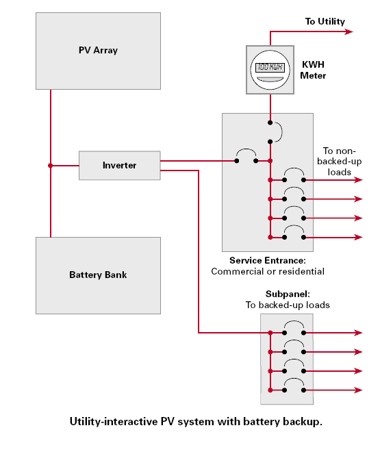

I subscribed to Homepower earlier this morning and got serious about expanding my PV knowledge. I took screenshots of 2 possible layouts ( from articles ) that I may use to achieve a grid-tied ESP ( emergency service power ) setup.
I have a question: In a grid-tied battery backup system, is 48vdc my primary option? And why?
I really like the combiner box in the bottom left of this diagram. I read that the junction boxes of solar panels are only rated for 7amps each. If you daisy chain 3+ panels in a row, the wire is not rated to hold that current and may potentially fry the panel or drop amps.
These are not what I'm using, just screenshots of other peoples setups
This is similar version from a different homepower article.
That is why I question the "professionals" that appear as authorities on some of this stuff.
As voltage goes up, current goes down and smaller wires are required.
3 -12 volt 100 watt panels produce 300 watts at 12 volts parallel or 25 amps, but 3-100 watt panels daisy chained produce 300 watts at 36 volts or 8.3 amps.  Our 125 watt x 12 v panels are about 10.4 amps
One of our 135 watt solar panels at 17 volts produces 7.94 amps.  They are daisy chained - (series) in two panels and paralleled in two.  Amp - hence larger wire sizes are required for parallel - not series.
They will always have a safety factor in their wire.  I think that what they are saying may be BS.  Maybe they want to sell combiner boxes.  The new outback inverters will take several daisy chained panels and the Grundfos pump we daisychained many panels together.
The bottom picture - while maybe a generalization, would lead you to believe that the batteries don't require a regulator - I wonder if that is really the case - doesn't seem it could be as possibly if it is sent to the grid things may be OK, but when the grid is down the batteries would get all of the power and be destroyed without regulation.
I think the reader has to already understand what these "pros" are saying to safely use their information.
Re: the first drawing. Connecting the panels in parallel like that is not wise, IMO. Connect them in series. HOWEVER to do that you need the right charge controller. The less expensive controllers may not be able to handle the voltage resulting from the series connection.
Also, that setup as drawn might have another problem DEPENDING on the panel being used. If the panels were of the nominal 12 VDC output variety, connected in parallel, using a typical low budget charge controller, on a cloudy day they may not be capable of putting out enough volts to actually get a charge into the batteries. (Seems like the batteries are wired for 12 VDC)
PV panel output voltages range all over the place, 12 to 50 VDC and even higher.
Are you planning to be grid tied? If so check with the power company to see what they allow. As well they may have a list of equipment that they authorize; it may not include everything out there in the marketplace.
Here in NM until a few years ago the power company did not allow grid tied PV systems to have a battery backup system. Now they do allow that but there must be an exterior manual transfer switch so the power company crew can disconnect or isolate the battery / inverter section from the system. This ensures the crew won't get zapped by the backup if the crew is working on the power grid side. Outside and not locked; they must be able to visually verify the circuit is broken.
I don't think either of those drawings are totally accurate. They don't show an AC disconnect or transfer switch. No DC fuses or breakers between the inverter and batteries. And as noted no charge controller in the second simplified system. (no neutral or grounds)
I question the value of drawings and information that are simplified enough to be dangerous.  That was a problem I had with Backwoods Home magazine also.
