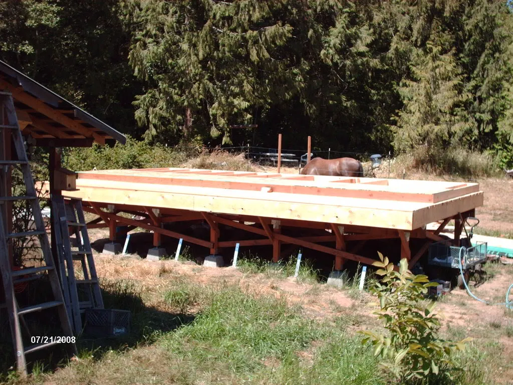

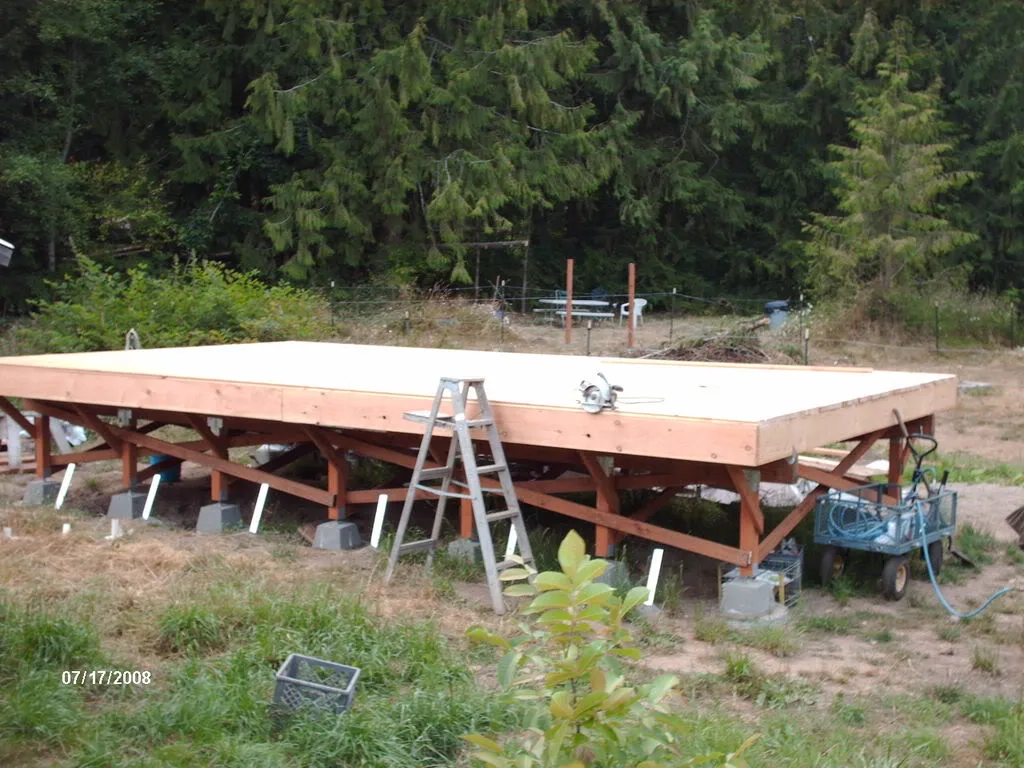

I bought the T&G in early May.  I've had to keep it covered, but am going to change the covering method to increase air flow now that the weather is getting a little better.   I still have the T's fitted into the G's because I'm a little concerned about warpage.  I like the sticker idea....maybe keep each layer "spooned", but seperate them with stickers...hmmmm.
The 2 x 10's I purchased at the same time wasted no time in becoming works of modern art the moment I unstacked them.
The good news was that they were floor joists, and I didn't have to fit tongues in grooves.  But I learned about quick release C clamps and my grandpa's block and tackle to get them to hold still in the right place long enough to nail them down firmly.   Thought I could only use that block and tackle for lifting things....
considerations I pre-finished my T&G because with the 4X8 beams there was no way I could get a good job done between them on the ceiling.  In doing so they lost their original shape.  I borrowed a ratcheting pry bar that has two pegs that fit over the joist(beam in my case) and a bearing that is off centered and a handle.  Sort of canterlever style. In fact they actually sell  one and call it of all things a " board stretcher" .  Mine was homemade.  Had a hard time to keep it from maring the beams so I ended up using 4 & 5' bar clamps.  Once I got the first piece on the side I just kept going back and using it as an anchor then pulled each new board together to the previously attached on.  When I ran out of pipe(bar) I would add another clamp to that one.  I had three hooked together at once to reach the last couple of pieces. If you don't own any it is a good investment. Just buy the end clamp pieces and make them out of 3/4" pipe whatever length you want.
I also found out that you cannot use a standard flooring nailer as they are meant for 3/4" flooring and the nails are 1. Not long enough 2. Do not position the nail in the right angle.  So I ended up using 2-1/2 & 3" deck screws. 2 per beam.

Got the T&G done.  Time to buckle down and figure out the walls.
