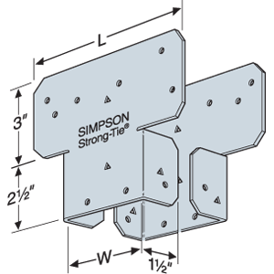

Question 2 - are the usual stamped sheet metal brackets for connecting 4 x 4's sufficient for connecting the top of the posts to the beams, or should they be as hefty as the ones at the bottom of the posts?  Do these get bolted as well ( I plan to set the beams on top of the posts, not try to bolt them to the sides of the beams.)
  AC44Z
Question 3 - I don't know where the log trucks around here go with all those trees, but most of the local lumber comes from Canada. So, faced with a 14 day wait, and the obvious weight of 24' PT 4 x 8's, I got 4 12's instead of 2 24's for the beams.
That's why there are 14 piers, one for dead center under the butted up ends of the 12' 4 x 8's
Is there any thing I need to do to secure those butted up ends?   The bolt hole in the bracket (it is centered just like the butted ends) won't connect them, can I just nail through the little holes in the bracket?  does it matter?
  The AC44Z will work at the bottom , you could add a flat gussett / strap  plates like these ST22Z

#28
 Yes , all post top one each side. They sell another that more of a PITA to use , you set it on the post and the beam drops into it so it's two sided sort of . More trouble than they are worth.
The straps would go only on your beam splice , one each side about 1" down from the top edge , so the "long way" to hold the beams to each other. The strap in the photo is just shown vertical , it can be used either way , or bent up and over for a DIFFERNT application.
  There's much debate on the new ACQ lumber corroding even the ZMAX stuff, copper / dissimilar metals type corrosion. The barrier separates the two metals. The one being in the wood. The copper is IN the wood the PT-ment.
  Or use Stainless steel hardware , we don't do it , If it was my business I think I would , I'd just add it to the cost of the job, as S/S is more $$$.

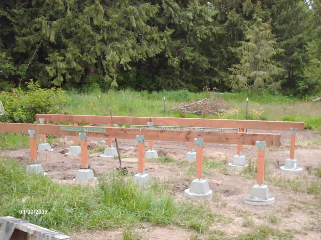

Pushing and rolling that concrete made for an interesting day.  The weather was beautiful. I noticed some folk on this forum saw snow and winter like weather.
Our summers are short, but glorious for the brief time they visit.  This was one of those days.  Stareted with an eagle lumbering overhead, then the Canadian geese in formation, strawberries and newly transplanted iris blooming, a tiny lilac making its first blossoms....wow, except for the aching muscles in places I will not mention, it doesn't get much better than this.
An hour here, an hour there.
Willy

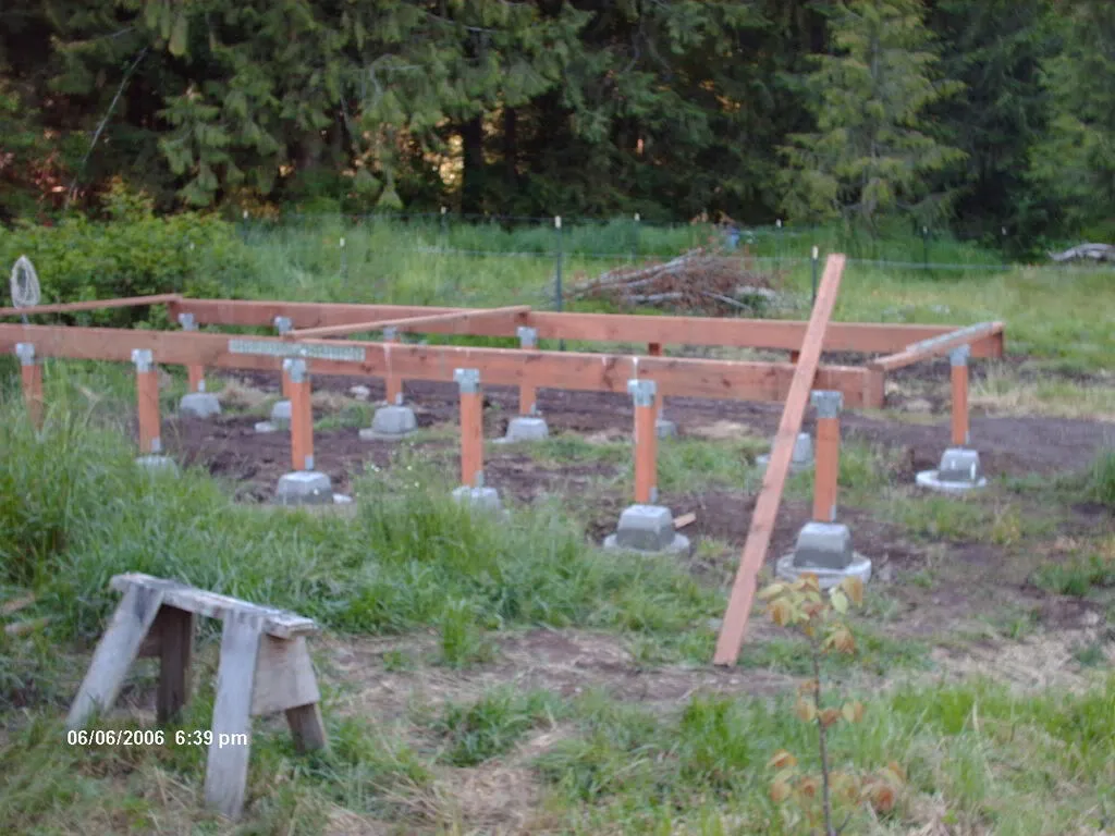

Looks great so far. If it was me doing it I would nail a X of wood on each pier from side to side to keep the posts straite and solid. If you nailed a board at the bottom near the pier block and went accross to the other post and nailed it just below the beam and on the other side of the post reverse it this will keep them from moving. Do this to all the posts it will keep them straite and make putting the floor joists up much easier with out the beams moving around. This would be done between the beams. The beams will hold the posts straite from end to end. Mark
Thanks Willy, I'm planning on it.
I saw a similar conversation about cross bracing elsewhere on these forums, and have the lumber for it.  When I put the first beam up, I found that even though the piers were level, some were not in exactly the right place, and had to do some "scooting" to get the posts directly under the beam, so they would stand exactly vertical.
I think that getting the one beam on made me get those piers in the proper place, and that now I can use those piers as "points of reference" to fine tune the placement of the opposite piers.
That should assure that a cross brace will squarely match up to a post under the other beam.
This is my first "house", and I'm really banking on forum members looking at the pictures and sharing their experience to help me get this done safe and correctly.  For me, the real value of purchasing the plans lies in the forum support.
I was also planning on a couple of "X's" on the long sides as well.

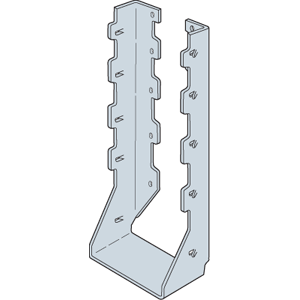

You double up the joists , or add a doubled up joist , under that closet wall and the wall by where you show that trunk at the foot of the bed.
Those double joist run the full width of the building.
At the "head" / top of the stairs you hang a doubled up "stairwell header" between those two doubled up full width joist , use double 2x hangers , you can order a "hidden" flange type for the one at the head of the stairs so it won't interfere with stairwell trim.
A HUSC you may need to add a 1/2" ply layer between as finding a double (net 3" HUSC ) could be a bigger issue than a net 3 1/2" hanger, no big deal better really in many ways for those double beams to be net 3 1/2".
  You can hang that angled stairwell joist , it should be a double as well off the "header" and the other cross beam with  skewed hangers .
Those other "open to below" areas all add dollars / time / hardware. They can be done , they just cost more.

I've read what you said a couple time, and I get most of it, but, what is a HUSC?

#1 : I saw that later when I reviewed the earlier posts on your thread. It's hard to keep track of all the different buildings and who doing what .
#2: The hanger I posted is a HUSC , http://www.strongtie.com/products/strongwall/wood-strongwall/husc-hucq.asp
Follow that link to the Simpson site.
#3: All those catwalks cost money , but thats why boxy is cheap-------er , not really cheap.

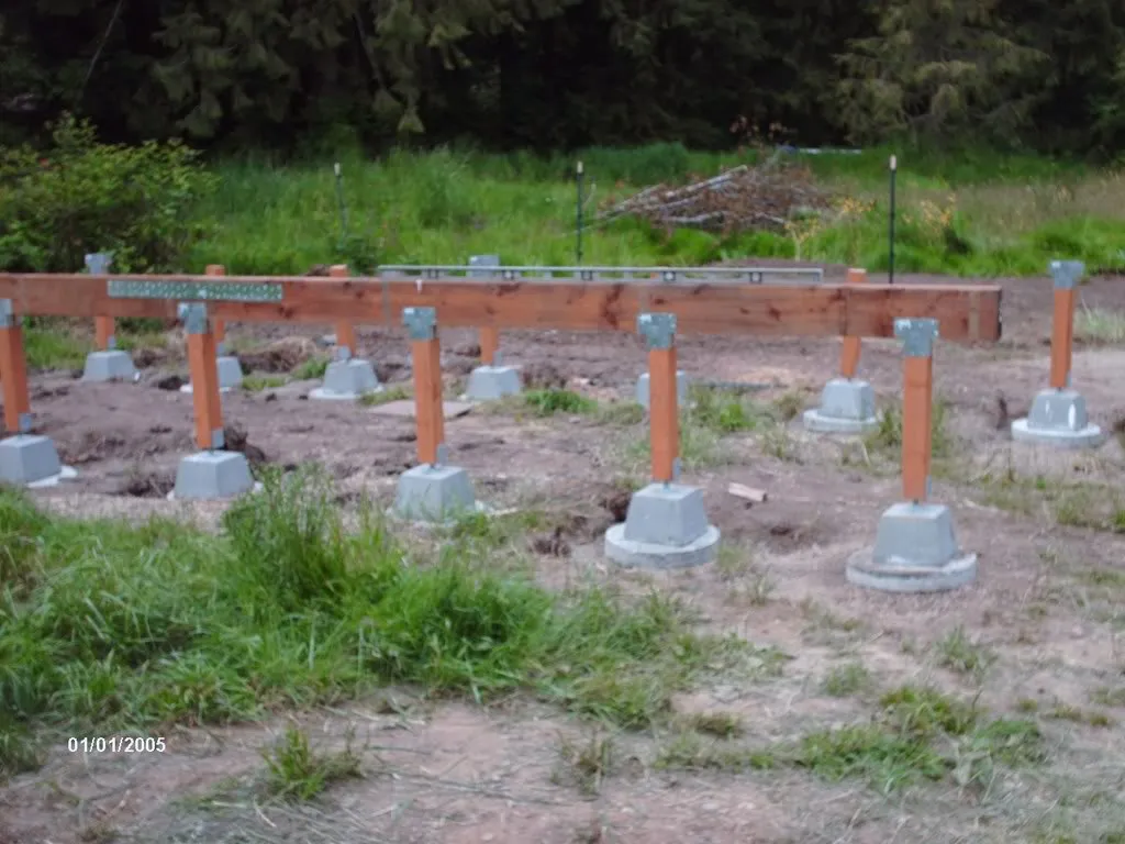

I haven't given up. I'll probably spend another day to get it right.  I have exactly the same distance between the nails in those temporary 2 x 4's between the beams, and they are exactly the same distance apart.  I have a laser level, a 6 foot level and a 4 foot level.  Right now the diagonal measurements are 178 and 181"'s on the first 12' section of the beams.  So I'm not square yet.  Looked good until I started measuring the diagonals....but I started at 186 and 179, so progress is being made.  I just keep walking around and tapping each pier in the right direction and it is gradually giving in.
When all the diagonals are right then I'l go back and make sure the piers are vertical again ( I have a handy dandy post level that shows both sides at the same time.
Then measure the diagonals again and start making any fine tuning to make the tops of the beams level again, if that has changed.
The rods supporting the posts are threaded, so I can make the vertical adjustments fairly easily.  Then comes the cross bracing.
I'll just keep measuring for square and level as I go because I can knock things out of kilter with a few hammer blows.
I have to agree with you all.  If I get this part right, the rest will be a lot easier.  So if it takes a whole day, it will take a whole day.

Whats you total beam length and the distance (outside to outside) of the beam? I can tell you what your  diagonal dimension should be.
Considerations, it sounds to me like you are dividing the length into sections and taking diagonal measurements off each one. If I interpret you correctly that is not the best way to proceed. Small errors in each section can add onto each other; of course it's possible that they could cancel out each other too, but you never know.
The best method would be to treat the beams as a whole unit. Make certain that each beam is the same length and the same distance apart and measure the two long diagonals. That would need a long steel tape; 50 footers and longer are available. I have a 50 and a 165 from Harbor Freight. For all I use them they'll last me a lifetime. Hmmm, I'm well past the half point...
When you get into lengths like that it becomes important to pull the tape tight for each measurement; they'll hang in a catenary curve if not pulled tight and affect your accuracy.
