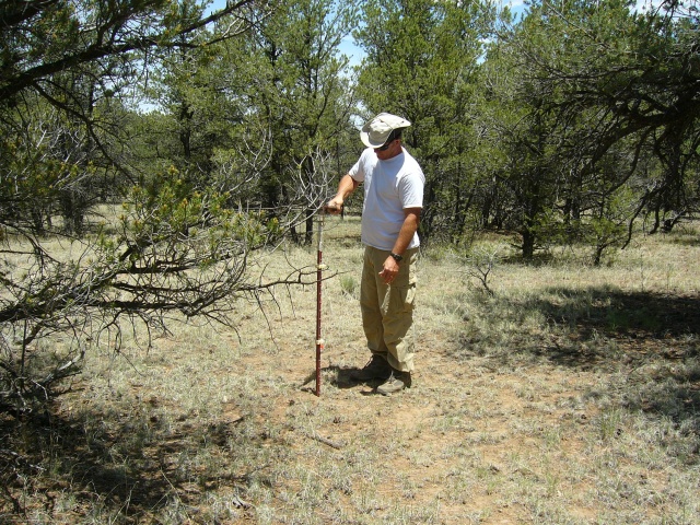

The well company provided free dowsing, and this is where the water is.  Apparently not one but two underground streams cross here.  Cute supervisor said to mark the spot with a better stake in case an elk ate the little flag, so:
I pounded one in with my bare hands.  Well, not really.  Then we had to get busy clearing out so the well rig could get in, so all hands were on deck chainsawing and pulling slash.

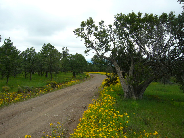

Looking good George! Glad to see the pictures. Lots of nice green grass along the road; what time of year was that? In the Jemez the grass will begin to brown soon unless it rains.
GunPilot
#4
QuoteLooking good George! Glad to see the pictures. Lots of nice green grass along the road; what time of year was that? In the Jemez the grass will begin to brown soon unless it rains.
That was early last September after the heavy monsoons.  The creek was running good and everything was green.  The other photos were taken in November or just this past week.

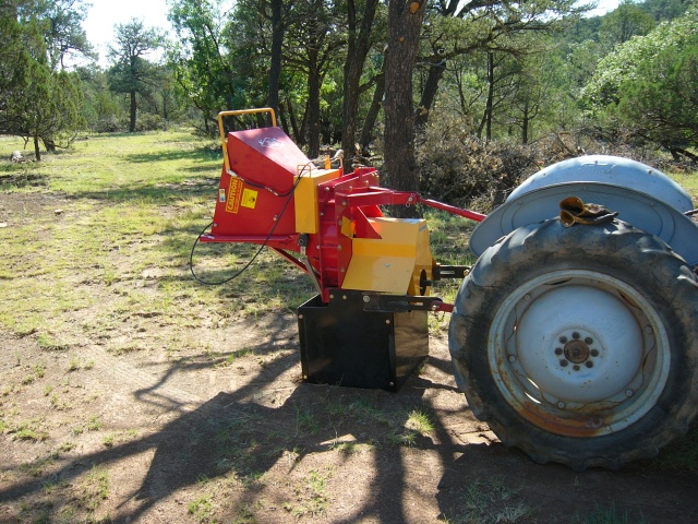

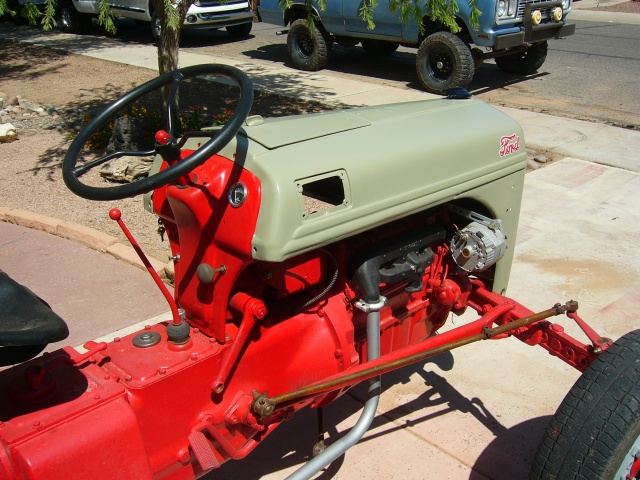

I did manage to get back up to the homestead this weekend.  We carried Frankenstein (Frankie) the Funk with its brand new, just out of the crate, Better Than Jinma 6" chipper.
Frankie is an interesting tractor.  Made in 1950 as an 8N, he was modified, probably at the dealer, with a Funk conversion.  This replaced the 24-hp flathead 4 with a 95 (alleged) hp flathead 6. More info on the Funks for the interested or bored can be found Here.
Frankie hasn't had much TLC in his lifetime but everything still works.  The thing around him that looks like an explosion in a pipe factory is in fact a Wagner loader from the same time period.  More about the Wagner loaders for the interested, etc, here.  Why am I messing with this antique equipment, you may ask?  Well, I could go on about old-school methods and reducing carbon footprints by not causing new tractors to be made or something, but the truth is, it was in my price range.  I could probably make money on Frankie with nothing more than an aerosol overhaul, but as you may have noticed, I become attached to mechanical things, and give them names and worry if they are lonely or not.
The Better Than Jinma chipper is the result of intense internet research on Chinese chippers and the reading of many chipper threads in various tractor implement boards.  I found an outfit called Betst(Ebay store link) that claims to have designed the chipper that Jinma ultimately cloned.  Now there are clones of Jinmas too I guess.  At any rate, I talked to the guys at Betst and ordered the chipper from them.  It arrived Friday, two days ago.  I had hoped to have it test run a bit before hauling it to the ranchita, but no such luck.  We had to unpack it from the steel crate, assemble it, and hook it to Frankie to go on the trailer.
The chipper is supposed to work with tractors from 24 to 40 hp.  I guess nowadays 24 hp tractors are bigger than the 1950s 24hp tractors, because it was evident that the chipper was really close to the back of the tractor.  On a hunch I tried to install the PTO shaft and hit snag #1.  No way would that fit between the chipper and tractor.  It's now 3PM and we have a 7-hour drive to the ranchita... some ad hoc monkey fab was required...
The 3-point attachments on the chipper were welded to some C-channel that extended them about 7 inches to allow the PTO to fit comfortably in place.  In addition, the top link of the tractor was mercilessly sliced in two and extended 11 inches to let the chipper sit level.  Obviously the 8N is a smaller tractor than this was designed for.  Ultimately, the chipper was attached and the whole lash-up made it up to Rancho Perdido at about 2Am Saturday morning.

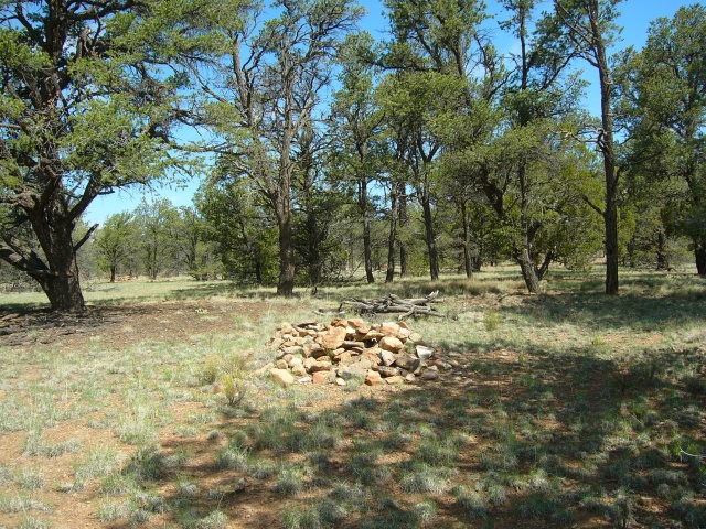

The whole point of this trip was to make some inroads on the monster slash piles that have been accumulating.  A couple of fine points: I've never run a chipper.  I've never even seen a chipper run.  This chipper has never been run before. I've never run Frankie before, except to load him on/off a trailer.  Plus I think I had a rock in my shoe.
A fun characteristic of the N is the non-live PTO and the fact that the hydraulics only work when the PTO is engaged.  That means if you want to raise the 3-point, the PTO has to be engaged. So what you say?  Well, the chipper manual strenuously warns against running the PTO with more than 15 degrees angle on it.  So if I pick the chipper up, the PTO has to run, and it will exceed 15 degrees angle by a lot.  So, bottom line, to move the chipper around, I have to take the PTO shaft off every time.  I guess some advances in the last 60 years, like live PTO and independent hydraulics have been worthwhile.  ;)
Co-located with the slash pile, PTO connected, I ran Frankie up.  It sure took a long time to get to the governed 2200 RPM spinning up the 135-lb flywheel.  Hmmm... maybe the fact that we are at 7800 feet has something to do with it.  Jetting is probably a mite rich too.  I'll have to Google the Bendix carb that's on it and see if I can figure out what is what on it.  Meanwhile, Frankie has smoothed out and it's time to see what a chipper does.
I fed it a branch about 3" in size.  It ate it, and chips came out.  Whoo hoo.  The Cute Supervisor took a picture.  Dominic is highly impressed, as he realized that dragging huge piles of slash is in his immediate future.  I fed some more branches. Some things came to light pretty quickly.
I think the 95-hp Funk is making about 18 or 20 horsepower.  The biggest piece of wood I fed was probably 3 1/2", and it all but killed the tractor.  I attribute the altitude, jetting, age of the tractor, and the fact that "95 hp" in those days was measured at the spark plug.
Power feed rocks.  I can't imagine trying to jam that stuff in there by hand alone.  Power feed is a must-have.  One attribute of the Betst machine is an improved power feed drive that kept breaking on the Jinma.

That looks like some of my projects, George.  I cobbled many things together while well drilling etc.  I recognized the 8N part right away.  The Funk part threw me a bit.
It looks like a great chipper.  Power feed is great.  I have one with a 318 Dodge powering it.  Its called a Chuck and Run.  No safety -- feeds by pulling the tree in with the massive rotating chipper wheel and whatever horsepower the old worn out Dodge can muster -- maybe 150 or so.  Anyway - it pulls the tree - and anything else tangled up in the tree right in in about 2 seconds.   I've thrown up to about a 6 inch Eucalyptus tapering out to about 25 feet long to see if I could kill it.  Almost did but not quite.
It is one of the ones that claims an unwary victim every so often.  Ground beef, anybody?

I was especially drawn in with the first pic you had of the 8N Ford tractor! It has to be
one of Ford's best ever products. I think they started building the 8N in 1948 or 49 and understand
they built several million of them They sold new for about $500 complete with some implements. You
can't buy one around here for less than $2500 today and a rebuilt one can run way on up there in price.
You can still buy new replacement parts at the Ford store in Ft Worth, I know, I've bought some.
Only thing I didn't like about the 8N was not having a live PTO as you pointed out in your thread.
Most all of them have now been converted to 12V electrical from the old 6V they came out with.
You just gotta love anything that is over 50 years old and the original mfgr still supplies parts.
Spent way too many hours on 8N's but, many fond memories!

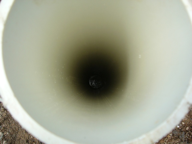

Dan and Greg cased the well with 5" PVC well casing.  This was followed by a gravel pack between the casing and the outer edge of the well.
Dan drilled the well on Tuesday and came back Wednesday morning to case it.  Looking in the hole, we were surprised to see the water close, very close.  Dan dropped a float tied to a string down in the well to measure the depth.  The water had filled up to within 24 feet of the top!
This is dry country, so it's pretty exciting to have 180 feet of water in a 200' hole out here.  It's also exciting because a dry hole costs exactly the same as a 5 gph hole does  ;)
