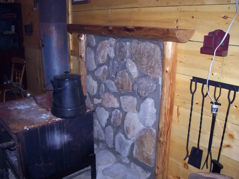

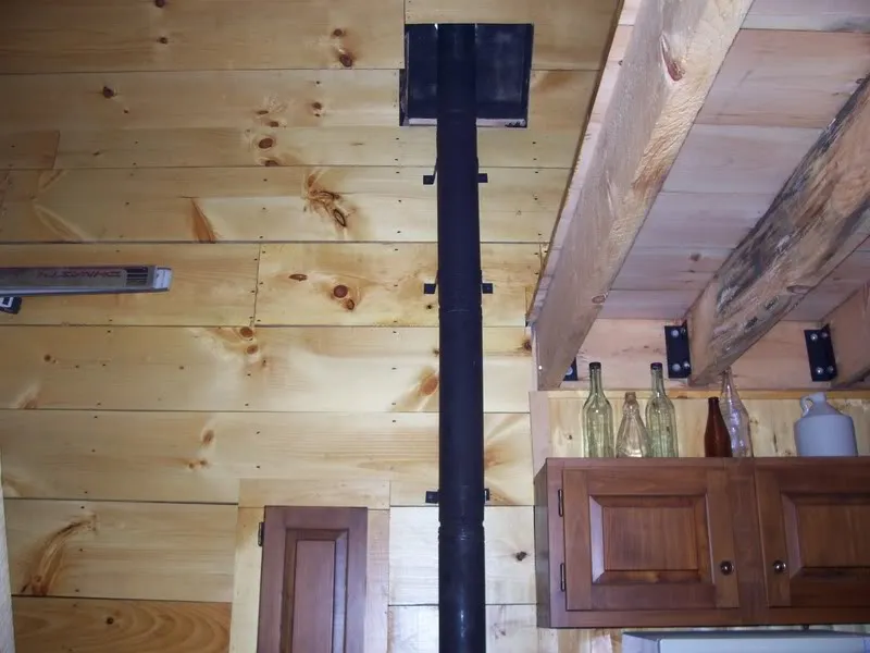

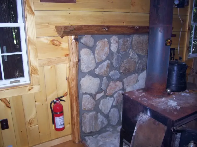

Well we got alot done Sunday and Monday .I  got my stone work done , We built our front steps and we put in the pipe for our stove heater

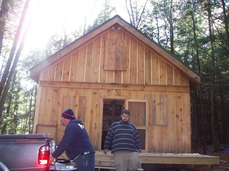

We i have not been posting because we have been just doing little things here and there. I did take a few pic's of  some of the front we got done this past weekend.

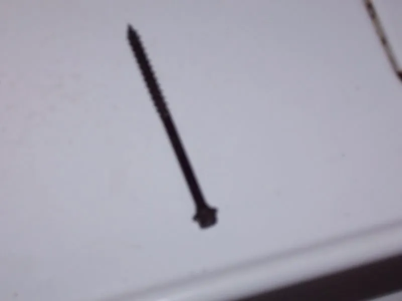

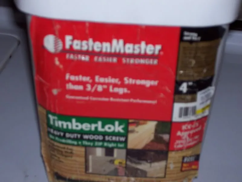

dmlsr
Ok i know what your talking about now.  Pic's are back on page 3.
We used timberlok screws.  Two at each stud. They are not cheap but work awsum.

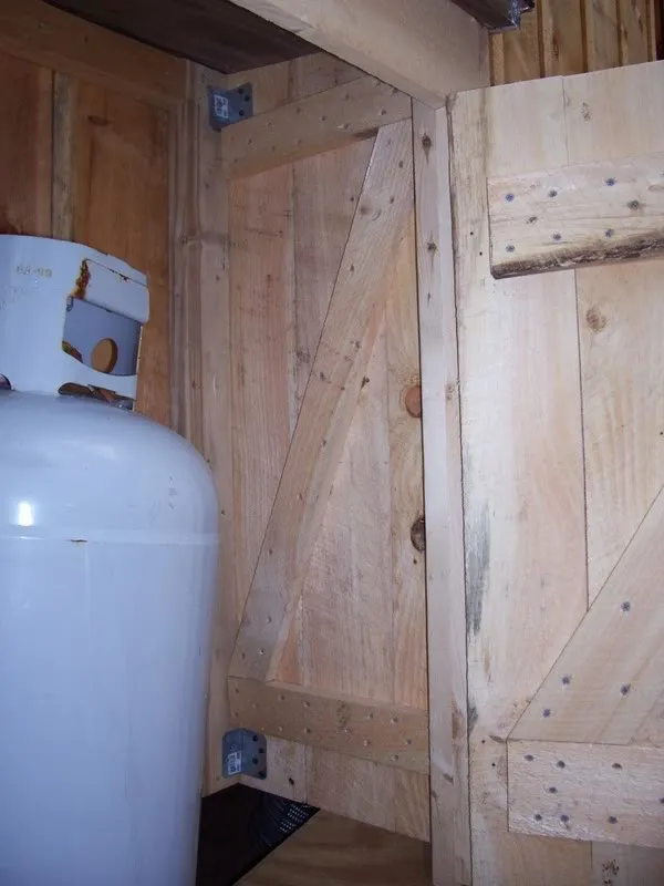

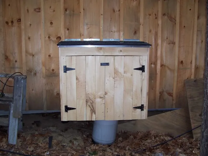

Built a little enclosure for our propane tanks.
And now we have snow so we will move back in and work on the bathroom.

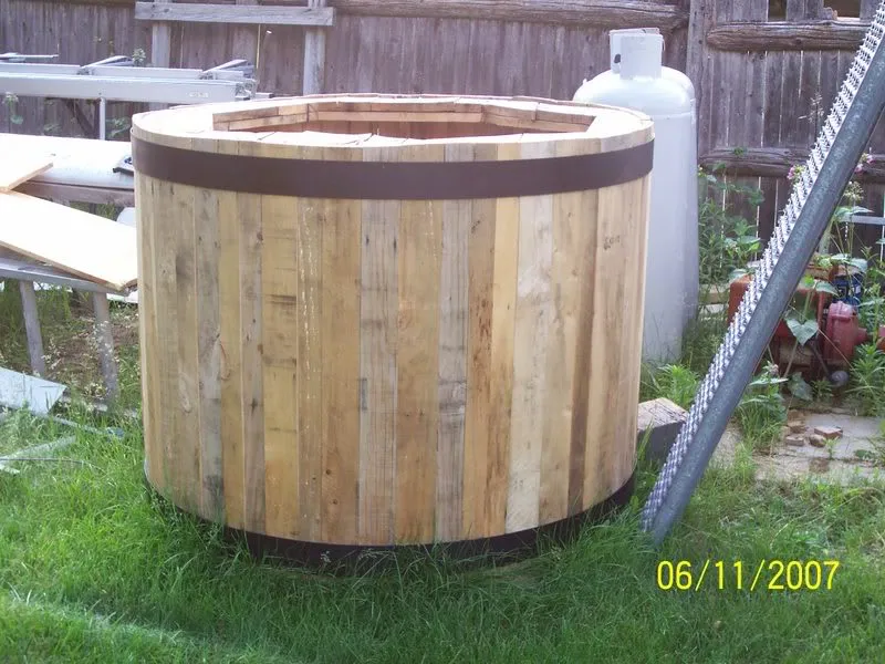

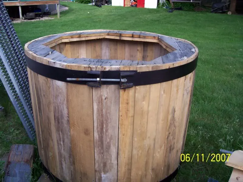

Water will be pumped from the brook and stored in a water tower we are building. This will give us our water pressure into the camp. The ends of the tank for the water tower  where the ends off a old wire spool about 4feet across. The sides are wood from a pallet we took apart to keep cost down. The bands are just thin flat stock that i welded ends on to be able to tighten down
