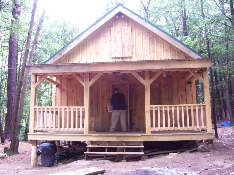

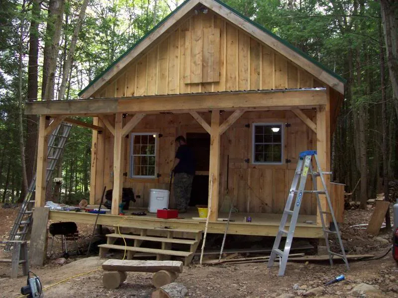

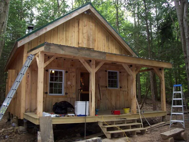

Well we had a good weekend. We got the roof on, plumbing done.
We have running hot and cold running water. NICE!!!!!!!!
I only have a couple of pic's, batterys in camera died (my son told me they where low but i did not listen)
This cabin is being built in memory of my father Robert and my granfather Henry.
Thank you for looking
Dave

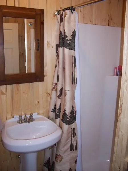

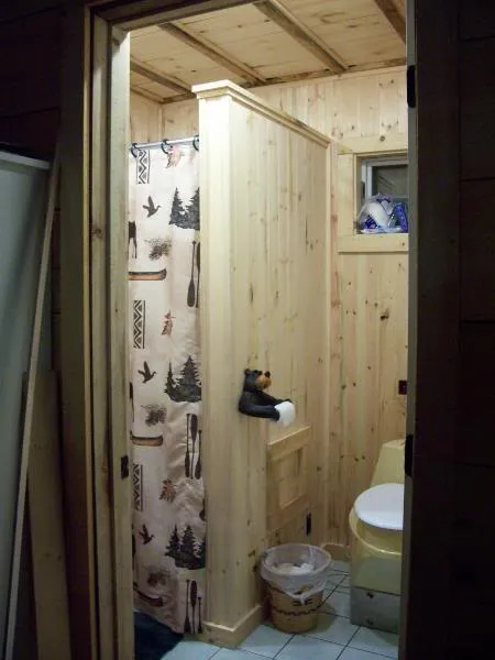

dmlsr

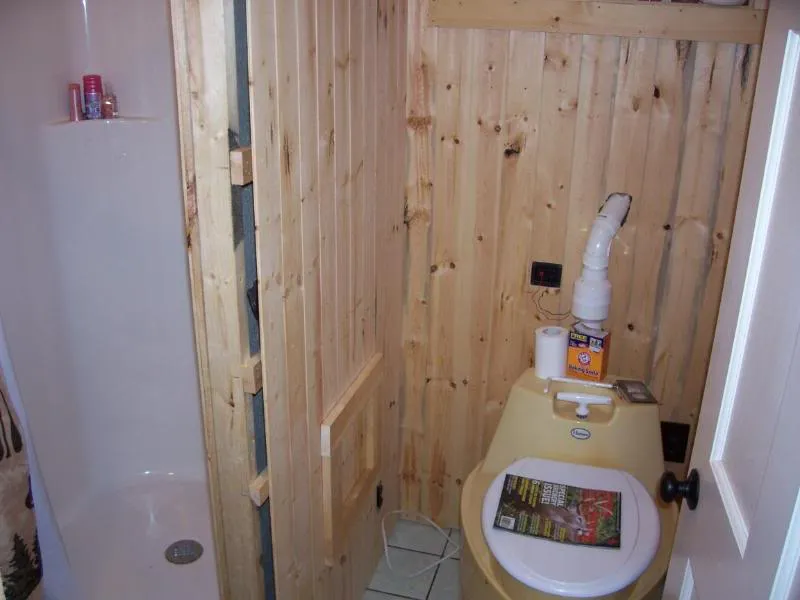

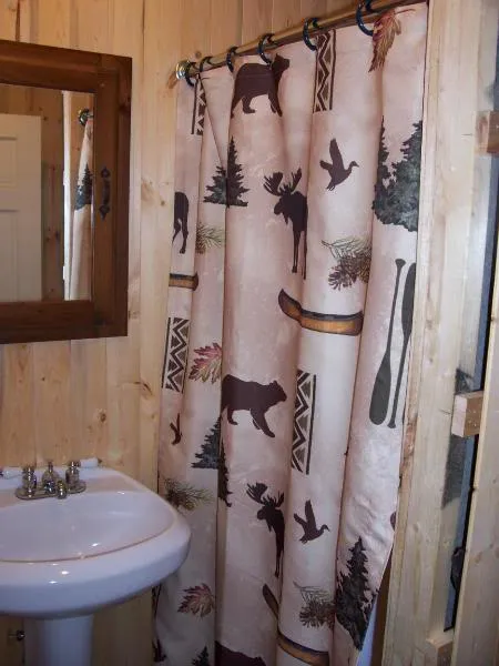

well got back working in the bathroom
here are a couple of pic's
hope to get it done next weekend
Dave

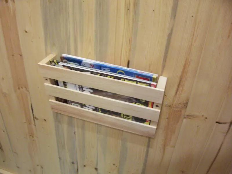

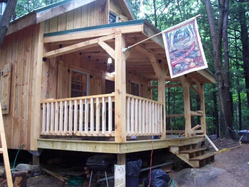

dmlsr

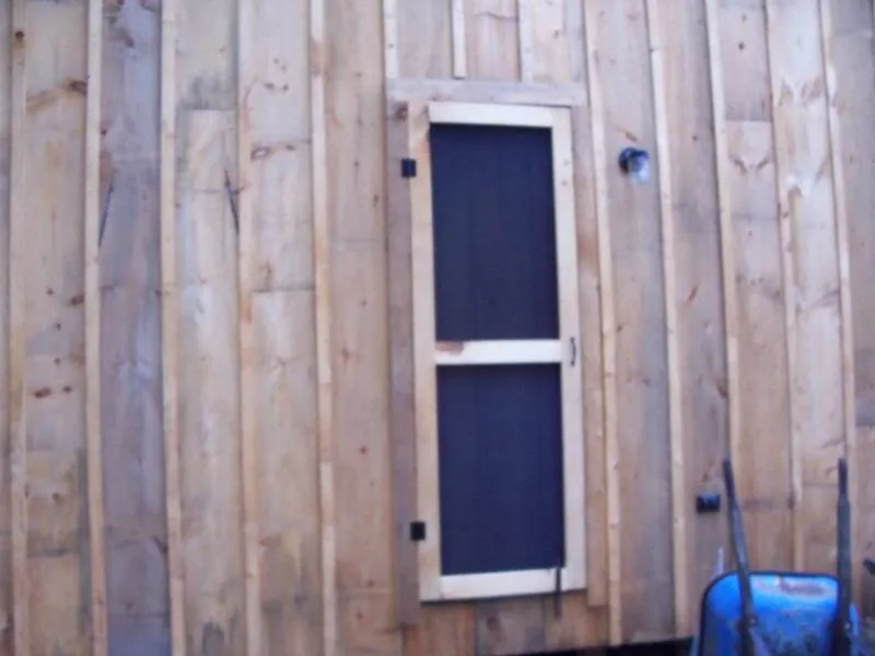

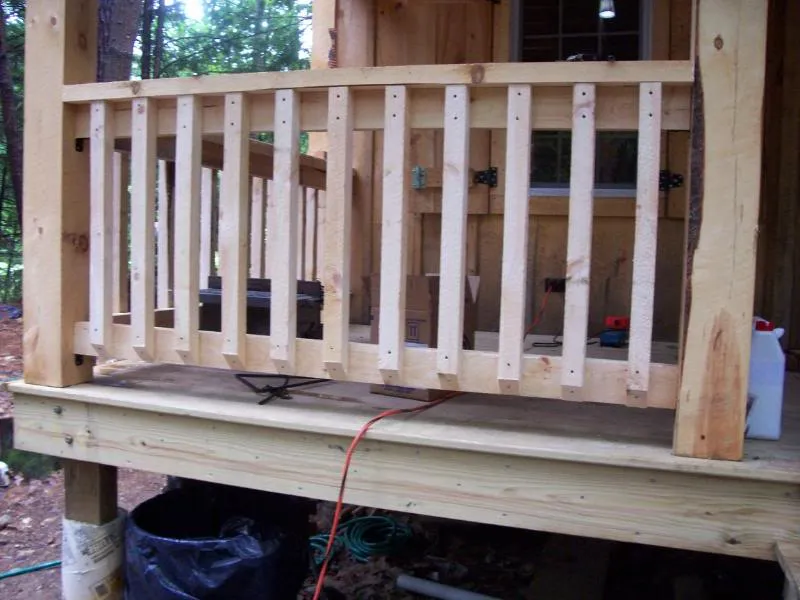

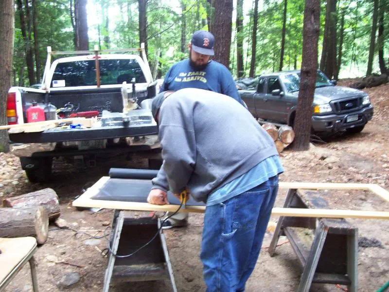

pretty good weekend. Alex got the all the  railing done on the front porch. I got the trim done in the bathroom. Also made and install back screen door.
weather stick
Dave
You guys have done an amazing job. I love it.  [cool]
The toilet paper holder.....I can't BEAR it!    rofl   The place looks really great you guys!  Congrats!

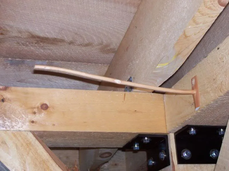

What size built up beams did you use on top of the piers?? Also what size floor joists?? Thanks. Looks great.

Looks just like a cabin I'd like to stay in!  Very nice - the porch & trim in the bathroom really are a nice finishing touch...
OK, what is a weather stick?  And what does it do?   ???

Peteh  i dont recall but i will be up there this weekend and i will check and post it here .
Sassy , when it is pointing up it is going to be nice out. When pointing down it is going to rain. Best of all it works

Thanks. I'm building a 20x30 1.5 story with a center steel beam and the built up beams will sit right on my poured concrete 10" piers. My floor joist will only be spanning 10 feet. Johns plans call for 3 2x12's with plywood for the built up beams.

the beam is 2x8 with plywood . It only spans 6 feet pier  to pier. the floor joist are also 2x8's
any ???? just ask

How is your composting toilet working?
dmlsr
Working good. no troubles. Do you have one???
