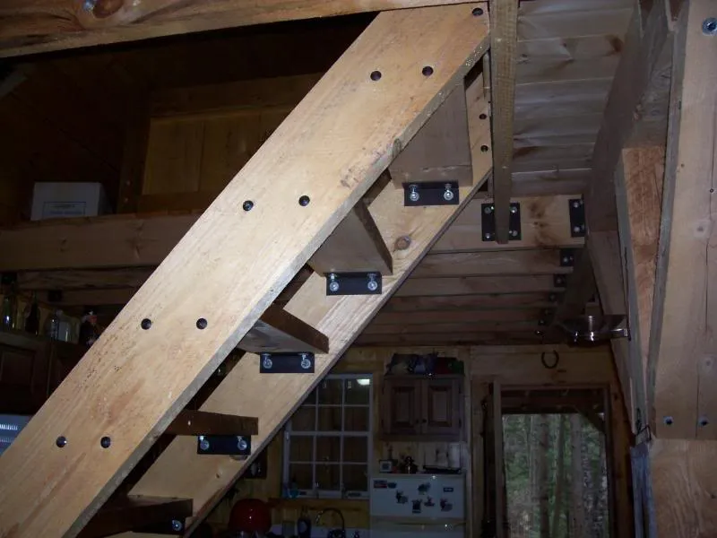

we where at the camp today to change the stairs. I wanted something alittle more user friendly. Im not getting any younger. Try to post some pic's tomorrow.

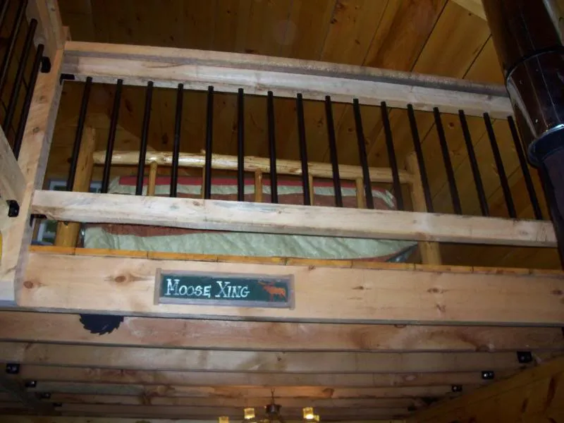

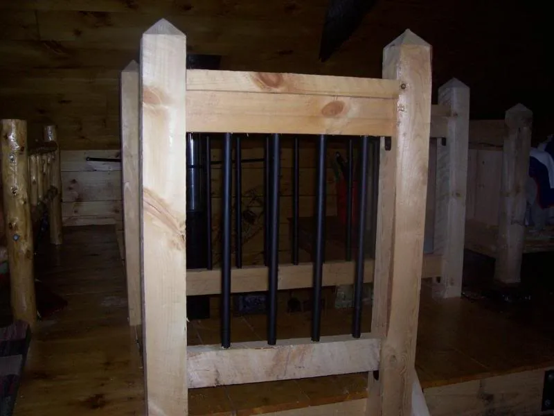

well we got going on the railings upstairs this past weekend . not much done but happy with the look.
We are using 4x4 for the post 4" space on the bottom , then a 2X4 standing up.  We made the black pipe  out of  electrical conduit pipe 3/4 inside we cut  24" long. Then  drilled in the wood 1" ever 5 inches. By drilling ever 5" it gives us the 4" gap to stay in code. We added a little glue in each hole. Then on top  a 2x4 standing up and then one laying down. this gave us a height of 36" ,thats code.
You can buy the pipes at homedepot . they are 30.00 abox of 15 and they are smaller around. We think ours look better . It would have cost us $210.00 to buy them done. It cost us 70.00 plus 2 cans of black paint.
This cabin is being built in memory of my father Robert and my granfather Henry.
Thank you for looking
Dave

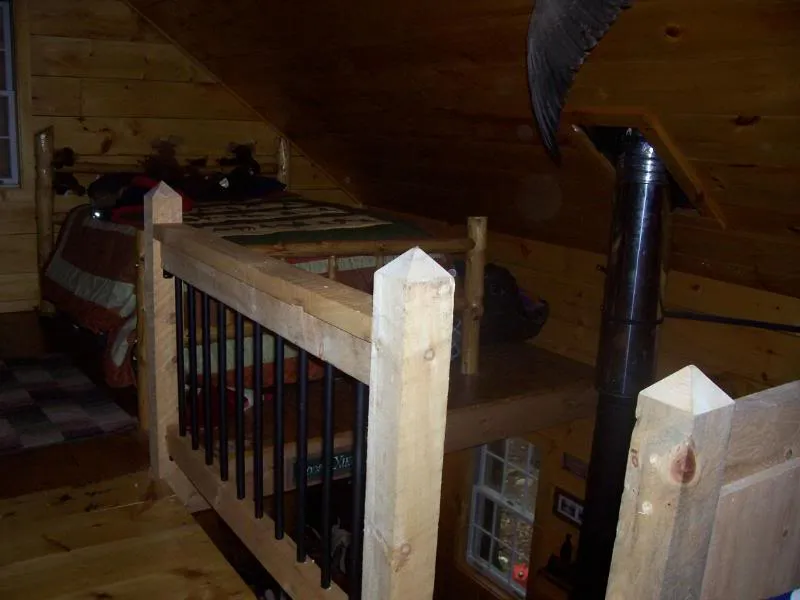

#389
acouple more pic's of railing
Dave
