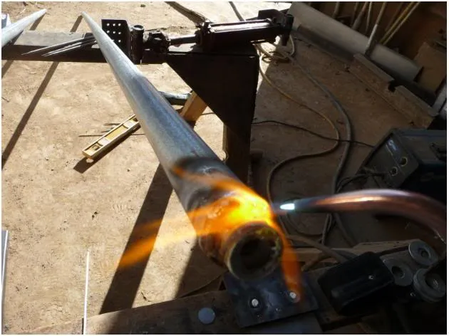

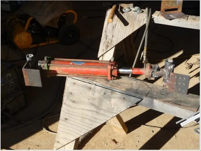

I repaired the cylinder ends - air tested it and made mounting brackets - I decided to reverse it also to put the cylinder end toward the panels - It will give me more power in the morning to return the tracker to the sun and eliminate some of the hose movement and length.

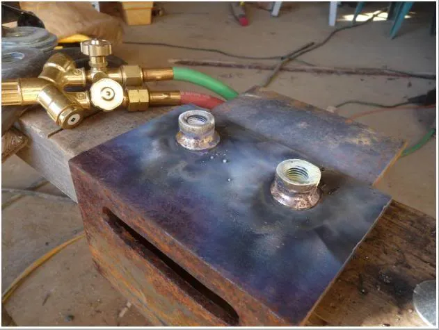

I made propane tube fitting adapter ends from washers and 1/2 of a 1/4 inch pipe coupling which I cut in half with the band saw.
I brazed the adapters onto the ends of the 1 inch EMT.  Brass with the gas torch is very strong and almost always leak free with a visual inspection.  It also works well with the galvanization - zinc.  I got a touch of metal fume fever from the fumes yesterday.  Respirator when welding?..... I didn't think I was getting that much....besides - real men don't use them ... right? hmm
The tubes will be a fill point and reservoir for the propane and oil for the cylinder - I'm using ATF - just enough to keep the cylinder oiled - I think.  3 feet up you see a pipe thread with a plug going into the side of the tube.  That is so I can sense where the liquid propane will fill to when I charge the system. [waiting]

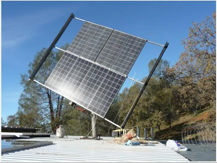

I now have the gas reservoirs charged up and it seems it is going to work.  Being so cold out it was a bit slow to respond but after lunch I came back to check and it was tracking the sun.  If it is too marginal, I may go to a larger cylinder.
Since I am using a high tech design and parts have been made by me on a highly skilled level, I felt it only proper I add a precision variable foot pound counterweight to fine tune the tracker so it would move with ease as it locked on to and followed the movement of the sun.  [waiting]
I extended it out and added the shades and gas tubes, leaving room for more panels depending on how it works in the wind.  I added extra bracing for wind loads tonight as there is a storm coming this weelkend.

Paint the cylinder matt black ? Add a curved linear, aluminium reflector just to pump heat onto the cylinder ? Make the cylinder the focus of the reflector ?

The points you brought up are some of what I was thinking last night and more.  I was thinking of painting over my original black paint and with less glossy paint --- will have to see if I have some flat.  The main thing I am worried about is wake up and getting rotation pressure in the morning.  I read a clue on the Zome Works tracker (fluid weight transfer for rotation...   - seems primitive).  They had a wake up reflector but didn't tell much about it.
I was also thinking of making some little parabolic reflectors to catch the morning sun when it first comes up but they would have to be limited to where they are clear of the tube when the sun is direct on, so the two can balance after it rotates nominal 180 degrees.  Even partial should help I think.  I have some mirror stainless I should be able to make the reflectors out of.  I could also make some partial reflectors for heating the fluid when the sun is direct if I matched both sides.

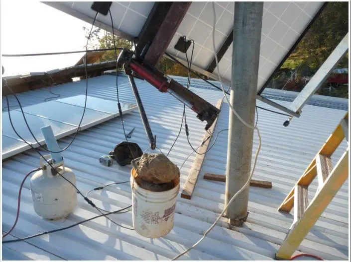

I mounted two more panels below the 8 shown above.  They clear the roof by about 1 inch at full tilt.  I am going to beef up the frame, making trusses of the arms and add the 4 panels that are missing.  I found info showing that wind loading should be under 20 psf.  at around 70 mph with all of my turbulence and obstacles - trees etc. so I think based on my rough calcs I can handle it.
I will mount my 14 thin film ones permanently about 15 feet ahead  of the tracker on the roof to keep the shadows clear but still reduce the wind loading on the tracker.
I made a small reflector for the wake up today - maybe it will help.  I want to get a new gauge for permanent pressure differential monitoring.  One of my old ones leaks so I have to shut the valve off.
