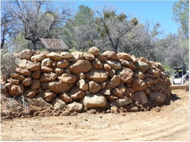

I think your wall is more work than mine, John.  All of my rocks are so big that I have to set them with the Bobcat, except for a few of the smaller ones.  The rocks that chink the holes will be able to be set by hand.
I am getting pretty good at rotating, flipping and setting them with the digging bucket.  The grapple is probably slower than the digging bucket and my few crude skills. :)
I don't think I would want to hit a wild turkey - even with my truck, Rhino.  We have a lot of them around here too.
More or less it is still work.  If I recall I used 654 blocks @ 90 # each at a cost of $7.50 each I am glad that the only thing I had to do was lift and not pay. ;D
I know that feeling.  I got $1500 for a load of rocks the same as I am using but mossy and delivered about 75 miles away.  That was about 30000 lbs of them max.
I am currently getting close to 500,000 lbs of rocks in this wall.

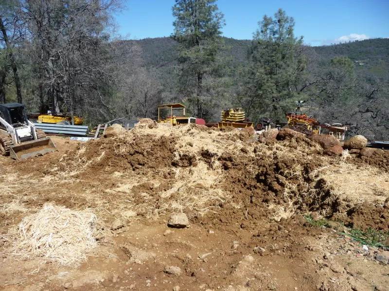

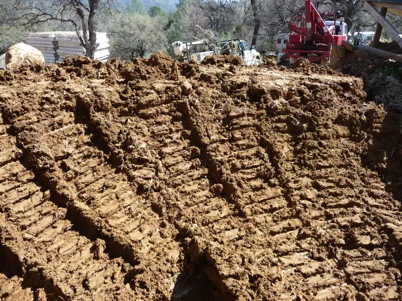

OK - back to my cob and rock wall.  It is nearly 10 feet tall now in Scottish Blackhouse style on one side and cob on the back side.

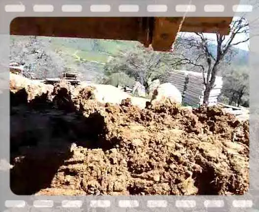

I used the Bobcat to do the cob plus added the Bouncing Betty to tamp it down on the top  in rammed earth wall style.  I ran the Bobcat over it with a loaded bucket in the earlier stages - Should have been around 18000 lbs concentrated on the front two wheels in the tracks as I was near tipping most of the time as I was compacting the cob.
Here is the cob wall as I tamped it into the rock wall on the opposite side.
I ran the Bobcat until it was near vertical packing the wall - at least until the tail hit the ground.  The front of the tracks would climb right up the wall.
Ride along with me to share the fun. :)
Here it is at the end of the day's work.
Here is a pix earlier in the day just after I got off the wall and started side packing.  I added the straw on the ground and squished it in with the Bobcat rather than my toes. d*

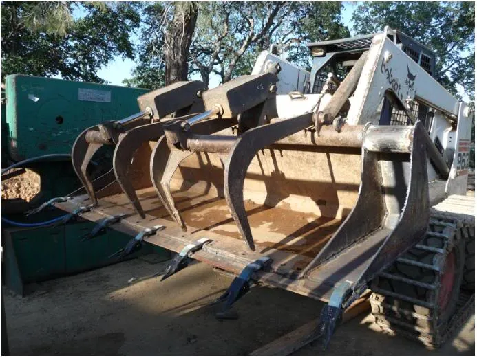

I expanded my Bobcat grapple bucket width to 7 foot 8 inches yesterday and added digging teeth to it so now I can brush, dig rocks and grab them and put them where I want them.  The grapple bucket was 6 feet wide with no teeth and it pushed rocks under the tracks trying to tip me over on sidehills.  Now it is a few inches wider than the tracks on both sides so it works great.
I took it down the hill today and put a bit of road in across a gulch so now the fencing for the cows will be a bit of an easier chore in that area.  I also wanted the ability to take the Bushhog down it for fence repairs.  I made around 4 hundred feet of road on around a 40% slope and across about a 10 foot deep gully.  Cuts were around 6 feet deep in the side hill in hard clay and rock.  Fun. :)
I also found that my property line was about 30 feet farther than the rats nest in the live oaks.  The rat had snagged the ribbons for his nest but the stake was about 30 feet farther in the brush.  I found the metal marker with a yellow cap with my metal detector.  Nice to know exact corners when making fence line.  As I recall the fence goes 1 foot in on the side of the owner making it.  No need to waste any extra land. ... [waiting]
After that Sassy and I went down to the spring box in the Bushhog  and dug it out.  Over the last 6 years or so, about a foot of dirt has covered it and roots have plugged the pipe.  Looks like a good time to replace it and get water down to the fish in the pond soon.
Finally - that pix everyone has been holding their breath for - the Grapple extensions and teeth

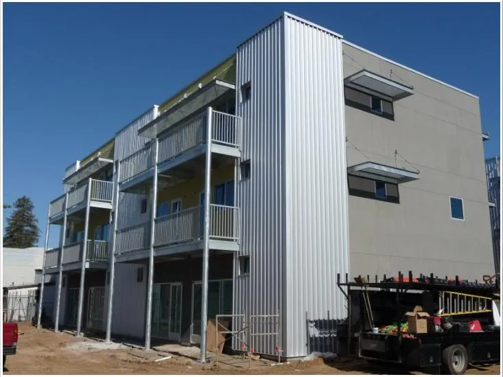

As most of you know - I am not here in the forum to harass you as much as  I am out of town selling my body for money.
It happened that a reporter for the Business Journal showed up on my side of the project and I even got quoted before I sent him in to see the PM and owner.
I am putting up the canopies in the picture on this page
and the balconies on this pix at the Iron Bird Lofts

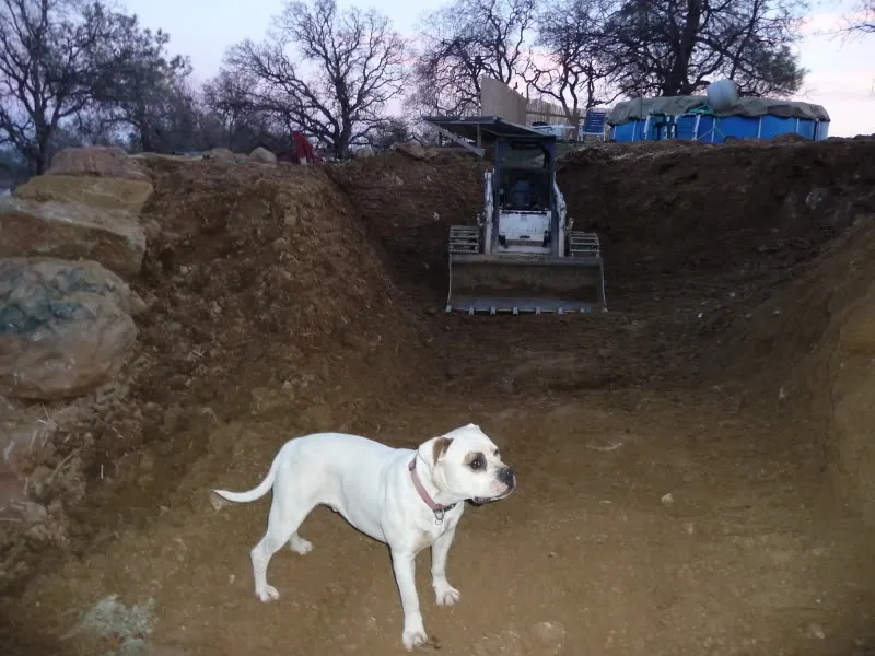

Question, is that your white bulldog/mastif in the picture? What kind of dog is it?
hmm The pictures of the Fulton Plaza/ Iron Bird Lofts were just pix I took of the last weeks Fresno Business Journal.  Reza, the owner/family partner has been redeveloping parts of old Fresno and was a friend of my son before I met him.  The Business Journal reporter took the other pix.
Spike is our dog.  I found him when prospecting about a year and a half ago.  He had been shot in he left fron shoulder.  He was - rough guess about 4 months old and had likely been dumped on our road.  Some of the others he was with had growled at a few residents.
Suzy - my other dog actually found him in a gulch we were prospecting.  He is an American Bulldog - solid muscle - about 80 -90 lbs and very good natured although a bit overly strong, and you have to be careful playing with him to not get him too excited and rough.
Thanks for thee compliment on the wall.  It is staying up well.
Here is a later pix of it I don't think I posted yet.
The rocks run from a few hundred to about 10000 lbs calculated on volume, with most averaging from 1000 to 4000 lbs.
