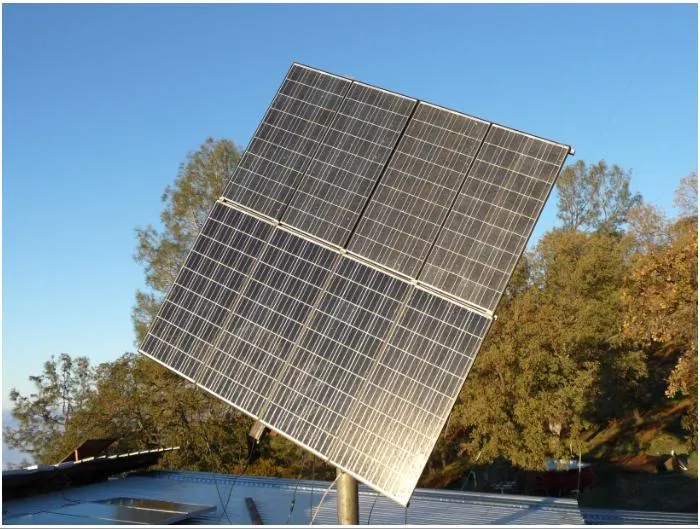

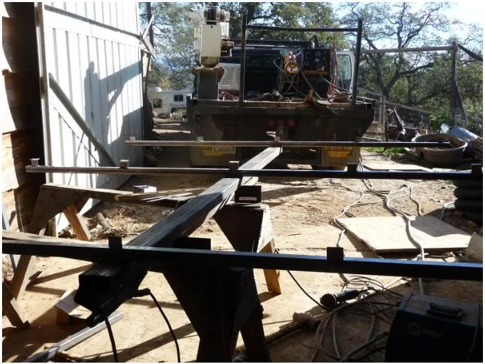

Since you are interested, I took some pix today and will add them here as I progress on this and improvements are made.
I built a frame and put mounting clips on it to simplify installation of the first 8 panels - as I check out wind loading I may ad more and made that easy to do also.
I have increased my power about 4x what I was getting with the panels laying flat on the roof.  I put the second set up last night and this morning they were also providing 4 times the power and as I manually tracked the sun today they provided power 4x as long also.
Even at right after daylight I was getting 10 amps where I was getting nothing to very little for the first few hours.  I had so much excess power today that I pumped water 3 times, or about 450 gallons and still didn't use all of the excess.  The controller shut down the panels for part of the day.

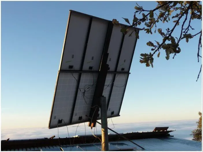

Here is the back.  The post is 6 feet tall and is attached to the center post above the center beam in my shop.  I added web stiffeners to the I beam to transfer the load to the column below -- just as an engineer would specify if I paid one. [waiting]
That puts the base of the post about 12 feet above the shop floor.

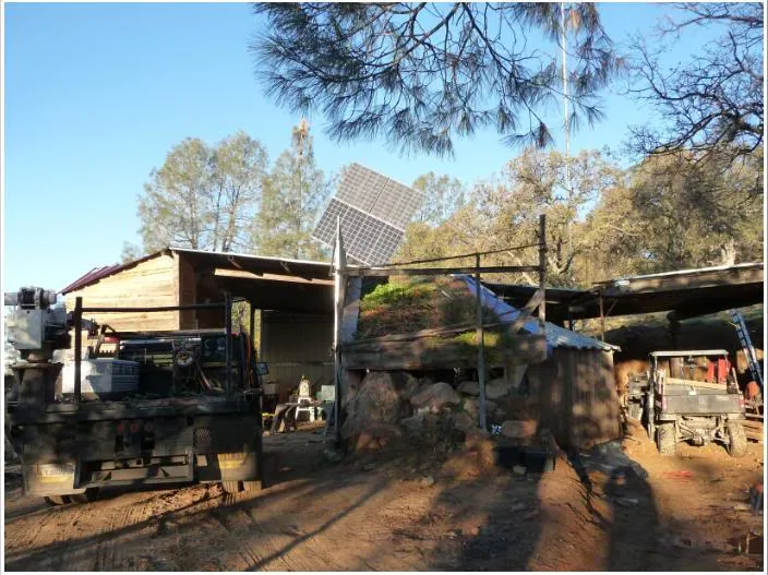

Here is one from a distance showing the tracker on the shop roof.
The panel area  currently measures around 8'8" x 10'
