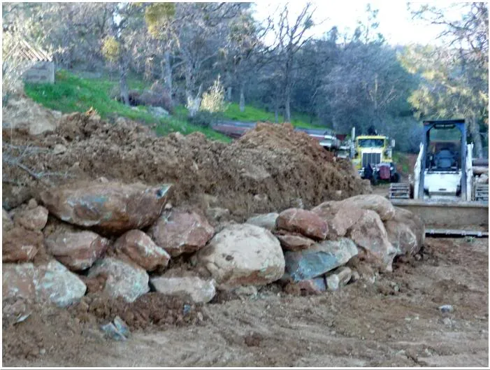

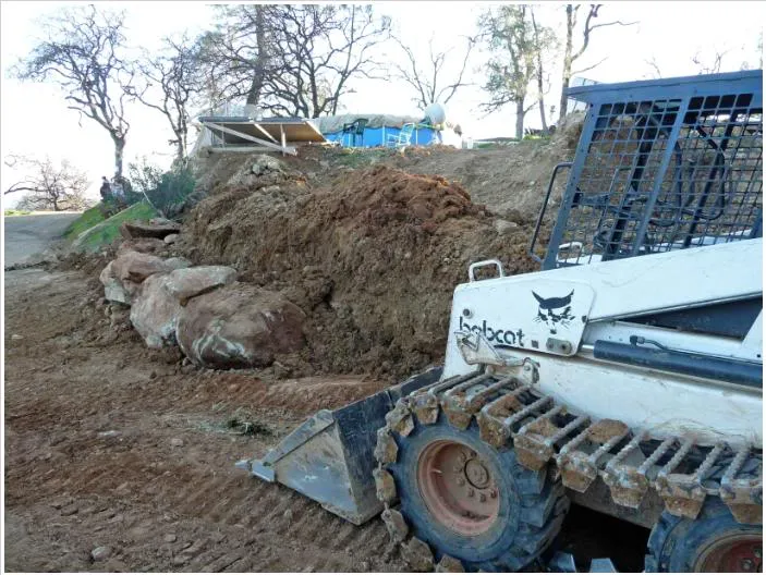

I am currently building an earthen wall with straw in it around the end of the cut that will become a tunnel in the underground shop after I get a roof over it.  I took down the pile of rock and earth by the pool that was from excavating it.  That will help me to be able to get the framing over it for the roof.  New tire on the Bobcat today so hopefully tire problems ease up a bit... It is a real pain to fix them with the tracks over them and I have done it 3 times this week.[waiting]

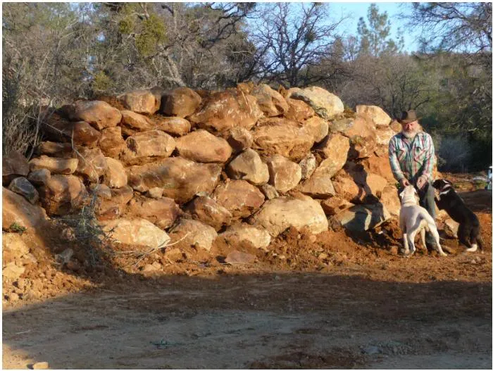

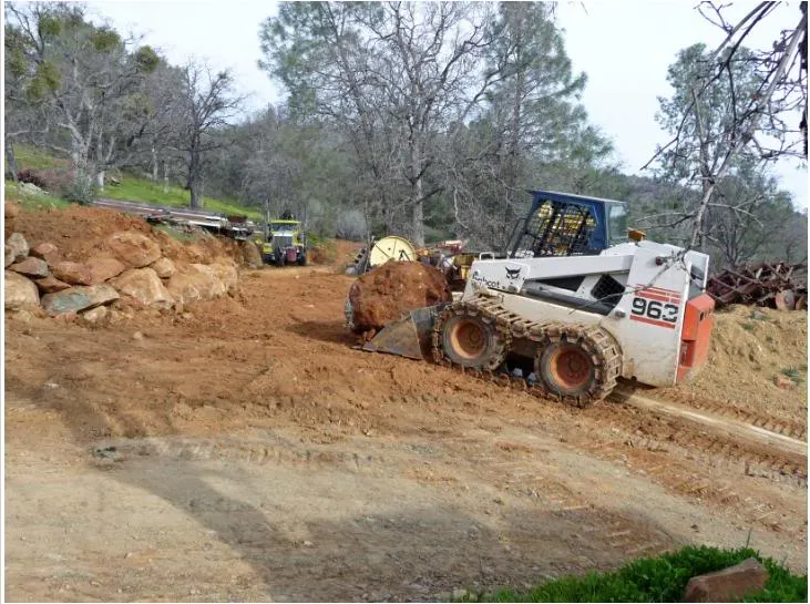

Here are a couple pix of the Bobcat Cob Wall along with a few rocks I stacked there today.  I've had a couple days off from working in the city building apartments for the masses.
I got some new tires for the Bobcat the other day - put one on yesterday.  They are called Junkyard Boss by Advance.  14x17.5.  They are the best and cheapest tires I have ever found so I ordered 8 more to have in stock in case they become unavailable in the future.  They are covered with blocks of rubber at least 1 1/2" thick and should work well in our rocks and clay even without the tracks.  They are flat (rather than rounded tractor lug style) and full width top also, so fit my tracks perfectly.  I only have one on the left rear now - just bought to to start out with.  Nice. :)
I am making cob with the Bobcat - clay and straw with rocks up to 1 foot or less included.  When done I will carve out the back side with the Bobcat.  Currently it is around 10' thick to allow for compacting with the Bobcat.  I cut the wall as necessary for the rocks.  Some of the rocks are over 6000 lbs.
Second day of wall building it is now near 8' high at the tallest point and 45' long.  The Bobcat has stayed together for all of this time.  A miracle.
Oh, wait a minute.  I did have to weld the bucket back together after digging out this one and bringing it up the hill.  Calculated weight by volume is over 10000 lbs.  I couldn't lift it - had to skid it all the way up the hill.  This was in the morning - worked a pretty long day as you can see from the next pix.
As I dig out rocks for the wall I am making equipment parking area on the terrace below the sawmill.  I have been slowly bringing the big stuff - equipment , antiques etc. from our place in the valley.
A pix of an old man and dogs in front of the wall.

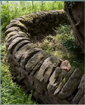

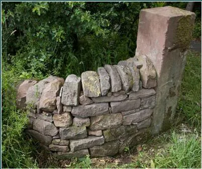

Glenn. I thought you might enjoy the work of one of my pals. He's a scottish drystone waller - here's a link to his site
http://www.elanddrystone.co.uk/SSPG/index.html
Al
Thanks a bunch Al.  I always enjoy looking at dry stone wall projects and it looks like he has done miles of it.  I borrowed a couple of his pictures and encourage others to have a look at his site.  Tons of great work there.
I have read what I could - watched a park service video of how they restored a stone wall along a canal, watched a wall being built in Sacramento, CA, and studied the Blackhouse pix from you.  I have combined the various methods to come up with ways of doing it myself with the mix of rough shaped greenstone I have here on the mountain.  We have miles of drystone walls here generally attributed to the Chinese but I think it was generally anybody who needed to build or clean fields and wanted to use the natural resources.  The Italians are said to have built more than the Chinese here.
In general the drystone walls do not deteriorate as easily over time as many would think.  They allow drainage through them and don't build up water and mud pressure behind as a concrete wall with a plugged drain will.  I removed a concrete wall a couple years ago for a customer that mover around 30 feet.  Gravity firmly holds the bottom rocks in place but the wall is still flexible and will follow movement of the earth without damage when properly build.
I try to get 3 point or more contact on all rocks and they all lean back a bit - generally 2" per 3 feet minimum, so gravity resists the ourward force from the earth.  In most cases retaining walls should not go over 4' high but the above wall is not a retaining wall.  The clay-straw mix is self supporting and will have a plastic cap with landscaping over it so it will remain dry.
Some of the basic rules to making it decent looking are to keep the front face uniform, place the big rocks well and come back and chink the smaller holes with good fitting self supporting rocks also.  Gravity and fit should make it all stay together rather than a poor fit that would make the rocks want to fall out or slide out under pressure.  If the proper rock is not there then find more rocks.  I can eyeball the proper rock and fit in seconds now as opposed to when I first started.
