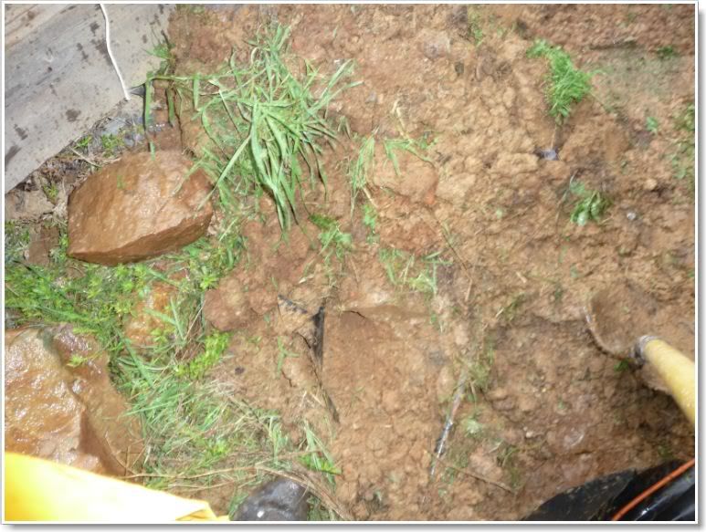

Still getting some water down at the bathroom floor so went looking for gophers again today.  Found this one - plugged him off and put a new heavy 20 mil membrane over the area there.    Our clay seals it right off tight, but a gopher hole in it defeats that temporarily.
The bad thing about gophers is that they could bring it from 20 feet or 200 feet away.  That is why I now recommend the French drains.  The gophers are our underground irrigation and drainage experts here, many times bringing a nice spring right out the side of the mountain or...... behind my wall once in a while during a rain.  They just plain don't play well with others....just concerned with their own interests.... [waiting]
If I continue to get a problem from them, there is not much telling how far they could come from so I have a couple more plans.... a garden shed with roof above the area... an old plan anyway, and begin putting the French Drain in the back floor just inside of the wall.  Got a little more I want to do that way anyway.  I think I can hook into the gray water drain from the shower and put a cleanout on the line in case of silt, but the water is generally clear anyway.

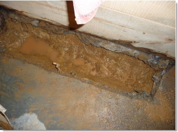

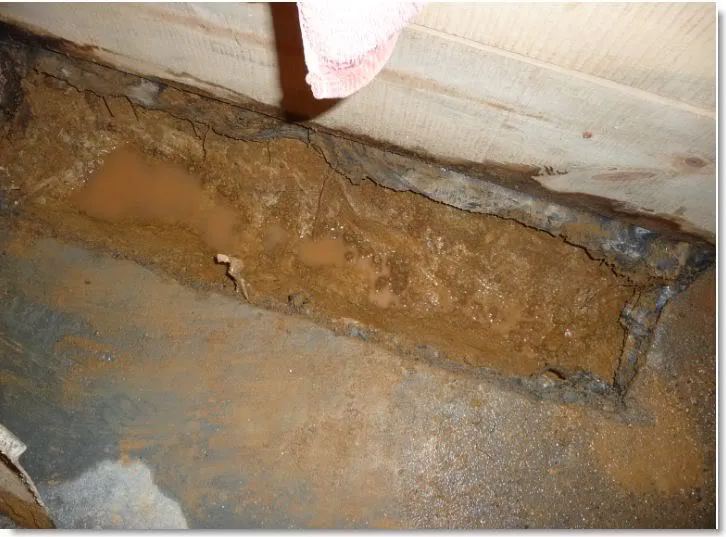

The ground under the cabin is claystone so water moves along under the floor area making it damp, except in the bathroom, it came out on top of the 3/4" thick concrete slab.
This is how I will attempt to defeat that.  ... [waiting]
I have intercepted the water just inside the exterior wall at the side of the bathroom.  I dug a trench to collect the water after which I can either put in a sump pump or.... hook into the graywater drain for the shower.

Got the rest of drain in the bathroom dug out.  Started on the east side future closet area by the stove now.  Struck water at 6 inches..... No wonder that floor gets damp.  The Gophers have been working overtime.  It is amazing how they can change water flows around here.
Planning to rig up a core drill tomorrow and see if I can drill a gravity drain to the outside.  If I can't do it Whitlock says he has a mining jackleg air drill that will do it. [ouch]
Drilled about 4 feet through claystone and rock today - broke the pipe the core drill was attached to and lost it forever,  so went to plan B.  Dug a sump and put a pipe out of the wall up high to pump it out.
