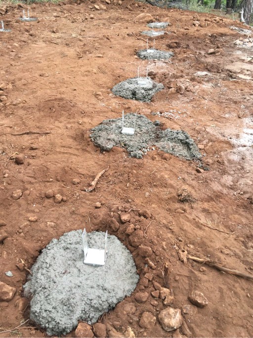

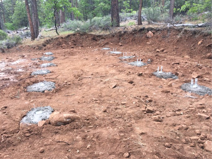

Here are some pictures of the piers/brackets, and I was a bit nervous after speaking with the contractor but I'd like to hear some input before i mention it to him.
First, there is no rebar in these footings, although they DO extend below the frostline (18'') they are 14'' x 24'' deep. He said we have very rocky and stable soil so it wasn't needed (I was away for work while it was poured so I found this out after...)
Secondly all of the Simpson strongties are lined up with each other very well (although some are not dead center on the pier), but some of them are mildly out of plumb, probably 1/4'' or less, do I just shim the posts somehow? Is that kind of common or should I be worried? Having a bit of anxiety about that. ???
Here are some pictures..

I've built footings like this for the deck on my house, although I did use rebar.  The brackets being out of plumb aren't a big deal, as you can bend the steel to get it into vertical.  I would shim with pieces of asphalt shingle as needed.
I learned by reading this forum that a built-up beam is stronger than a solid wood beam of the same dimensions.  The beam load calculations established by the American Wood Council allow for a 15% increase in the design strength for the built up beam.   Be sure to locate joints over a post, that's the only way it is stronger.
The pier and post design is great at being low cost, but you sacrifice a lot of load bearing capacity as well as shear resistance compared to a continuous perimeter foundation.  You'll want to brace those posts and the beams too, to the extent that it seems like overkill.  But when you load up everything with the weight of a cabin,, especially if it's carrying a big snow load on the roof, it doesn't take a lot of lateral force to rack things over.

Hmmm, there might be a semantics thing going on here. To clarify, a built up beam is made of 2x lumber up on edge, good. A gluelam is factory laminated of lumber on the flat... don't attempt that, it will fail. Look in the codebook for beam and girder span tables for dimensions, I think you'll be in chapter 5.
If you build the girder in those pockets out of treated lumber and frame a stem wall on top that is sheathed in treated ply it would be better braced than putting the cabin up on poorly braced posts. Asphalt shingles are not shims nor is anything else compressible, I think code says 350 psi or greater but with the loadings this produces you may need better than that.

Well guys, feeling a bit bummed out today, not really sure how to proceed right now. :-[
I spoke with the contractor about the out of plumb anchors and he suggested shimming. Luckily I was able to find some composit shims that are up to 8000 psi. Started putting in posts and some of these anchors are actually 3/8'' out of plumb in either one or a combo of both directions. Got the 3 posts nailed in and leveled but they are basically floating, with only one corner touching the flat face of the anchor. This is obviously not ideal.
Should I try and just jam/hammer the shims in to fill the empty space as tight as possible? Cutting the wood at an opposing angle isn't working, the multiple angles needed to bring the post plumb are just too complex. I'm frustrated because this contractor is well known in our area and has built alot of local businesses around here so I dont see how they messed up this much and I'm not sure if I should try and ask them to fix it (somehow). ???

For starters I'd fire the contractor now before he messes anything else up!
You can shim etc and if needed later can go back and do something like I did (put in your own footing and surface bonded cement wall for a foundation after the fact) if you feel it isn't good enough.
If you are using posts and then beams remember that they will need bracing and lots of it.  I found that my cabin wasn't really 'stable' until it was very well braced and even then the addition of two foundation walls under it (I'm not done) made all the difference.
So fire the contractor (those footings look like a kid poured them, not a pro) and either hire someone who is professional (and therefore will do nice work -- meaning everything will be plumb, square etc and look nice too) or do it yourself :)
I know that sounds harsh but you want your cabin built right and I'd have NO confidence in that contractor now.

I'd have to agree, that work seems excessively sloppy for someone claiming to be a professional.
NathanS
A contractor without a license, or willing to lose it, by going around the code officials.
I don't think it's too late to dig out between the piers and then pour a continuous footing, or scrap the piers and offset the whole building a few feet and start over again - this would actually be faster and easier I think. Seems expensive now, but really in the scope of building a house it's not that much time or money.

It would be so much easier to do the foundation correct now than to put all the work into a structure and come back and fix it later.
   That soil looks awfully familiar---I built for my Mom outside of Lassen.  Similar dirt, similar slope.  You are going to build a rigid structure, attached to a flexible foundation, set in moving soil.  That dirt is creeping downhill---not fast, but it is.  It expands and contracts, too.  You have zero earth/wood contact separation---it's a great plan if you're into feeding termites.
   Your planned structure is small enough that hand building a continuous footing wouldn't be too hard.
   It's a beautiful property, by the way, and I see nice native building materials lying around everywhere.  Here's what I'd do--
1) Start with a retaining wall where you've cut into the hillside there.  Set up a french drain, pour a proper footing, and use the native stone for an attractive feature that redirects water away from your structure.
2) Dig a nice continuous perimeter footing, 24" deep.  Use plenty rebar and pour concrete.  After that you could use cinder block but I'm fond of slip forming smaller foundations.  Get at least 18" out of the dirt and provide for ventilation.  If you want, you can build a stemwall above that to provide under house access, good airflow, and somewhere for storage.
   A nice solid foundation will really pay off in the long run.  Take close note of OLJarhead's foundation, that's something you can do.  The retaining wall can be built as a practice run where it really won't matter as much... Finally I hope you know we all love building on this site and seeing structures go up---I learn something from every single build.  So when people are encouraging you to upgrade your foundation, we're really hoping you end up with a strong, safe structure

So an update...after reading your suggestions I figured it'd probably be best to not ask the contractor to correct the problem since it may just make it worse and I called a carpenter friend to come and help me properly level and shim the posts, we got most of them done!  :D, and hopefully the next few will be done within a few days (my work schedule right now has me working 5-730 6 days a week so work is progressing slowly).
I put a LOT of consideration into just restarting the whole foundation, but as of right now money constraints as well as a strong desire to get the house weathered in by winter are going to make that unfeasable so I'm going to continue on. I'll  be heavily bracing the posts, and getting some simpson column caps, as well as going into this with the understanding that I will probably put in a stemwall within a year or two regardless of how the posts hold up. I know it will likely be more work than it would be now, but it's what I can afford.
Oljarhead your pictures were equal parts inspiring (for me) and maddening (that the contractor messed up so bad) so thank you for posting those, I really like visual aids.
