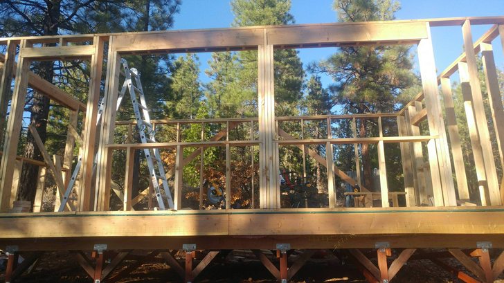

Correct, the jack studs weren't in yet when that pic was taken! Good looking out though, thanks.
So in laymans terms, does that mean I screwed the pooch again on these headers?  :o
Will the section modulous for this header as constructed realistically support anticipated loads or should I just bite the bullet and put in 2x10s?
Researching online is giving me some conflicting information,  ??? some tables are recommending 2x10's and others are saying 1 inch of header per foot of window span is sufficient for single story buildings?
You are not illiterate
Good question. Step back and figure out the load... look under "reactions", "max gravity" on the truss sheet for that area. How many trusses are bearing on that header? Multiply the number of trusses resting on that header by the max gravity reaction and that is the load the header is designed to support. So there is load.
For resistance, describe what the header is built of now and what is the clear span inside from jack to jack?

I've got the lateral bracing underneath completed and I finally got those headers replaced. What a pain that was, glad it's done although tomorrow I'm going to have to re plumb and square that wall as all the prying and banging knocked it around a bit!
Here's a pic from today

Thinking about it, let me make a case for using 2 ply 2x12 with a filler of 1/2" ply. That would stack up beside the gable truss to the same height as its bottom chord. You can then lay a 2x6 plate on top of the plant shelf against the gable truss and scribe where their flat studs are. Notch your plate to fit round those and nail down the plate to both the beam and the truss (another tie, when I say in the post storm photos that this truss is laying on the ground at the base of that wall... it gets sucked out not blown in more often than not, the beam/connection has to work both push and pull, you could wrap metal lumber band straps around beam and truss easily at these thicknesses for that matter).
Those headers look good. On our job the guys are on day 4 of fixing the framer's attempt to reuse the old barn rafters, stringing, shimming, power planning, there is at least that much work to go  d*. My partner sent an email this morning  :D

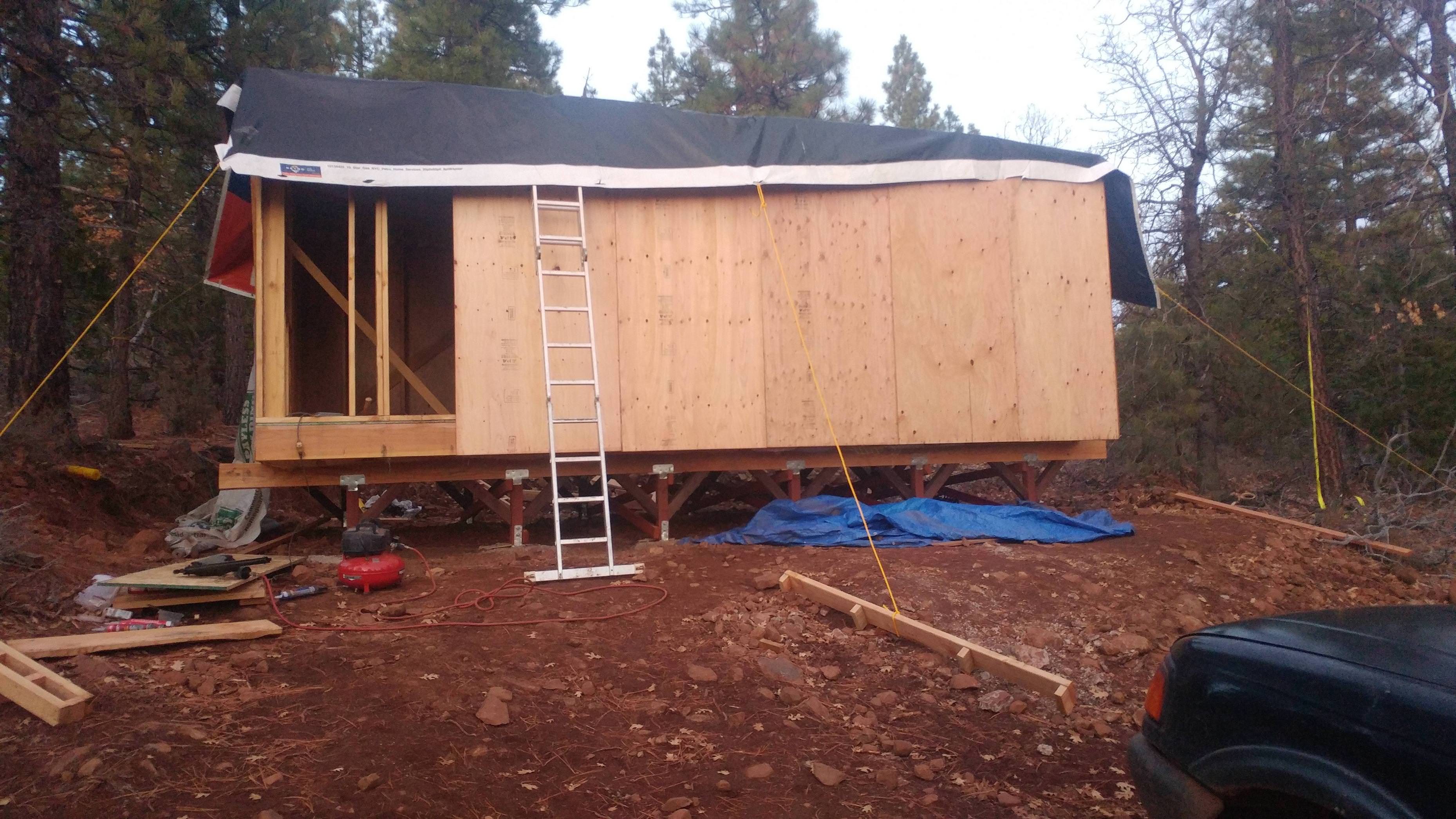

I started with just trying to put some house wrap over the top as that was all I had and storms were coming. But I found a website which lets you buy old billboard ads which are thick vinyl and ordered up a 20x30 for about 50 bucks. That sucker was HARD to get up and unfold on the roof, especially with only 1 ladder. But its been done!
Sheeting is going steadily, as of right now the house just looks like some kind of mysterious wooden cube cause I haven't cut out any of the windows yet :)

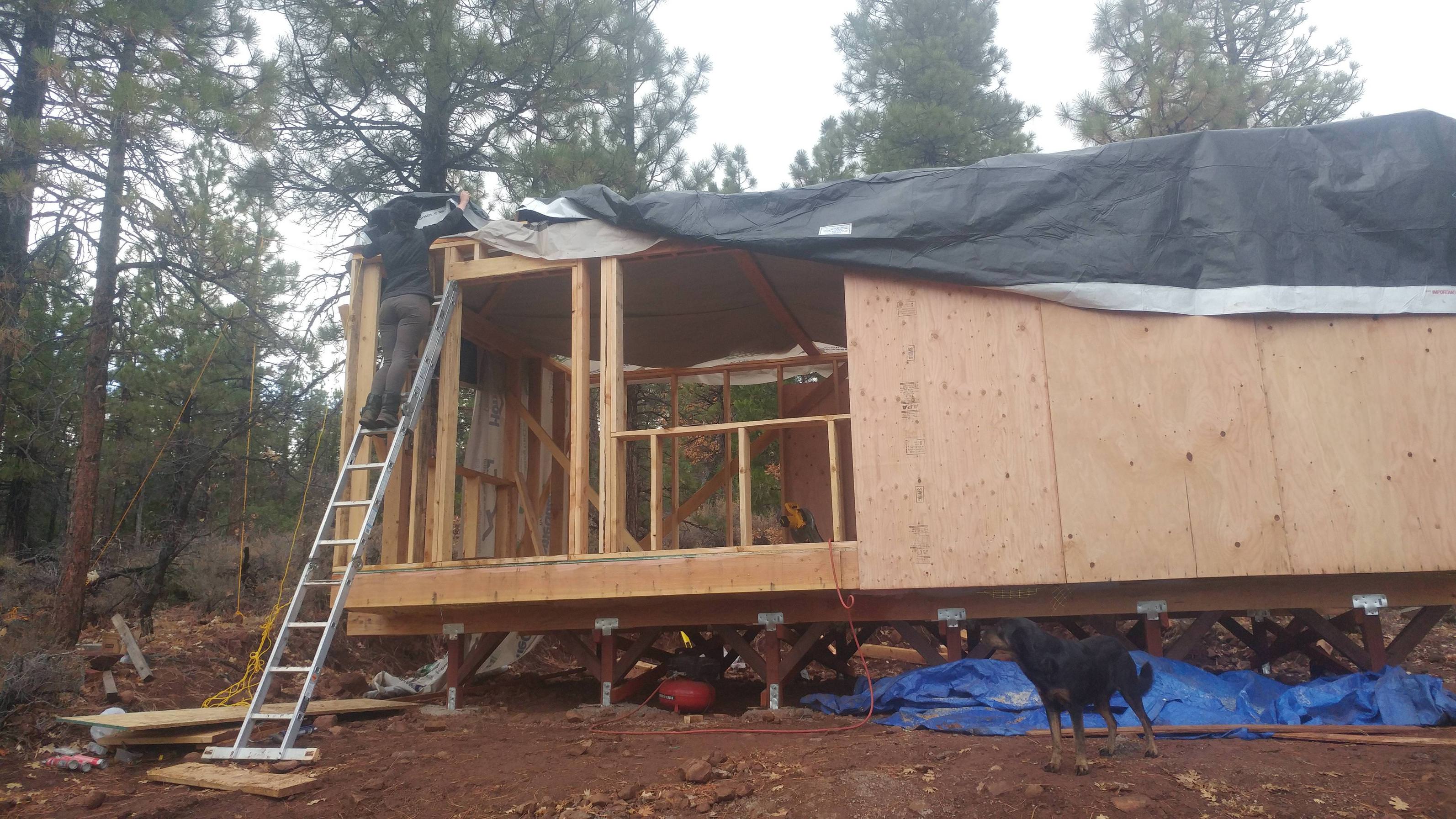

Yup ;)  Been there!  I was going out OFTEN to get the weight off as it always sagged in the middle.
OlJarhead
I tried to find one that showed the ice and water that gathered on the tarp but this was November 1st 2009....
If you can get trusses up, even enough to 'tent' a tarp over the cabin I'd advise it.  If not then some kind of shed style arrangement to allow water and snow to sluff off the tarp would be good.

That picture is almost a spitting image of what we got going on. Even down to the non covered strip at the top of the walls! Thx for posting that.
Just been spending the last few weeks battling the weather that's been coming down on us, sometimes even going out every couple hours to try and knock some water off the top. Felt a bit like Lieutenant Dan screaming at the storm lol.

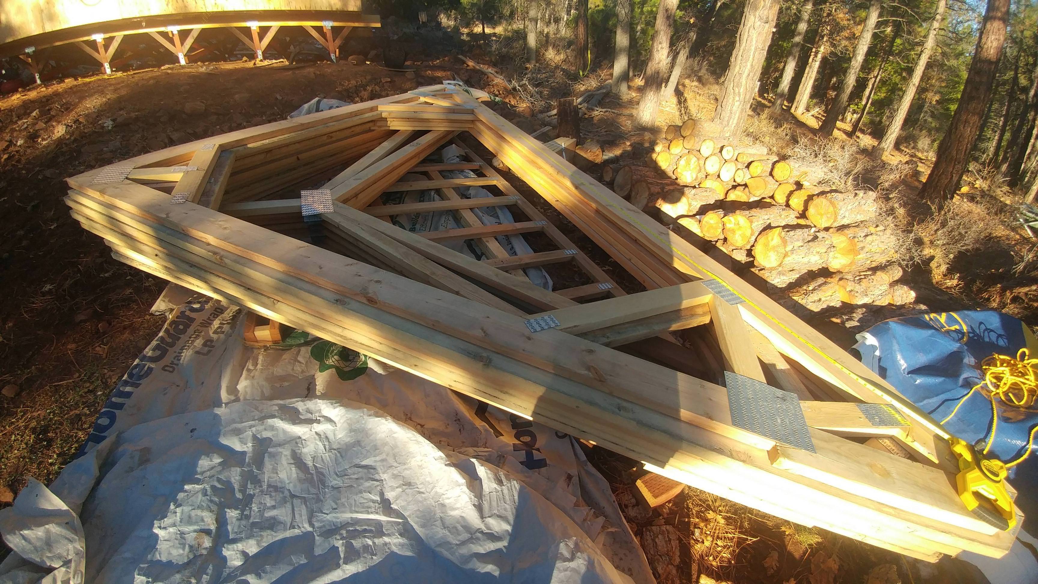

Trusses are FINALLY done and delivered today and we got some nice clear skies in the forecast for a bit, time to make the final push and get this sucker weathered in!
Good deal, could he not get up to set them on the wall tops?
Be careful around those overhanging nail plates as you move them around, they can tear you up.

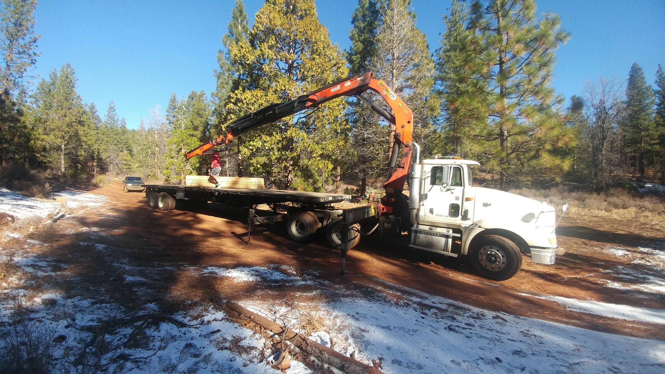

Sadly no, we didn't have a big enough turnaround for the truck since they sent a full size semi so he had to drop them about 300 yards away and we just carried them up. On the upside, I got a discount on delivery because their standard is for 'plate level' delivery which they couldn't do. Found out about those little stabby suckers the hard way, hopefully once was enough to learn my lesson!  ;D
