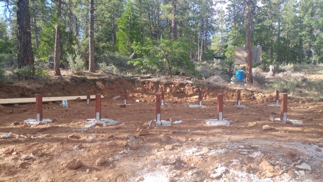

Well here's a long overdue update, progress as of last weekend! Finally got all these suckers shimmed and trimmed. Work is slow going as I work in fire and as fire season picks up my schedule gets more and more hectic and unpredictable.
Woot! on our way!  [cool]
Next stop is the built up beams, which I hope to have made if not even mounted by monday.
After thoughtful consideration (and discussing it with the missus) we've decided to just continue with the original plan to go with the wood pier foundation and likely add a continuous footing down the road, as cool as the perm. wood foundation sounds, if I'm gonna dig a trench to frost depth anyway I might as well just fill it with concrete afterwards similar to what OlJarhead is doing.
That being said, I do think that anything I can do to increase lateral stability is going to be a good idea, so I'll be headed to our local home improvement store tomorrow to return the Simpson Column caps Part # CCQ44SDS2.5 (which offer no rated lateral support and were frighteningly expensive) in exchange for some other ties, but I'm curious as to what more experienced builders would recommend I buy.

I'd still build walls rather than trying to solve the problem with a sheet metal connector, the frost depth gravel was ideal, you can stay above grade. The lateral on those is one direction only IIRC.

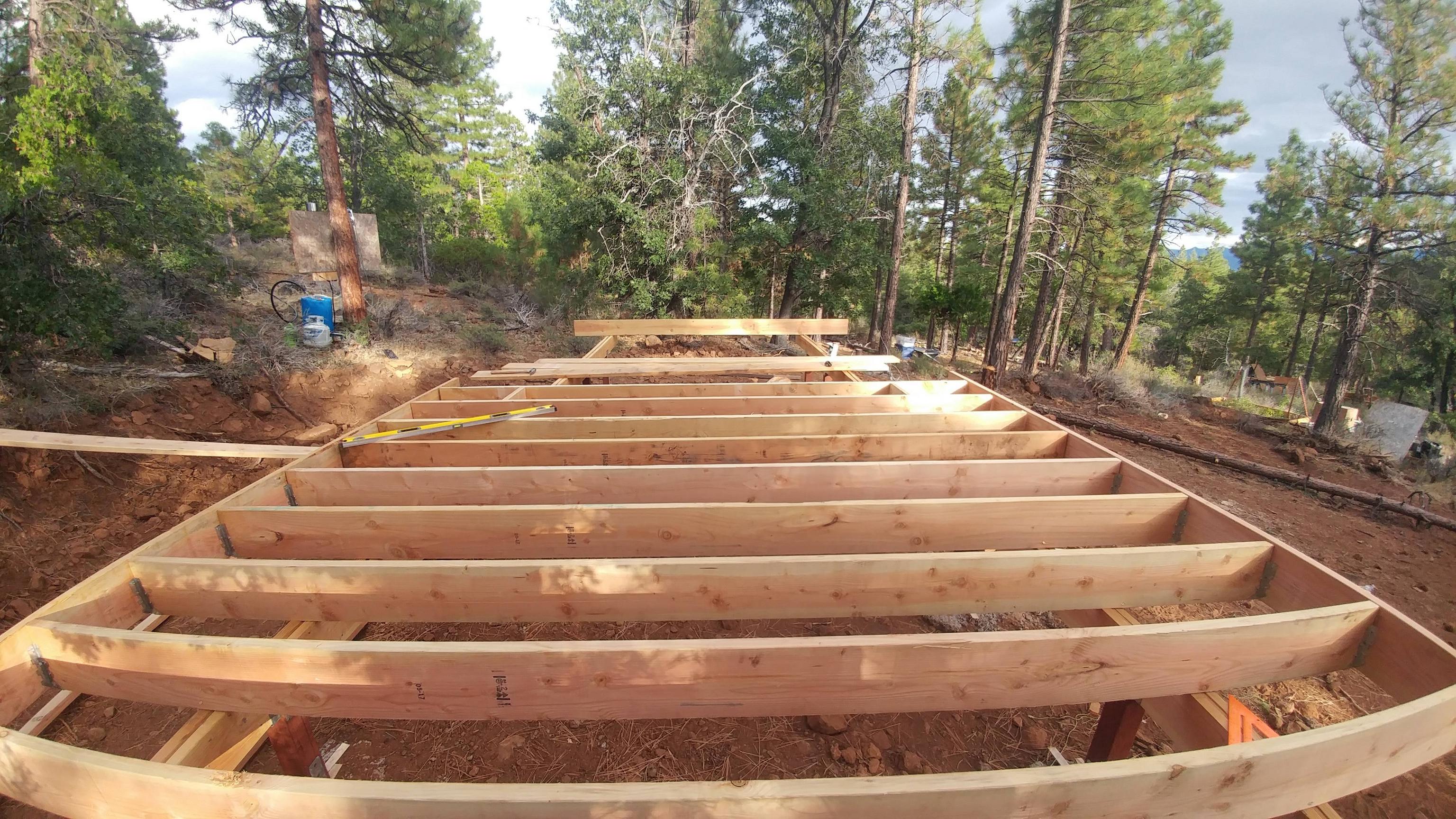

Anyway, heres a (nearly) up to date picture, I'm two joists away from having the platform done before I can start putting in some subfloor to dance on!
You are not illiterate
don't forget to block between joists over the girders  ;).

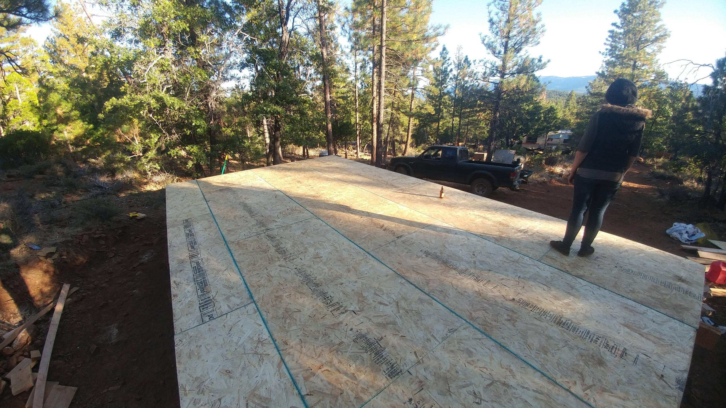

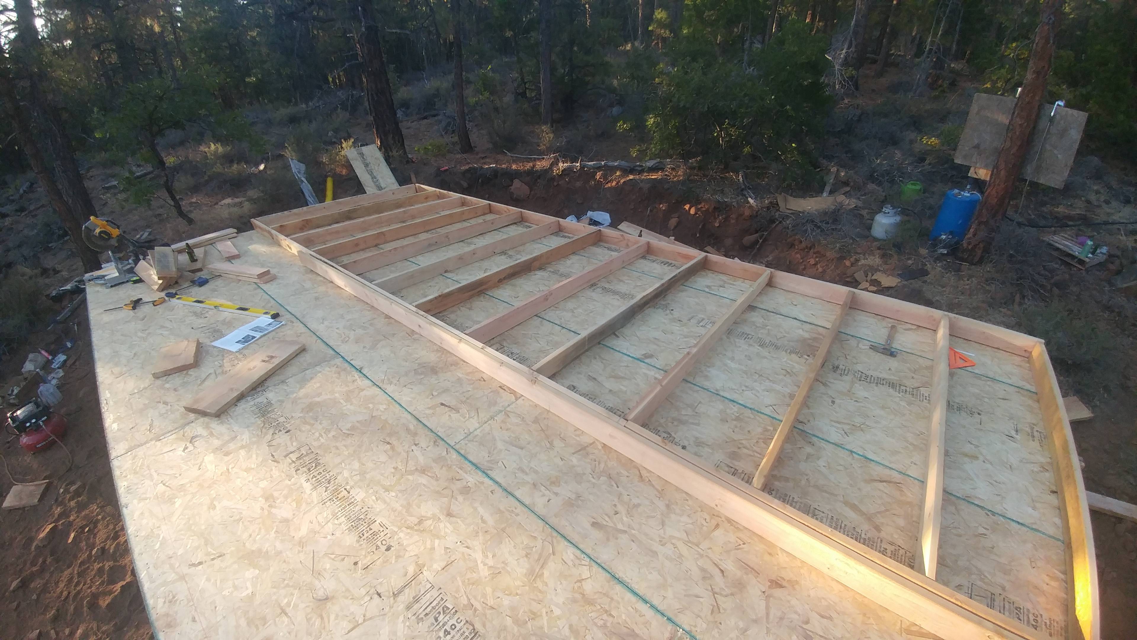

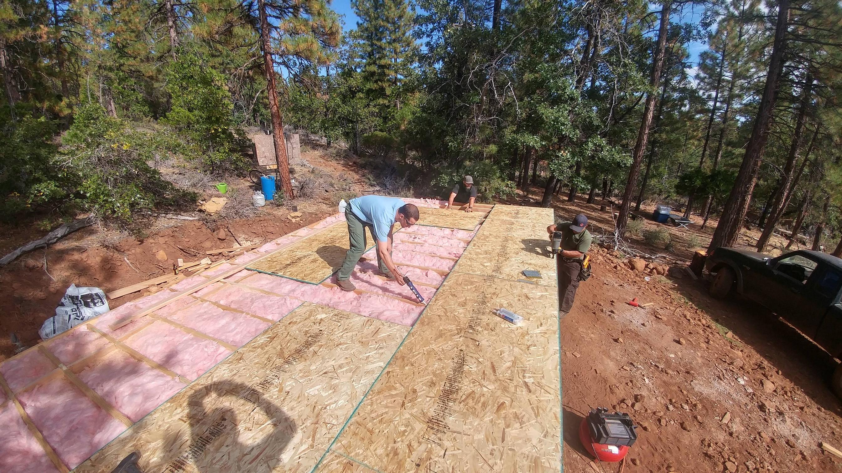

Alright, made some progress this last weekend, really feeling the pressure to step it up now before the weather comes, luckily I think we'll stay largely snow/rain free for at least a few more weeks. Got the blocking in, 'X' bracing, insulation, and subfloor.
We all gave a pretty good dance on it in celebration but sadly I forgot to take a pic of that.
I also started laying out the rear wall since there are no openings I figured that'd be a good way to ease into the other walls.
Should I vapor barrier the underside of the floor joists? I'm eventually just going to sheet the bottom to keep out little rodents and wasn't sure if that'd be sufficient.
Next step will be raising/bracing this wall and then working on the front wall, that sucker is going to have 3 4x6 windows and a door so I'm sure i'm going to spend quite a bit of time head scratching and cutting to make sure everything is laid out ok.

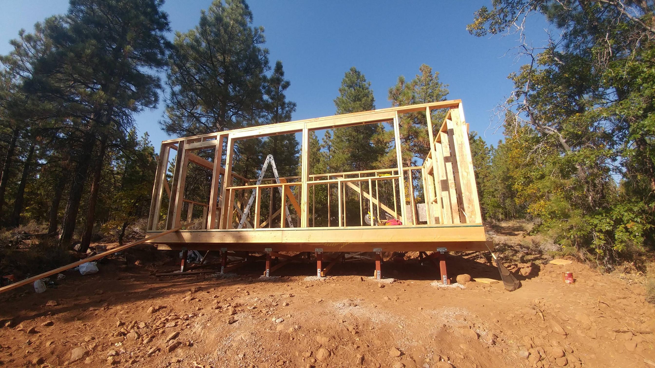

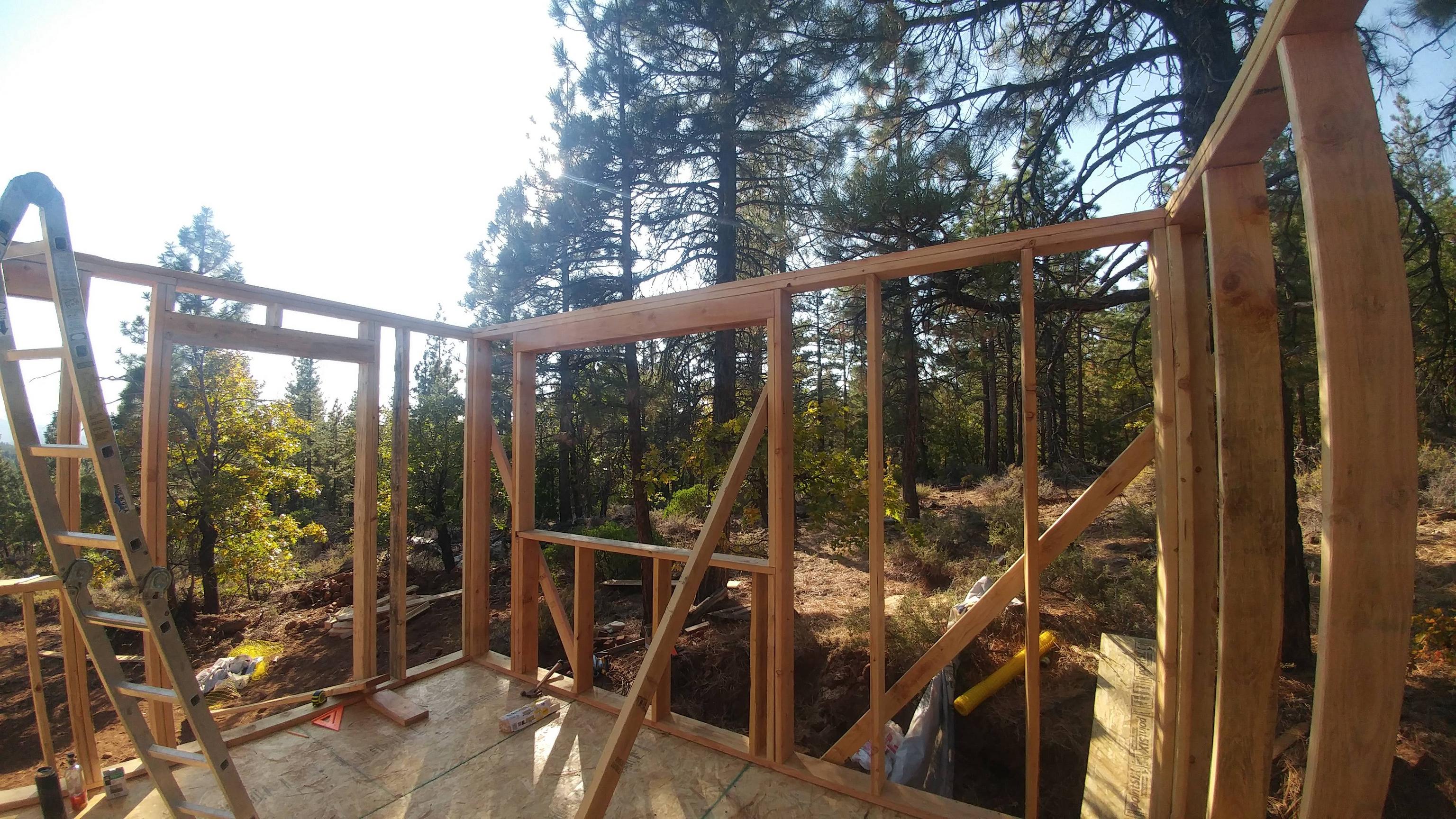

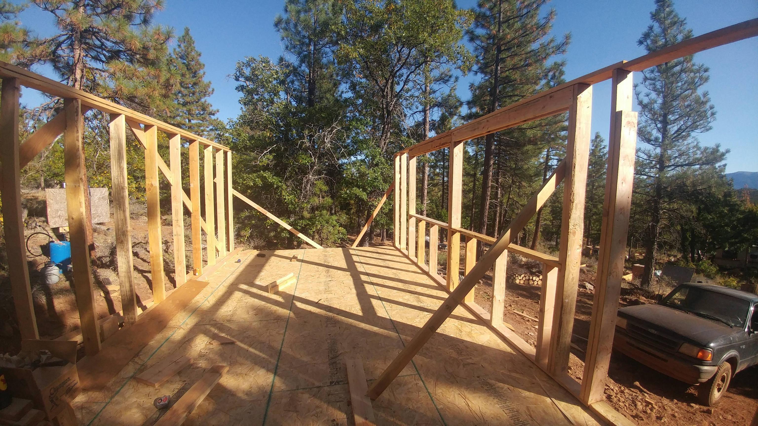

Alright! Wooo! Finally got all 4 walls up, nailed, plumbed, and straight!  :)
So, a few things have changed, first off, we decided not to put the 3rd large window in the front.
Also, due to my inexperience and wanting this thing to be as sturdy as possible, I decided against the 10' walls figuring that if I can slightly lower the total surface area on the windy side of the house (left side if your facing the front) it'd make me feel a bit better about everything, so 8' walls it is.
Now the concerns/questions.
The truss tech has said it will be around 1 month before I can get the trusses built due to their backlog, which made it difficult for me to try and figure out exactly how tall the end walls would need to be since I'm not sure if the trusses will have a seat cut, how deep it would be, etc (just intimidating having not done this before).
After talking to a distant friend of mine who frames for a living, he recommended that if need be, I could likely build a gable end to fit the inside of the end truss, and then switch my sheeting orientation from horizontal (on the lower portion of the building) to vertical over the hinge that would be created.
So as you can see, I have 8' butt walls.
Now here are my questions..
1. would this provide adequate strength? I know I am creating a hinge but could I realistically have a strong roof doing it that way? If not, would I simply be better off (in terms of both strength and loft headroom) building a standard rafter roof now that the walls are shorter? The inside chord of the trusses is only 8/12, so I'm thinking 12/12 rafters may give us a bit more room up top... What is going to be the best combination of strength, cost, and headroom at this point?
2. If I DID build normal rafters, do they still need to be tied across the entire building length when they are only 8' or will the loft provide adequate stiffening?
3. Everywhere I look it seems like people have differing opinions, should I sheet the walls horizontally or vertically for the best shear strength?
4.. Before I dropped to 8 foot walls, I didn't clearly think about how that would affect my placement of my loft joists.  ??? as you can see below, I can't really notch a ledger as planned because the door header is in the way. What is a better way around this? Could I simply use joist hangers or some type of hardware to attach the loft joists to the studs?
thanks everyone for your help, with any luck I'll be able to get this sucker sheeted and roofed before too long!

In the 2nd picture I see no foundation bracing on that axis. it would be a good idea to sheath at least the corners before loading higher. All sheathing edges should be blocked solid and the perimeter of all sheets nailed on 4" centers. Although running the sheets laying down produces a stronger wall in out of plane bending across the studs it requires twice as much blocking. So, most people stand the sheets, I believe the shear is identical either way. Your framer friend is not wrong on orientation. I did that not long ago in a remodel, there had been bugs and rot, hopefully evicted. I ran 1 row of treated ply horizontally then stood the sheets up the rest of the way, blocking between studs and nailing on 4" at all seams as we went. A joist hanger is ok on a header if it is sized for it... those headers look a bit slim, could be the pic, did you size them from the codebook table? The cantilevered rim joist is really just hanging by nails rather than bearing and delivering load to on something under it. As such it is not a bearing point for a ledger for deck or stairs. Likely the house girder is not sized for additional load from the cantilevered side, whatever is in front of that door should be thought of as freestanding on its own foundation, simply tied to the building for lateral support not vertical. ... if you laterally support the building  ;)

Indeed! I suppose I got a bit ahead of myself and now I'm paying for it. the 'Y' bracing will be going on tomorrow, great suggestion with the attic trusses! I didn't even know those were a thing, I spoke with the truss tech and explained the situation, I also requested a 1 foot cantilever on each side. He was a bit concerned about me ASKING for a hinge but I assured him it'd be stiffened up nice and tight.

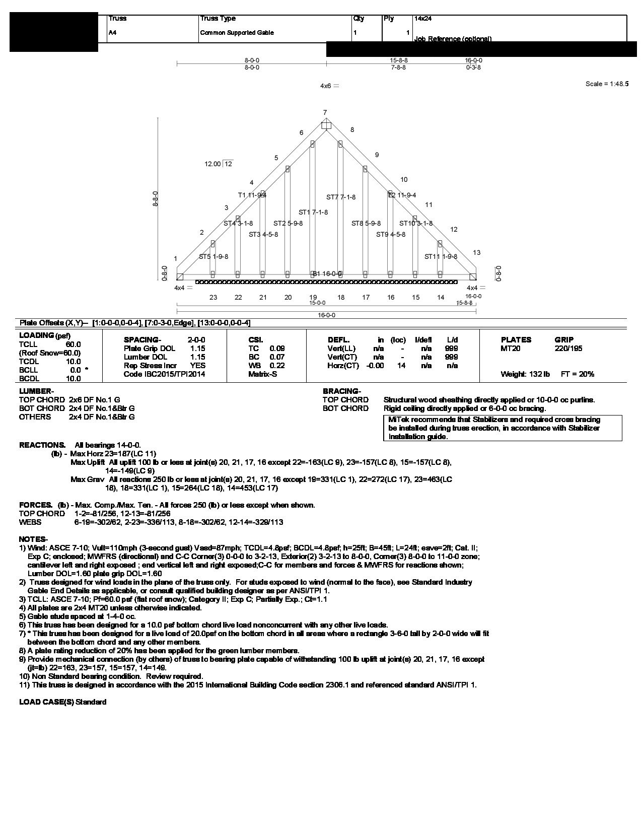

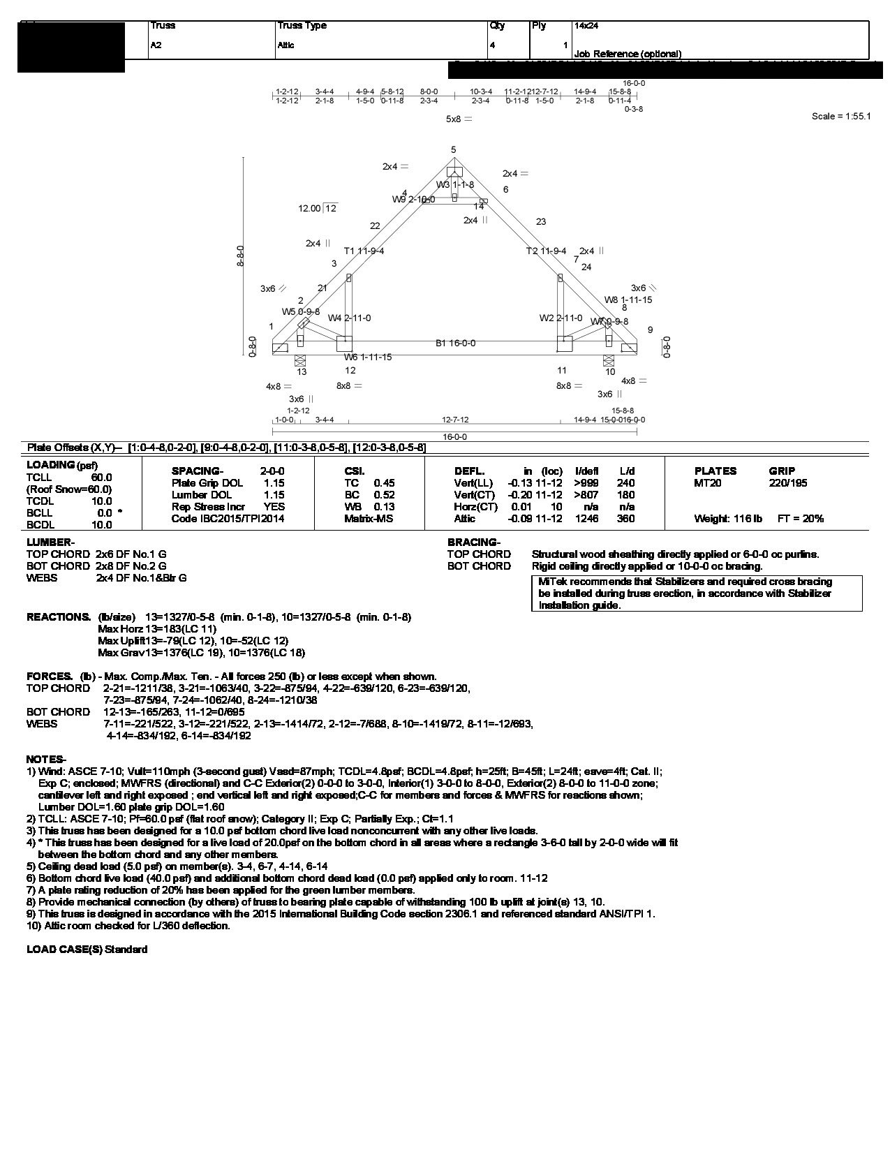

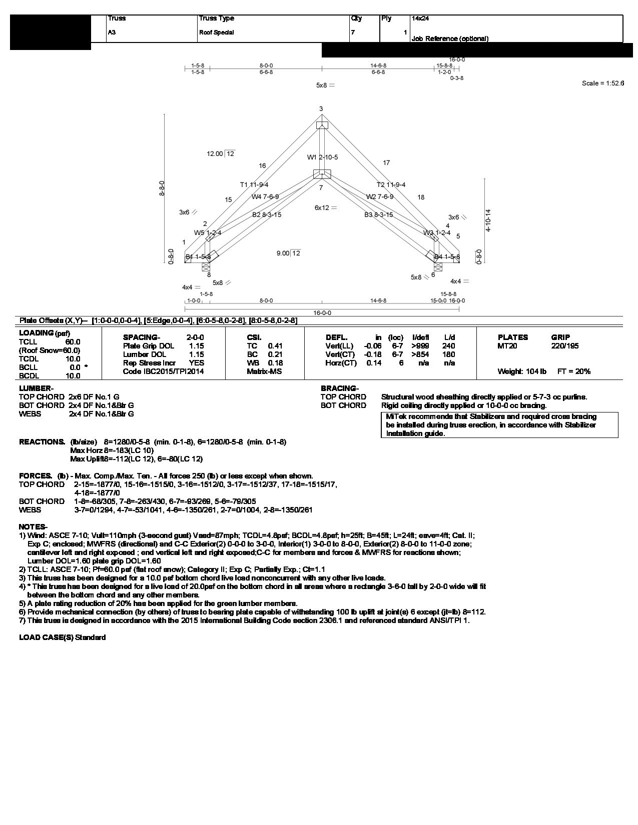

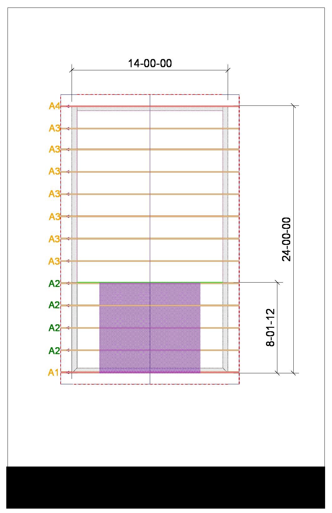

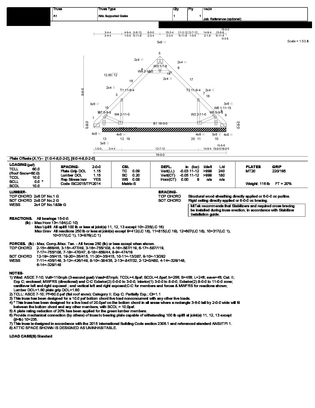

Here is what I've got now, I think this looks pretty dandy..if it gets a pass here I'll go ahead and approve the quote this week! Exciting!   [cool]
Layout
Trusses and end
I can't see on there where it mentions headroom, although Thats ok beacuse I really just need enough room to be able to sit up in bed, standing isn't too big of a deal.
When you mention sheathing the corners, the current  (8 foot) ply I have leaves around a 10-12 inch gap uncovered when stood vertically against the walls & rim joist right now, will I be better off just cutting a 10-12 inch strip to fit that or should I put the strip in the middle somewhere so I can have larger continuous pieces 'sandwiching' the smaller one?
Also I'm trying to imagine how the LVL would actually attach, that sounds like the best idea to me but I cant seem to visualize it very well, could you elaborate a bit?

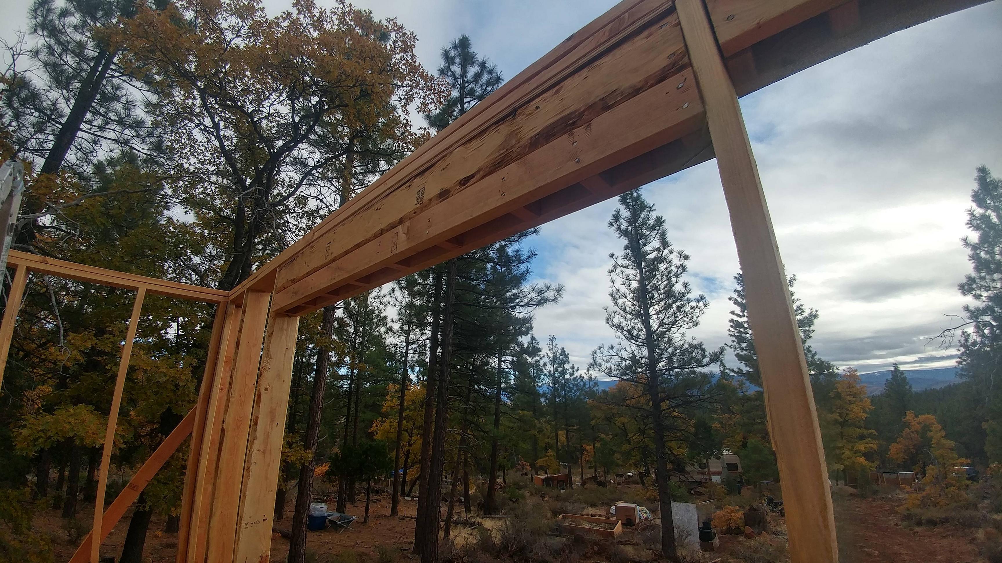

EDIT: Also, crap, i nearly forgot about it, good eye....I DID make 3 of my window headers too small, they are paired 2x6 and the table says they should have been bigger, this obviously has me feeling quite stupid and bummed out. Should I try and cut the jack studs and add in some 2x4 underneath the headers then lower the sill? Or will the steep pitched roof keep the loadings low enough that I can realisticly not stress too much about it?
I'd try for more headroom, if you are using fiberglass insulation the top chord needs to be furred down 6". Draw it cantilevered from 2' overhangs and I believe you'll get there. Have him drop the top chord of A1 and A4 for 2x4 lookouts.
The strip is fine, you'll need blocking between studs at the seam. I like to nail 2x blocks to the sides of the trusses, in line over the wall. Then notch the upper piece of sheathing to fit around and between the trusses, ending about 2" shy of the roof. This braces the trusses and airseals them up to the vent area for the roof insulation, keeping "wind washing" down.
since you are asking the tech to fire up the computer again for more cantilever... and since we have hinges on his mind. Ask him if he can wind model that gable wall with an lvl laying flatways atop the top plates directly inboard and attached to the gable truss.

Over windows?  Uunder a load bearing wall?  If a load bearing wall I'd cut down the jack studs, remove the 2x6 and place the correct header.  I know it's a tough one but do it right today and not worry tomorrow :D

I had him add a foot of cantilever and change the chord for some lookouts, but unfortunately he said his software isn't able to test the wind in that way.
I went ahead and placed an order for the trusses as everyone seems to be backed up right now. Unfortunately the trusses wont be done until late nov. or early dec.  :-\ Obviously I'll throw a tarp over it but I'm almost debating if I should just do some kind of SUPER simple low pitch shed roof or something until spring and just throw the trusses up then. Either way it's gonna be close with this weather! Should be exciting. Stay tuned!

QuoteI'm just building a smaller 2x4 header and placing underneath, this should give me enough strength equivilant (or nearly so) to a 2x10
Stacking members provides the same strength as putting them side by side, it does not provide the same section as the deeper member of the space it occupies. Or, two 2x4's makes a 4x4 not a 2x8... a section modulus for bending strength of 7 vs about 11, a little over half strength.
flyingvan
Maybe I'm looking at the picture wrong but I don't see any jack studs.  Is that header addition supported by nails alone?
