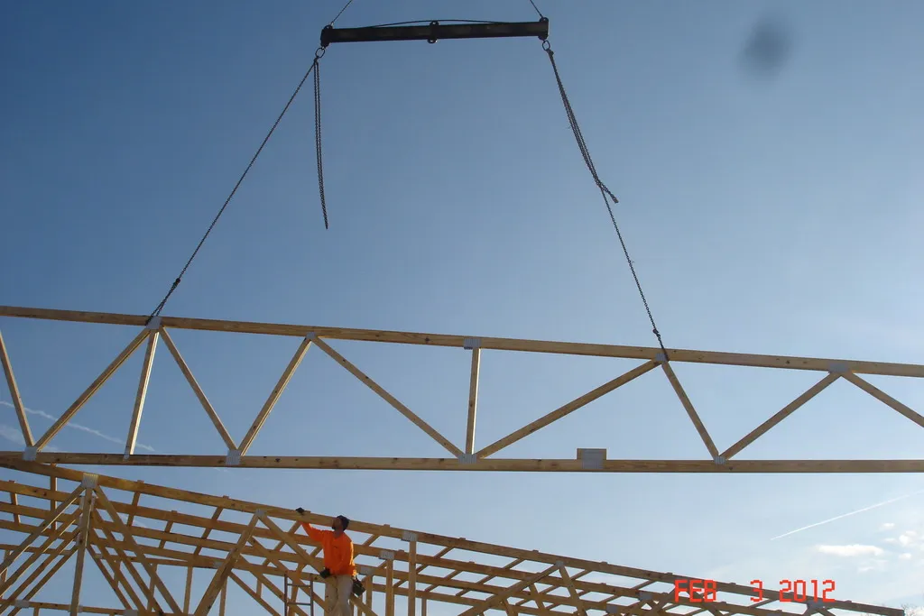

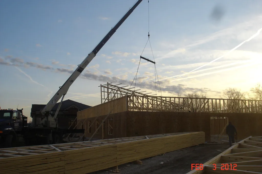

garyc
This is a building that I built in 2012 using mono trusses with a 3' heal. These trusses are 64' long with a 1"-12"pitch. I built this building for my business.
If it wasn't for bad luck . I would 't have any luck at all.
Medeek
That is a crazy span.  The webs in this truss are very interesting, a Warren type truss mixed with vertical webs (modified Warren).  I am curious as to how they arrived at this design.  You can tell these trusses will be under a signficant load, look at the splice plate and additional blocking on the bottom chord.  The scale of these trusses really comes to light with the construction worker in the photo (second photo). Thank-you for sharing this.
