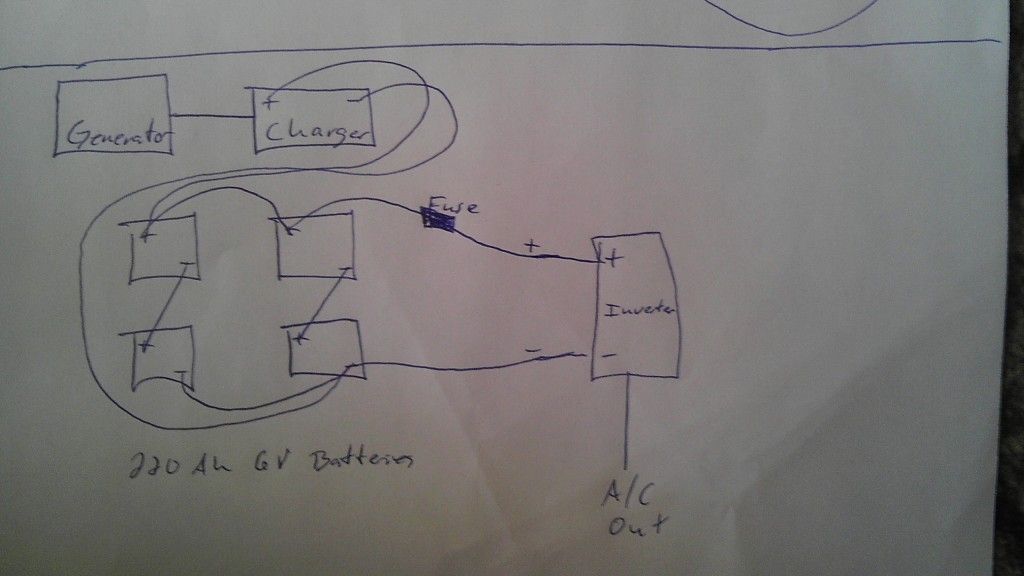

I made the purchase of 4- 6V Costco/Interstate 220 Ah batteries and a 2,300W inverter. I have a 2,000W Champion Inverter Generator that will be connected to a 25 Amp charger to charge the batteries until I can add solar. Now, I am pretty certain I have sketched my system correctly, I just need some guidance on how to add the charger into the system.
I will add the sketch soon, but for now, do I just connect the leads from the charger to each end of the battery bank at the same terminals where they go out of the bank to the inverter?
Thanks

I ran my 55amp Iota charger directly to the battery bank (using a copper bus bar where I also connect my charge controller and inverter) so I think what I see here is the same?
The only issue I've ever had is with my Morningstar MPPT controller which didn't seem to like the Iota charger set up that way for some reason but today when I need the charger (very rare) I just kill the breaker on the MPPT controller and leave it off while charging with the Iota charger and Generator.  Saves guess work.
4 Costo 220ah batteries?  I didn't see you requirement but I run 8 at my cabin and with a Refrigerator running on the system I don't have any issues even in the winter though I think 10-12 batteries would have been better for long stretches without sun.
Course it depends so much on everything you're running and if you don't have the fridge then you probably can drop half the batteries! lol
