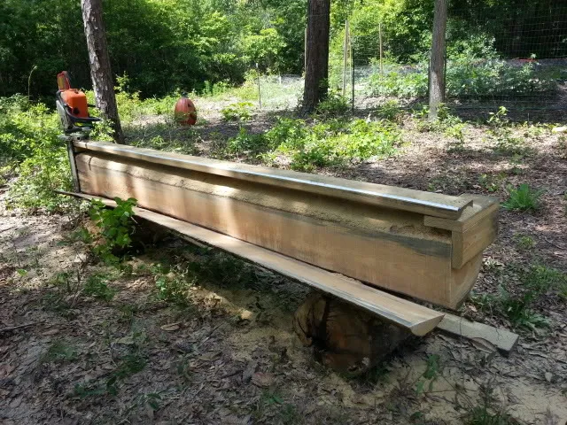

Not much work has gotten done but I have been working on the log for this the center support and I started cutting beams for the loft floor joists with my chainsaw mini mill from the other logs I have left .

I was surprised how nice they turned out.  Setup of the first cut is crucial.  This isn't really intended for making that firstcut it thisk kin but you see how I did it.  I am sure they would much rather you but the $300 Alaska mill to slab the first cut or two but I wasn't doing
They sell a ripping chai . That they say will cut better and faster.  I just used a new chain is had and it cut just fine on my 64cc stillwith 20'' bar.  Every cut got a little rougher so keep it sharp.  By the end of the day yesterday I was getting pretty rough cuts but for me that's fine.  We wanted thatrough cut look

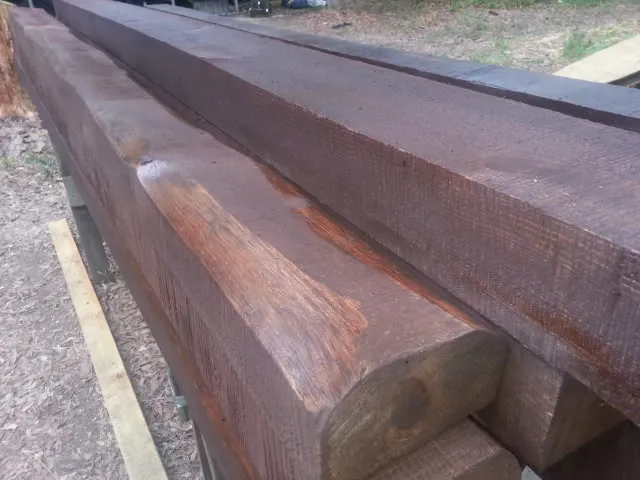

stained the beams. it is only a medium walnut but the rough cut sucked up like a sponge and it's a bit darker then I anticipated. will look good against the blond floor boards though.

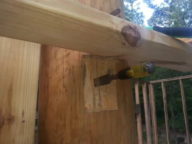

noptched the sides of the log to accept two of the beams

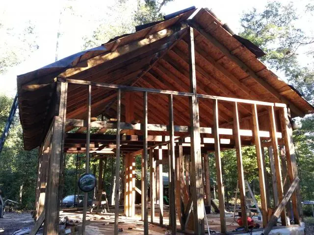

got some of the rafters in today. I have about half the sheething for the roof ready to be put up also.

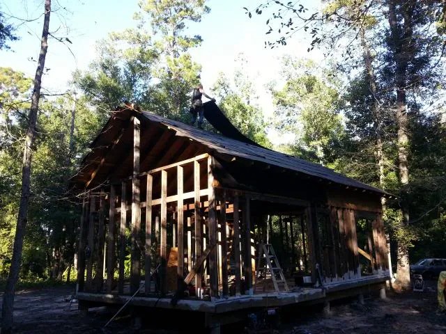

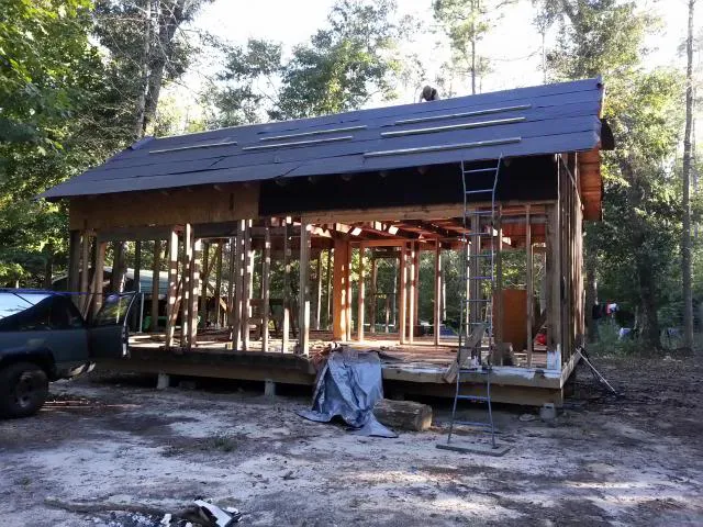

managed to FINALLY the the roof rafters and sheeting up and it's tar papered. I had it all done except the middle row last weekend and now it poured rain for two days and I was off work. All I could do was look out the window and watch my osb and house get soaked. but it's done now. Now I save up for the metal for the roof. Silo has been broke down for last 4 days so paycheck may not be enough this week.
I managed to get a kid I was working with at Lowes to help. Paid him $200, he likes heights and I hate them. he's like a spider monkey up there. i cut and handed sheets up and supervised him, he nailed them off and papered it. He's a hard working kid I'd pay him more if I had more
I am going to buy some scaffolding next week and we will hand the barge rafters and drip edge then get started on the metal. it's not been fun working around all the twisted wood from being out in the rain and now I'm going to need about 5 gallons of bleach to spray all the wood down
