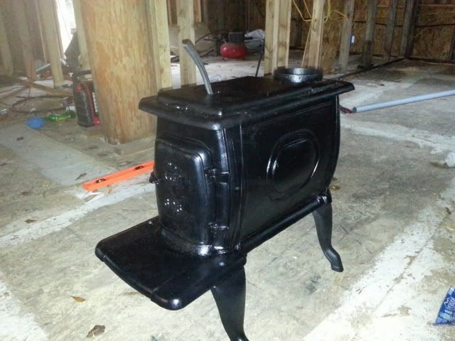

My new old stove. It had 2 broken legs no door pins and 50lbs of rust
After a lot of elbow grease and some paint. Two new legs a handle to open the top plate new door pins and a new log grate. All in under $100.
Once again its good to yave friends. This fame from the guy who helped with my roof. Guess I paid him enough. N3ar as I can tell its pre 1940s. Im not sure if I want to use it in my house though. Kinda scarred. Lol.
This is a king stoves and ranch model 626. After researching i5 the company was sold a few times. The last co that bought it was us stoves which still holds thr patent on this stove and still produces it with amazingly few changes. Thankfully b3cause of that I was able to buy brand new parts and they fit right on it. The legs are about 1/4" shorter so I can either stick an extra piece of tile under them or order two more to replafe the other origionals. theyre only $11 ea
Nice gift.  You should be able to lay a decent looking floor with it.  Maybe have to mix & match to get a quanity to fit in your rooms but still cool.
Yep the old "box stove".  Good for instant heat but lousy on keeping a fire very long.  Better sleep close to it and have your wood pile about that close as well.  Probably be good for the shop just to take the chill off and burn up some scrap lumber if you are into wood working.

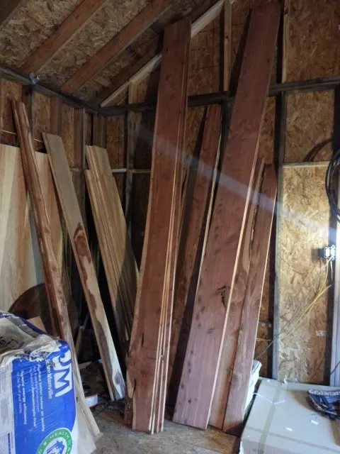

I scored a good deal on some cedar last week.

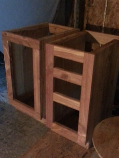

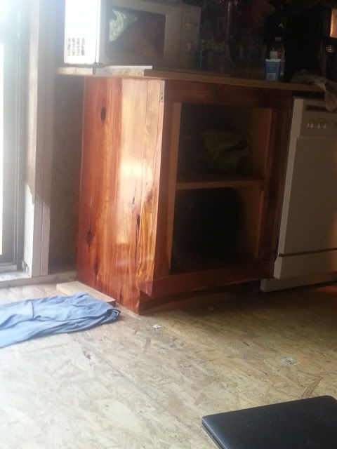

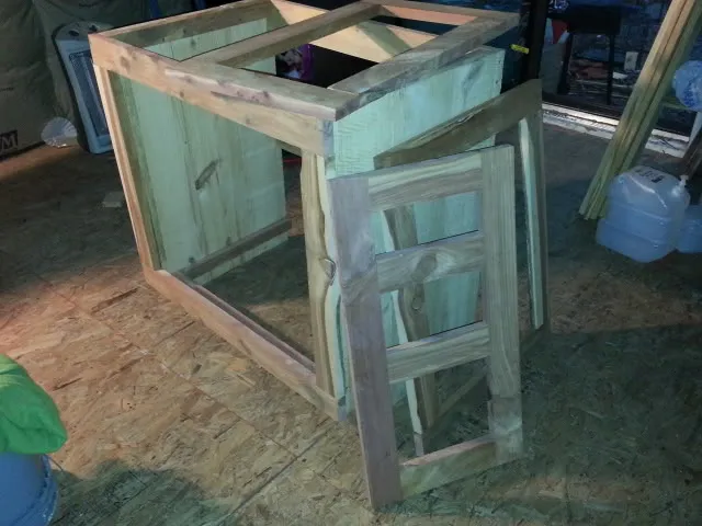

So I started making kitchen cabinets. Got one done and the frames for all the rest of the lowers. I will make more boxes tomorrow. Making those out of rough cut pine and the faces are the cedar. My camera flash washes out the red though.

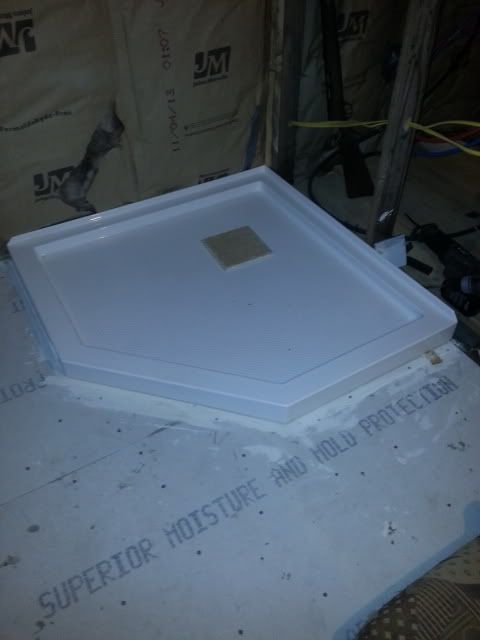

I also set my shower base. I overspent last week with the cedar deal I ran into and valantines day. So I have to wait to buy some spray foam and tile backer board. I have the shower valve, I could start plumbing it in but im afraid I may need to return it to pay for food for the rest of the week. Hate it when I mess up the budget

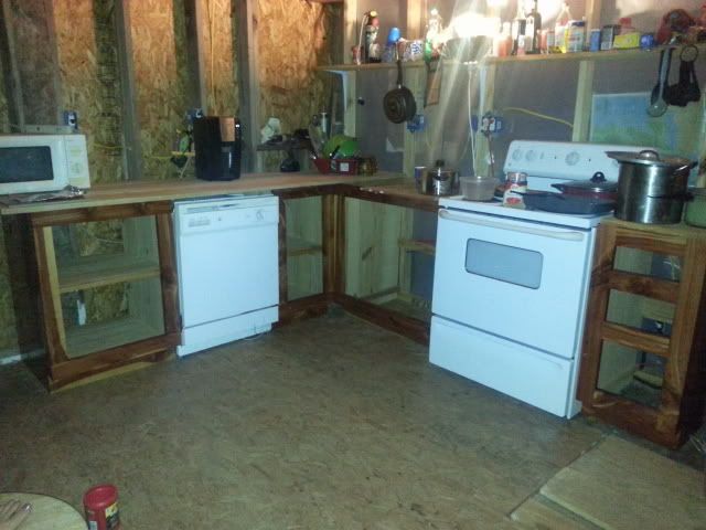

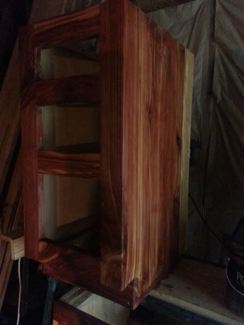

CjAl
I got my cabinetes finished. Well not c0mplete but the finish is on. I need to make doors and add drawer slides.
I am off thursdays and fridays now. I will do my upper cabinet this week and tey to get doors done.
I also started paneling the bumpout in the bedroom. Rought cut pine behind the headboard and cedar on the sides.will look nice when its finished and sanded with some poly on it. The rough pine is ship lapped and stained with a light walnut

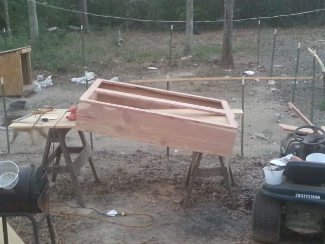

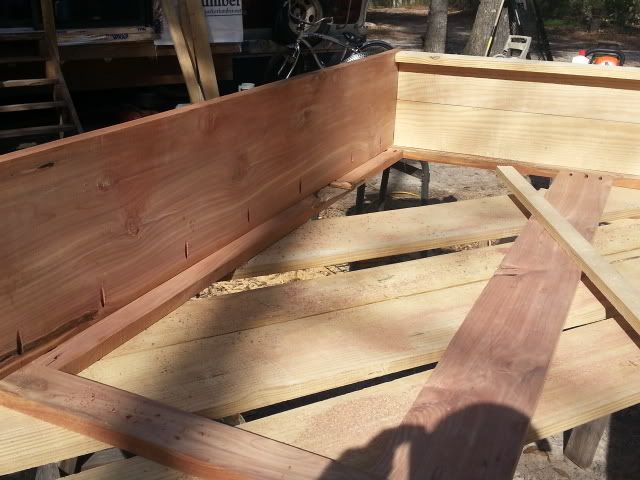

CjAl
This is going to be one big upper cabinet. 5 1/2 foot tall and 50" wide. Going to be real fun to hang.
