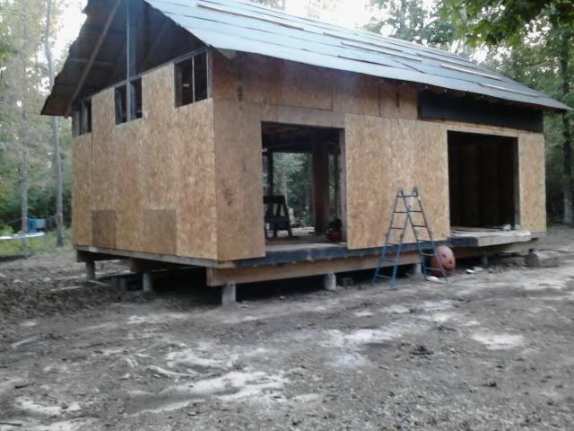

This is where I am now. Going to get the sheathing for the back wall todsy then I need to go buy some scaffold. Work is supposedly starting back up tomorrw.
CjAl
Look ma, no doors!
With being off work almost two weeks it looks like It will be a month before I can buy metal now.the tar paper is vonstantly coming loose.
Anyone know if it would be a problem if I rolled out house wrap over it and stapled i down? Would I have to remove it befor I put the mmetal roof on?

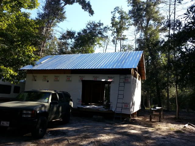

Well it has been a long road but the roof is on.  I still have to put the gable end trim on but it's dry.
Now I just have to frame out the bump outs,  frame the gable walls and finish the sheeting up there and get some French doors.  Then I can start the plumbing and electrical.  I have a tax return coming that's is going to pay for my septic

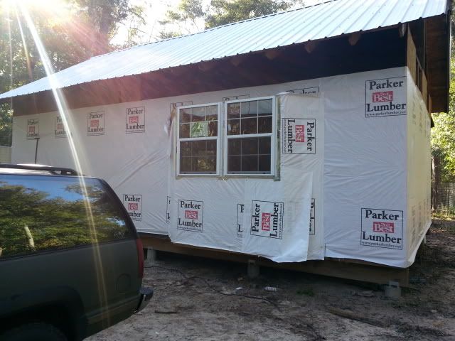

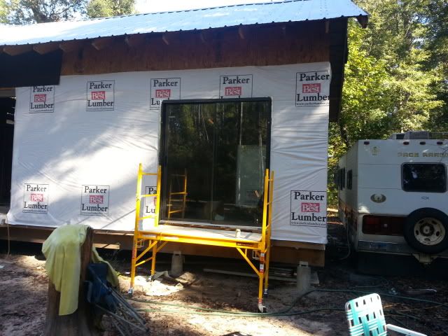

Thanks!  I still have to go around the end of the sheets and put the screws in the edge.  My helpers leash wasn't quite long enoughto let him reach them.  I bought some scaffold yesterday so iin will get on that.  Still have to put the gable end trim on too.  Work has been going full on.  I tried to take this weekend off to work on it but called in both days.
Igot a 6' sliding doors new for $100 off a local Site that's kind of like Craigslist.  I got it half installed before it got too dark last night.
I got the front bedroom bump out framed in and two windows installed in it.  Pics to come

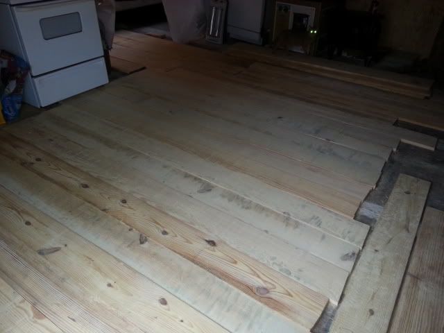

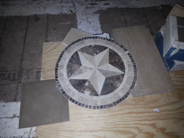

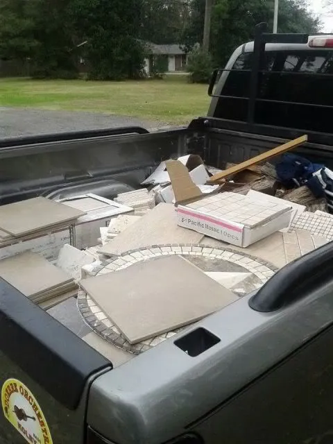

I have some friends who sell flooring and they brought me a great present.
I had a bunch of 1x8 and 1x12 cut at the sawmill to use for flooring.
Pics to fallow as I can get thrm to upload on this miserable internet connection

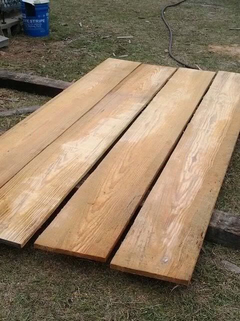

CjAl
Some of my flooring laid out to dry. This is very green 8". I know this isnt a great way to dry wood but I am out of room and the old subfloor is very weak. I have a stack of much dryer stuff in the loft area. All my 1x12 were cut out a very old very dry log so I am going to lay that stuff in a few weeks.
Some of my bigger flooring
CjAl
This is a bit of my guft from my friends. Its good to have friends
