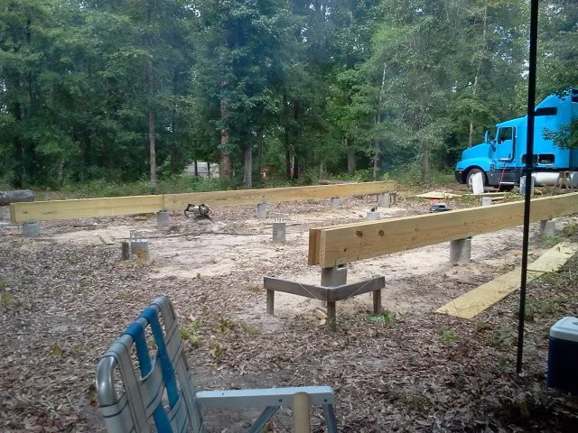

i ordered the lumber for my beams. that was a quick $700. had to run out and put up an address sign for the delivery guys. couldnt help take a few pics
CjAl
this is harder work then it looks. just me and my wife to haul the PT 2x12's and of course since i had them delivered i got a bunch of cupped and warped boards.

looks like i wont get my beams done untill next weekend or later. rain yeasterday and today lisa doesnt feel good enough to help me lift the beams. i just have to square up the two i have, screw them into the brackets and build the center beam
Quote from: CjAl on July 02, 2012, 11:31:40 AM.....  doesn't feel good enough to help me lift the beams. .
Are you building the beams in place, on the piers where they will sit? Easier that way.....
