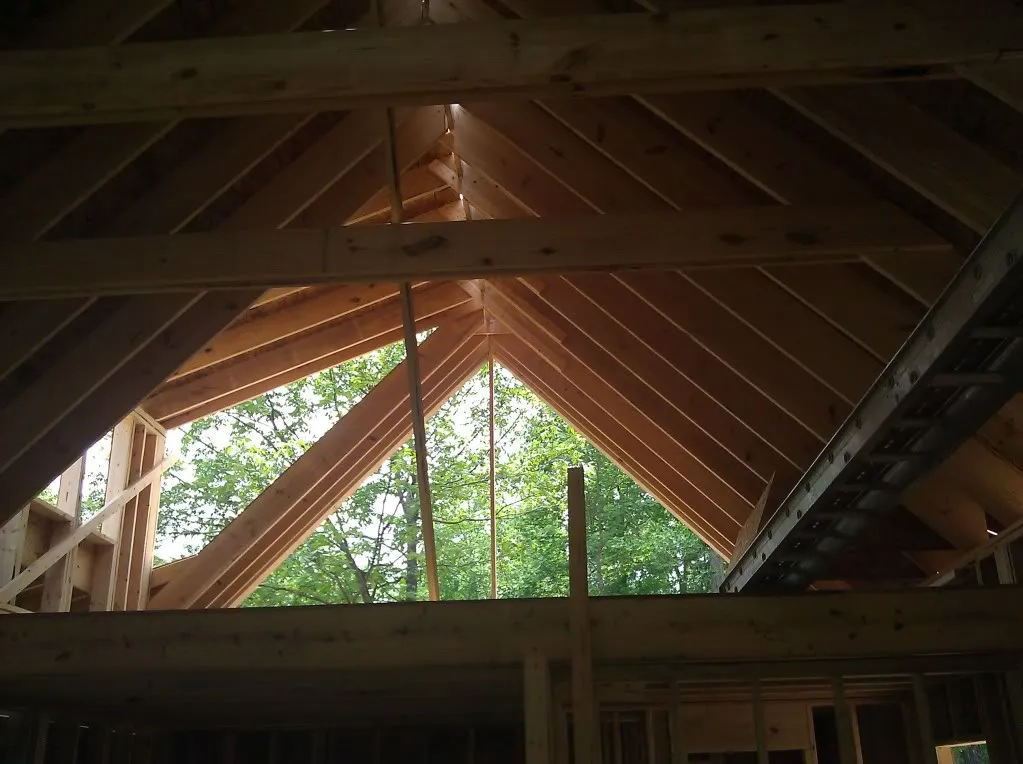

he told you to leave the rafters cut with a gap below the ridge board? doesn't that right there nullify any further info he gave you since everything I have heard is to have the gap at the top otherwise the rafters will split.
unless my math is wrong, couldn't he use three 2X12's nailed together as a ridge beam with a support in the center? run tripple 2x6's up the full length of the gable end walls and one 6x6 up from the floor in the middle of the house (probably right where the roof pitch changes anyways) and run the tripple 2x12's across the top of them and cut common rafters to sit on them?  You can go back later and wrap them with a thinner cedar or something if you want a "pretty" beam at a fraction of the cost. It's what I plan on doing. I don't have my figures in front of me as I'm on the road sitting in my truck but mine is 32" and if I remember corretcly the load calculator came up about a foot short for tripple's being okay for my application. should be just right for him then.
metolent
That's close to what I did CjAl - well, except that instead of building up the ridge beam and posts, I used a 6x16 glulam for the ridge beam, and solid 6x6s for the 3 posts holding them up - picture below.  He would have to probably change the wall structures to get the posts in, but that's not a big deal.  The thing I would be more concerned about would be transferring those point loads to the ground given the steel post foundation - I'd have to do some math ...
Seems like the easiest thing to do would be to go to engineered trusses given where things are now.  For me, I wanted the open ceilings, so a ridge beam made the most sense, but then I designed the foundation and walls for it as well from the get-go.  If you really want that upper dormer, I wouldn't give up on it now because 6 months after you're build is complete you may regret not spending the time/money to get it the way you really want it....
ellbaker
So what should you do if you wished this thread was active a year ago?  My framer added a shed dormer after I asked for one during the build. My dormer is a 4:12 pitch.  I do not have rafter ties in the dormer section.  Framer said it was no problem, he does it all of the time.  Any way to fix this now?  My ceiling is finished now.
#321
Dangling rafter plumb cuts as well.
Tie it with a level ceiling would be one way.
At this point I would monitor it. Pull a tight string from corner to corner along the top plate of the dormer wall. Is the wall straight or bowing? Whatever is there is likely the same at the ridge. This is now reaction, you've realized too late, hoping to have Al's done pro-actively.
If there is a wall under the ridge it will act the same as having a beam under it... Al has this but look down, the floor was likely not designed for the load at midspan. I have this going on in my house, no ties, ridgeboard construction, roof sagging and wall bowing. There is a cross wall and an in line wall under the ridge that took the load as the roof sagged, it held,  but the floor now has a permanent sag from supporting the roof, the wall leans out, the ridge has a sag. If that inadvertant wall had not been there I'm pretty sure my roof would have snapped thru in a freak snow. We had my naive design load path and mother nature showed the actual load path. My floor is dimensional 2x10's at 14', this is I joists at 20', my ridge is 2x12 with no span between support greater then 12', this is 2x8. I am well beyond code but so far within the ultimate strength of the material. I've debated popping the top and trying again several times, that's working behind the ball, reaction. I've simply had about a hundred attempts at getting it right since. Hopefully we can save Al a few practice tries.

Wednesday Night - February 29th, 2012 Mid-Oklahoma
I got another truss quote today. I told the truss builder that at the half way point (the
15 foot point), that's where one pitch will change to another. I can give you all the facts
in text right here but I'll post a picture and the two jpg files that the truss company
emailed me. Just to let you know, I emailed the truss builder my plan information and
also a 3D rendering of the 2nd floor so he knows what kind of house these trusses are for.
One question I have about these two different pitched trusses coming together is, will one
truss be nailed up against another truss at the point of change or would there be some kind
of blocking between them?
Now, the biggest thing about these trusses is that they are all 2x4's - that sounds weak...or is
it just me? They are rated for my build and the truss builder said that they'll be stamped by an
engineer. Please let me know what you think.
Here:
And here are the actual jpg files of the quote, one is the 12:12 pitch and the other
is the 6:12 pitch:
Click here to see our 20x30 and here to see our 14x24.
You have two solutions to the same problem. These are just different from the first. These are more typical of what I envision when I see the word truss. These are commonly made with 2x4 lumber. It's a special grade you will not find in HD or Lowe's. It is not the size of the lumber that matters, it is the engineering that goes into the creation of the individual components that make up the whole. The different configuration compared to the first truss from a while back means the interior will look different.
Less lumber and of smaller sizes results in a lower cost.
Depending on how much insulation you would like out where the truss rests on the wall, you may want to ask this second company what it would cost to have raised heel trusses made. There are some extra pieces and that lifts the truss up off the wall plates to give more attic insulation space. IMO, it is worth the extra cost. Whatever insulation amount you figure is good today is probably not what you will wish you had ten years from now. That's my opinion, as heating and especially cooling costs will do nothing but continue to increase.
I did not take the time to see what the actual headroom would be under the truss centerline over any loft floors.
