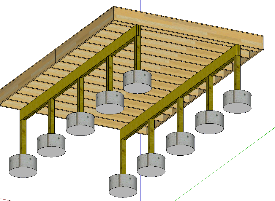

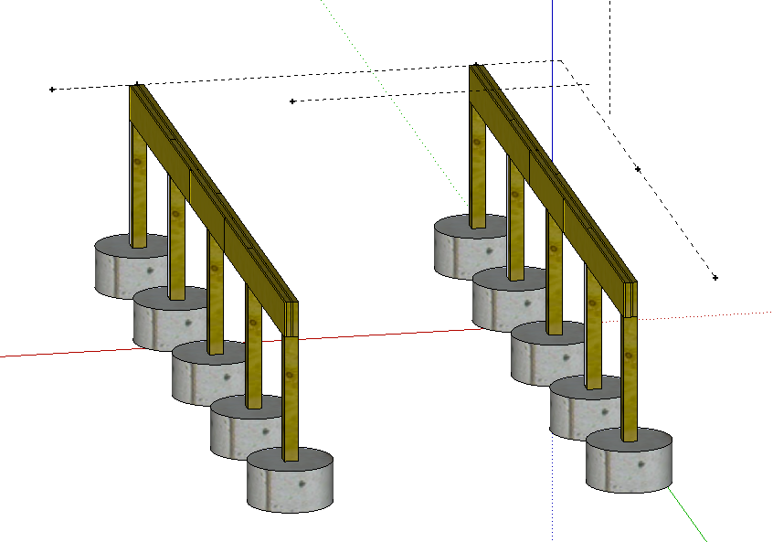

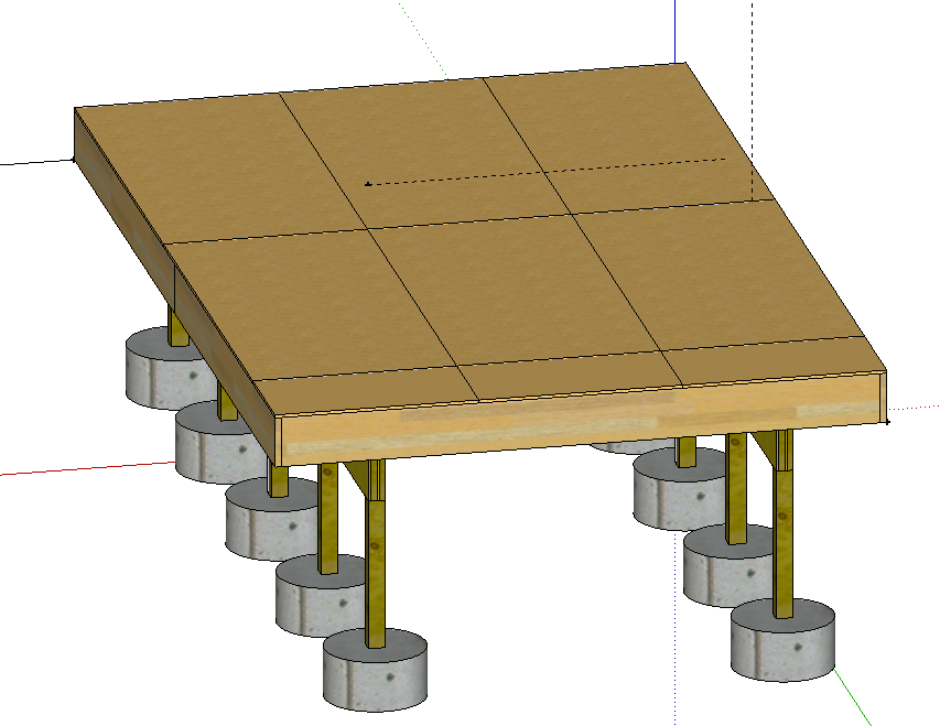

I have done something interesting that as an IT guy you may find intriguing.  I am using Google Sketchup (free program) to virtually build the structure from the ground up BEFORE I put shovel to dirt.  I'm literally starting at foundation and building up stick by stick and sheet by sheet as if I were really doing it, and comparing that to what Wagner and the plans say to see what I am forgetting or what things will interfere with each other.
Here's some screen captures of work in progress doing that on a small (12x18) cabin.

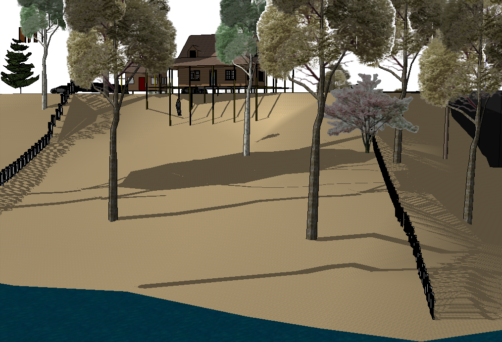

With it you can also do some lot modeling as I have done here.
Even imported trees that others have created.  There's a big 3D library online.  Sketchup is pretty easy to pick up.  I went from never heard of it to this in about a week or two of fiddling with it.

Oh, and for the record, I think my build on those beams is wrong.  It's a sandwich of 2x Pressure Treated and 1/2" Plywood with staggered joints, but I think I also want the joints to fall at the post locations for increased strength.   :)
Nice sketchup work.
Yes, it is preferable to have the 2x joints fall directly over a pier.
PT wood is not required for the beams if it is more than 6 inches above the ground. Ideally the beams should be a foot above ground level to make it possible to crawl under the beam. Then a minimum of 18 inches to the bottom edge of the joists. Only the piers need to be PT wood if the above is followed. In a real build you would also have diagonal cross bracing between piers and beams and piers and joists.
Also, on the floor sheathing, in a real build those panels would be staggered so there would be no place where the corners of 4 panels meet. Flipping the center row of panels would do that. And to be correct a row of blocking down the center. Nice job, but it is just missing those details.
