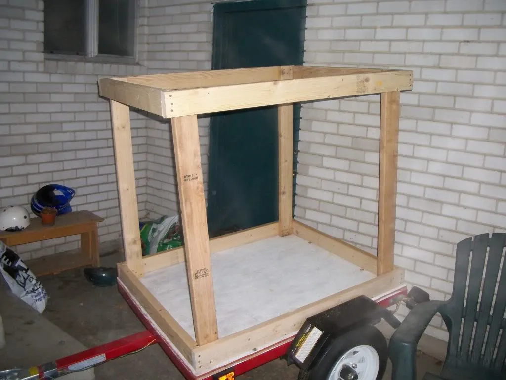

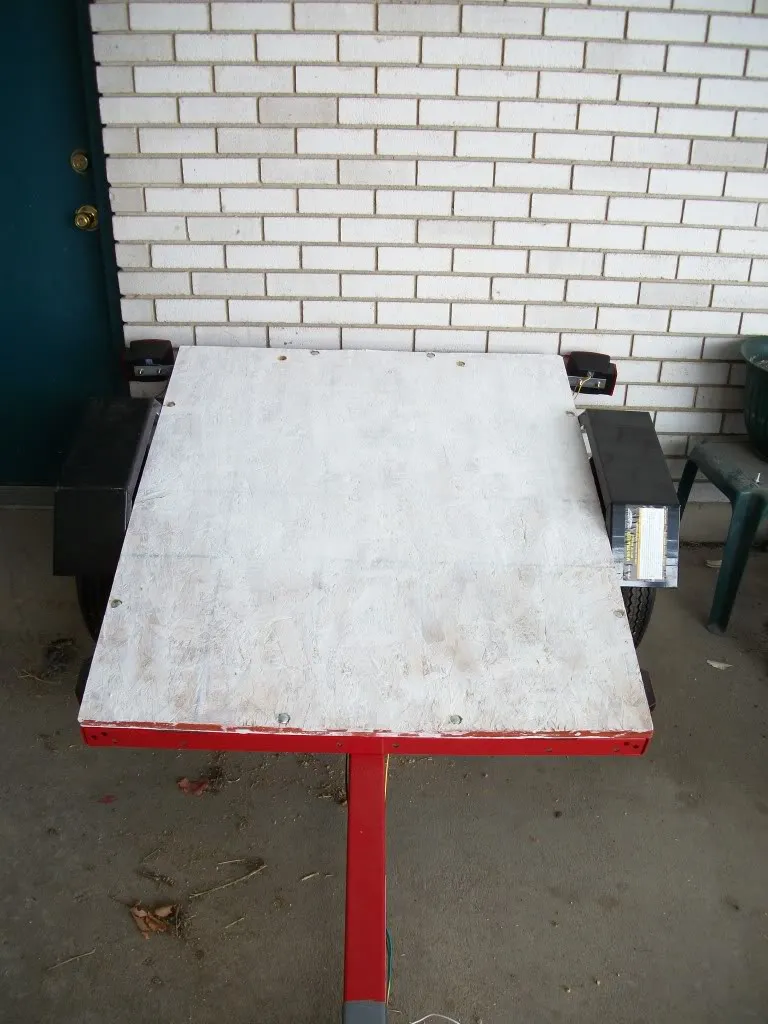

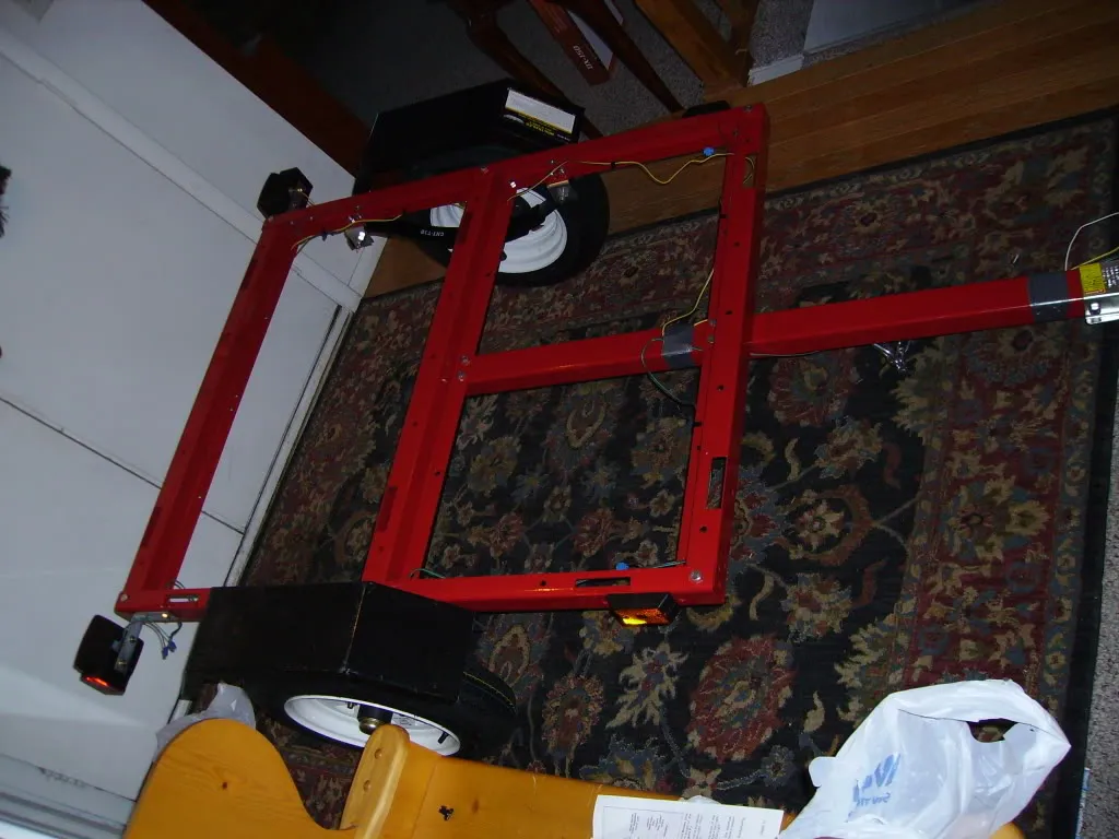

Several months ago there was a thread talking about solar power trailer.  It peaked my curiosity and so I started to research the possibility.  After some research I decided to build one.  I had a 800 dollar budget and started it in the late winter.  After a few starts and stops I completed my trailer a few weeks ago and got it hauled up to the cabin.  It works great and supplies all the power we need.  I run an extension cord from the trailer to the cabin.  I have a power strip in the cabin for everything that I need power for.  It works way better than my generator.  Here are a few images.

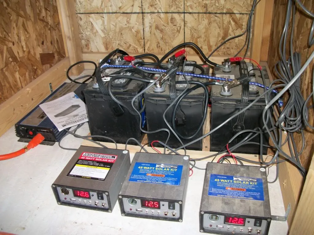

  Would you please take the time and post a wiring schematic.   With the various components you used . . .

The  trailer is on sale once a month for 150.  Get the one with the 12 inch wheels.  It will travel much easier with less bounce.  It is also the smaller
one, not the 4X8 one.
As far as wiring goes, the three batteries are wired in parallel.  The output stays at 12 volts but the amps are tripled.  I used a 12volt inverter.  It is very easy to hook up.  Pos to pos and neg to neg.  If you have access to a different inverter I would get it.  The cost for the habor freight one very good but it is very noisy.
I keep an extension cord and pair of jumper cables in the trailer just in case.

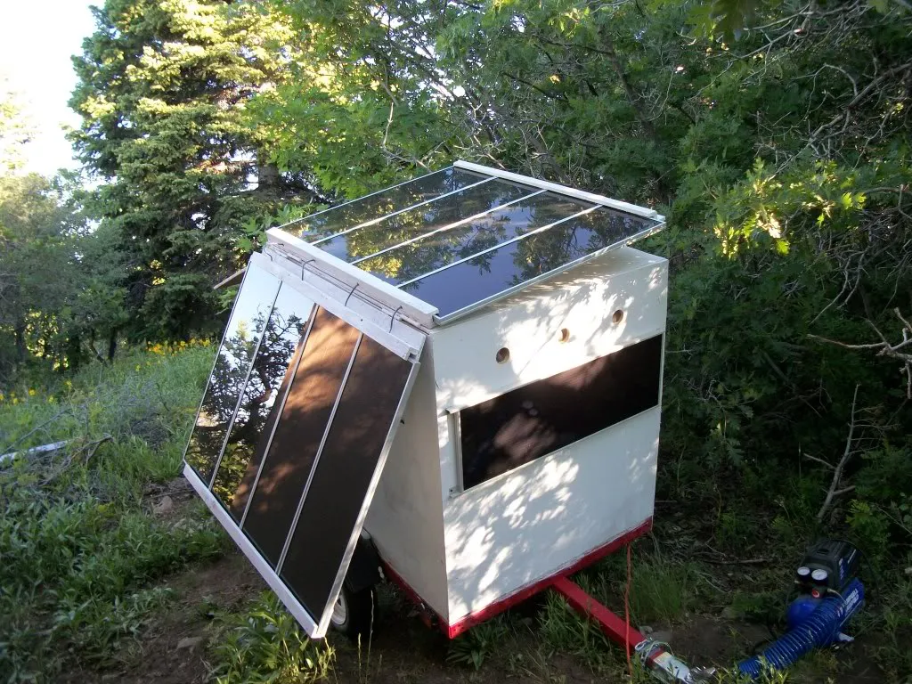

I found this website a couple of weeks ago and my pioneer spirit has been refreshed! Great looking trailer setup, how do you store the panels for "transit". I got into solar panels last year at my father's shop. We did it as a learning hobby. My father was a hydro operator with TVA and COE, so he was all for the power generation aspect of solar and also wind. What are you powering with your setup?
thanks,
325ABN
How do you protect the panels when you are pulling the trailer down the road?
suburbancowboy
The panels are easy to slide in and out.  So when I travel I just unhook them from the charge controller, slide them out and put them in the back seat in the truck.  When I started the project I was going to build racks in the trailer to store them in, but decided to save the time and just put them in the truck.  I will probably still put in the rack inside but it will just be fore winter storage.

I'm curious why you built the cargo box as big as you did.  Is the space necessary for venting the equipment or was that to accomodate panel storage?  Also, wouldn't a single high output panel cost less and take up less room?  (There is probably a good reason why this wouldn't work, but I'm pretty clueless about this stuff!)

The size of the box was sized to holding the panels that are hanging on the side.  If it had been shorter the side panel brackets would have been hitting the wheel well covers.
