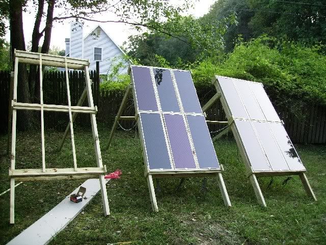

Glenn has a very good point. These are some frames I built, cost was almost nothing and are tilt adjustable
Another good point from Glenn is to add modules. Each with it's own regulator or charge controller. All of my controllers are Xantrex except the newest one which is a Tristar.
The Tristar is working just as well as the others.
Using modules, I can have power for specific areas and if need be, huttle power to an area that I am drawing more than normal from.
