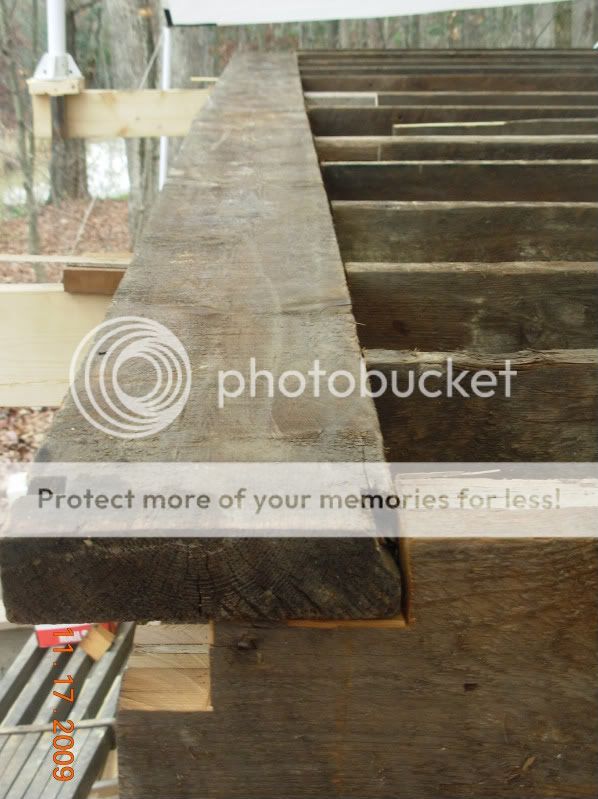

Got most of the joist notching done except for the stone section, and decided that it was time to stage some more timbers for later sawing.
Dragging the largest log past the job site.
These two logs will turn into 6"x8"x16' timbers and become the main loft beams.
Back to the cabin and some blocking and other detail.
Included here are some spacers that I forgot on the other side of the floor frame.
Also remembered that there was some 1" insulation board that could be used here.  I didn't do it on the other side, and it's probably over kill, but it's fun to use materials that may not have any other use.  :D
