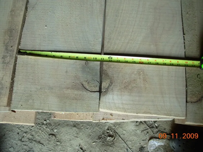

But just when I was about to order some lumber from the mill on Coon Hollow Rd. some oak and pine showed up on craigslist, cheap.

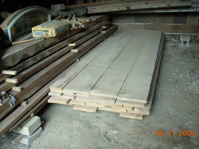

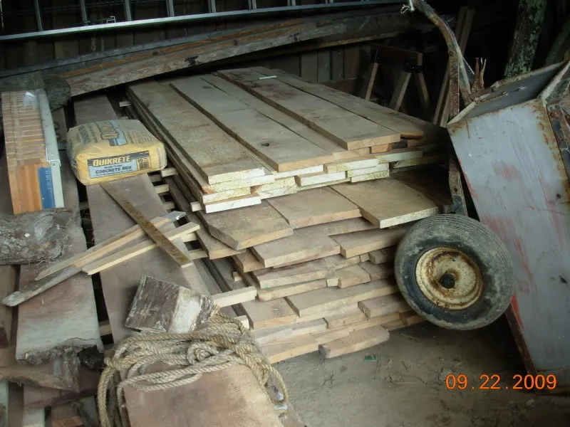

Here is the first load of pin oak, about 225 bf, 4/4 x 11" x 10' mostly.  Actual dimensions are 1.125" x 10.75".
Still have another 135 bf of oak and 100 bf of pine to pick up.
This was a pretty big tree as you can possibly see by the matching boards.
Oh, and all of it for 2 bits a bf.  [shocked]

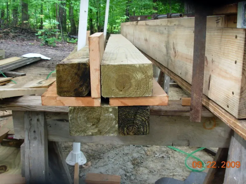

Got a little more done on the second girder/beam and wanted to get a feel for some of the future work.
This is a depiction of the joist layout at the SW corner.  There is a total of 3 10" joists, one 2x8 nailer and one 2x4 nailer spanning the beams, all within 17" along the beam.
I have also tried to show the sub-floor with a wire chase and the flooring butting up to the plank wall supported by the 2x8 nailer.  The 2x4 nailer is for the rigid foam board insulation and outside of that will be strapping to hold the foam board and be a nailer for the horizontal cedar siding.
Then on the east side.
Here I wanted to get a feel for the joist height.  Shown is a 2x8 that was handy, but the actual joists will be 2x10's.
And here looking NE.
Still working on the post design, so didn't get much done except for base plates and got some gusset material cut.

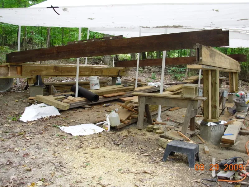

Unloaded the remaining pin oak and pine for a total of 460 bf at a cost of $115.  ;D  The plan for the oak is old school diagonal sub-flooring and haven't decided what to use the pine for, maybe strapping for porch roofing.
It rained hard on Sun. and got the wood a little wet before I got it into the barn, but it dried over night.
On to finish the second beam and work on the posts.

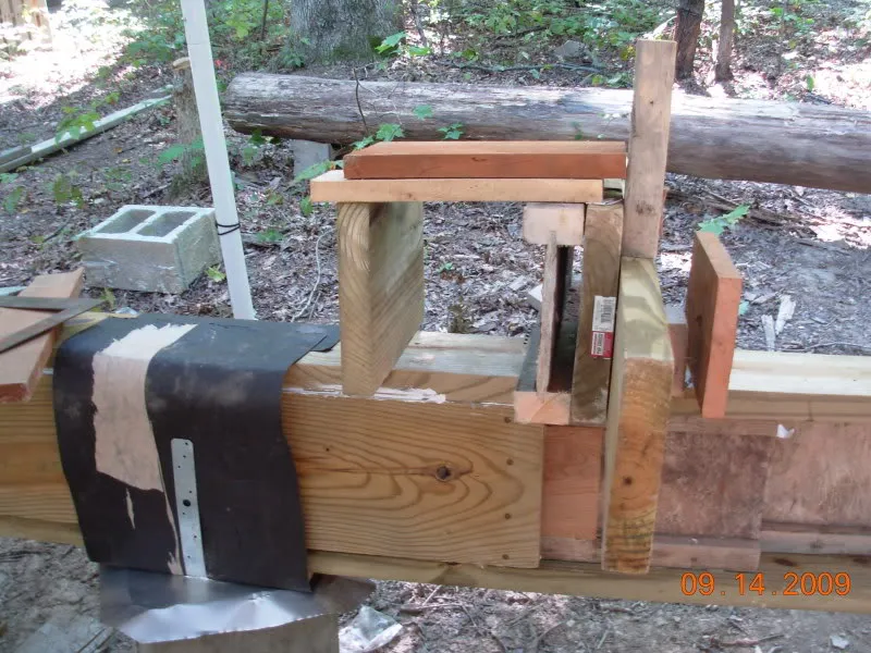

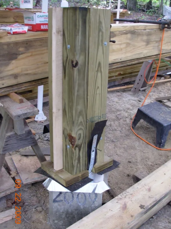

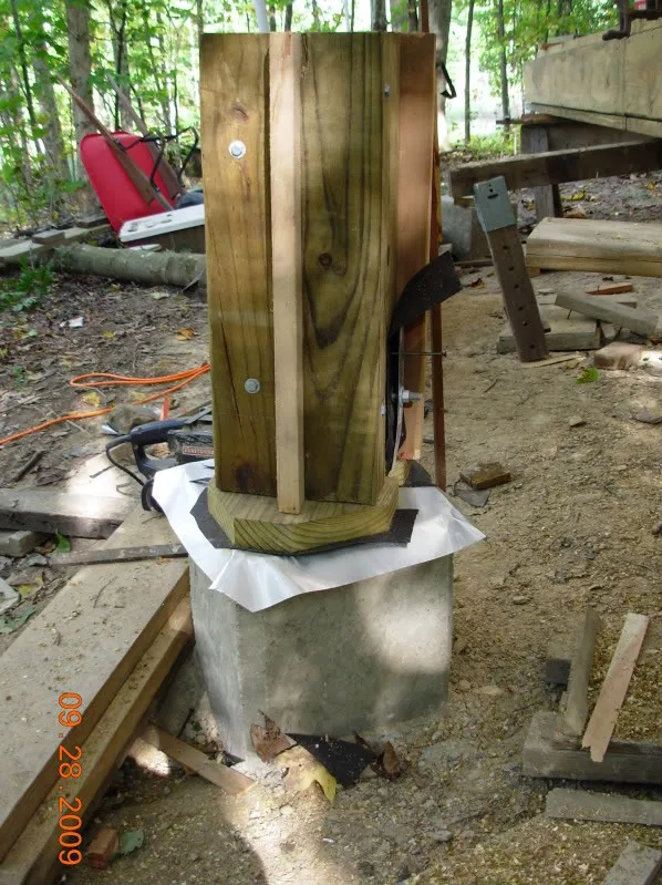

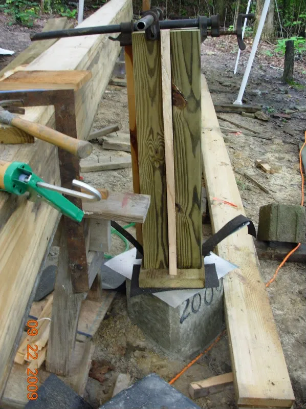

The proposed post design with 3 nailer/gussets for braces.
Put the tallest post pre-assembly on the pier to think about how to do final assembly.  Went to a local supply store to see what they had for pole barn nails and/or lag screws.  Decided to get the lag screws, 1/4 x 5 galv., but they didn't have galv. washers, so went to the hardware/gun store to find washers.
The lag screws cost $2.00 a lb. (16 count per lb.), but the worker gave me 18.  Then the washers were 10 cents each, so almost cost as much as the screws.  ???  Decided to check the price of the lag screws at the hardware store and they were 65 cents each.  :o
So the good ole supply store that has been around since before all the other stores were but dreams in a corn field, saved me over $8 on one small fastner buy.  (another example was a $2 cut-off wheel for the angle grinder, that the hardware store and even Wally World wanted $5 or $6 for.)
Set up the second post to use as a template while assembling the first one.
I know, I know, I tend to make it more complicated than it needs to be, but I'm having so much fun.  [crz] rofl
Got the first post assembled and decided to call it a day.  May need to add more screws later.

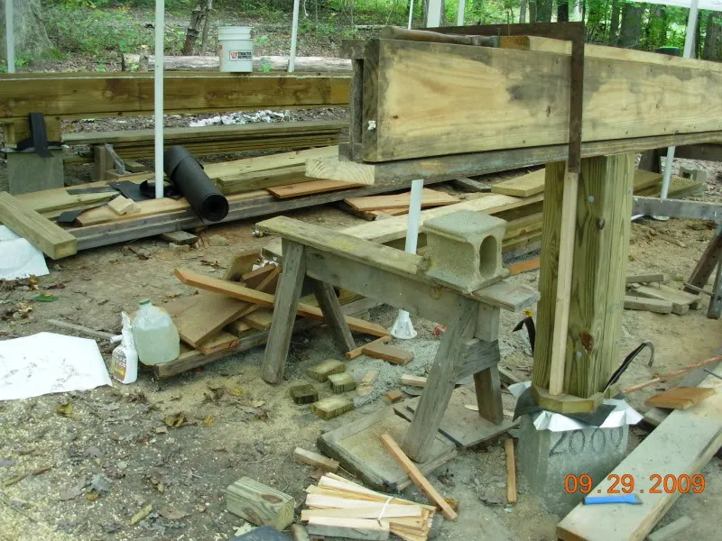

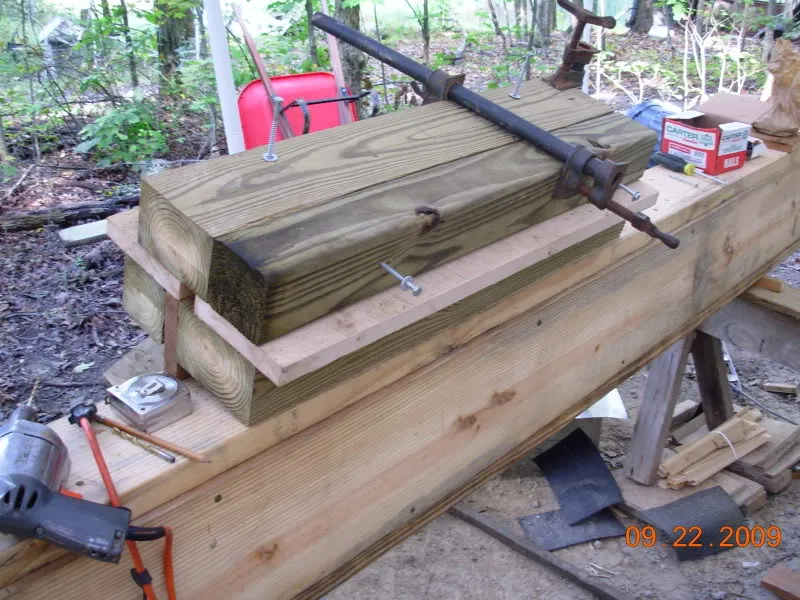

Back at it this week and working on the assembly of the second post, then....

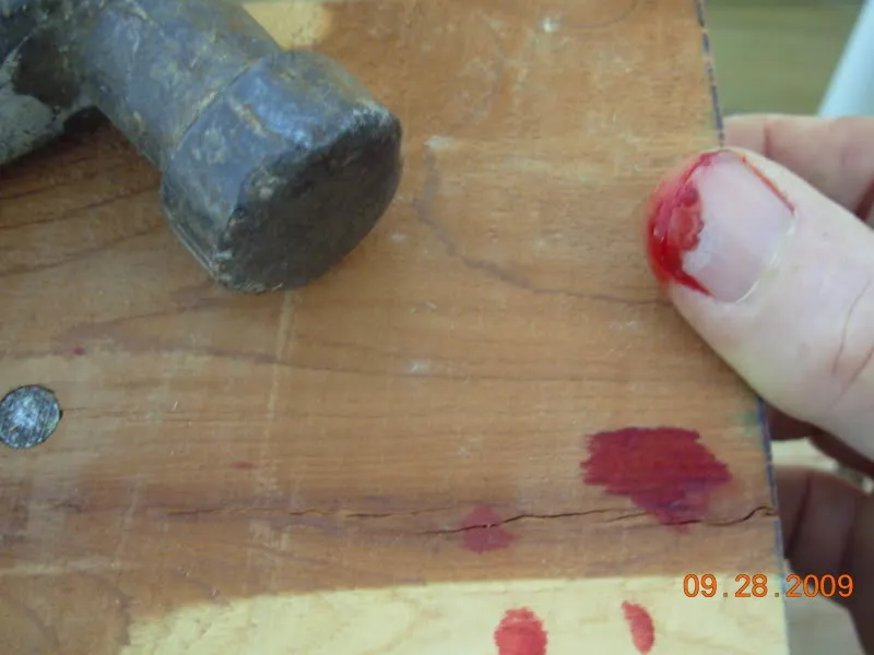

Hit my thumb with the hammer.  That's what I get for using a right handed hammer.  >:(
This may be the first blood shed and deposited on the work in the "blood, sweat, and tears" game called building your own cabin.  ;)
Despite the blood letting, got the post assembled.

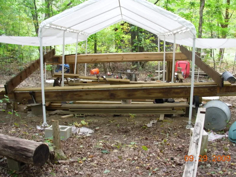

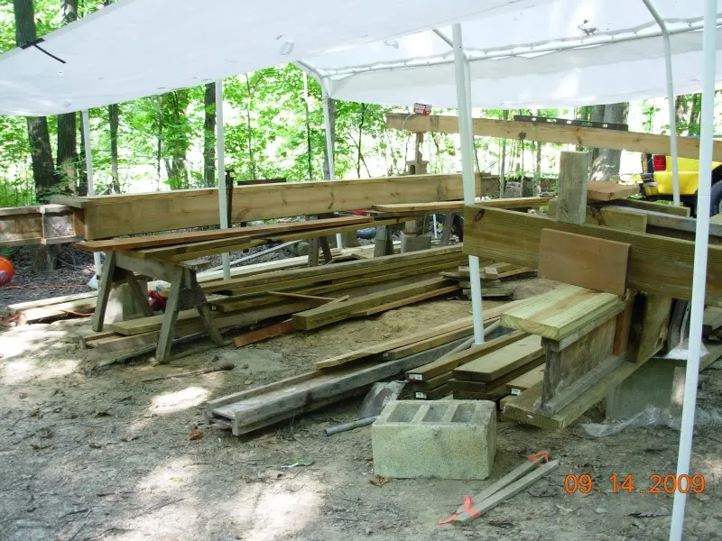

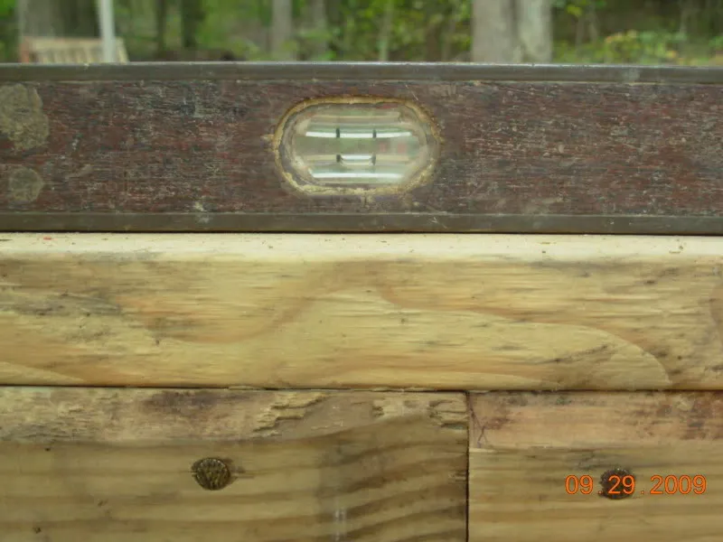

Looking at the NE corner after trial setting the beam.
Looking at the NW post.
The beam looks good to me.

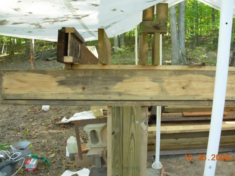

poppy

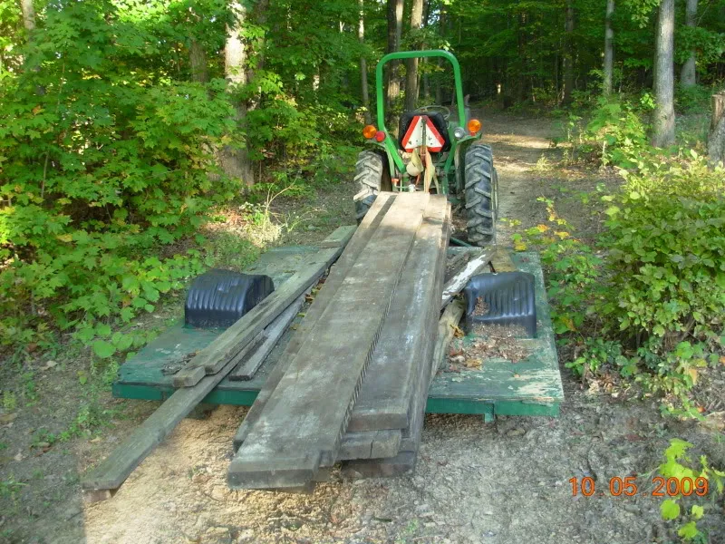

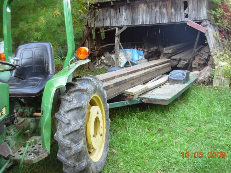

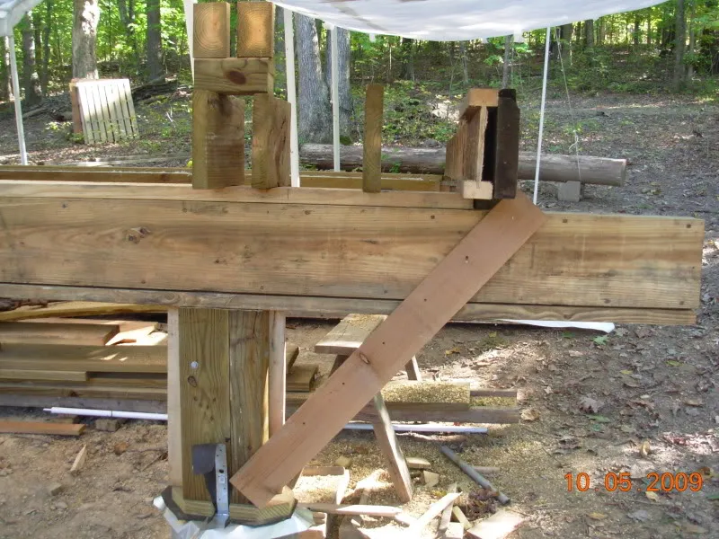

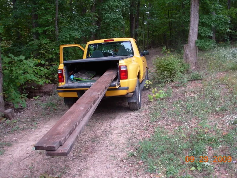

Time to get some of the joists from storage in the old garage.
Using the new driveway to transport the reclaimed 2x10 joists (actual height is about 10 1/8")
Trial setting two joists on the E and W sides of the main cabin.
The E joist looks pretty good.
Looking from the south.
Looking from the NE.  Still don't have the N beam where it needs to be, but that's for another day.

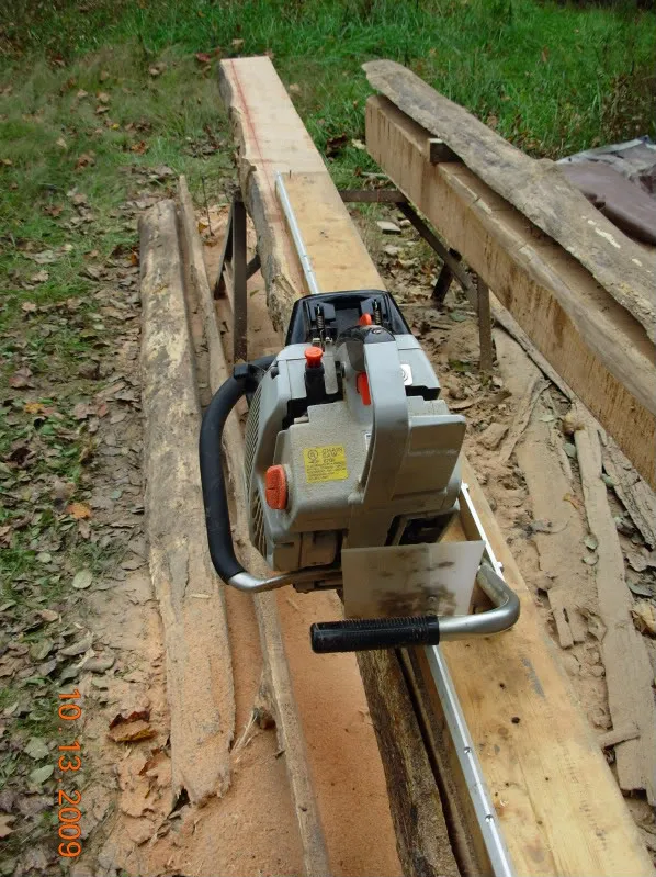

Got the big chain saw back from the second rebuild and decided to do some more timber work.
This is where I had to stop after the saw burned up the second time.  That was back in May.
Got the 3rd and 4th cuts completed and did a little draw knife work on the wane.  This is one of the timber posts for the N wall.

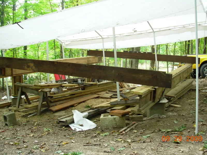

So I decided what to do about the out-of-square foundation beams.  Slide the S beam to the E and the N beam to the W.
This attempts to show where the timber frame post will fall relative to the pier on the NW corner.  No, that's not the real brace; just a mockup of a 45 deg. brace.
And the NE corner.  The beams were off by about 7"  :-[ but it looks like all will work out.

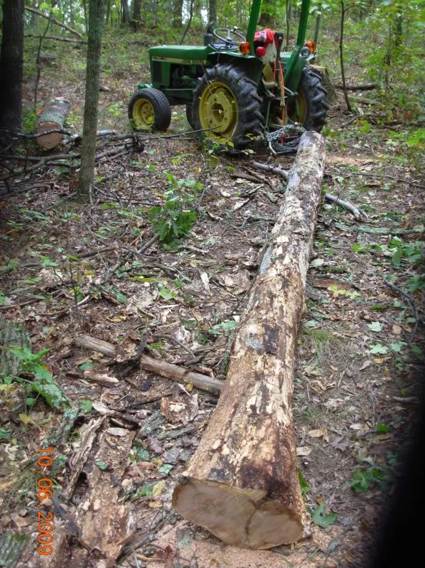

So how to get a 16' wide cabin with short joists?  Well use timber sills, of course; after all, this is a timber frame cabin.

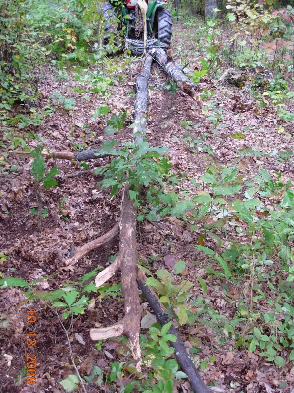

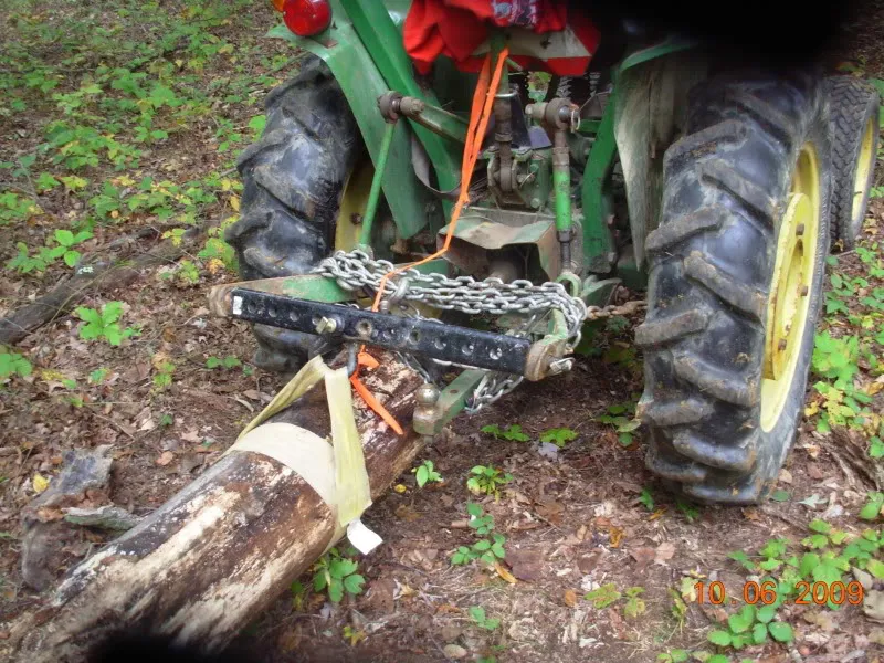

First is to harvest a standing dead red oak.  The 9 1/2' bottom section there in front of the tractor will become braces probably.
Preparing to drag the 17' log (de-barked with an adze) down to the timber preparation area.
The trick is to lift one end enough to minimize soil damage and avoid getting too much dirt on the log.

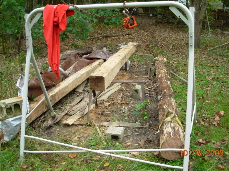

Setting up the new hoisting frame.
Even a log from a dead tree is heavy.

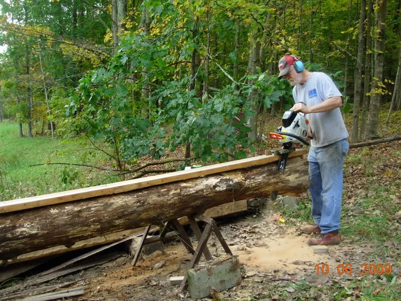

Making the first cut for the 6x6 sill timber.
Using this method for the first cut means that a 10" log is about the max size for a 20" bar.
And a relatively clean cut in the red oak.  Ran out of time at this point.

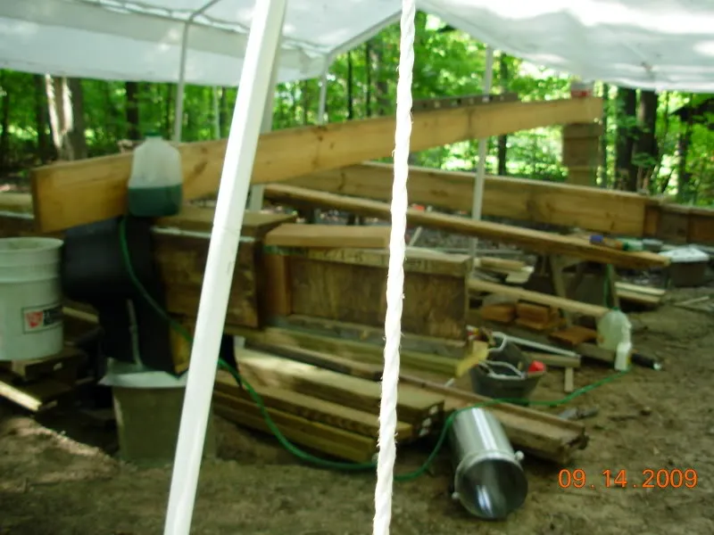

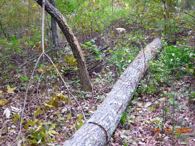

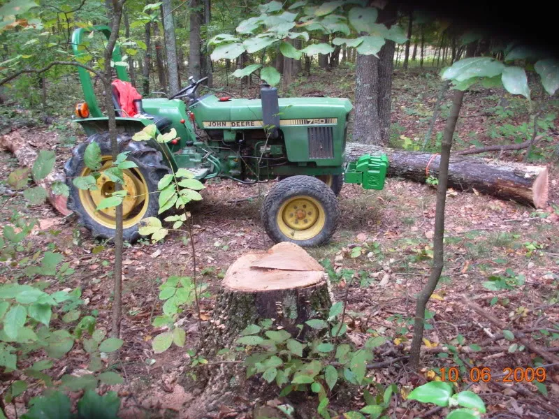

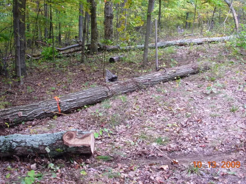

A new week, some more work.  Before completing the 6x6 sill timber, I got to thinking about proper sequencing of the timber frame, you know, last raised has to be the first assembled. (the first will be last, for you biblical scholars out there  ;))
So decided to cut a couple more trees that potentially can be used for the loft frame which can't be raised untill the end frames are up.
Here are 3 potential trees, but the one in the middle is the most crooked, so decided to cut the other two in order to verify that they each will yield a 16' 6x8 timber.
Not sure why all of these red oaks are dying, but these 3 are close to the one I cut last week plus there is a 5th one that died this year in the same area.
This is the left side tree that sort of "kissed" the bent tree on the left(made that way by a previous logging venture) as it came down.  Not to worry; I expected the kissing to occur, and moved accordingly.  :P
The 2 red oaks down and bucked.  They will each easily provide the 2 16' loft frame timbers.  The larger of the 2 also yielded a 17' log that will make a nice one piece 5-sided ridge pole/beam.  The other tree provided a 9" dia. 13.5' log for something.
For those who haven't done any logging, if you look closely, you can see the peavey (auction find) used to roll logs.
One good thing about felling dead trees is that they tend to buck themselves.  :)

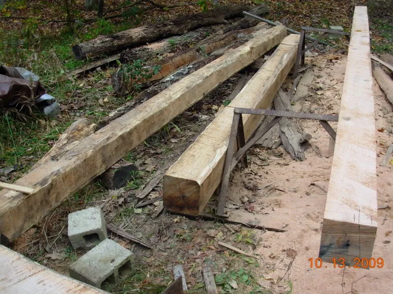

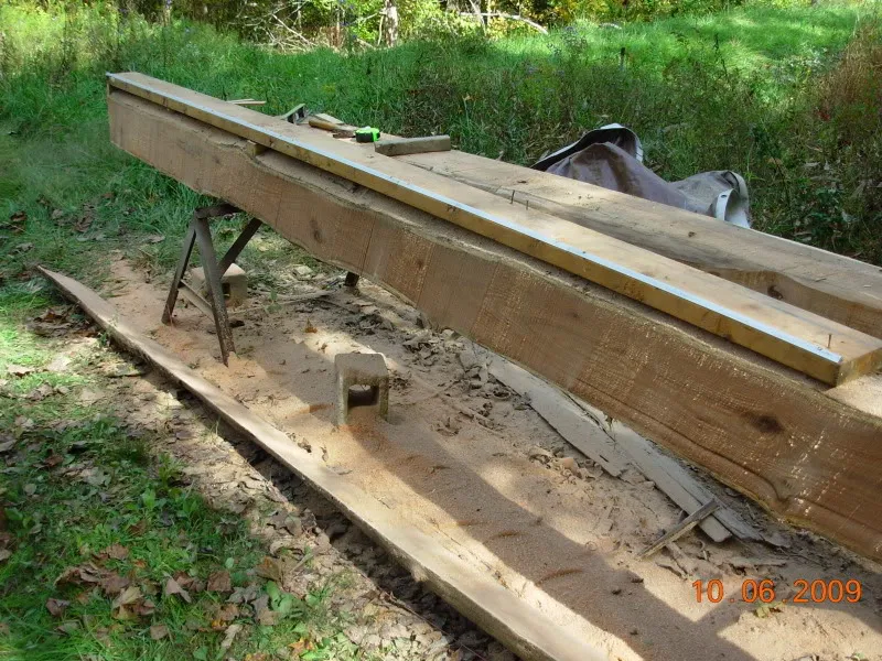

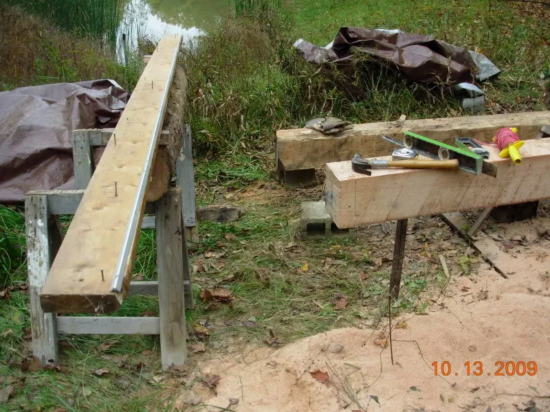

Part 2 for this week.  Went back to finish up the sill timber.

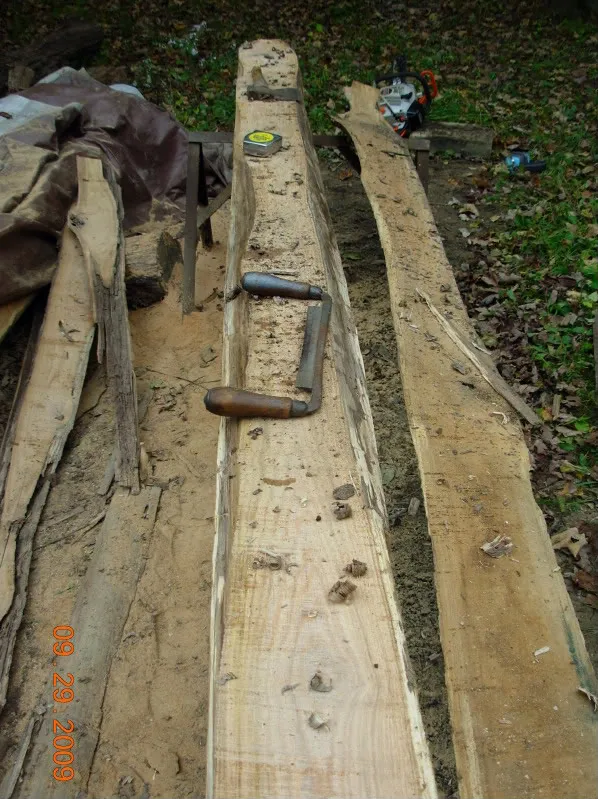

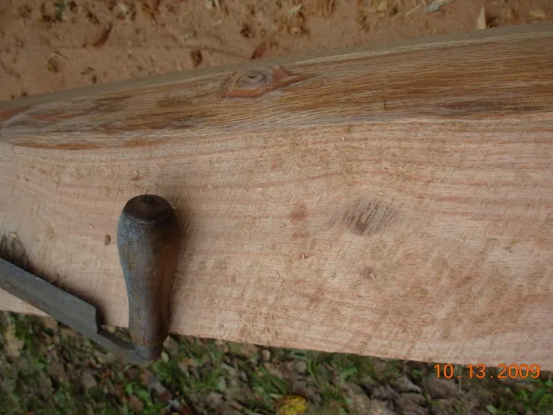

Setting up for the 2nd to 4th cuts are much easier than the first. This is the 4 cut.
The draw knife makes quick work of some wane clean up.
Now, on to the sill timbers for the south side.

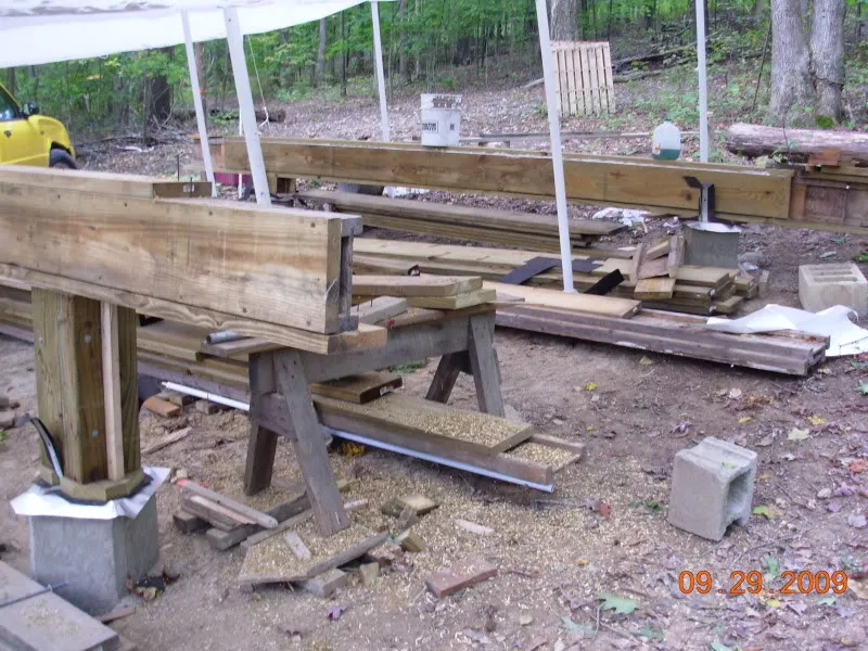

Here's the set up for short timbers of which there will be 3 for the south side. (has something to do with the bump out feature)
Timbers completed so far; 6x6, 8x8, & 6x8.  No, the 6x6 is not twisted; just distortion from the wide angle lens again (plus the end cut is not square yet).  d*
And then a parting shot of early fall over the pond.  Tall trees in the left center background is a small hickory grove.

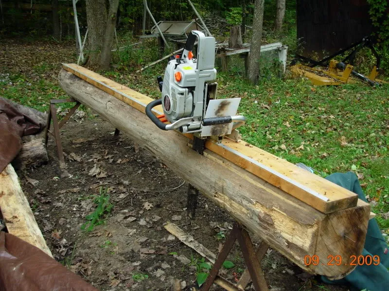

poppy, what do you call the device that holds the chain saw in place for doing millwork? ???
Rule #1: "Don't sweat the small stuff"
Rule #2: "It's all small stuff"
poppy
Jim, the device in the pics. is a Mini-Mill II by Grandberg.  It is also called an edger used to square up a log for making slabs with the larger Alaskan mill or for just making timbers.
I also have the Alaskan small log mill that will be used to halve the log for the cruck frame.  I have also used this mill for the first cut on a log for a timber.

Jesse, yes the saw moves easily and smoothly, but as an example, these cuts for a 6" sq. timber were at a rate of only about 4-5" a minute, plus I would stop the saw every 6" or so to hit the oil plunger.  Also, to make one pass of about 17' took more than one tank of gas.
It will be a really slow process for the cruck blades which are planned to be 12" wide at the base.
Those who use chainsaws to mill lumber use a much larger saw; at least 1.5 to 2 times the power of mine.  Most of my lumber needs will be handled by the local Amish mill that has a Woodmiser bandsaw.
If I had any locust, I probably wouldn't attempt anything larger than a 4x4 timber with the rig I'm using.
