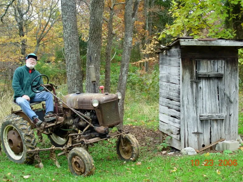

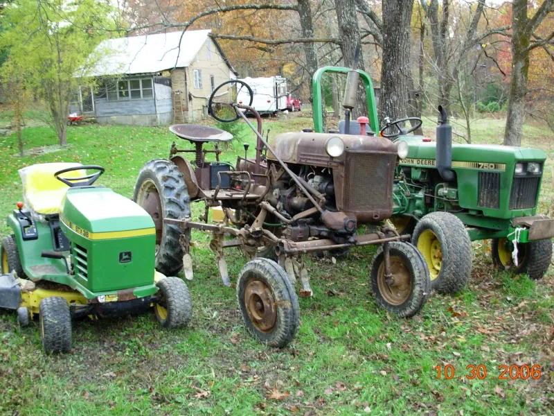

One of my first purchases was my dad's old 1948 Farmall cub that my sister had bought from him and wanted to keep in the family.  It has the cultivators installed that I have used for the driveway work.  I also have the original sickle bar mower for it.

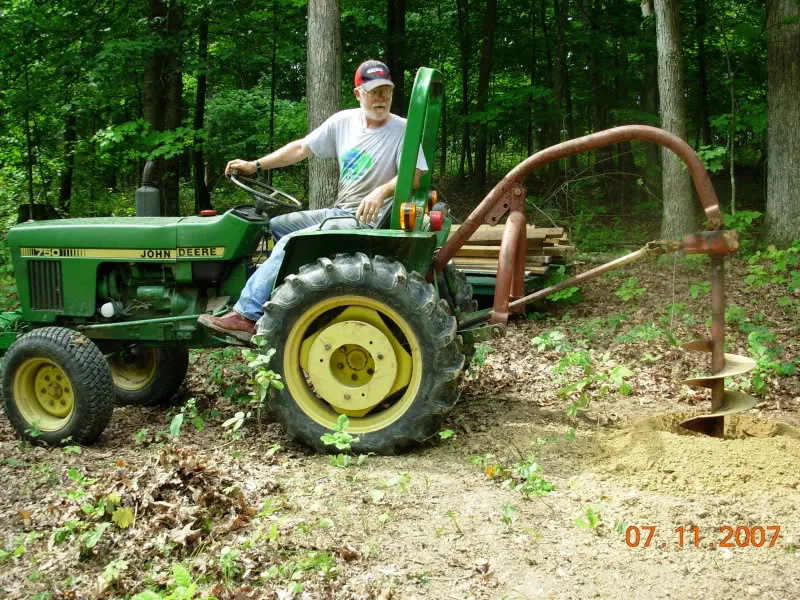

More purchases:  John Deere 750 tractor with post hole digger and Deere lawn tractor from the local John Deere guy.

Jay, thanks for the kind words and yes the cub is a neat old machine.  My dad and brother and I raised tobacco with that tractor, so there are many memories.

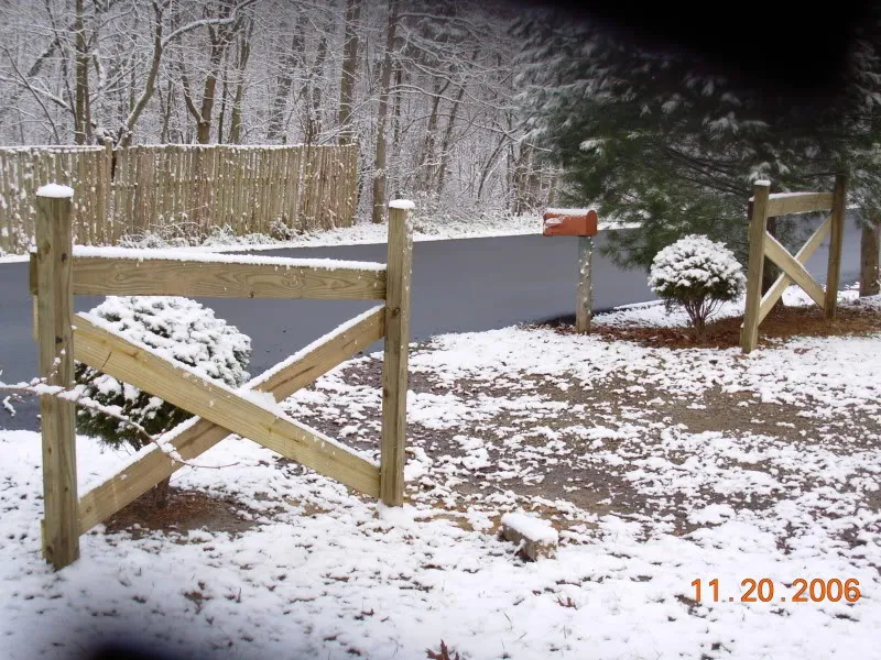

The first snow came before I got the first gate complete.  The gates are each 8' spanning the 16' opening; made from 2x6PT. This is for the original driveway to the old house.  I made a different design for the second and future driveway to the cabin site.

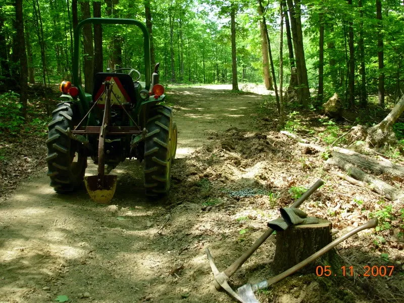

Working on removing one of the stumps left from cutting one of the standing dead oaks.  This is looking west along the new driveway about 200' back from the new culvert.

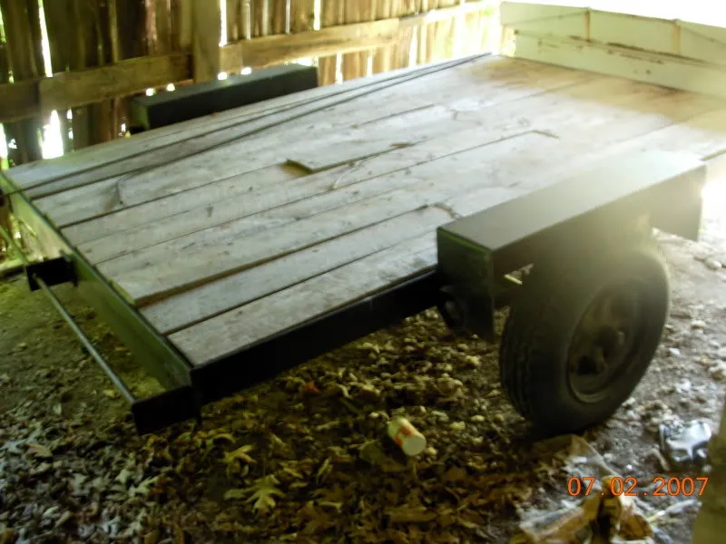

One of my farm auction buys.  I trailer made with the axle and wheels from a house trailer, which is questionable for road use. I now have 5 trailers all together of various sizes and types.

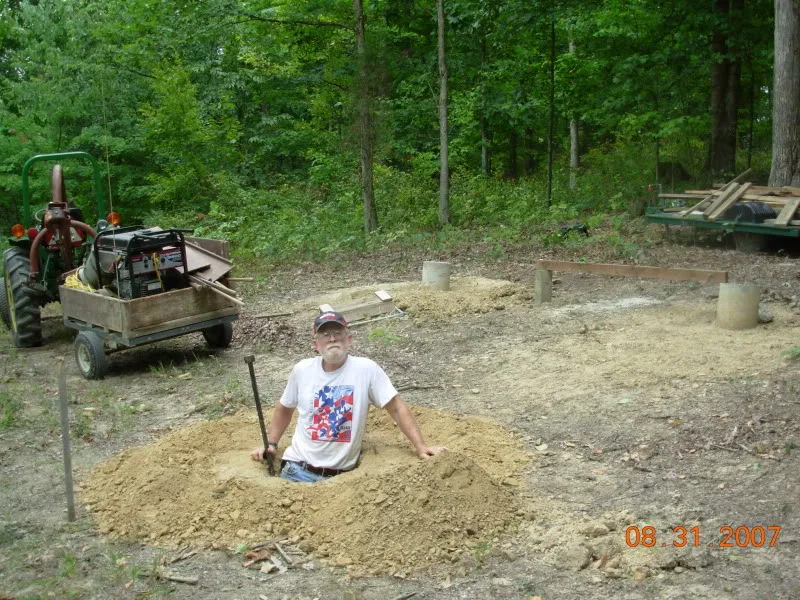

Boring the first pier hole with 14" auger at the first cabin site.
This is the first installment of real work on the cabin, but as I have said before, this is the first cabin site and has since been abandoned.  I guess I could skip forward to this current year when I started the building at the second site, but I have really good pics, and I hope that someone can gain from my experience.

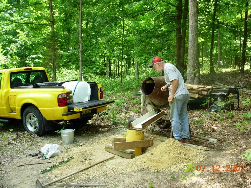

Pouring the first pier using another auction buy (the electric concrete mixer).  I bought a new gas powered generator to run it and other tools.  There is a re-bar cage in the form that I forgot to take pics of.  I used four 1/2" bars with 90 deg. bends at the bottom ends that extend into the enlarged hole below the Sonotube.  So the holes are at least 3 1/2' deep with the bottom expanded to 2' in dia.  The 12" dia. 4' tubes protrude 1' above ground level.  The bottom of the holes have undisturbed hard pan clay.

Hole number 3 with me for scale. 8)
