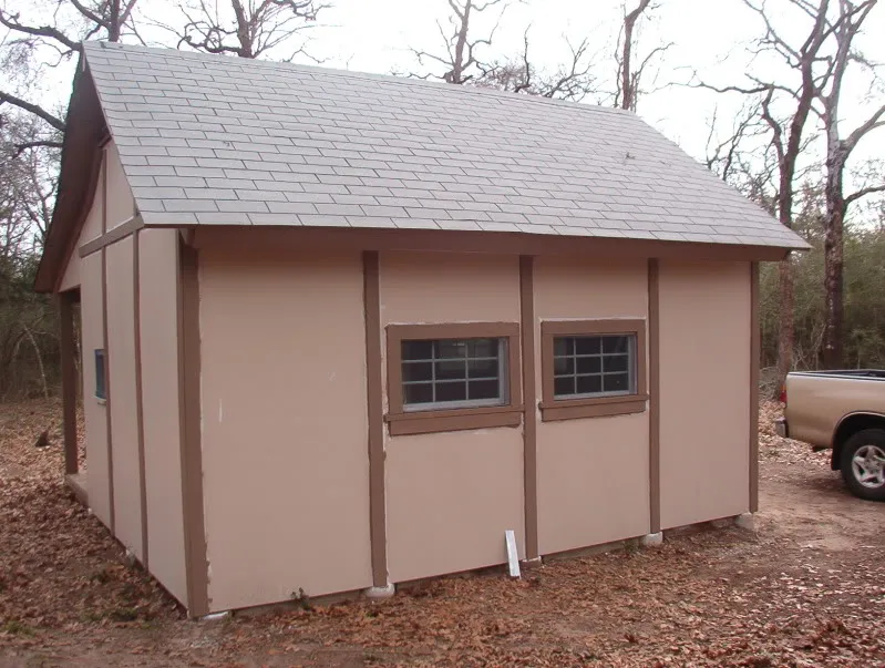

Went today and got half of the trim cut, nailed up, primed, and painted.
The north and east sides of the shed are done except the final paint and touchup.
Looking fine.

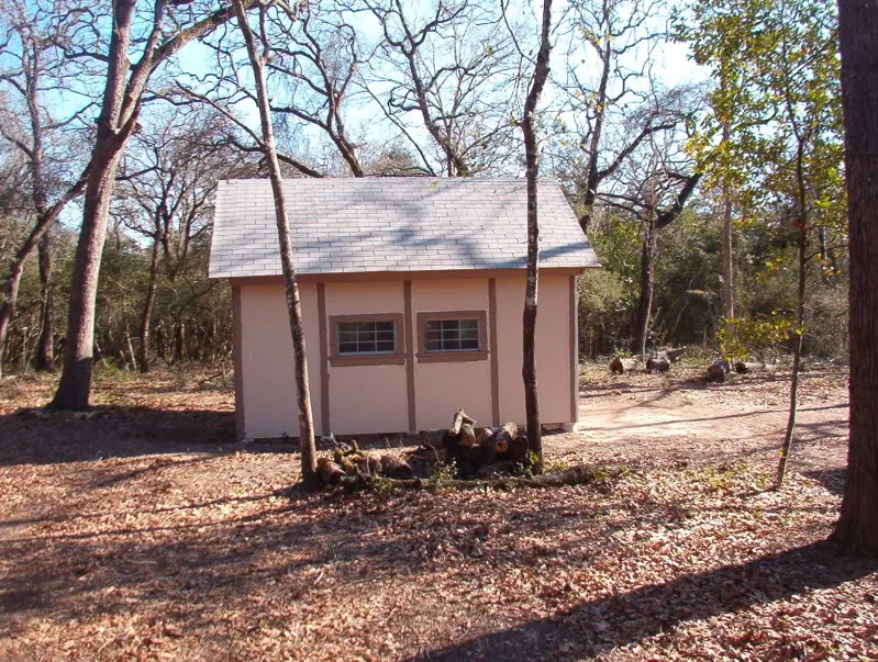

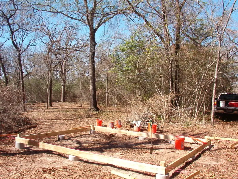

One year ago pic:

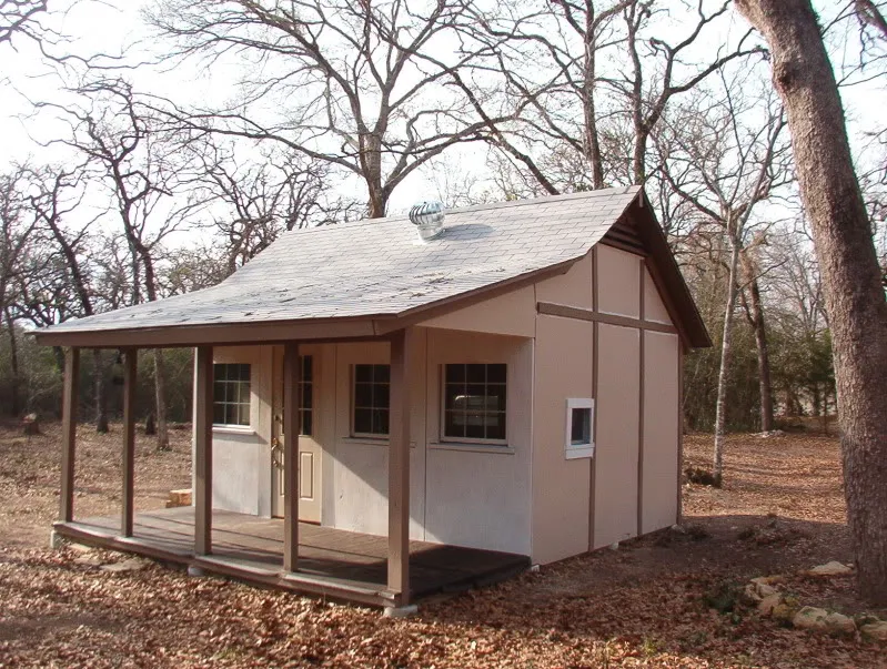

Todays pic from almost the same angle:

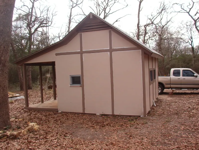

Looking at the front or north side:

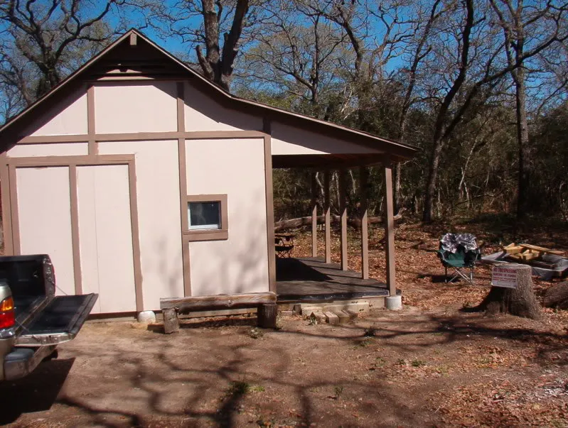

Looking at the west side, with the door and trim in primer:

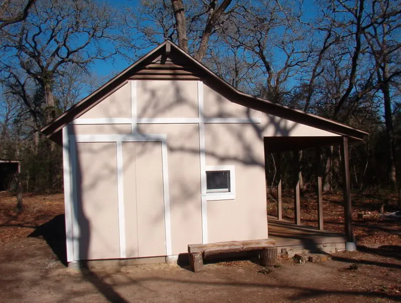

Went today and got the final 4 sheets of siding up and primed.
Abbynrml I just wanted to inquire about a couple things.  1.  What was the deciding factor in placing the vent turbine on the front roof rather than the back side out of view. Is there any reason that you decided against a ridge type vent.  2nd is that a window on the right end or something else.  It is considerably smaller than the ones on the front. Not that anyting is wrong mind you but that appears to be awful low to be able to see out in a standing position.
Abbynrml
Redoverfarm:
1. The vent is on the back side. the porch is facing south. The double doors are on the west side. No door on the front side. I used gable vents and a turbine vent. Ridge vents always seem to leak for me.
2. Yes it is a very small window. On the east side and another on the west side. Wish it was bigger, but it is what it is.
I bought all the windows off craigslist and got them cheap.
It is low, and standing it is too low to see out thru, but sitting it is about the right height. I will probally be sitting more than standing when inside. One day perhaps I can install a larger better suited window, but for now this will work.

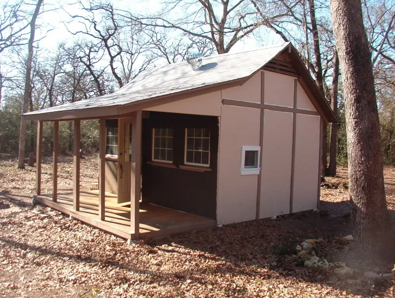

I am happy to say phase 1 is almost complete.
Phase 2 was going to be the porch, but as you can see, it is already started.
I plan on screening it in. Going to run screen top to bottom all around.

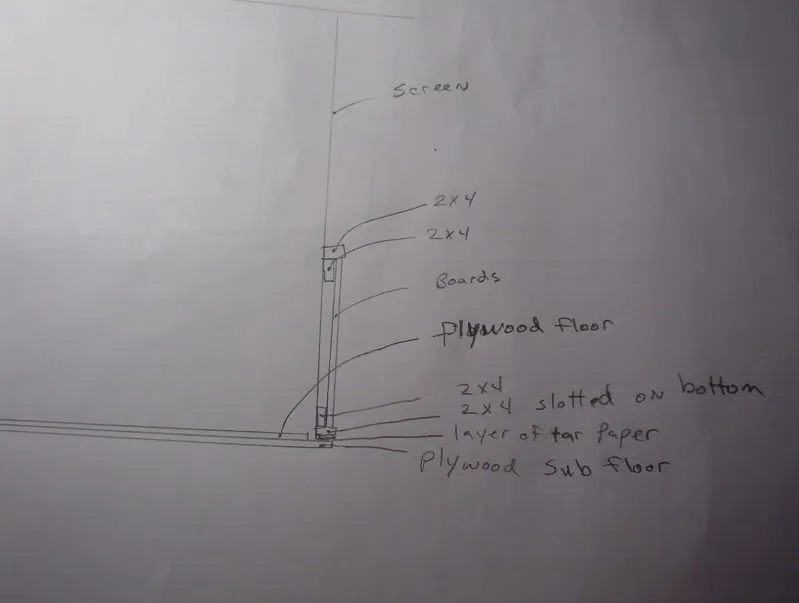

Then I want to add a wood barrier around the bottom, going up about 2 feet. I was thinking of just using 2x4's attached to a 2x4 top and bottom.
A question that I have is how should I allow water to drain?
Can I cut grooves in the bottom 2x4 to allow it to drain?
Any thoughts or ideas for the porch finishing?

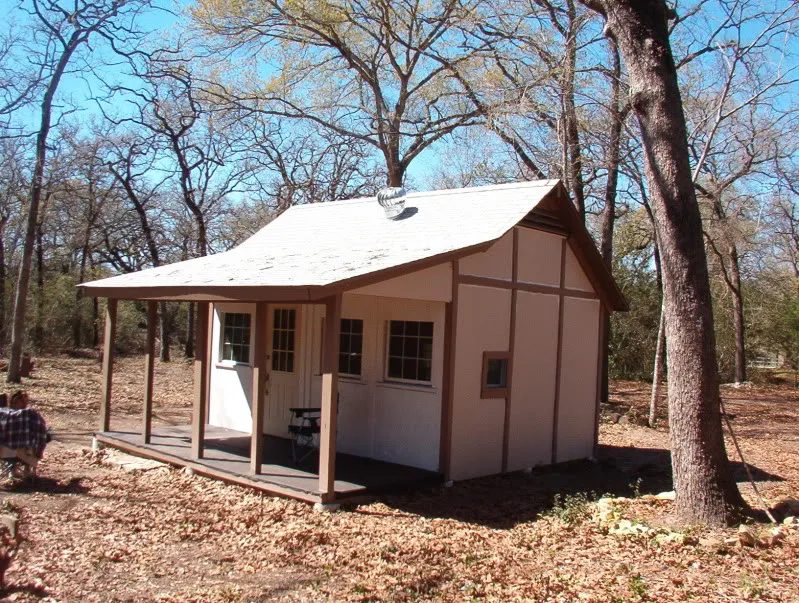

Today was beautiful. Trees budding out even saw a few wildflowers.
Got the trim completed on 3 sides now, only need to trim the porch windows.

Does anyone have any thoughts on the water drain slots under the bottom 2x4 around the porch?
Something like this:

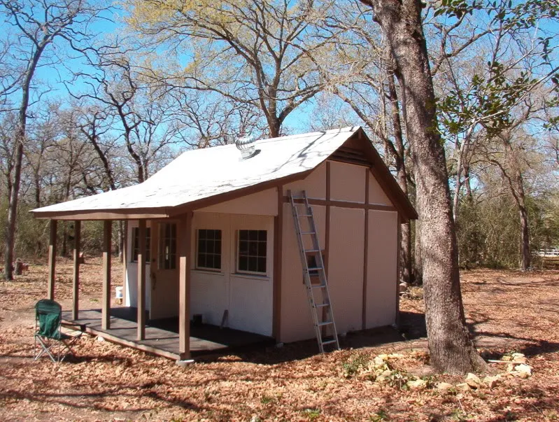

What a wet day!
It stormed this morning, from about 8 until afternoon.
Cold front came thru and temps dropped big time.
I cut and nailed up the last of the trim work, just need to finish the painting and the exterior will be complete on the shed.
Still need to do the porch, but I'm kind of stuck on what to do.
In the rain today the porch area was soaked. Rain came in on 3 sides.
I'm almost afraid to finish the porch. Afraid that it will always get to wet.
Any ideas how to keep it drier?
Even thinking of ripping up the floor and redo it all.
What can I do?
Welcome to the world of delimia's.  Everyone visits there every once in a while.  I take it that you used Ply for the porch decking. I hope that you included a pitch of at least 1/4" to 1' .  Wind driven rains will eventually make it's way through the screen enclosure.  About the best approach is to keep the ply protected so that water will not penetrate it and it will delaminate itself.  Off hand I would say the best approach is to paint it with a good quality oil based porch and floor enamel.
As for the drainage even a larger slot will eventually fill up with dirt, debris, cob webs, bees nest and the list goes on.  I think I would probably build the railing wall and leave it slightly off the floor say 1/2" and then get something similar to cobra vent material and slip it into the void.  It should allow water to exit the floor but keep the insects at bay.  The major problem is that anything you do will have to allow the decking floor water to exit without any obstructions. By cutting kerfs in the 2X you would have to do it so close together to be effective.  You could use screen over the void then camoflauge the void and screen with a 1X board that you have blocked out (1/2-3/4") on the lower side and would still allow the water to drain but would not be seen.  Yes the board will appear to be a little off plumb but not that noticable. In the same train of though you could block the complete 1X out and then nail a 1" board as a cover to conceal that blocked out 1X from the top side hiding the blocked out area except for the denensions of the 1X .  Hard to describe what I have in my mind  d*( Lord Help Us) and get it into written form .
