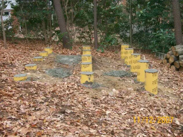

I'm new here but thought I might be able to add to this post. I do concrete piers for a living. It seems cheaper and easier than most of the ways I have heard described here. I do not know if it is acceptable for a house. So you would have to check that your self. If I can figure out how then you will see pictures of my work. Did I mention its cheaper too?

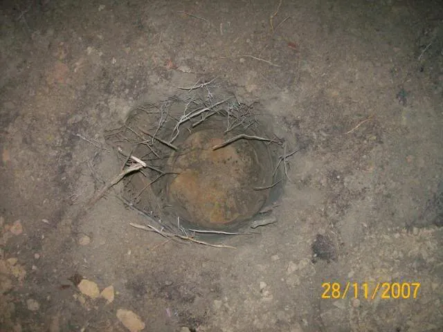

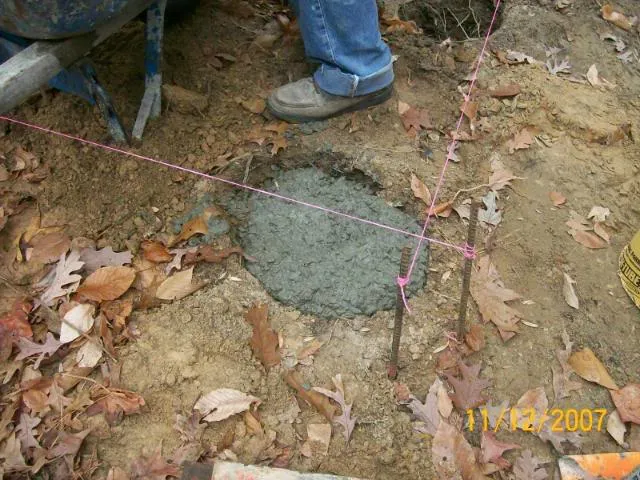

Thats just a basic 12" augur hole code here requires 18" deep I usualy go 20". The empty holes have to be inspected before you fill them with concrete.

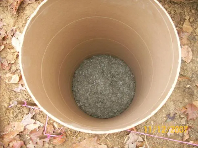

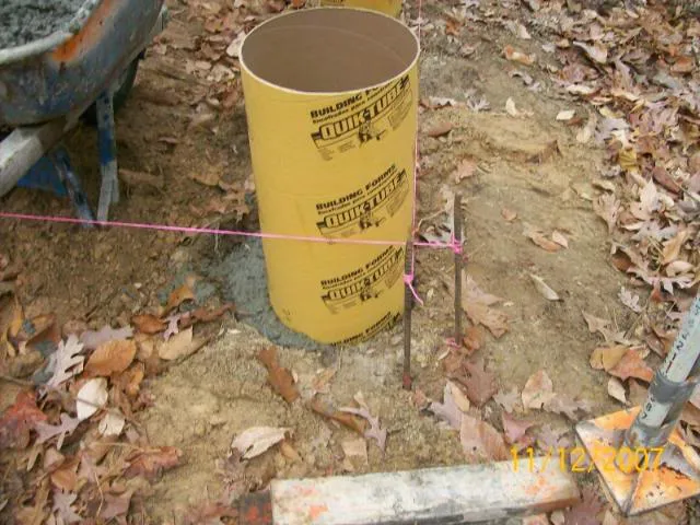

After the inspection we string line the pier locations and cut all the forms. You want to push 3" or 4" of form into the concrete in the hole.

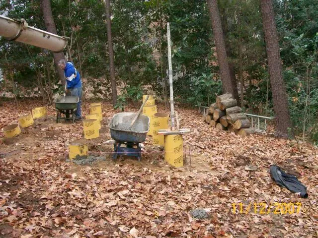

That helps keep the pier strait when pouring. You can also see how we set up the string lines to keep the rows strait.
Then you fill up about 1/2 way and get a check on the height. I use a grade rod taped to a tamper and a builders level for this.
Once they are close I fill them the rest of the way and get them perfict. Its best to have it a little tall than a little short. Its easy to tamp the wet pier down. Its not so easy to pick the form up when its full of wet concrete.

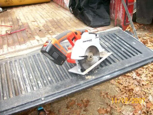

Now you remember what I said about cheaper? Well the sono tubes (forms) are $12 ea. for a 48" section you cut to size. I use a 18V saw to cut the form tubes.
  It takes 3 80lb. bags of quickcrete to make a pier 36" tall 18" below grade and 18" above grade. Thats about another $12 anchor bolts have gotten outragous though. The last ones I bought were almost $3 ea. Thats for a coated 12" X1/2" anchor. If you mix your own concrete from portland sand and gravel its even cheaper. Here we don't use rebar unless the piers get tall over two feet out of the ground.
These pier jobs that I do are for storage buildings. I can't see any reason it wouldn't work for these cabins. I have done piers for upto a 16'X32' building like this.
Hope this might help someone.

BiggKidd I have also used 5 gallon blastic buckets (botom cut out)instead of sono-tubes for things a little closer to the ground. Just cut off the bucket after set.  I guess I am old fashion but I always stick a little rebar in for good measure. If it is not too nosey where in Central Virgina are you planning on building?

Five gallon buckets work fine, but the inspector isn't quite so happy to see them. LOL

The tubes work fine for a cabin.  w* Thanks for posting all the photos, we love photos.  :D
Here in NM when running the inspection gauntlet we need a rebar  X  or  #  in the bottom, with the bottom of the hole either 16" square or 18" round, 8 inches thick. Then 2 pieces of rebar vertical in the column.
I am one of those choosing to use a poured footing in the hole bottom and then build the column from dry stack concrete block and fill the blocks with concrete as there is no way to get a transit mixer up those roads. So I'll be mixing Quikrete bags, probably by hand, although I may take the portable 3 cu ft mixer. Haven't decided.  :-\  Takes more water to clean out the mixer drum than the wheelbarrow.
Thanks again, hope to see more from you.
Nobody ever hijacks a thread here, Larry.  We just deviate from the topic a bit for a learning experience.  [crz]
Welcome to the forum and thanks for the illustrated  tutorial.
