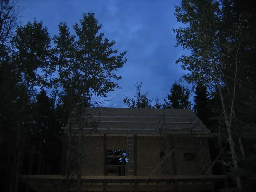

Starting sheeting the roof this weekend.  Pcitures a little on the dark side.  I didn't realize how steep the 12/12 roof was until you have to spend the day standing on it.

Lightened your image...

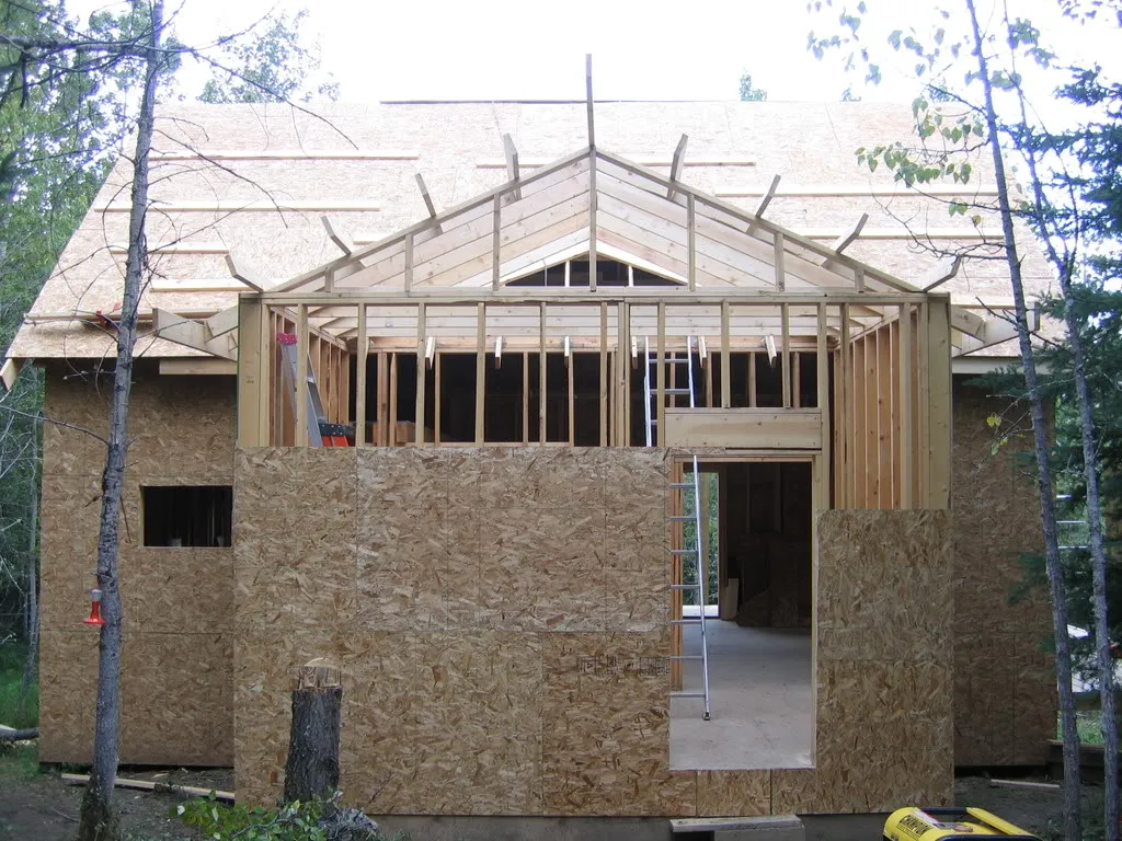

Latest progress........I've put the sheeting on the outside too low in some spots.  Needs to be cut so it doesn't rot.  Past first inspection!!

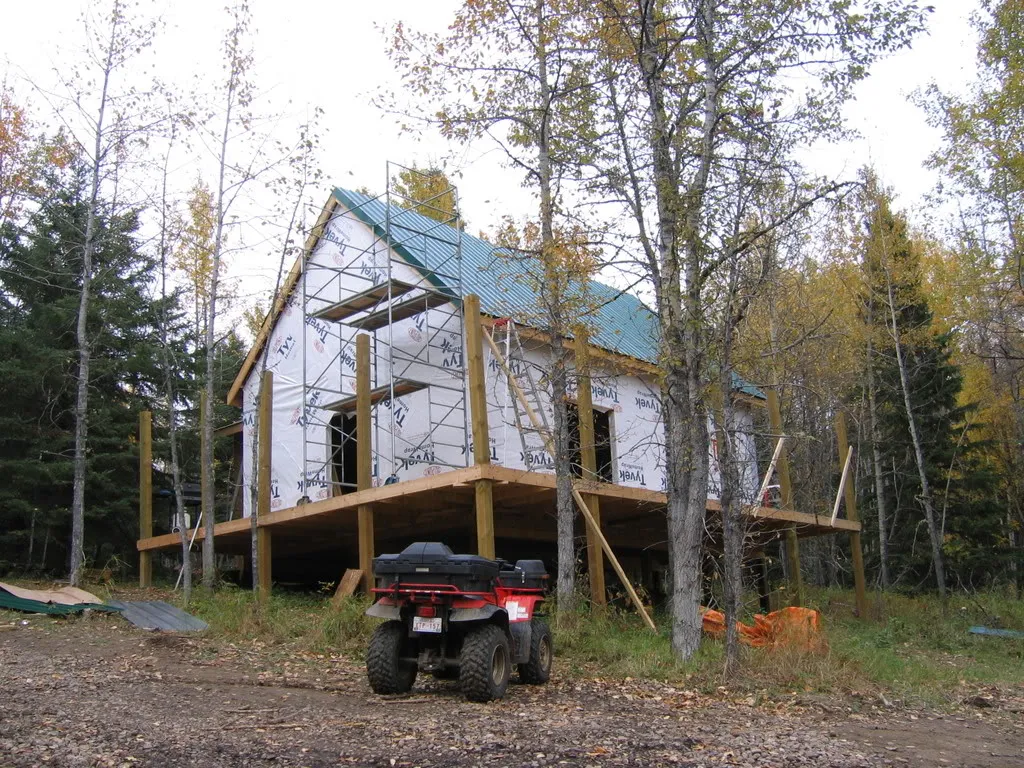

Update........one side of metal roof is done..................

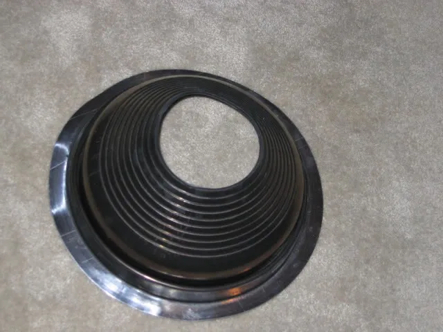

Going to install the stove pipe and flashing tomorrow.  The flashing is a 3' square piece of malible aluminum, which they say just lays on top of the metal roof.  I'm not sure this is going to look that great.  Does anyone have any experience with stove pipe flashing on a metal roof?
TheWire
I just put my chimney through my standing seam metal roof.  I cut the hole for the chimney with a sawzall from the inside.  I used a fine tooth blade to go through the OSB & metal roof.  The hole is a 12"x12" square to fit the chimney's cathedral ceiling support.  I then used a tin snips to extend the top cut of the hole in the metal roof to be wide enough to slip the 20" wide flashing under the metal roof.  The flashing overlapped a standing seam in the roof which didn't matter at the top because it slipped under the roofing.  At the bottom of the flashing where it hit the seam, I cut the seam back part way and cut the flashing to over lap the seam.  I then used gasketed screws to fasten the flashing down.
This looks like it should shed water nicely.  The only questionable area is the point where the flashing meets the edges of the top cut in the metal roof.  There is a small spot in the intersection that water may get through.  I applied a quality silicon caulk to this area and under the flashing before I screwed it down.
I used the Selkirk Super Pro Stainless chimney system http://www.selkirkcorp.com/superpro/Product.aspx?id=106  This picture is similar to the flashing I used.
BTW, I spray painted the flashing to match the roof color prior to installation.
Jerry
Jerry most metal roof flashing boots that I have seen are rubber and mount to the top of the metal roof.  There is a metal aluminum band running on the outside edge that can be bent to conform to the ridges and valleys of the roofing.  The screws are anchored to the metal roof through these.  None are slipped under the upward edge of the metal roofing.  But generally these are used with either double or tripple wall insulated pipe such as illustrated in Mt. Dons post I listed. Just from a first glance it looks like your boot might be for a shingle roof.
If you are using insulated pipe you could always use a large diameter rubber booted flange to go over and up against your already installed boot.  They make a boot that is split on one side and lace up like a pair of boots if you cant get it over the top.  I think I saw them up to 24" dia pipe before.  A google brings tons up to choose from.  The reason that I mention it is that when you try to go from under to over on a metal roof there is an area that is weak sealing being that intersection of that Over/under at the metal roof.  When the metal roof changes in temperature it will expand and contract and that movement would scare me thinking of the intersection I was speaking of. Yes now it is sealed but through a couple of temperature changes it might open up.  There is a link below for the boot I was referring to. The grey and black boots are High temps.  With your 6" pipe the OS diam would probably be 8-10" then your existing boot would probably put it to 12-14".  So either a # 8 or #9 would work.
http://pipebootexpress.com/universal/pages/universal/main.htm;jsessionid=86DFD249C185B26ECDA5BEE807F32E70
I don't want you to think i am just being critical but I would hate to have your project damaged at this point in the game.  You have done a commendable job.

I exchanged the flashing for this boot.  This will look alot better.........
