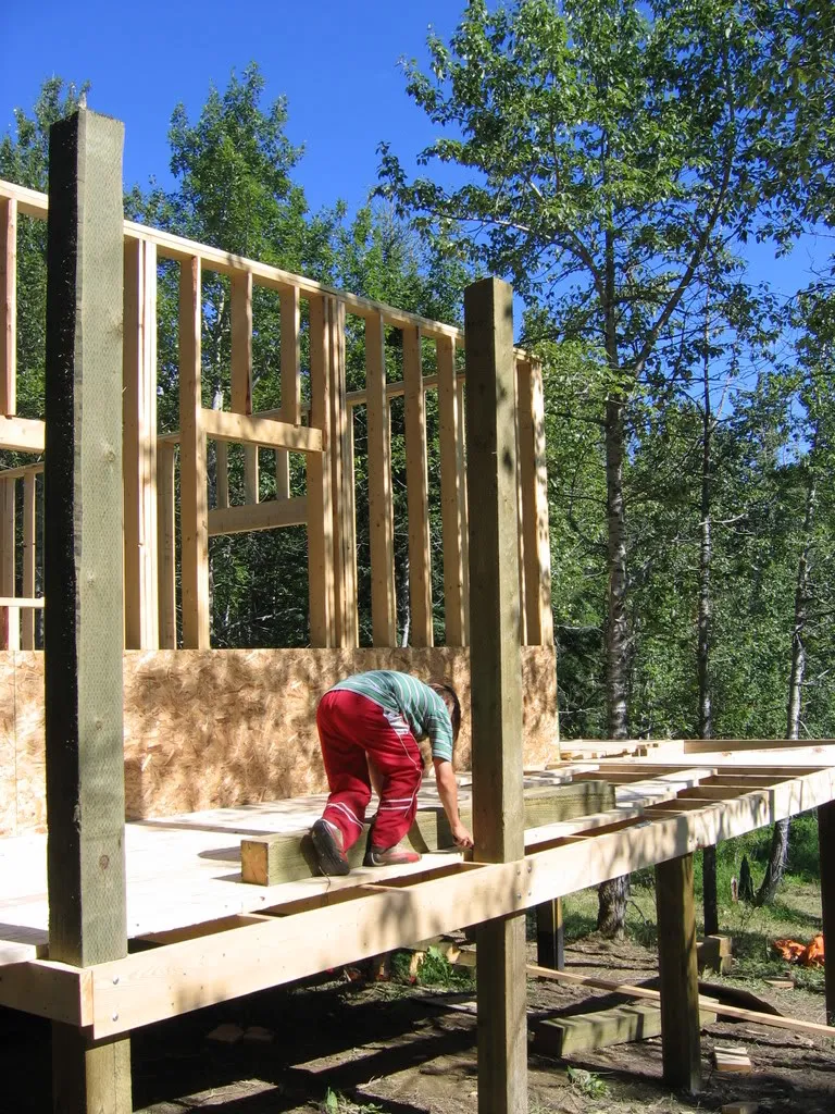

Two questions:
1.  I'm doing the floor this weekend - nails or screws?
2.  The posts in the front of the cabin are 4" high.  I want to evetually brace them and was thinking of 4x6 cross member from the top of one to the bottom of the other.  Any thoughts?

Alberta Curt
Thanks for the info.  Went out this weekend and got most of the floor done.  Still a little concerned about the front of the cabin being 5 feet off the ground.  Deck will be at least 6 feet.  It now feels like we are getting somewhere.
Sure need some feedback about different types of bracing I could use on the posts.
See the "Alternative Bracing" detail on sheet 1A. This would be for the taller posts and braces to the beams. The bracing should be PT if within 6" of the soil. Also see p. 10 in the booklet for tips on straps and anchors that can make the rest of the structure more rigid. Much of this will also apply to Post & Pier foundations.

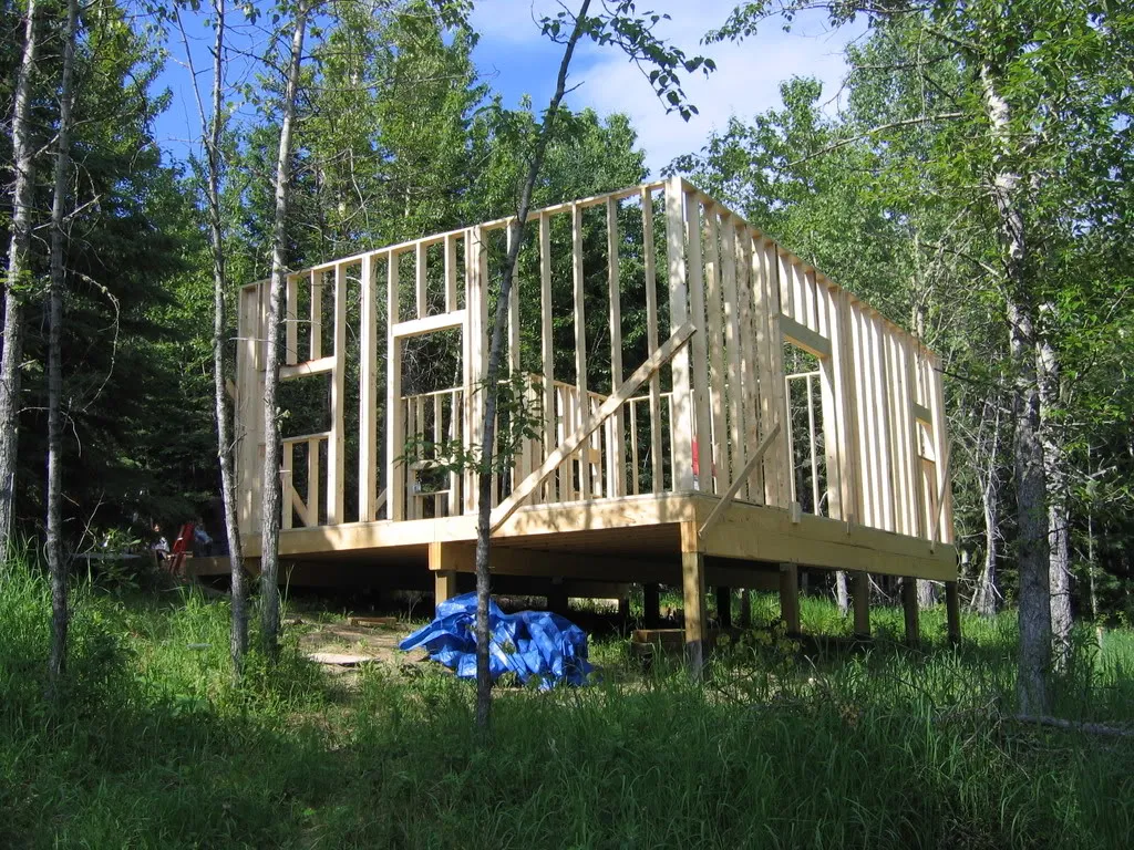

Walls almost complete...........
[img width=512height=384]https://countryplans.com/smf_images/i/f653c3dce5/walls.webp[/img]

Thanks John.  A couple of questions after our work this weekend...........
1. I didn't use 2x6 above and below the window/door headers.  The header rests on the trimmer studs and the top crpple studs are toe-nailed into the header.  Are there any structural issues with this?
2. Can 2x8's be used for loft joists?  The joists will be resting on a 2x4 load bearing wall at the 10' point.
The framing looks slightly OVE (optimum value engineering) but I don't see a problem. Comparing yours to this from Wagner...
I see you have eliminated a couple of supports under the bottom 2x6 window sill and extras at the top of the header. I do not think these add necessary support or strength.
Yes, almost any species 2x8 joist can span 10' feet when 16" o/c. - #1 D/F can go to 24" o/c spacing.

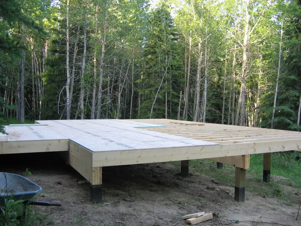

Hey Alberta Curt, I looked over all the photos in your photobucket album. Nice.
Question (and sorry if I missed the answer someplace); I see you appear to have used PT posts in ground. What was that black coating? Roofing tar?  Also what did you do at the bottom of the hole? Gravel, concrete pad, wood slab?
Thanks
Alberta Curt
The black stuff on the posts is a damp proof foundation tar recommended by the local Building Inspector.  I used 5' holes, with 24" cement footing 8" high, 3' of wash rock, and topped off with clay backfill.
