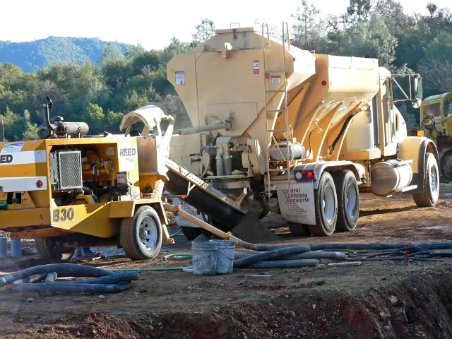

That is too much for me - maybe you can find someone with one of these then they can add water to the dry stuff and mix it on site -- all done by computer.. about 10 yards per load.
