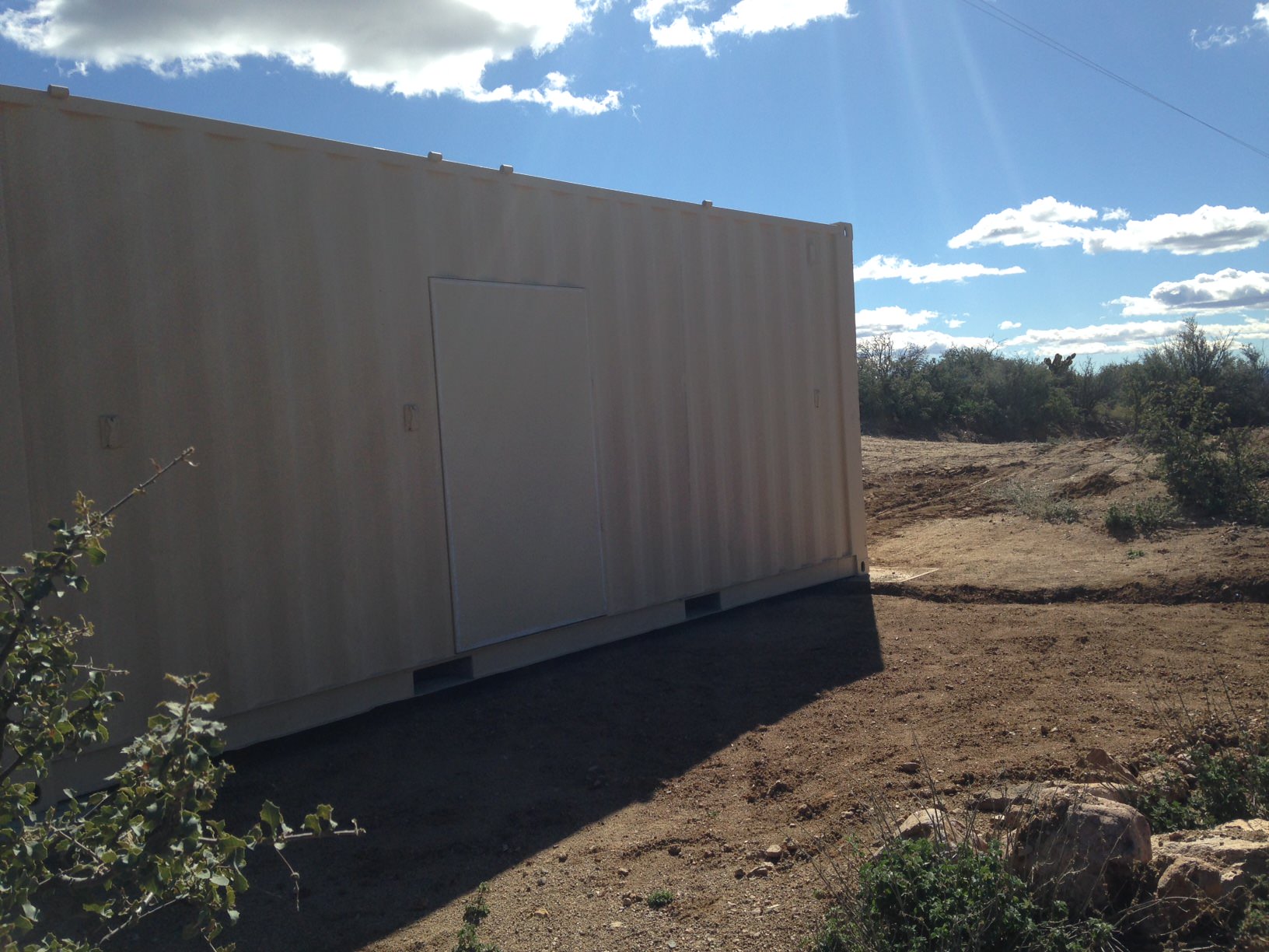

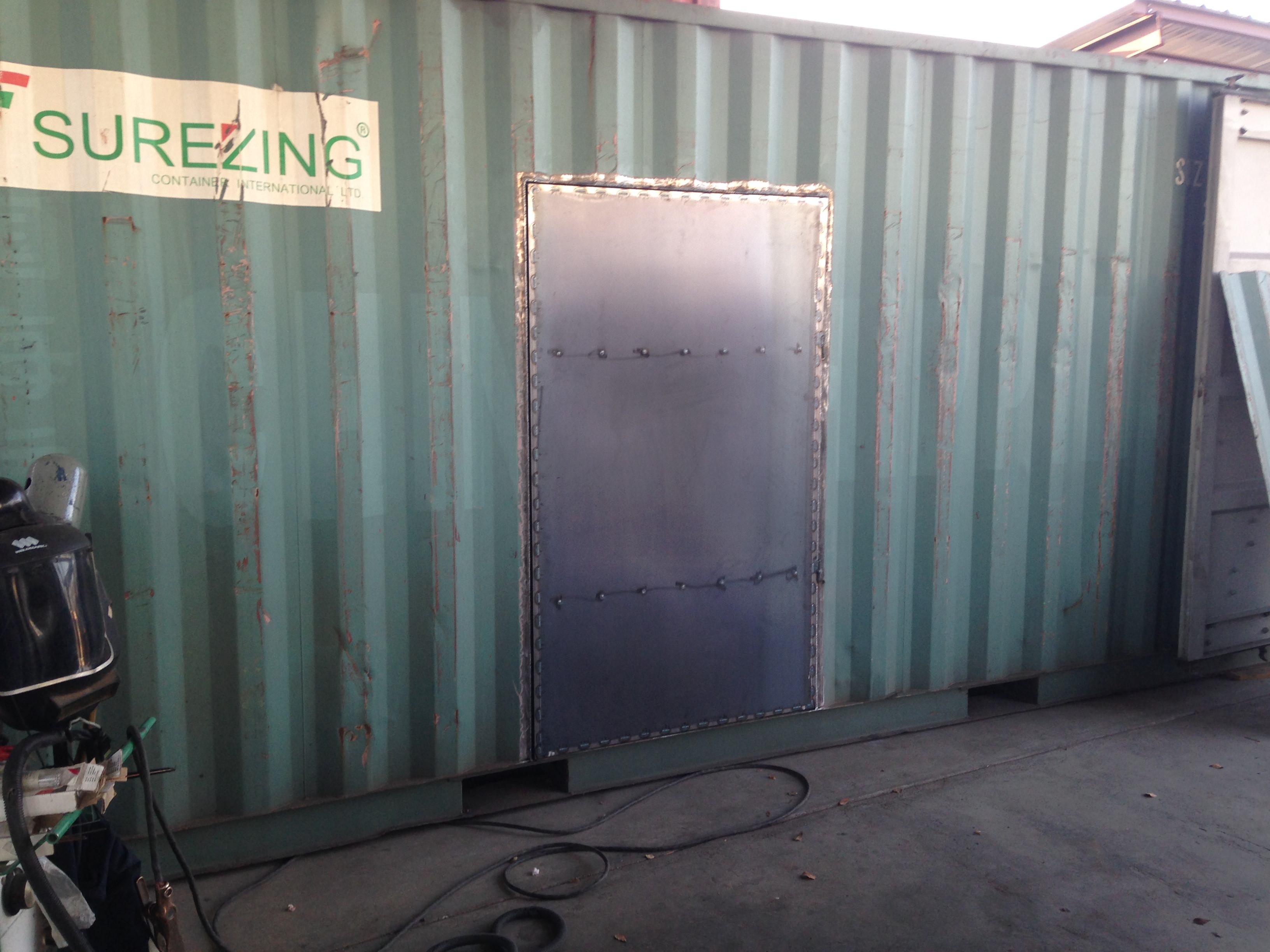

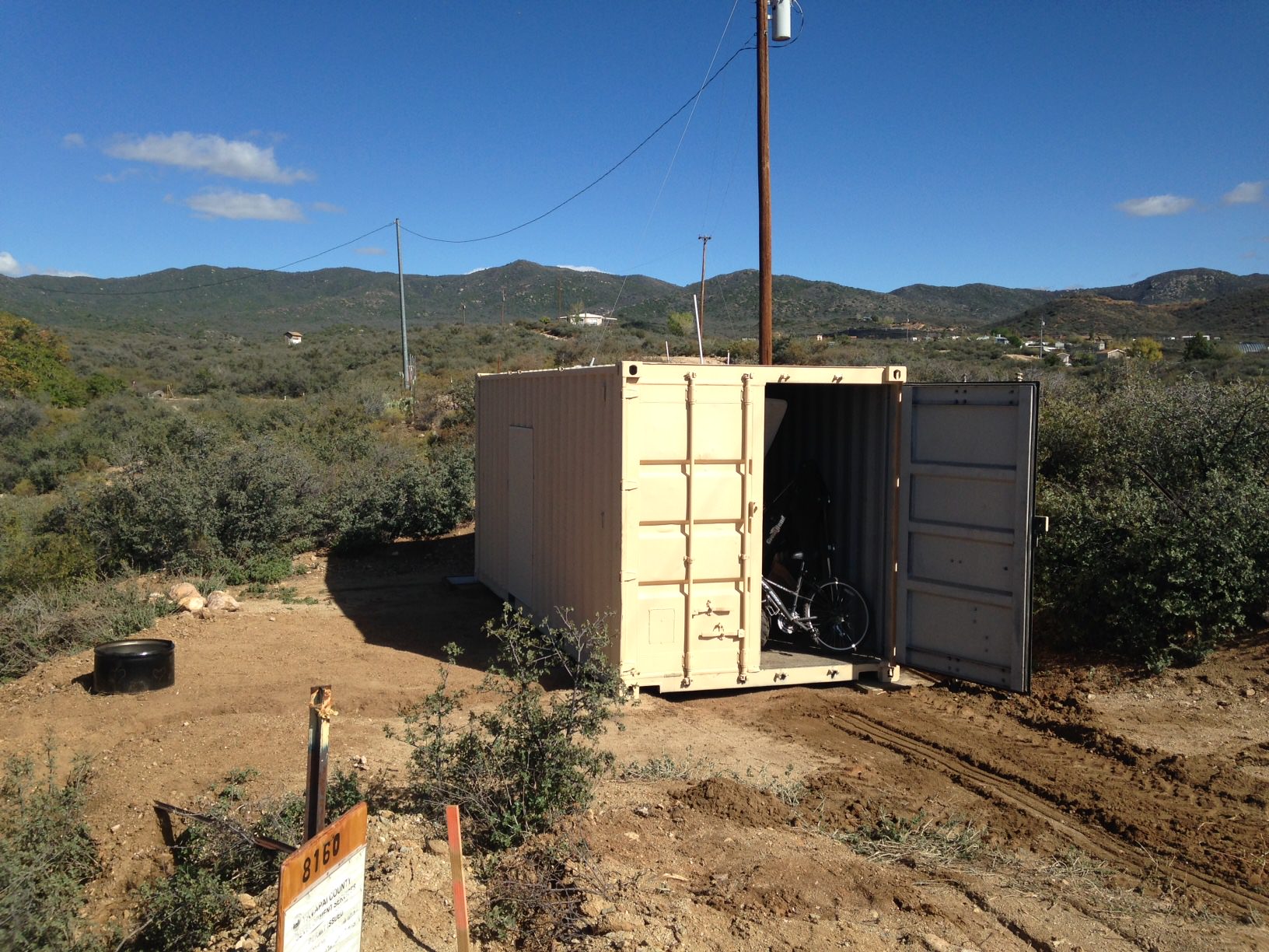

I have a 20' set up for my tractor storage and a covered work area inside and out. Big thing was being able to lock everything up. I will post photos when I get home. Also make sure the city/county is ok with it. My county was not. d* But I did it anyways.

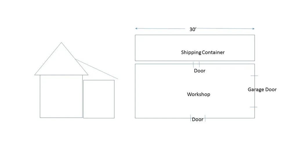

OK lets take a look at this.  30' container next to a 30'X20' workshop (wood construction).  The workshop will go on a slab and one of it's "wing" will cover the shipping container.  The idea is that the door leading into the shipping container will give me access to storage.  Should I use the container as a wall and build off of it? or just build it snug against it? Think using it as a wall will effect the insulation value? I'm not insulating the container.
I think you could pour a floor and frame that area cheaper and more useable?

BassLakeBucki
He is saying skip the container. You can stick build the extension/lean-to for less and have it be more usable. The containers value is in the security/fireproof it can provide. I also wonder if you would need a second form of egress (another door out).

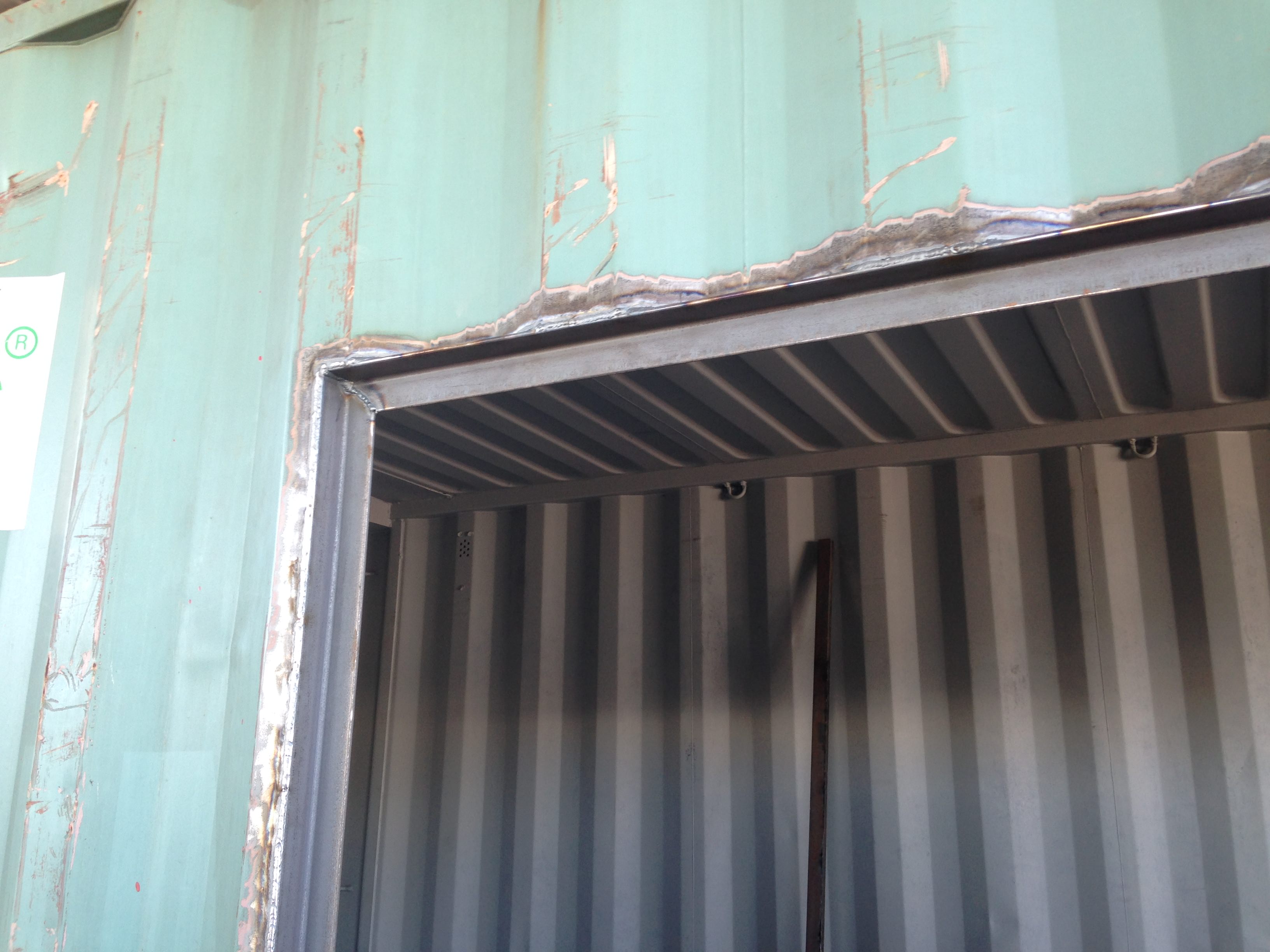

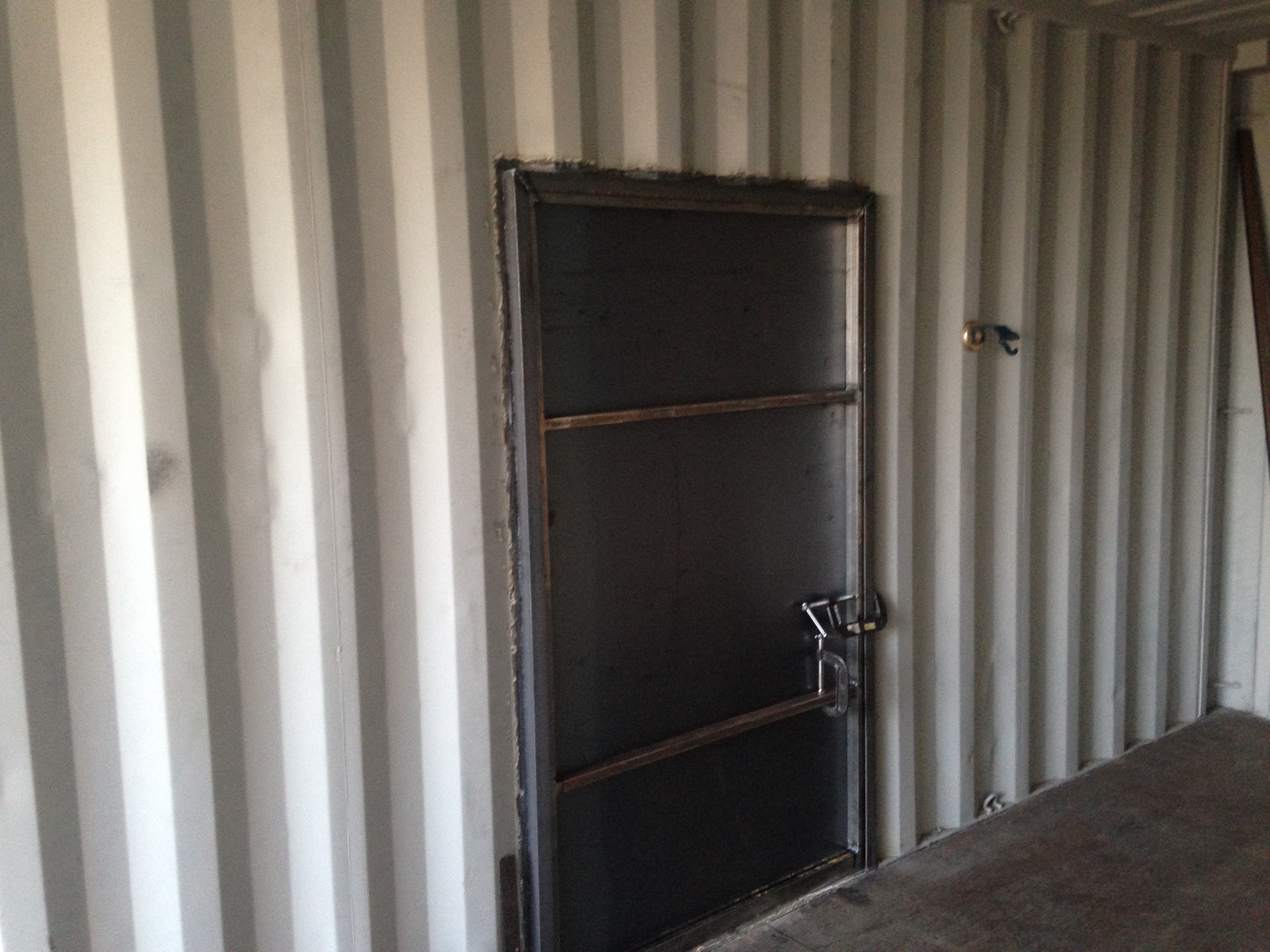

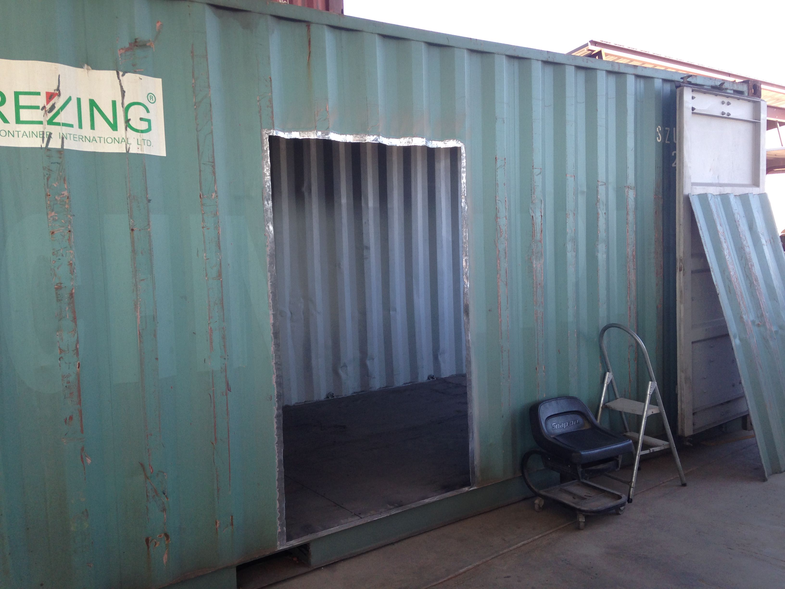

Schiada.. great pictures! The door frames look very nice!
