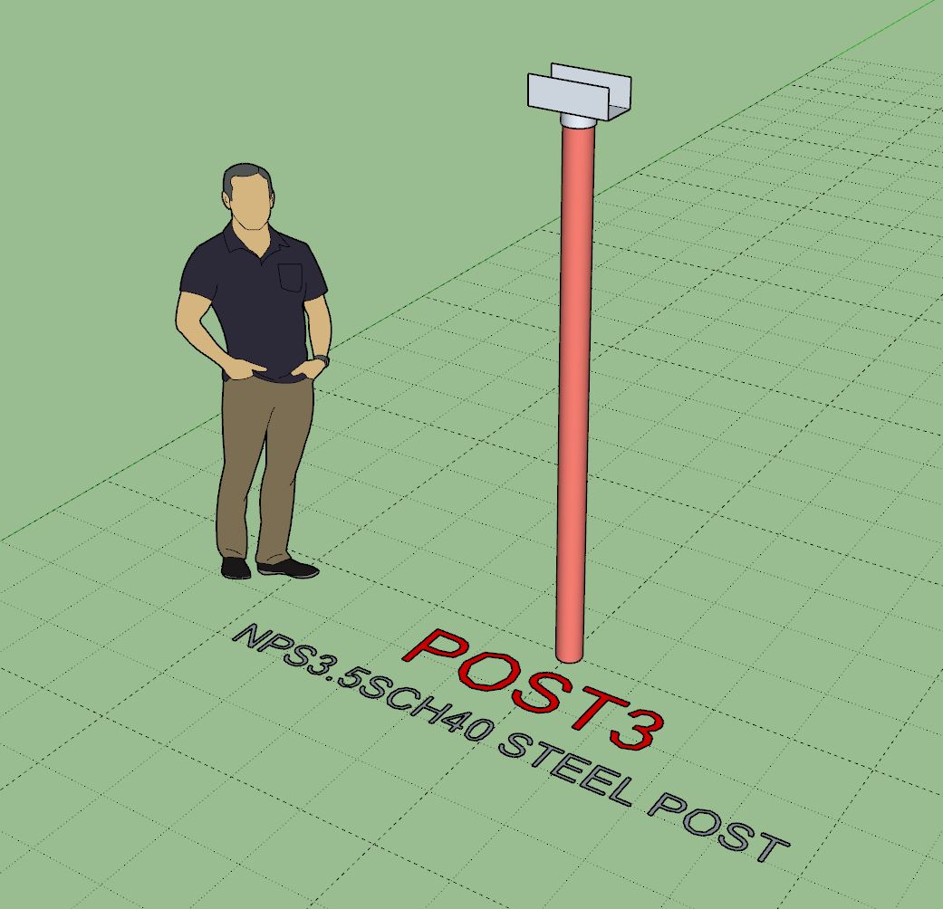

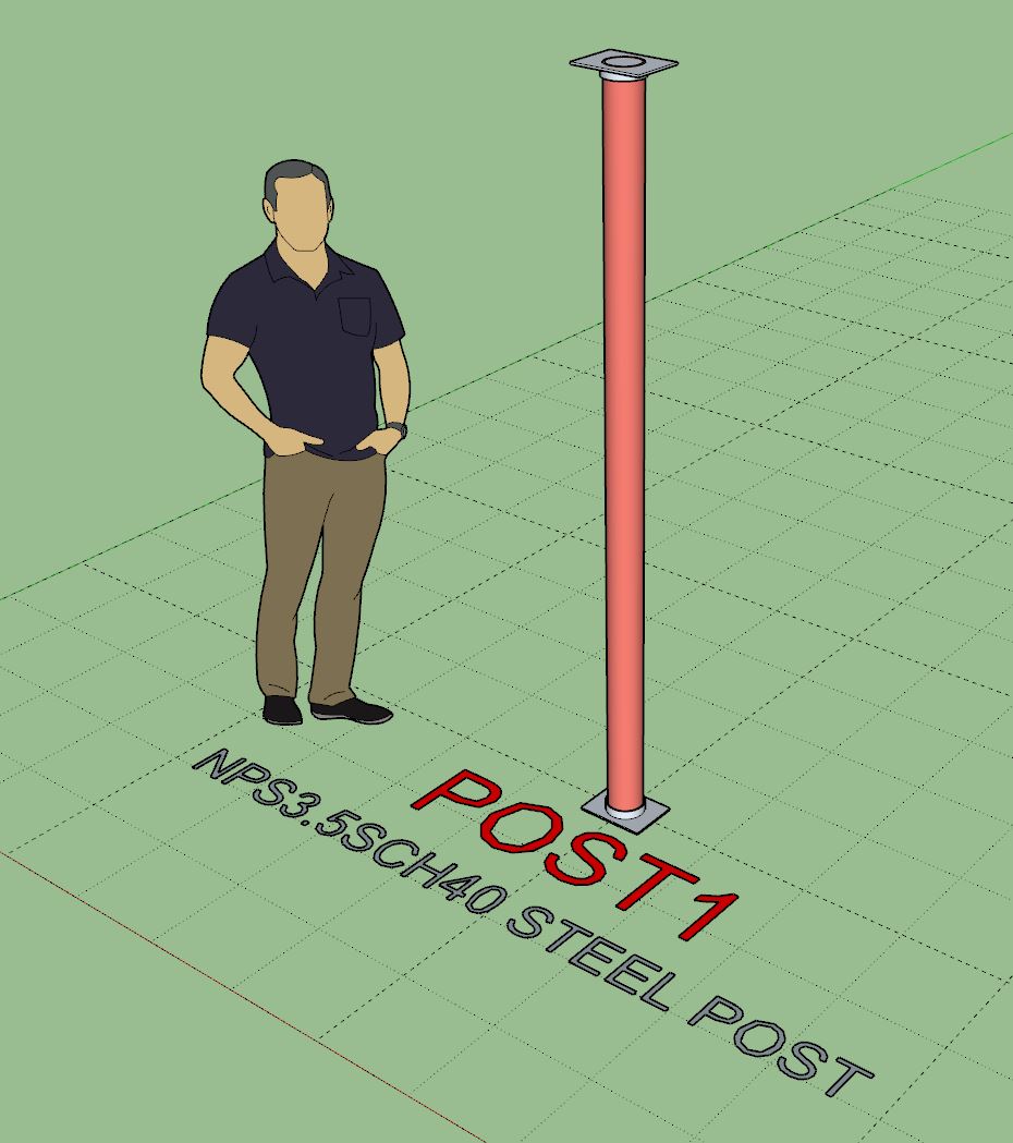

Medeek
Version 4.0.4b - 07.14.2025
- Added springfield plates to the post base and post cap libraries (for 3.5" and 4.0" pipe).
- Added the following Simpson post caps to the post module: LLC35_35, LCC35_4, LCC45_35, LCC45_4, LCC525_35, LCC525_4, LCC6_35, LCC6_4, LCC7_35, LCC7_4.
If I'm going to add in this new "pipe" post then it stands to reason that I also add some appropriate bases and caps to match.
Nathaniel P. Wilkerson, P.E.
