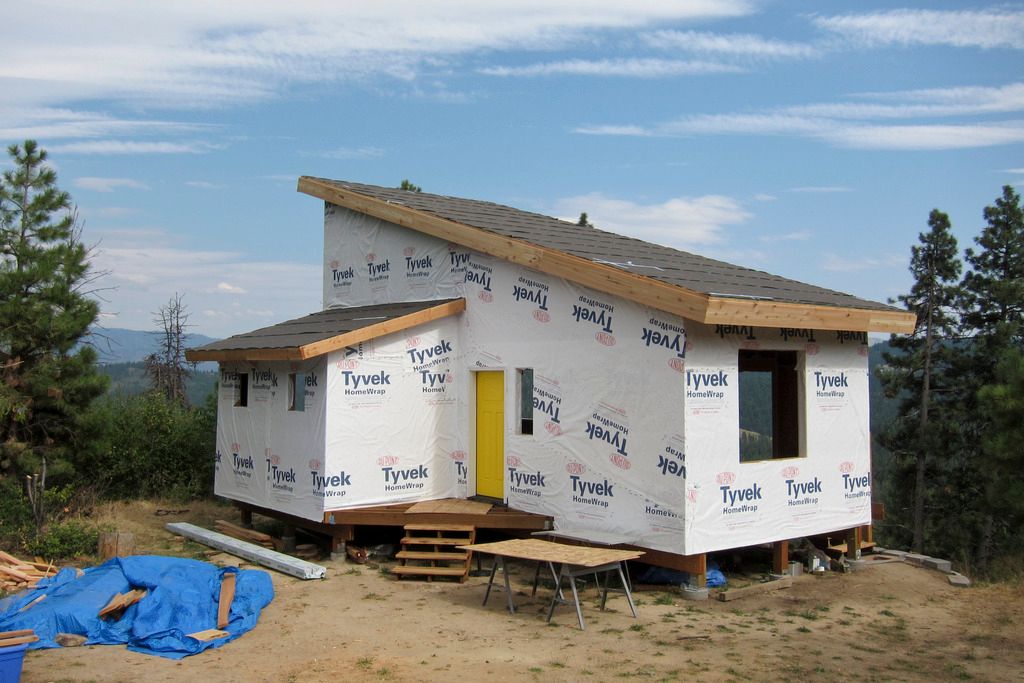

It's a metal roof installed over sheathing. My rafters, 2x12s, extend 2ft past the high/low walls of my shed roofed cabin. My fly rafters are out about 14". I was planning to do the T&G parallel one the high/low ends, and perpendicular on the long rake walls. Cutting the vents in, like you've explained seems like the best option so far.
Here's a pic of the structure.

Quote from: midrover170 on July 23, 2015, 08:57:33 PM
Hey Redoverfarm,
That helps clarify some of my concerns with your original question.

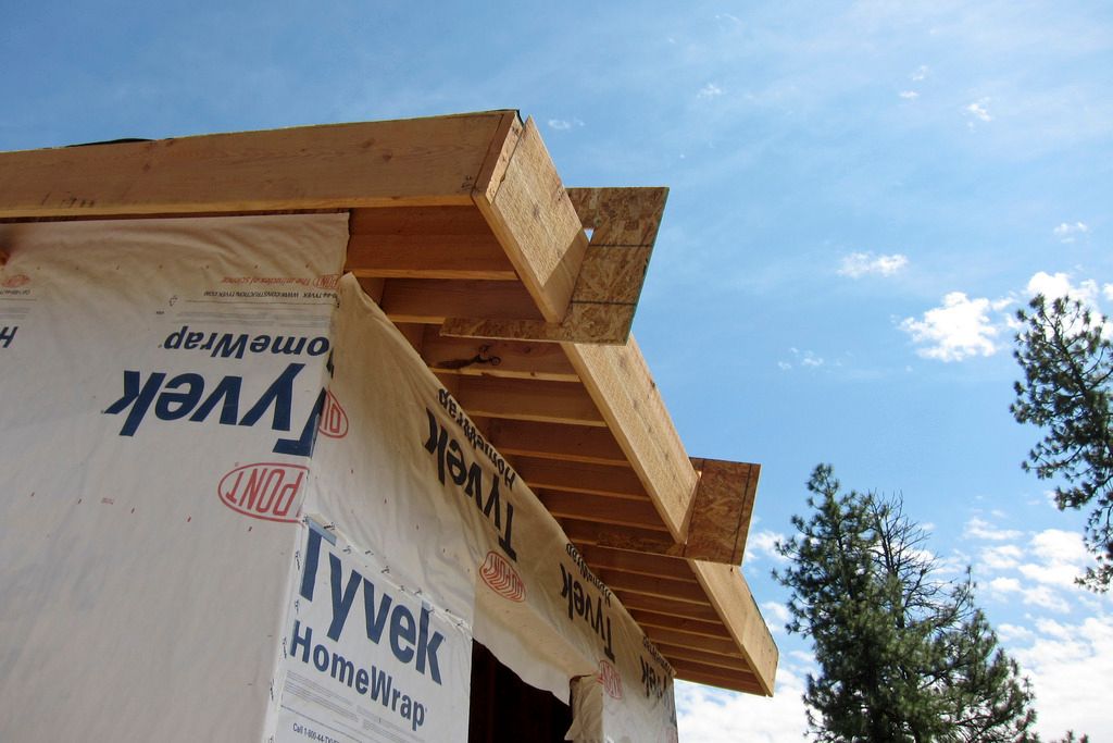

midrover170
Thanks, everyone.
I was able to install the fascia boards over the weekend (on the main roof) using a handy tip from this video:
https://www.youtube.com/watch?v=YZLJKyktEsc
I was working alone so no way I could have done without the jigs. Couple pictures below. Soffits are a few weeks/months out. Roof is going on next weekend, and windows sometime in between.
