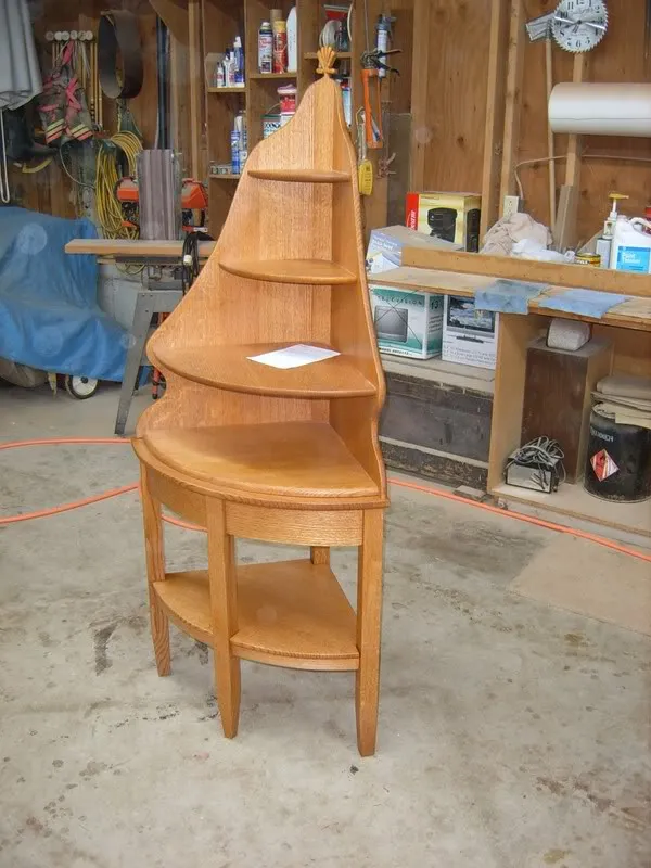

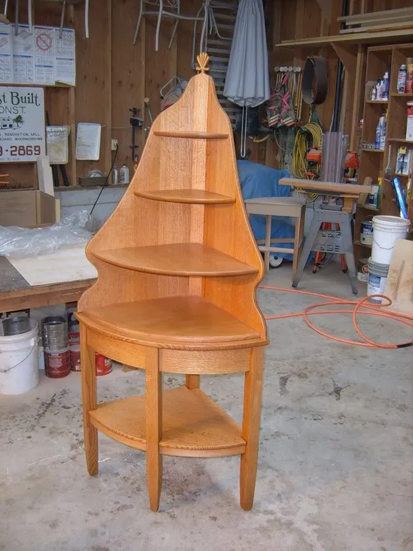

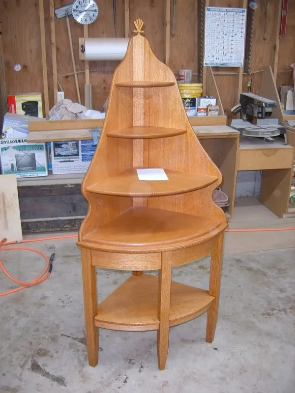

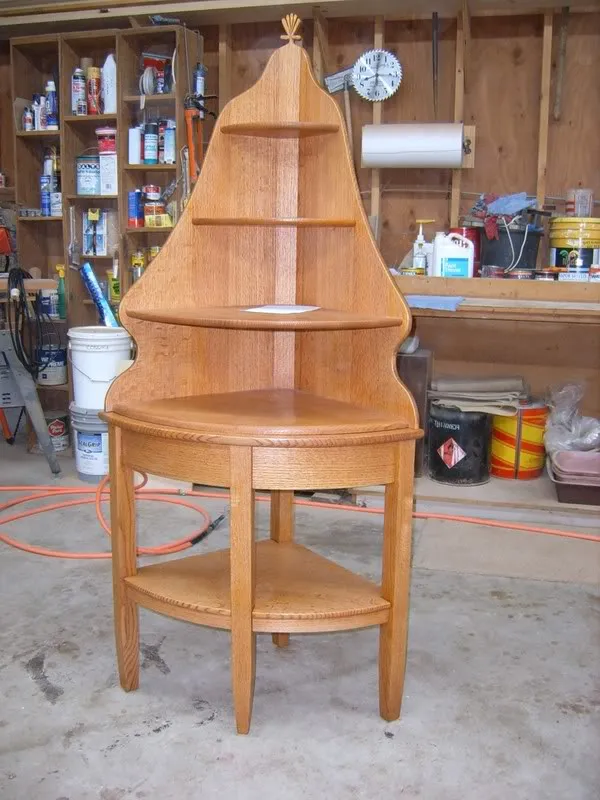

 Lastest table , the stand on it I made a couple of years ago .

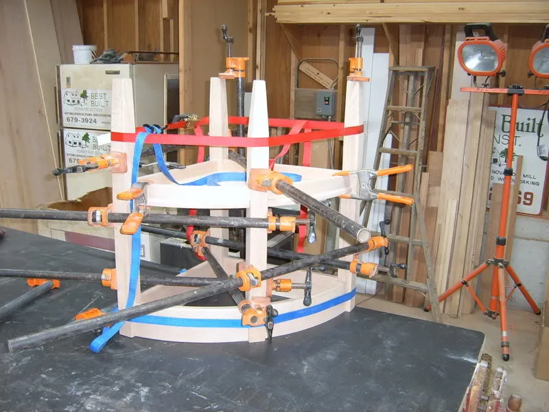

 In the clamps a couple of weeks ago,  :o

Love the clamps Paul!  :)  Table's pretty good too.  ;D ;D
Good match on the color.
Are the curved pieces shaped from solid stock?
 Thanks Mtn D.
 Bent laminations on the curved parts. Cut into thin strips , glued up around a form.
No wonder the finish on the curves looks so nice and clean. I did a cut/shaped curve piece once and the grain didn't look right, didn't match because of the different directional slices through the wood... as compared to the flat pieces. ... you know what I mean...
 Yes a sawn curve would go thur a variety of grain directional changes .

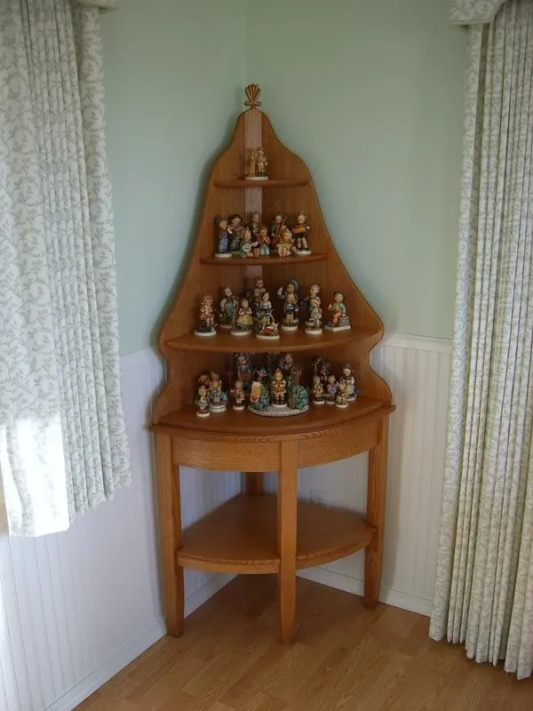

 BTW they really like it ,

Looks like it came from a store, PEG.
Doesn't everything?
Superb work. :)

What I meant was that it had that professional store bought look without the plastic wood picture veneered particle board.

Looks like the Hummel Clan get together.  :)
