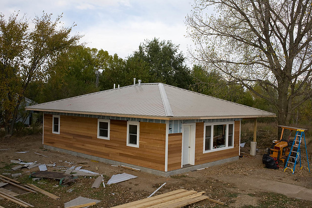

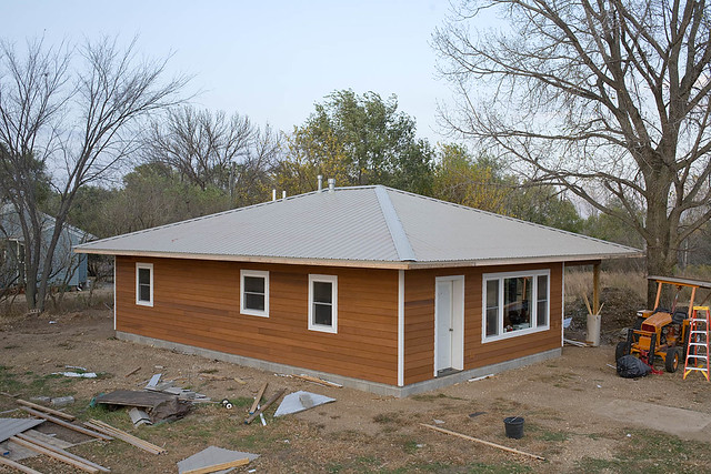

I applied a WRP (Water Repellant Preservative) to mine before I cut them to size, all 6 sides. As I cut them to fit during installation I treated the cut ends. Stained with a semi-transparent stain after installation, which went very quickly. I removed the trim before staining the siding. The trim was screwed on for that reason.
I liked the natural color before doing anything to it but LOVE the color after staining. Still looks natural.
Before stain:
20110927_001 copy_web by Alan  Gage, on Flickr
After stain:
20111007_001 copy_web by Alan  Gage, on Flickr
Don't know if it was the right way to do it or not but I'm happy so far, though it hasn't even been a year.
