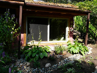

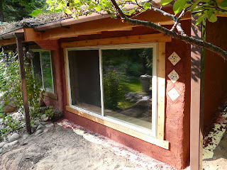

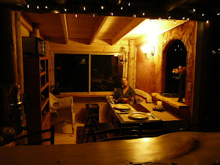

Broke ground after labour day...and just have a few loose ends to tie up...everything works...Takagi Jr on-demand gas water heater...Fisher-Paykel washer and dryer (inverter can push both of them, no problem...the dryer is gas)...pex tubing for water...
We also remodeled the kitchen this past spring...
Maybe we'll get to the addition off the back...utilising a clerestory...for a large bedroom...open things up...and tie the back door onto a deck which attaches to my shop's office...

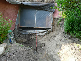

What's the white deposit in the wall of the first photos? Looks gypsum-like?

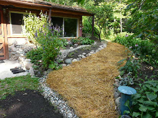

It would be a startling sort of a sight walking through the woods, approaching your place as in the sixth picture... all the "roof"penetrations.   :)

Y'know glenn, we don't have any 'soil' on our roof at all...we put compost and straw, leaves, compost, plant squash, straw, leaves, compost...plant squash...and let the organics build over time.  I'm careful to keep the material moist until after snowfall...I'd guess we have nearly 18 inches of composted organics on the roof of the house...plus another 8 to 10 inches of lofted straw.  The addition, just getting started, more loft...layed over with compost and then more loft.
I figure wet mineral soil could weigh as much as concrete...up to 150 pounds per cubic foot...where wet organics don't weigh too much more than water...which is 62.4 pounds per cubic foot...

When I first built the place, I'd stuccoed anything above grade...but then I buried the entire east and west side after building some retaining walls...and the stucco on e/w sides got buried.
23 years and there wasn't a bit of rot in even the rim joist of the wall...that's pretty amazing for untreated wood buried...although, I was very careful to isolate everything from direct contact.
You are using a heavier or EPDM membrane, arent you and with the 10 foot or so umbrella outside the cabin?
The compost is a great idea - much lighter than earth which is about as you calculated.  Not quite as fireproof unless wet as you say.  I think I will go for more squash on the roof next year and root crops out in the compost and soil garden we expanded into this year.  I hope to get a couple inches of compost or loam and succulents onto the shop roof one of these days.  Get a little bit of that thermal flywheel effect or at least a bit of a break from the summer sun.  Hard to beat the squash leaves and winter squash for storage and food through the winter.
lodestar
I've used .45 mil EPDM, and I lapped it by half coming off the existing roof...and extended it to about 8 feet off the new roof as an umbrella...backfilled with very clean sand...which should remain dry and act as a thermal flywheel.  You're right...those squash leaves stay about 8 inches or so above the roof, keeping everything in shade...cooling the house.
