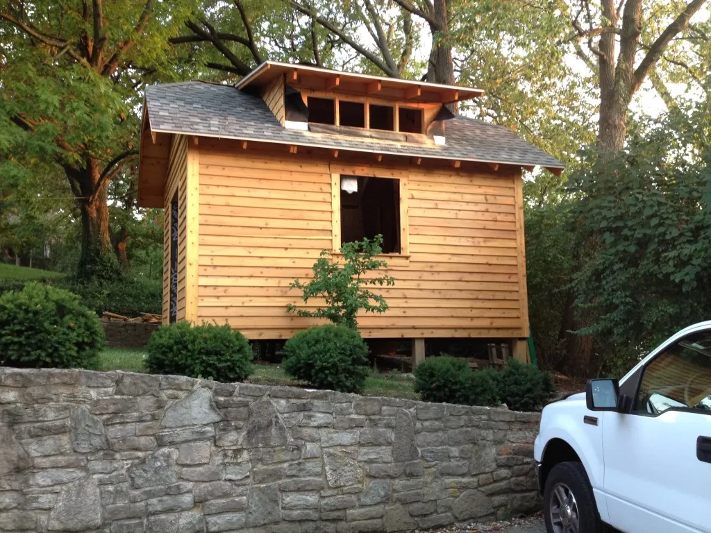

I cut out the holes for the windows in the dormer.  Gives a better feel for what it will look like when finished.  I will probably only trim out the windows up there but not the corners.  I'll just butt the shingles together to hopefully give a beveled look from ground level.
I ended up just drilling holes to vent the siding and roof.  I was originally going to fur out the trim between the rafter tails, but decided against doing that.  I'm not sure what I think of the holes, but unless your standing right underneath it you don't see or focus on it.  You can also see how I trimmed out the window, pretty happy with it.  I made the mistake of not adding extra blocking under the corner trim of the shed.  I did add extra under the window trim, and the visual differentiation is  nice.  It tends to cast shadows and create more of a contrast.  Lesson learned for next time.
And here is how it looks coming up the driveway.

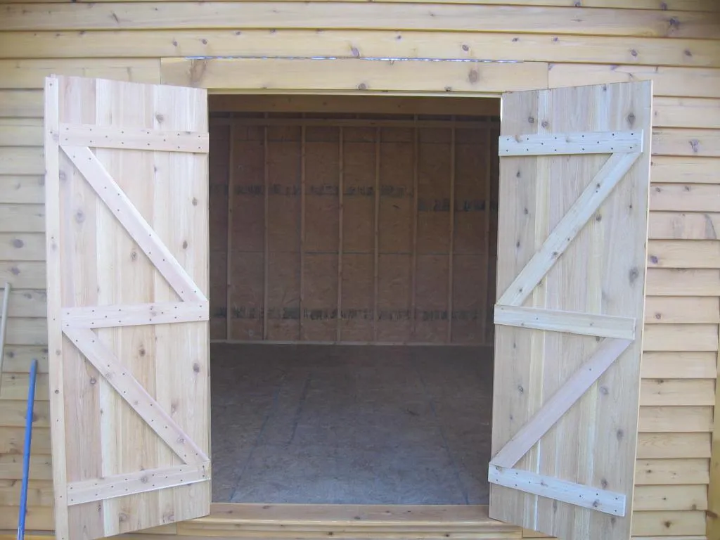

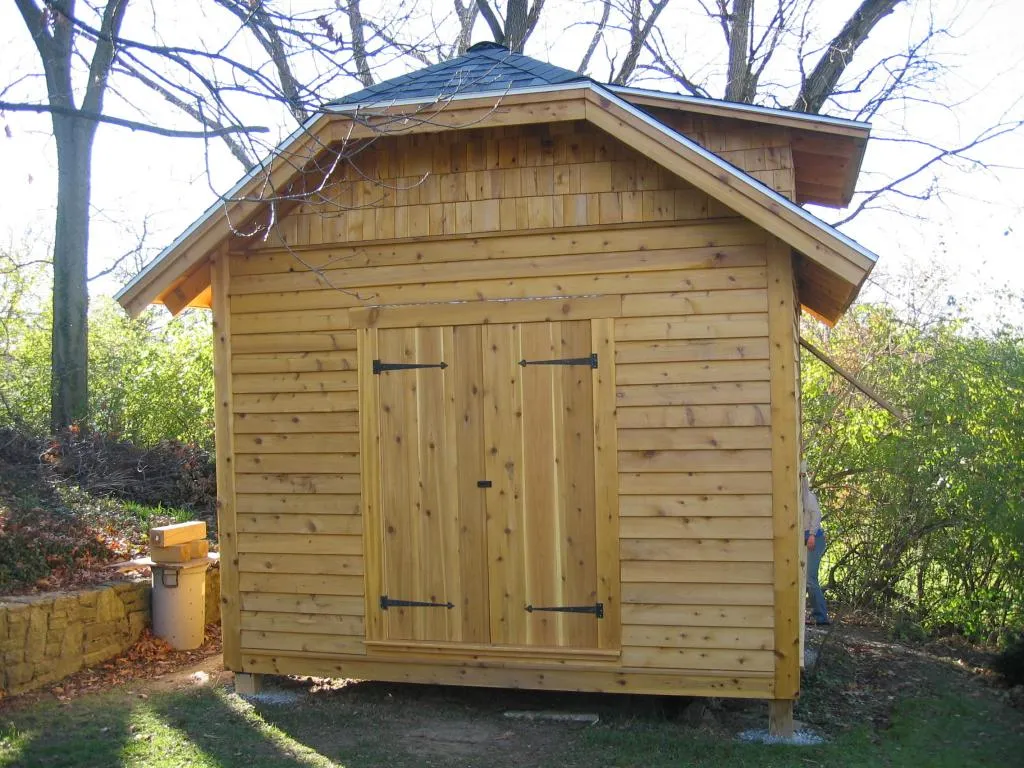

Well about a year to the day I started I am done with phase 1 of the workshop, shabin, Taj M'shed.  I finally got a door on it which means I can not lock it and leave my tools out there rather than hauling them in and out everytime I work on something.  I will admit I am a bit worried about wood movement causing the doors to buckle but this is the way the book I have said to contstruct them.  There is about 3/8ths of in inch combined space for them to expand.   I can always re do them if I have problems.
I also got the final side of siding done.  Didn't spend too much time worrying about details on this side since it is blocked by trees and only seen from far away in the winter.
