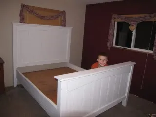

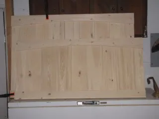

I thought a Swanson Speed Square was a silly thing until I USED it.  I do as much woodworking as DH, I built a bed for our bedroom last fall and I used it constantly for marking, making sure things were looking square and it was small enough it was always handy!
The bed in process....
DH using the speed square while setting the bed up in our bedroom.
The kids testing out the bed.

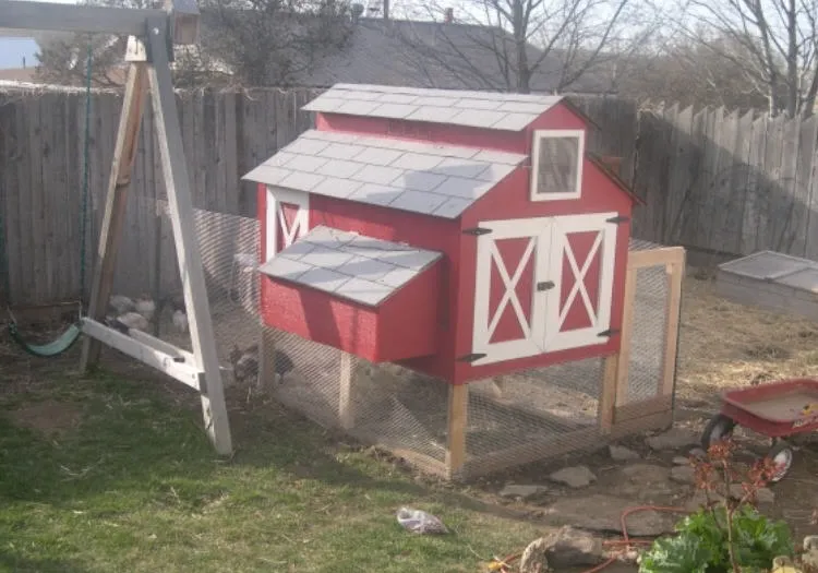

Here is something the kids and I had fun building....
A chicken coop.:)
Boy did we have fun with building that, we got to get creative and the kids loved helping.
