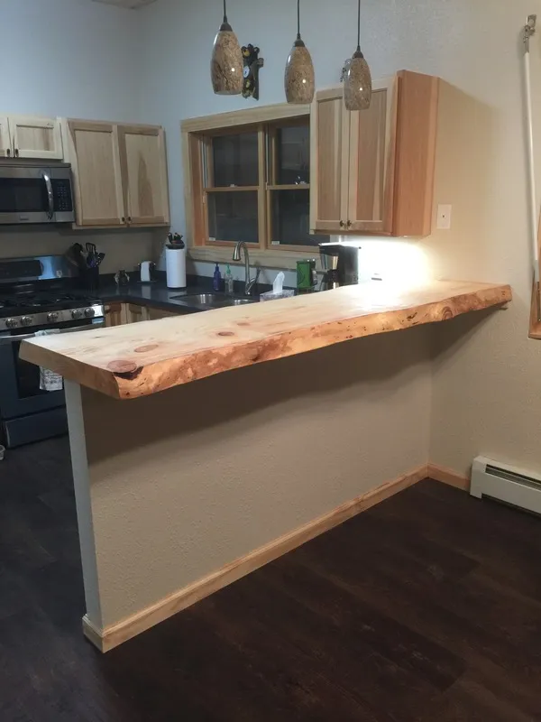

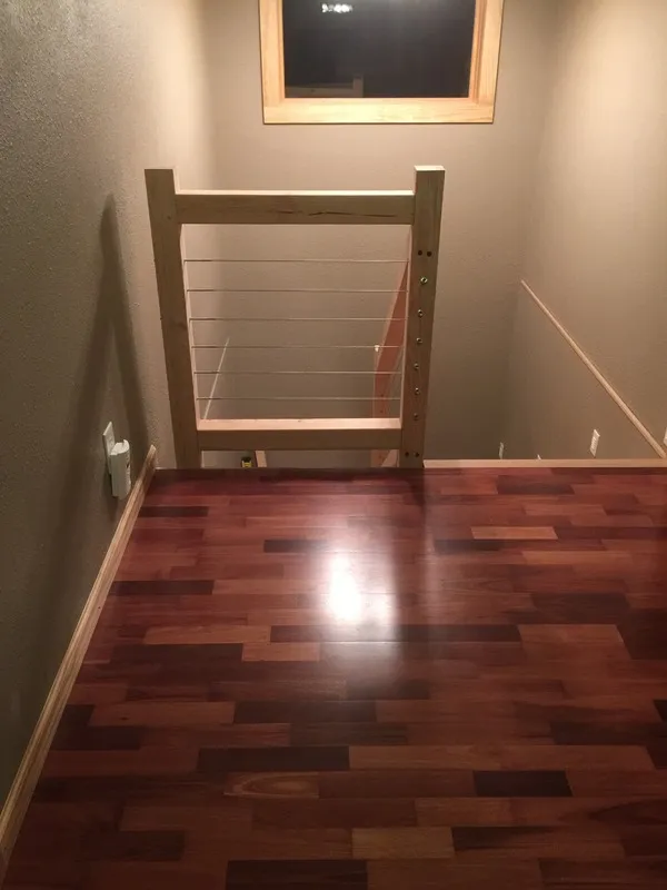

rdzone
All finally done!  (For the most part). Been slacking lots going on in my life, but thought I needed to post pictures of the final project.  Sorry for any repeat photos.
