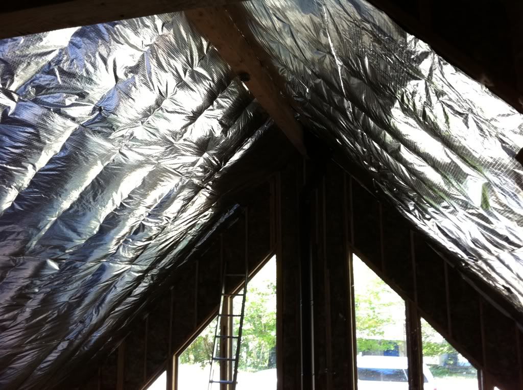

I had originally planned to have insulation installed this past Friday, but alas the company had to order more R38C as they don't carry as much of the high-density stuff in stock regularly.  No problem...going with the flow.  We still went up and got a few things done.  I had a few punch list items from the last set of inspections, so I got those things all knocked out (extra strap in the crawl where the 3" DWV pipe went through the plate, changed out the w/h pressure relief valve to cpvc and fed through the wall to outside, hard-pipe the kitchen vent, few extra wide nail plates for studs with plumbing, etc.).
Since there isn't that much to do inside right now (which feels weird btw), I installed some light fixtures on the front and started framing the front porch.  I ended up making it a bit bigger than originally planned, but we're liking it a lot.  I'm finishing the deck with cedar, which is what I'll do for the decking on the front as well.  There will be a wide set of stairs facing the driveway, but I didn't get around to even starting those.  Instead we all went up to Paradise for the morning on Sunday to have a few snow ball fights!
On the plus side, insulation goes in tomorrow!

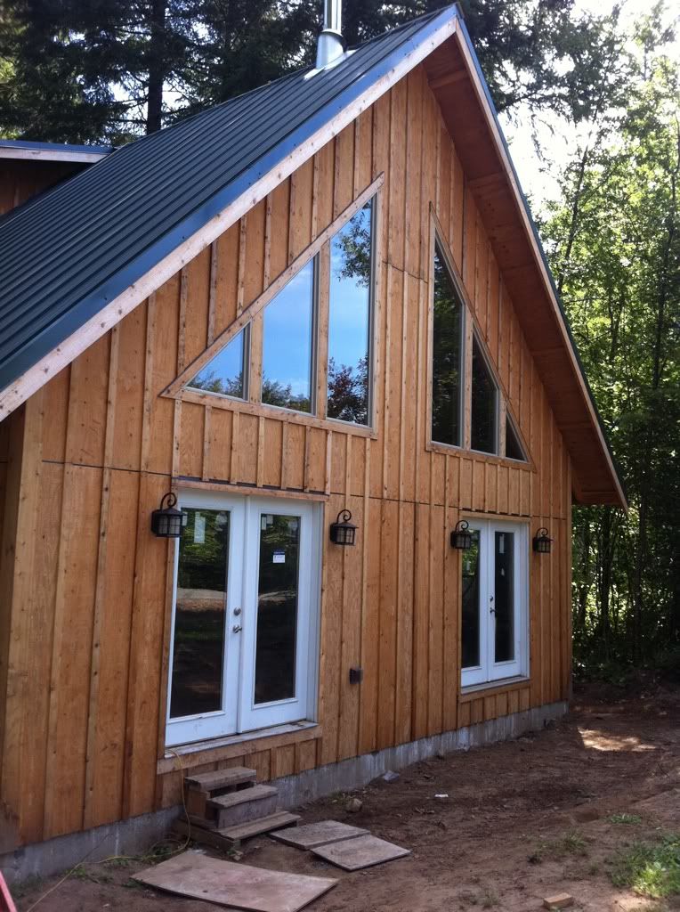

Lights!
Front porch

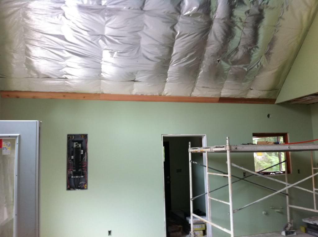

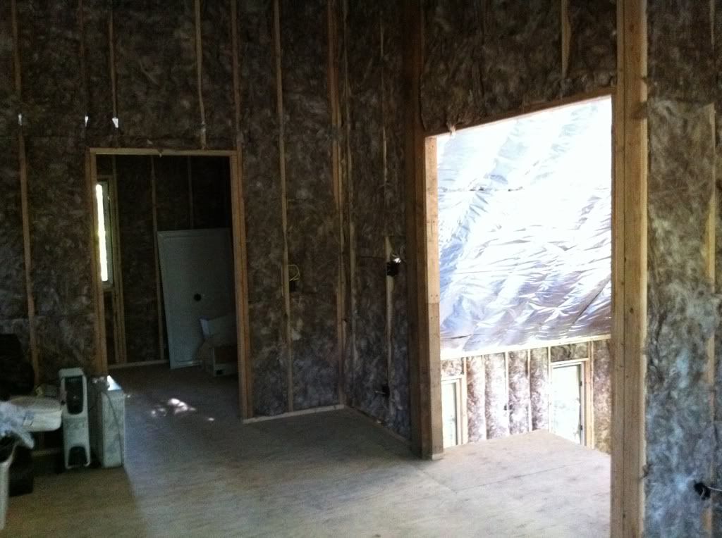

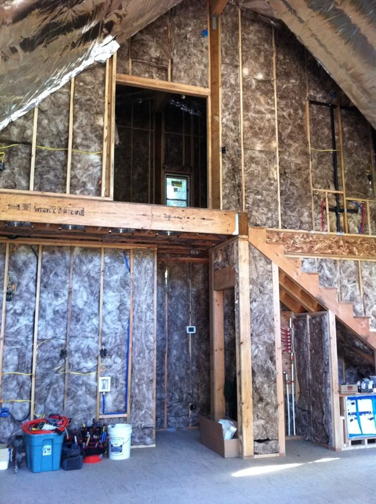

Insulation went in yesterday.  I had R38C put in the ceiling, R21 put in the walls, and R30 put in the floor.  Then I had sound insulation installed in every interior wall and the loft floor and stairs.  It's amazing how quiet things suddenly were after all of the insulation was installed.  Finally, I had FSK paper put up on the ceilings where the cedar T&G is going, they did the "energy seal," and all exposed pipes in the crawl were insulated.  The crew of 4 was in and out in ~4 hours and cost far less than just buying the materials and diy.
I'm getting bids from people for sheet rock now which I expect to start next week...

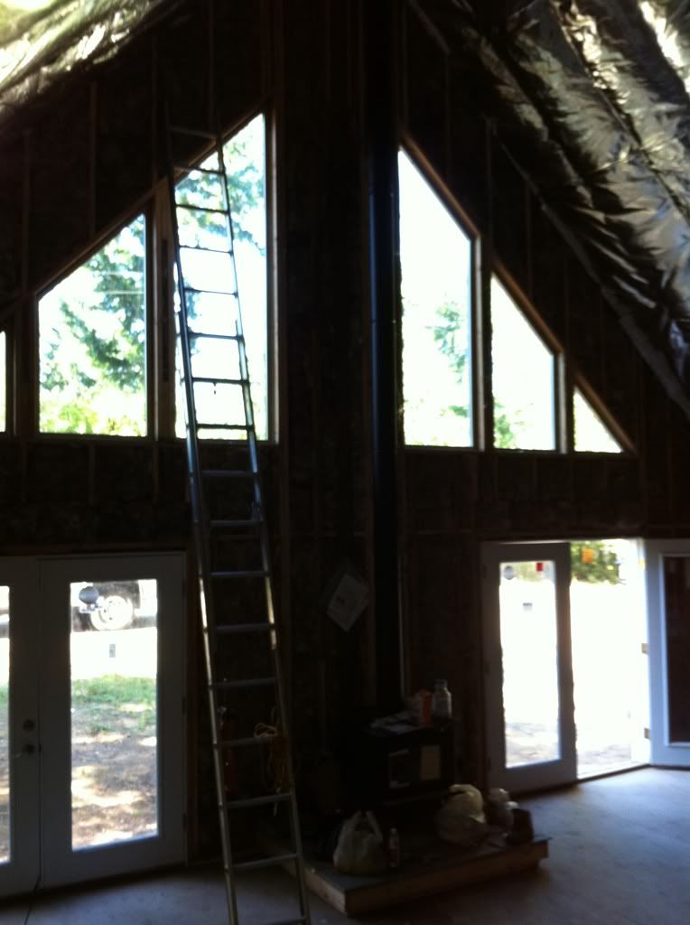

I realized I didn't have a pic of the wood stove pipe install. A bit dark given it was so sunny outside, but you get the idea
master bedroom in the loft looking forward
Mbr looking across from the master bath

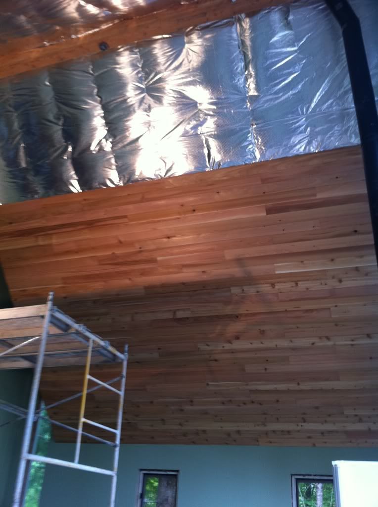

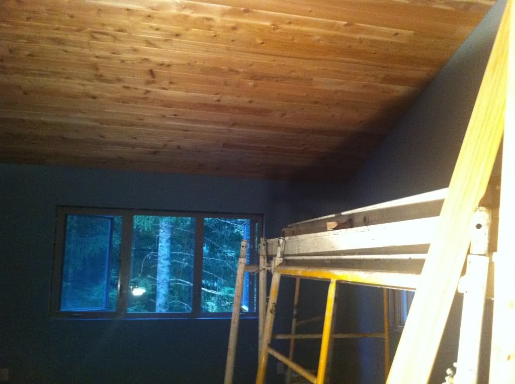

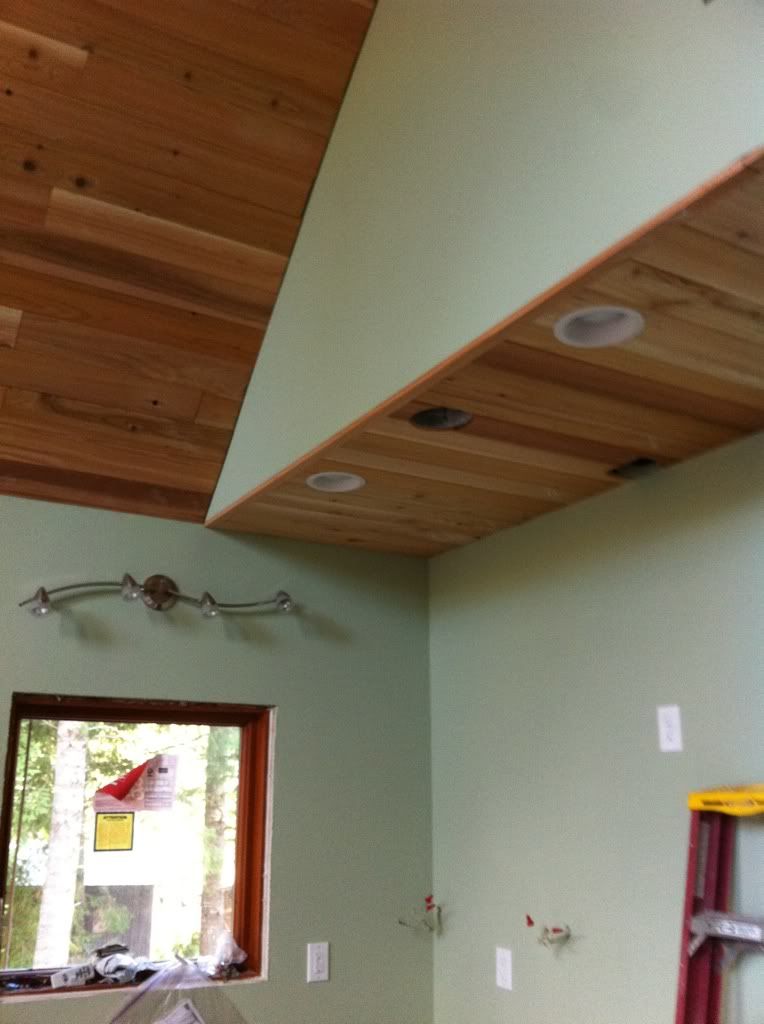

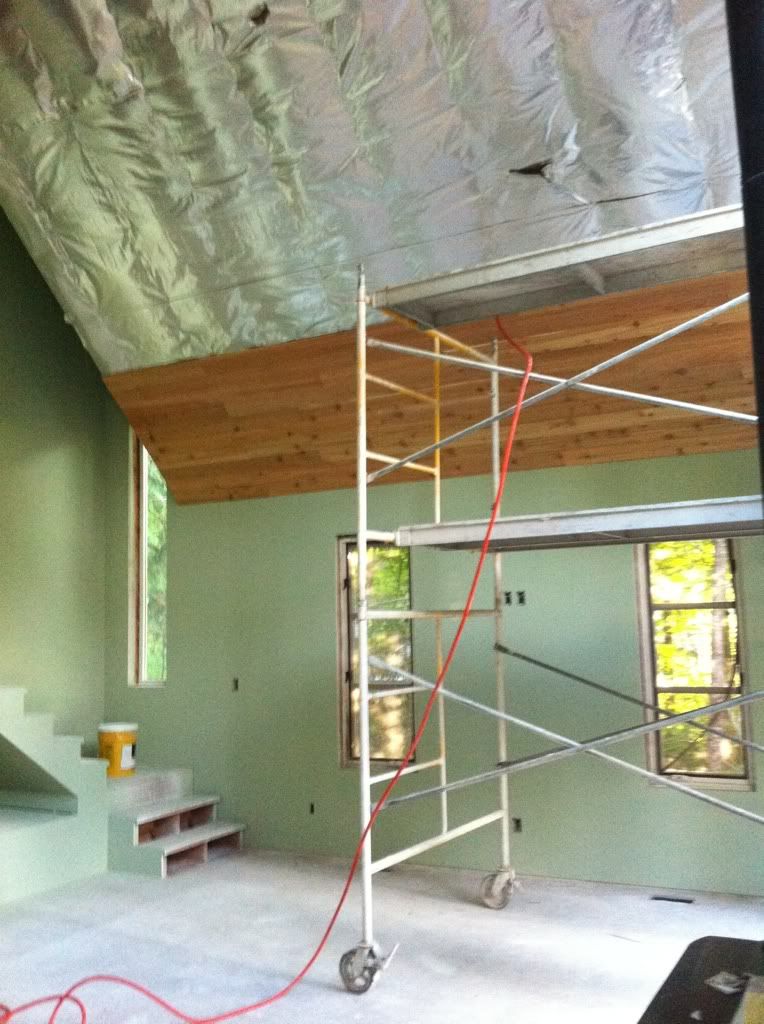

We got all set up and started on the large open area of the ceiling first, which definitely proved interesting.  The sections of the ceiling in the great room are just shy of 20' wide and 20' "long" from the top plate to the ridge beam.  The bummer was that I had to cut every piece, which I did after figuring out which pattern to use and then staging the courses.  Then I started banging them up there.  I think each side took 47 or 48 courses.  We had 3 levels of scaffolding and at the end we had to put the planks across the very top which I have to admit was kindah scary given how much movement there was (we were also short 2 sections of cross bracing).  So I would stage the courses and my brother would move me back and forth, except for near the wood stove which required moving close and and then swinging perpendicularly over the hearth.  Fun stuff.  Each side ended up taking about 24 hours which included breaks and 6 hours of sleep time.

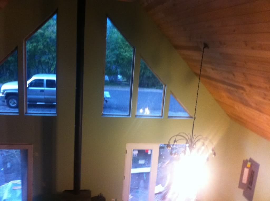

We also fired up the wood stove for the first time.  It's just an inexpensive one from Lowe's (Pleasant Hearth is the brand), but works really well.  Going to take some getting used to it I guess.  I'm not sure why but it was very cool to see the smoke come out the chimney for the first time.

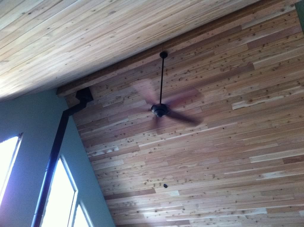

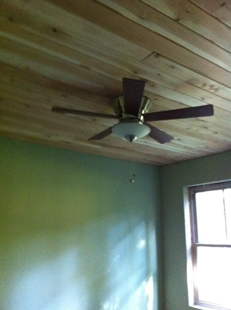

After finishing the two large sections of the great room, we installed the 68" ceiling fan.  It looks like a huge wood prop and doesn't appear to be moving fast, but moves a lot of air.  Since it's marketed for a "great room," there aren't any of those pesky little chains hanging down, and no light.  So it operates entirely by remote control.  Kind of cool.  After all of that we moved upstairs and set up the scaffolding in the master bedroom.  This was nice as we only needed a single level throughout and we set up multiples so I could run across all of it without having to be moved.  The last several courses near the ridge beam required standing on a bucket on the scaffolding, but that just made it more exciting.

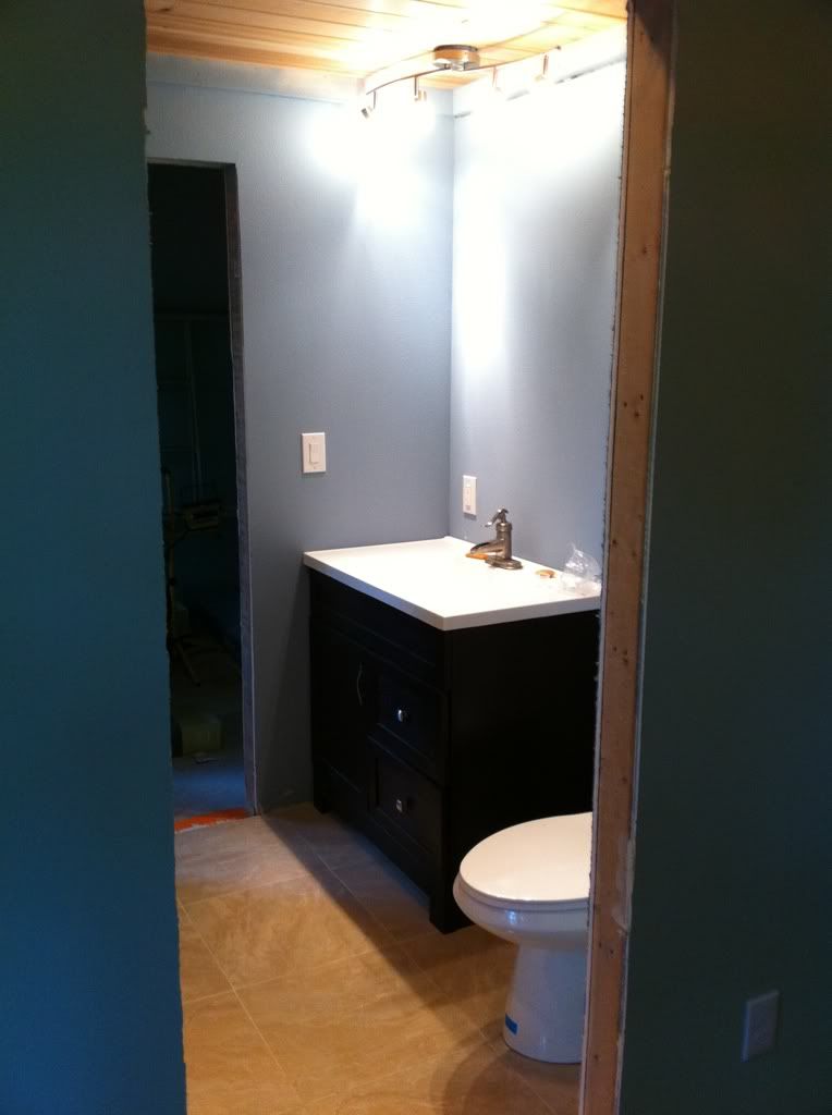

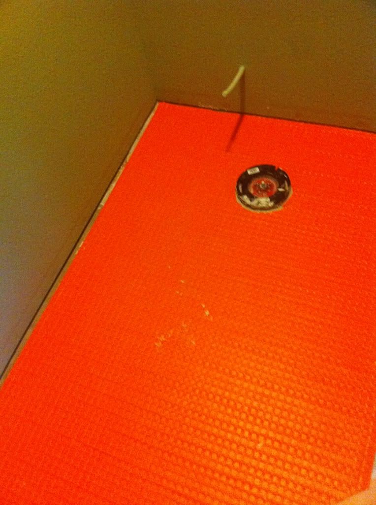

Finally, we laid Ditra and tile in the downstairs bathroom as well as Ditra in the "potty room" in the master bath.  That way next weekend I can install at least one toilet, which will make the kids and wife VERY happy.  ;)  It's the little things.  I still have to finish the ceiling in the master bath upstairs, the narrow section over the stairs (more 32' ladder fun woo-hoo!), then move back downstairs and finish the small ceiling overhang in the kitchen, the ceiling of the 2 downstairs bedrooms and bath, and finally the mudroom.  But the ceilings are limited to 9' in those first floor cases, so I now consider those pretty trivial.   :P

We made it!

Master Bath "potty room"  fan/light combo and recessed can as well as floor.

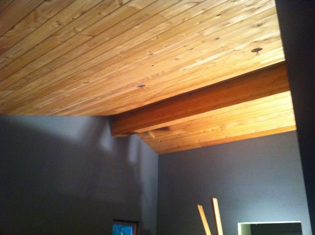

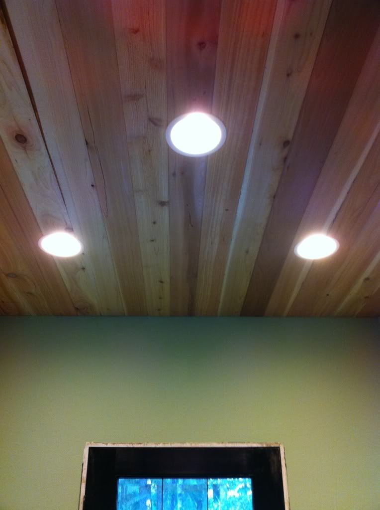

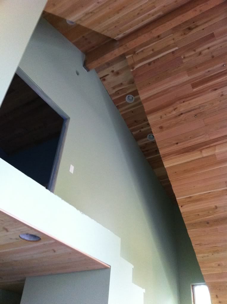

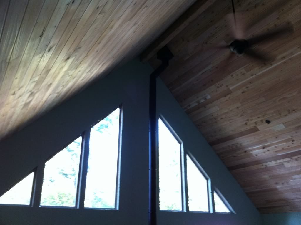

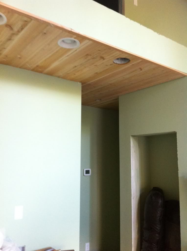

The big news is that all ceilings are now done!  Yes, every ceiling in the place is 1x6, T&G cedar.  It took longer than expected (yeah, big surprise right?), but it's over.  The last section was the narrow section over the stairwell that is at the 4-12 pitch.  I knew I could start it with a ladder on the stairs, but figured the crux was the middle.  I did a couple of scary ladder tricks for a few courses and finally built a platform from the upper landing extending out over the stairs and then used a 8 foot A-ladder on top of that.  It was still the scariest part of the whole ceiling endeavor - guess that's why I left it to the last section..    d*

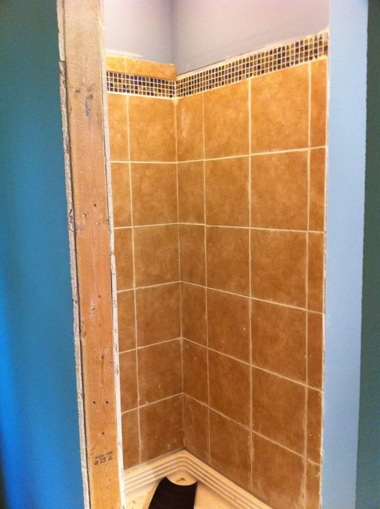

We also got the downstairs bath mostly installed, say 80%.  Got most of the shower tiles installed with the exception of a few edge pieces up by the glass tile accent "stripe."  Edges need to be fixed up a bit still, but those are details.  We had the vanity already, but we bought a sink topper thing and I got the plumbing all done to hook it up, so that's all done.... and of course, most importantly we got the toilet installed.  I bought dual-flush toilets not to save water so much as I've read that because they are designed for lower flow, they are more efficient in moving things along.  I like the sound of that, so in it went.  Yes, the wife and kids are much happier now.   ;D  Bath fan and all lights are in as well.  The only things left are some cedar trim around the 2x4 that I used as a pseudo ledger around the dropped part of the ceiling, cutting up some of the tiles for the baseboard trim after I get the door trim on, and thresholds.

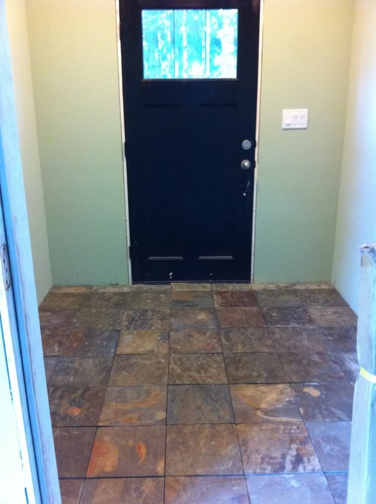

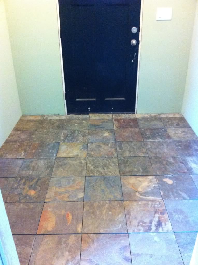

We also got the slate down in the mudroom.  We had previously decided to go with Ditra instead of cement board just for ease and speed in installation.  It's pretty nice stuff.  So, we laid down the Ditra in there one weekend and put the slate down this past weekend and are pleased with the look.  Grouting and sealing will happen this coming weekend.

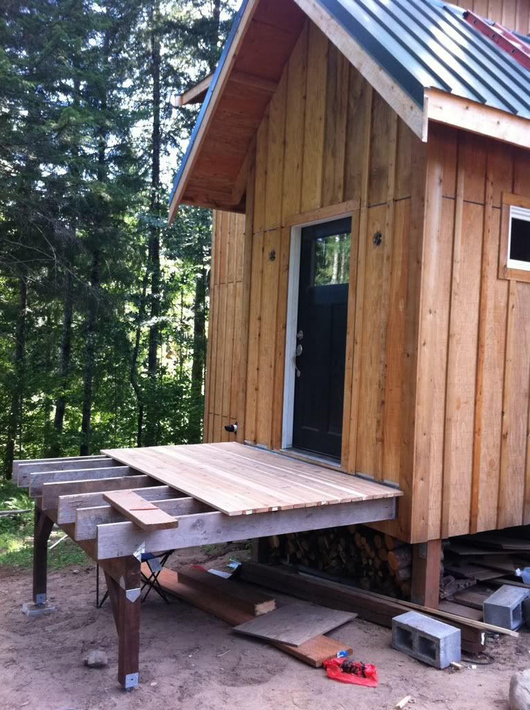

I also finally built some stairs to the front porch.  No railings yet, but given that we are now to the stage of installing flooring, we wanted to be able to have the kids not track in so much stuff from outside.  Just simple stairs, but they feel and look beefy which I think goes with the place.  I went back and forth on what I should use for the treads and finally just went with simple Doug Fir 2x12s, but then for the risers I used cedar.  I still have to put the blocks beneath the bottom of the stairs, but that's not a big deal.

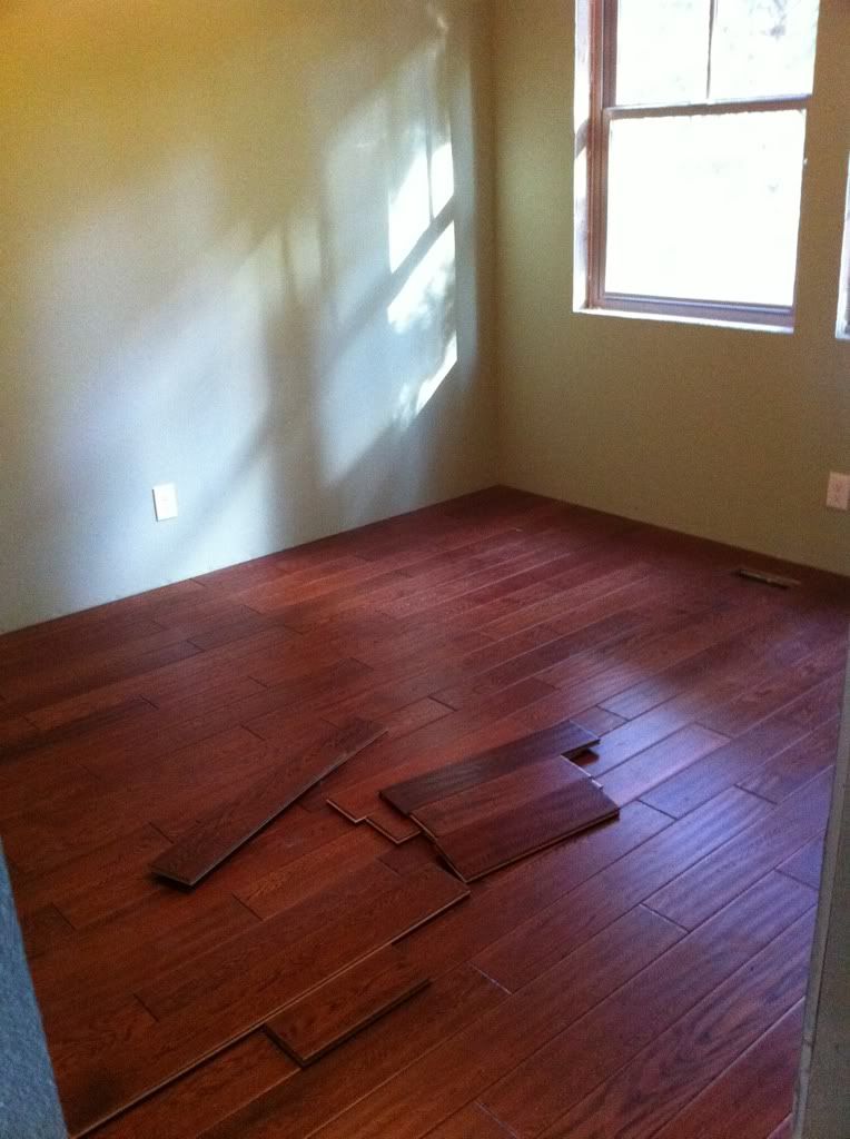

Finally, we started on the hardwood floors this weekend as well, just before we left on Sunday.  We got the kids' room done!  After working with the cedar T&G for so long, the flooring goes together easy and fast, like butter.  8) Really a nice change.  We are using a 5" wide, 5/8" engineered hardwood, White Oak, stained an Asian Teak.  Looks pretty good I think.  The big thing for me was the width, a 5" course makes it feel like you're making progress during install.  No doubt, it's just a head game, but I'll take anything I can get.   ;)  Given I had already installed the ceiling fan in the kids' room, the only thing left are doors and trim and we can call that room done.
We plan to get most of the rest of the flooring done next weekend, which I think will make for a huge change in how things feel overall ... and reduce the dust from the sheetrock!  Anyway, too much typing, here are some pics:
ceiling shots
mudroom ceiling/lights/floor

bedroom floor/ceiling/fan
front porch stairs

As to progress, we got the mudroom slate and the hearth slate grouted and Ditra laid down in the master bath in preparation for tile. We still need to seal the slate, but we'll get to it.  The sheet rock guys also came and hung the durock in the master bath shower, so that's ready for tile now.  The big news is that we finished installing the hardwood flooring throughout the entire place!  We installed hardwood everywhere except for the bathrooms and the mudroom.  I got all 1st floor hardwood installed last weekend, then finished up the flooring in the loft/master bedroom this weekend.  It's quite nice to finally be done with all of the dust left over from having the walls sheet rocked.

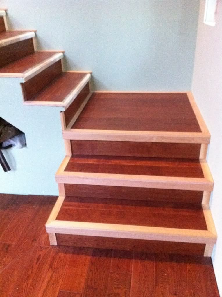

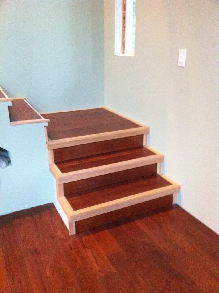

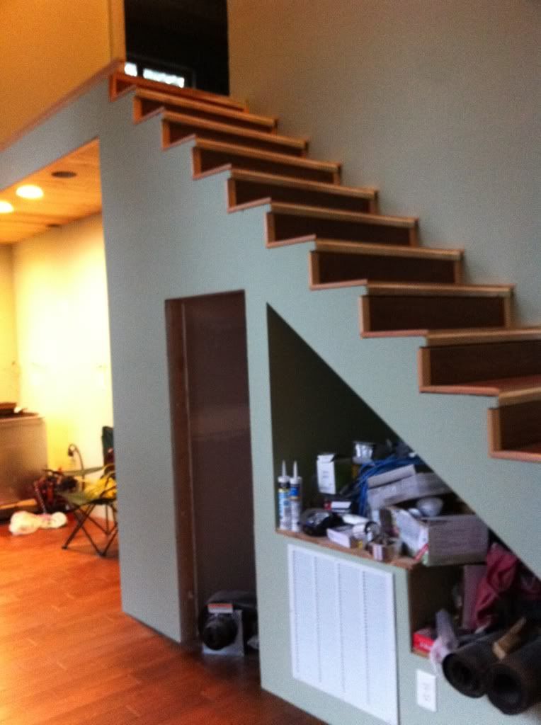

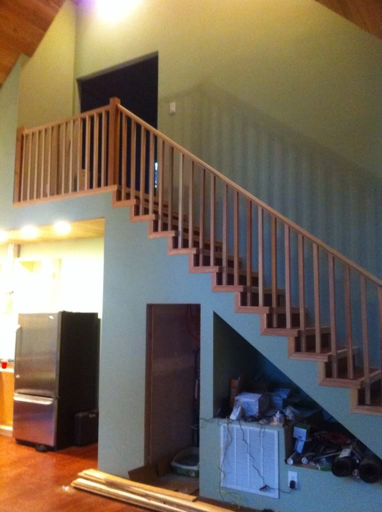

I also got all of the treads/risers installed, which took quite a bit of head scratching before starting. I originally planned to rip up the 2x12 treads and use the pre-fab oak treads with rounded edge, but I like how stout the 2x12s feel.  So, we decided to use the h/w flooring, but it's engineered, so we couldn't just trim the edges because you'd see the plywood layers.  So, given we have cedar on the ceilings (and soon all trim/molding will be cedar as well, we decided to use the flooring for the treads and trim out the edges all with cedar; sort of a ceiling materials meet the flooring materials in the middle kind of thing.  Plus it would keep all of the rise/run dimensions consistent and within the code required variance limits.  Also, I've read about how the contrast factor in stairs is a safety thing...great.    So, I start ripping down the left over 1x6 T&G cedar to make it all work.   I started at the bottom just to get the layout and dimensions worked out for patterning purposes.  I figured if I did the first few steps up to the landing, then the rest of the stairs would be easy just working off the pattern.  I also did most of the "side" of the moldings on the lower steps/landing to ensure the face pieces worked with the side moldings.  Turns out I had to change at least one of the sizes 1/4" to work it all out.  In the end, I got all of the treads and risers installed, now I just need to finish the "finished" edge and edge face as well as the side moldings up the wall.  But I think I like the end results, even if a bit labor intensive.  Let me know what you think....  For reference, we have 16 steps up the loft (9' walls on the first floor and the loft floor is 11 7/8" TJIs hangered on a 6x12 LVL in the middle, so the finished floor is just over 10' up.
Here you can see the side moldings I did in cedar that I will continue all the way up the stairs.  Although I wasn't sure I would like the contrast between the teak-stained oak flooring and the cedar, I think it's looking ok.  We'll finish the cedar when I'm done with installation.
Here's a closer shot.  I ended up doing cedar around the periphery of the landing just to continue the cedar edging as part of the transition.  Thinking it looks ok.
all treads finished... just need to finish the rest of the trim and get the handrail up....

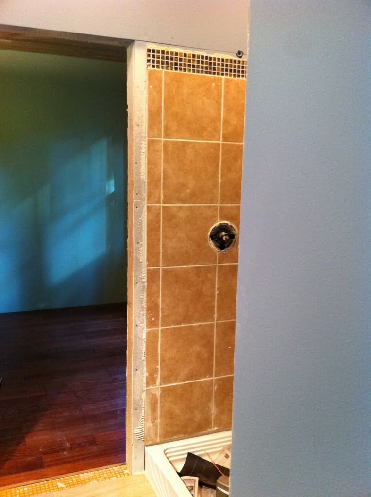

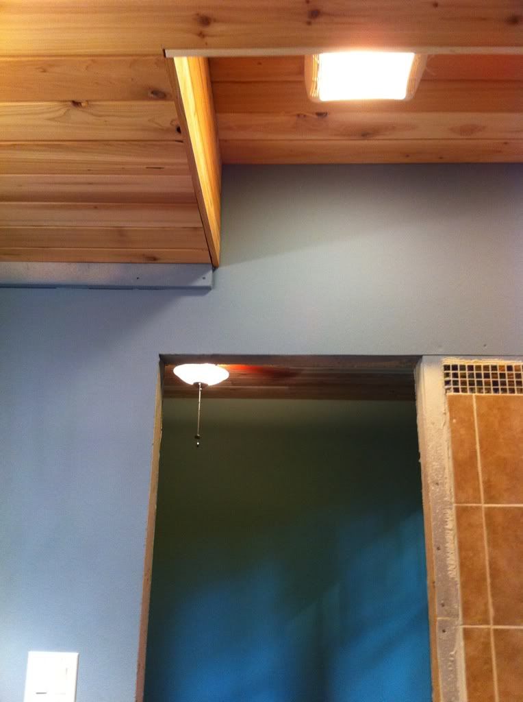

master bath shower - the "stripe" are all glass tiles
crazy looking light fixture we haven't figured out how to position yet
master bath floor is tiled
stairs

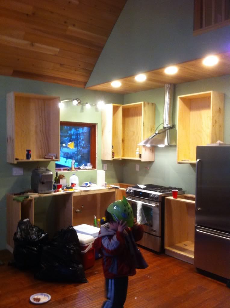

kitchen is coming together - messy since we were packing up.

I forgot to take pictures, but we got quite a bit done.  When we left last weekend, we had tiled the entire shower with the exception of 2 tiles.  So we got those, installed, and then grouted the whole thing.  After that, we installed all the shower trim fittings and it's now ready for doors.  I also installed the second toilet in the master bath as well as placed the vanity.  All we have left up there for the inspection is to get the counter with sinks and faucets installed!  We still have to do tile baseboards, trim some stuff, and hang doors, but I don't think interior doors are required for the CO inspection..... I hope.
We also got the dishwasher installed with the exception of the drain line hooked up, which I'm waiting until I have the sink that is being mounted to the counters this week.  We got a great deal on a Bosch d/w that is only 44db, so even though it's corny, I'm looking forward to running it to see how quiet it is... I got the CO detectors in and then worked on the porch a bit more.  I got all of the railing 4x4 posts up and most of the balusters, but I ran out ... again.  But I did get the stairs leveled out with a concrete footer underneath, so that was good.  I also got the stainless cover installed over the ducting from the range vent hood - the wife was happy to see the finished look.
Hopefully after next weekend we'll be ready for the final inspections.   The kitchen counters should be ready this friday, so I have to build an A frame thing for the trailer this week before  picking them up and transporting to the cabin.   We'll pick up the vanity counter/sinks and all the faucets, and then after finishing the handrail up front I think we are probably ready ...    Like I said, we still don't have all of the trim installed, nor do we have all the interior doors installed, but I don't think that typically matters for the CO given we are owner/builders, yes?
